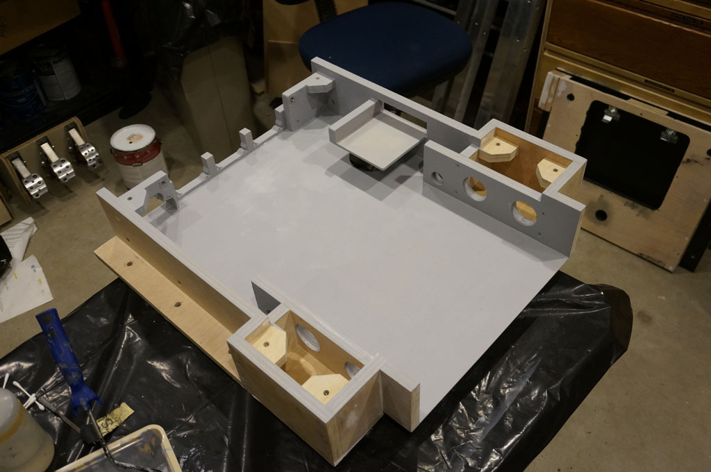

Laythe
  • Posts: 726
Re: Mimic's Sister - Shapeshifter
« Reply #90 on: November 06, 2018, 05:08:07 am »
Quick update...
The front corners of the front cabinet are tricky, with how I want the legs to work.  Aligned the corner blocks, glued and screwed them on, and gave it quite a bit of fill.
I want to blend all this such that it looks like one piece when painted, so I made myself a sanding longboard out of a two foot bar of aluminum I had around.
Got all that fill sanded back down to something resembling flat.  The longboard helps... though the aluminum turned out to rub dark grey onto the wood, oops.
Installed the legs, and here's the current layout.  It looks as though I'm building the shortest pinball machine ever.
The upper backbox doesn't have it's sides yet, as I'm deciding whether or not to groove them so as to hold a bezel type overlay in front of the screens and speakers.
So now I'm finally at the point where I can prime and paint the inside of the front cabinet, I think - since painting it once finally assembled will be impossible.
From the back here, you can see the profile of those side blocks, and how the top of the leg tube interface works with them.
I set this all up to prime... and then decided to sleep on it, just in case I realize some other urgent step I really should do first, heh.
SOON.
« Last Edit: November 06, 2018, 05:20:55 am by Laythe »

I jumped ahead a bit in the process to get the red and black on the backbox because I needed to see PROGRESS.  But, that was getting ahead of myself, and it causes me inefficient use of disposable rollers and brushes to have things in different stages like that.  So I've got more slogging to do.
Blah blah blah lots of bodywork again.   :blah:
Unfortunately, fixing defects in a matte grey surface is hard to photograph.  I'm sure the defects will show glaringly when it comes down to the final polish of the gloss paint, by which time it will be too late to do much about them. But for now it's hard to accurately document this part of the project.
Sometimes I get a really obvious case, like this plywood manufacturing defect:
This is a spot on the inside top edge of the big rear access hatch, where the plywood making machine just smashed a bunch of crap together and left a mangled wreck. There's no screwhead there, that's just a roughly circular bit of wood.  (Surprisingly, this one wasn't too much of a fight to fix.)
Much more often, though, this is representative of what I end up with.
This is on a board that has already been filled, sanded, primed, sanded, filled, and sanded.  That mostly-horizontal line above the speaker hole - that's not a scratch, that's a ridge, buckled up in the top surface ply of the plywood.
I primed the board after this photo, sanded it down, and a bare wooden line shows through. Primed over it, sanded, and that wooden line showed up AGAIN. Primed, sanded, yep, there it is, bare wood above the contour.  Clearly, paving it and sanding the whole thing wasn't getting me anywhere.
So, I tried sanding just the line itself, using the edge and corners of folded-over sandpaper... for about an hour. Primed it, looked great. Sanded it.  Wooden line. Still a ridge.
So I said some strong words of power.
Alright, four coats of primer and sanding on this board and I've still got the defect?  FINE.  Needle file.
I defy this sucker to stick through the paint now!  After all, I know how to fix gouges, that's just filler.
Ha ha ha ha.  So I filled it, primed it, sanded it, and it was still a dip below contour.  So much for "I know how to fix gouges", I guess.  It only took me three more passes of palette knifing primer into the gap and sanding everything down to hit flush.
So this is how I am finding bodywork to go - an awful lot of work, for a very small return, to fix something that looks like it should have been easy to fix. If I don't fix it, it'll show through and look like I didn't care about the build and then bother me forever.  It yields to effort, but only very slowly, and it's very gratifying, but only in retrospect.
Stepping back, here's the whole panel.
This is a rather visible portion of the machine. This will be the wall to your left when you are in driving / simpit mode, pretty much smack dab at eye level.  The ridge, and the gouge, are at least gone. For now, maybe.  I won't be surprised if they reappear in the color coat.
(Also, notice that scar where the freehand dremel burr got away from me at the corner of the speaker is now gone.)
Here's the front of that piece, as primed and prepped.
An interesting detail here is the radius to blend into the lockdown bar at the top. I need it square where it fits into the leg, but the top needs a bit of radius to flow into the lockdown assembly - so the corner is kind of a tall conic section to patch between them.
The lower rear cabinet is also getting attention.
I've done a lot of work on the cheeks that sit atop the rear legs below the neck, that surface was initially pure dog's breakfast. Now it's all the way up to kind of probably maybe okay.
I think all of these surfaces are now good enough to proceed.  I am very much looking forward to getting a color coat going on these, to catch them up with where the backbox is!
