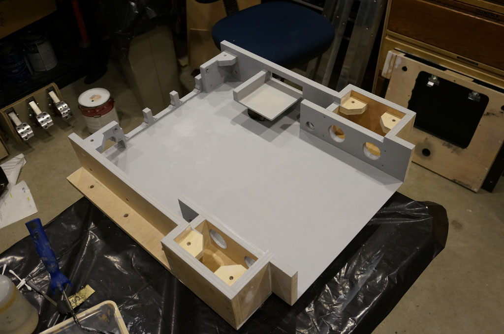

So now I'm finally at the point where I can prime and paint the inside of the front cabinet, I think - since painting it once finally assembled will be impossible.
From the back here, you can see the profile of those side blocks, and how the top of the leg tube interface works with them.
I set this all up to prime... and then decided to sleep on it, just in case I realize some other urgent step I really should do first, heh.

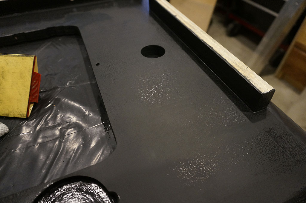

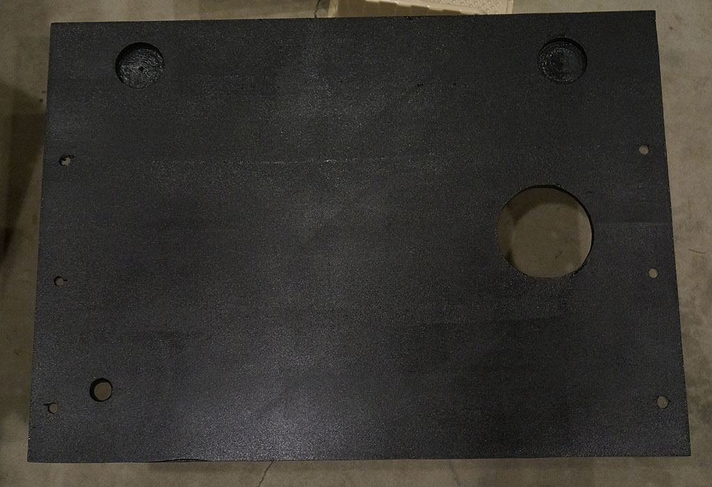

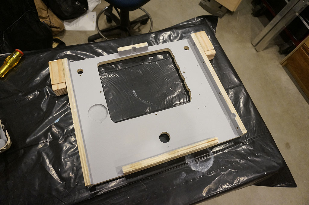

I went ahead and primed the interior of the front cabinet panels.  Priming is easy and fun, nothing much to say about it - I've primed a lot of things before and I'm comfortable doing it with a roller brush and a foam brush.
I knew I wanted the interior of the front box painted because you'll see it when you open the coin door.  I kind of regret not painting the interior parts of Mimic, so I figured I'd go ahead and paint up the inside of the back cabinet too, though it'll only show when the access hatch is off for service.
It'll help block light leaks on the buried DMD monitor.  There's no good way to get a paintbrush up into the side cheeks, though, so I'm just going to do the main atrium / wind tunnel down the center.
I dry sanded the light grey primer with a couple passes of 250 and 400 grit, then rolled on a coat of gloss black latex paint, and it looked bad.  That's okay, though the first coat on primer always looks bad, that's to be expected.  I knocked the high spots off with another pass of sandpaper, rolled on the second coat, and that's about what most of the bookshelves I've made get - full coverage, but it could perhaps be called utilitarian.

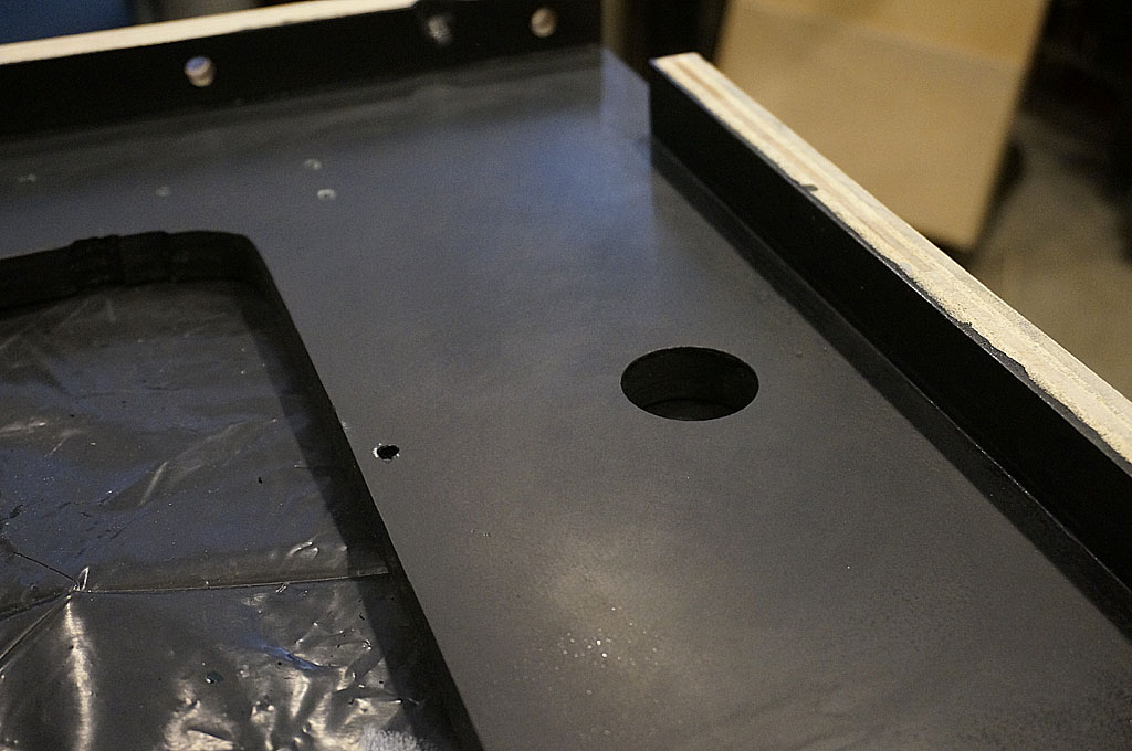

My base layer sanding didn't do as much as I thought.  But hey, I thought, I've watched Ond's video, I just need to do the process.  Sand more.
So I sanded down to accidental burn through into primer, and rolled on more black paint, and sanded through it, and rolled on more, and the results were just wretched.
I mean, awful.
Awful, like, this is what I had after about 10 hours of work.
That is like five coats of paint.  I'd gone through maybe ten complete sheets of sandpaper by this time, full of pilled up impacted paint bits.  If anything, it looked worse than the brute force two-coats-and-done I've used in the past.
My spirits at this point were pretty low.
I found myself remembering:
You won't disappoint my friend  :).
... yeah.
I kept going.
By hour 18, with rigorous care dry sanding and the most careful sanding block discipline, I had something that reflected light like this:
(That's the white specular reflections of the shop lights in the high gloss valleys, and I'm maybe halfway down to meeting them with the flat matte finish left from the hours, and hours, of dry block sanding I've done.)
So at that rate, what, it should take 30 hours to hit the bottoms if I don't screw up and knock a hole to primer somewhere first?  Hrgh.

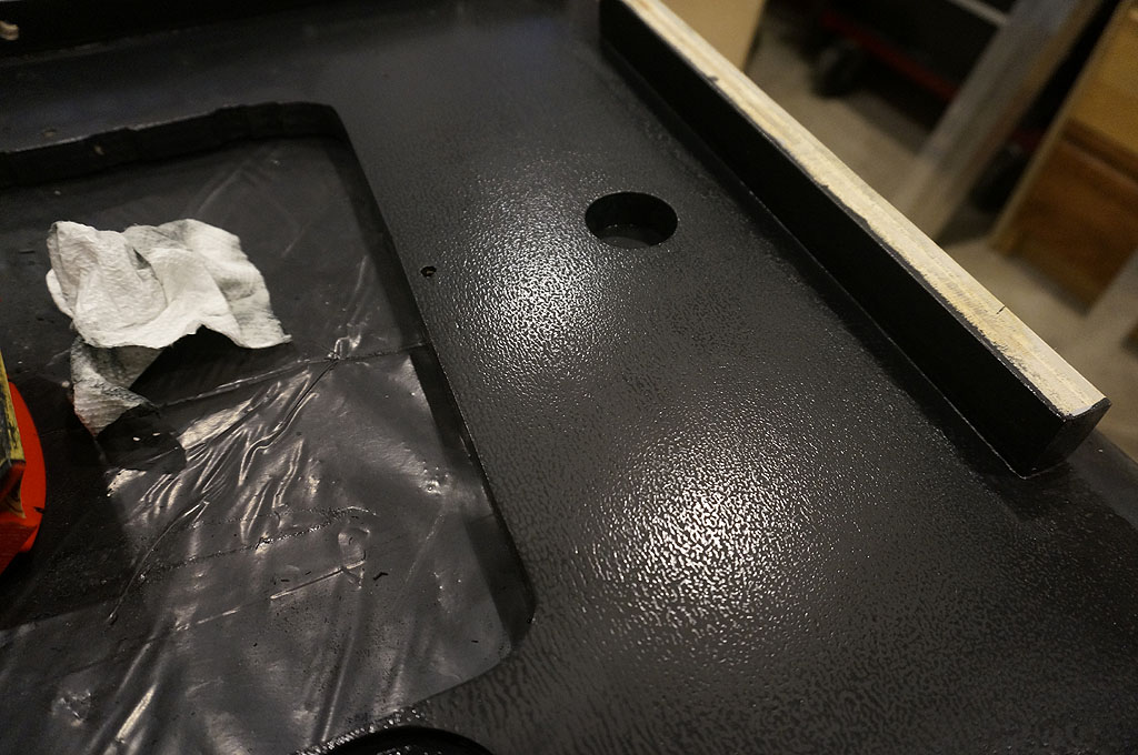

I started getting experimental.  Why not, this is a lot of doom and ruin anyway.  I thought about Ond's video, and watching him dip his sandpaper in water to clear the dust.  I grabbed the water bottle I use to dampen my soldering sponge, and hosed a dab of water right onto the middle of the panel with a shrug.  Plopped the sanding block into the pool and instantaneous magic happened.
Where I was fighting stiction and pill-rolling and a nightmare of slow progress interrupted by dusting the paper and the work surface every fourth stroke... a fine slurry of silky paint sludge began to flow.  The feel of the sanding block changed entirely - I could read the remaining contours in the surface from the way the pad moved, and everything started to WORK.  Wet sanding this stuff is like a 10x speed multiplier.  It is -amazing-.  It is -magic-.
About 18 hours to get to that picture above.  Add water.  And then it's about 15 minutes to get to this.
Well hello there.
The rate of improvement of the surface is astounding.  I think some of the slurried dust of water and latex paint is reattaching in the bottoms of the valleys or something, because the surface improves faster under wet sanding than just knocking the tops of the peaks off seems to explain.
Another fifteen minutes, and,
I think I've learned how to do this, maybe!

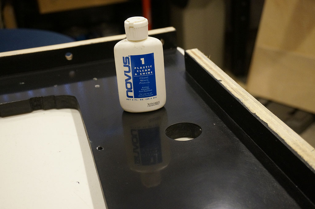

I kept at it with the wet sanding, learning the feel of it.  Once I got it somewhere I liked, I broke out the Novus #3 and #2 polishes, and I got this:
Not bad, for foam-rolled latex paint, hey?
Thanks, Ond.  I wouldn't have believed I could do it.  Now, I think I can.  Water is the epiphany.  Water is the answer.  I still have much technique at this to develop, but I feel I can see the way now.

If you are sanding for hours and hours w/o progress - you are using too fine a grit..
Getting a polished finish is all about a finer grit taking out the scratches of the previous grit..
Wet sanding is great - but don't kill yourself for hours using 400G when you can cut the high spots down with 180/220 (wet) first...  then step through 320/400/600 to get the final results.
Keep up the good work  :)

Thanks, Malenko, Ond, Arroyo and bperkins01.  That you all think I'm on the right track is encouraging.
(bperkins01:  My problem was that if I used any coarser grit dry, I was blowing through the color coat into the primer in places long before getting through the orange peel everywhere else - the only way I could get the control to avoid having one deep pill-rolling corner of the paper breaking through, was killing myself for hours starting at 400g and cleaning the paper every four or five strokes.  Doing it dry is just the the wrong way to go.)

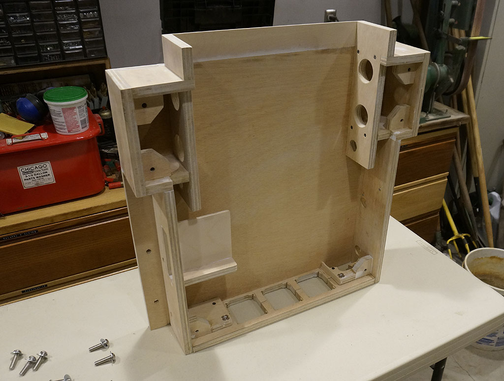

I've got the inside of the aft cabinet painted now, and I am verifying and tuning the fits with the thickness of paint.
Here's what the bottom will look like - three intake fans, the power relay, and a big cable passthrough.
Pardon the upper fan screws and the button head upper panel screws not being installed - the paint is still tacky so I don't want to go clamping things together yet, this was just a quick check.

So, working up from the floor - the brackets attach to the floor.
The side panels of the backbox attach to the roof panel...
And then the resulting arch attaches into the floor and monitor brackets.  This locates where the bracket holes line up onto the back of the roof panel.
This shows the skeletal frame of the backbox while empty, when the hatch is not present to form the aft wall.
I'm pretty much hanging the weight of the monitor off four screws through 3/4" plywood here, so I wanted all the engagement on them that I could get.  I didn't want to lose the strength that the tapered tip of a wood screw would have given up, so I went with over-length screws on purpose.

I jumped ahead a bit in the process to get the red and black on the backbox because I needed to see PROGRESS.  But, that was getting ahead of myself, and it causes me inefficient use of disposable rollers and brushes to have things in different stages like that.  So I've got more slogging to do.
Blah blah blah lots of bodywork again.   :blah:
Unfortunately, fixing defects in a matte grey surface is hard to photograph.  I'm sure the defects will show glaringly when it comes down to the final polish of the gloss paint, by which time it will be too late to do much about them. But for now it's hard to accurately document this part of the project.
Sometimes I get a really obvious case, like this plywood manufacturing defect:
This is a spot on the inside top edge of the big rear access hatch, where the plywood making machine just smashed a bunch of crap together and left a mangled wreck. There's no screwhead there, that's just a roughly circular bit of wood.  (Surprisingly, this one wasn't too much of a fight to fix.)
Much more often, though, this is representative of what I end up with.
This is on a board that has already been filled, sanded, primed, sanded, filled, and sanded.  That mostly-horizontal line above the speaker hole - that's not a scratch, that's a ridge, buckled up in the top surface ply of the plywood.
I primed the board after this photo, sanded it down, and a bare wooden line shows through. Primed over it, sanded, and that wooden line showed up AGAIN. Primed, sanded, yep, there it is, bare wood above the contour.  Clearly, paving it and sanding the whole thing wasn't getting me anywhere.
So, I tried sanding just the line itself, using the edge and corners of folded-over sandpaper... for about an hour. Primed it, looked great. Sanded it.  Wooden line. Still a ridge.
So I said some strong words of power.
Alright, four coats of primer and sanding on this board and I've still got the defect?  FINE.  Needle file.
I defy this sucker to stick through the paint now!  After all, I know how to fix gouges, that's just filler.
Ha ha ha ha.  So I filled it, primed it, sanded it, and it was still a dip below contour.  So much for "I know how to fix gouges", I guess.  It only took me three more passes of palette knifing primer into the gap and sanding everything down to hit flush.
So this is how I am finding bodywork to go - an awful lot of work, for a very small return, to fix something that looks like it should have been easy to fix. If I don't fix it, it'll show through and look like I didn't care about the build and then bother me forever.  It yields to effort, but only very slowly, and it's very gratifying, but only in retrospect.
Stepping back, here's the whole panel.

I did a little body work on, then primed, the rear hatch panel / back cabinet spine.
To verify that things still fit together with primer and some of the paint, and to transfer the positions of the stripes between parts, I did another test assembly.
These test assemblies also serve as integration checks for me - this is the first time the whole backbox mounted to the back cabinet with the rear hatch installed, and that took quite a bit of sanding and adjusting to make work.  I also like keeping pictures like this around to look at while I've just got a bunch of subassemblies in front of me, to reassure myself this can yet become A Thing.
But, next on my list is more paint.  There are three panels here - the front of the back cabinet, the front of the front cabinet, and the back of the front cabinet, that all get a tricksy two-tone horizontal stripe division out in the middle of the panel dividing red above black, and while I'm rolling black paint this time I'll also be doing the back hatch.
The back hatch is relatively easy, and since this face will be inside the cabinet and invisible in the end, I'm considering just painting it, I'm not doing the full on sand and polish to be sufficient - I've got plenty to sand and polish that will matter a lot more elsewhere.
(Well, okay, maybe I will sand it a bit, that looks awfully ragged...)
The main thing I've been working on, though, is the two tone paint.  I figure to do the black first, because the slurry of wet sanding red paint is more likely to come off the black than the black slurry is off the red, I think.  I made the terrible discovery on a prior part that masking tape will in fact lift my primer - so I don't dare use it for this line.
So... I'm freehanding it.  Aw yeah.  Slapped a yardstick up, traced a pencil line, painting up to it, freehand with a disposable sponge brush, out in the middle of nowhere.
Good enough!
It's... decidedly tricky to polish up to an edge like this, and not over.  I'm not 100% sure that this is going to work when I've got live red and live black paint abutting each other and I'm trying to polish them both, but at absolute worst, if it all goes south I'll just stick pinstripe tape over the seam and pretend like I meant to do that.
I've got a fifth coat of black on the three tricky panels right now, and once it's good and cured, I'll come back and give it the sand and polish treatment because I think it's thick and flat enough now.  Black Mirror, here I come.

I finished sanding the first panel - got it to about here, at 400 grit wet.
This is the best panel I've done yet - I've got a defect where I burned through the color coat at the lower left corner, but it's in an area that will be covered by the control panel rail assembly, so I'm okay with that.
Gave it a polish.
It's getting there, I've still got a lot of swirl scratches to buff out, but if I hold my hand up next to it...
Polishing up to the line and not over seems possible at this stage, when it's primer above the edge - managed not to smear a lot of black onto the grey primer, and that gives me hope.
Next up, the other two panels get this level of sand and polish, and then as a long term goal I get to paint the red down to these lines.  The grand challenge will be to see if I can get a two tone panel where both sides are polished like this up to the seam.
