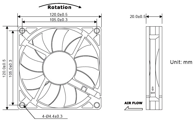

How do you ventilate your cabinet?
« on: May 17, 2018, 03:18:29 pm »
With a marquee, power supply, lcd, and computer... how do people ventilate out the inside of their cabinet most effectively?
Is LED even hot enough to warrant creating ventilation?
How about everything else?

Normally: vent on the bottom edge of the back panel and a fan or two pulling air out of the top.  (fans on top part of pack panel or slanted panel above the pack panel, but not horizontal on the very top)
In old cabs, convection did a good enough job that fans weren't used.  Fans are cheap insurance though.
I have fans in the bottom of my cab pointing at the floor and pulling air in.  I'd consider that bad practice because it sucks up dust from the floor, but it's what worked with the way my cab is set up inside.

I’ve found some on amazon, and even a few powers by USB, but they only give the measurements of the whole housing unit. I can’t tell how big of a radius/diameter to cut.
Any advice?
I would normally cut after I get them, but I’m taking all my wood to a CNC.

I'd use two 120mm computer fans running off the PC power supply.
The fans go nearly to the edge.  Eyeballing it, a 116mm hole would probably be safe.  That would leave about 2mm overlap to cover the thickness of the sides and avoid having a gap.
I'd buy the fans first and measure though.  If the hole is too small, the fans won't function optimally.
If mounting vertically, sleeve bearing is ok.  If mounting horizontally or at an angle, get ones with ball bearings.  (sleeve bearings wear out prematurely when mounted horizontally)
Ones with built in speed controllers would allow you to make them run slower if they are too loud, but I'd just hack the connector to use the 5v pin instead of the 12v pin on the molex connector.

Where do you think I should put the fans?  One on top back and one on bottom right by CPU?
This was answered in my first reply.

There is no need for ventilation. In my opinion (unless you run your machine for 18 hours straight), it's the most over done part of a home build. I mean the cabinet itself is big enough to diffuse any heat coming from a computer with a case. Decase the computer and your problem is solved. LED's give basically no heat. Now if you are running a bartop then that is a different story. But a cab is huge. I would never worry about it. Plus using fans is a great way to get a ton of dust in your machine. My Outrun fans are so stupid and loud and bring every bit of dust inside my machine I had to cut the wires.
My Mame cab never once got hot, and that is in a smaller Konami cab. My Galaxian, punchout, time pilot, street fighter, and pinball machine have no fans going. 100% over rated. I have never once heard of a full sized cab over heating.

Pretty much what I said. Even the CPU fans on mine are only ever at a low spin speed (quiet!) - if the CPU was getting hot, they would spin up. They only spin up for a few seconds when I switch on the cabs. I assume this is just to blow off any dust that may have accumulated since they were last turned on.

If you're super worried about it, a fan to pull cold air in near the computer.  A hole at the top is all you need (with vent cover), but you can add a fan there too.  Make sure you mount the fans properly (you don't want it pushing the hot air down). Most people decase their computers, I think its better to leave it in the case. you can control airflow better inside a tiny box instead of a full sized cab.
