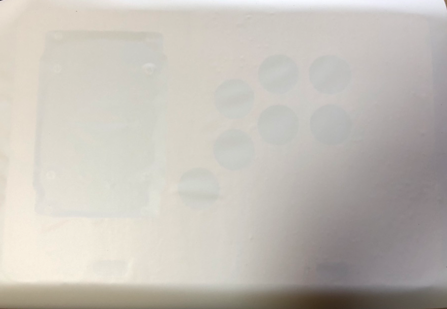

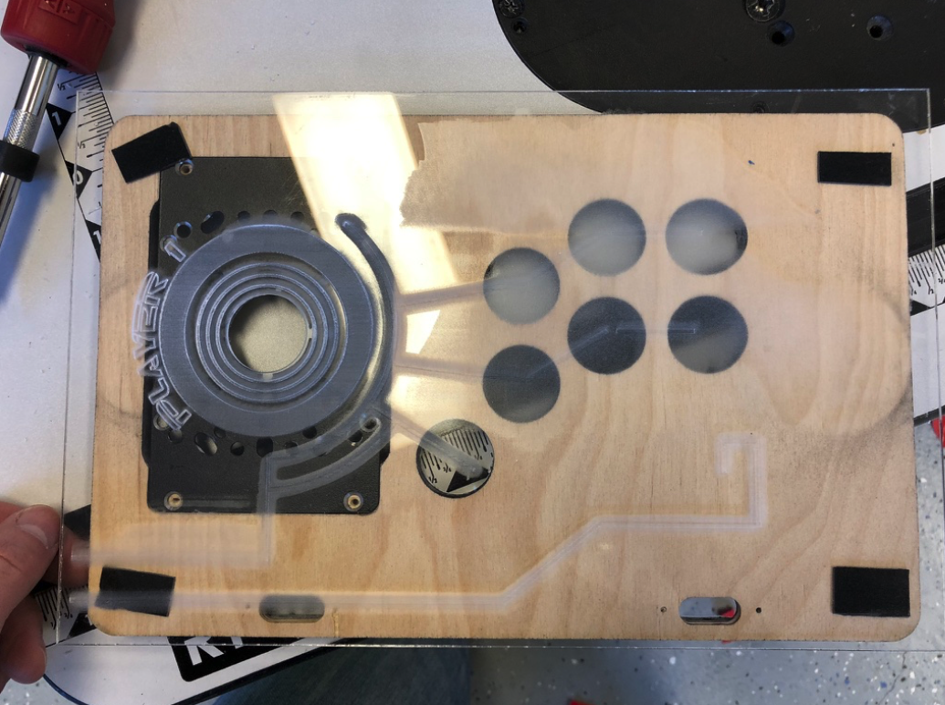

MikeA came through big time!

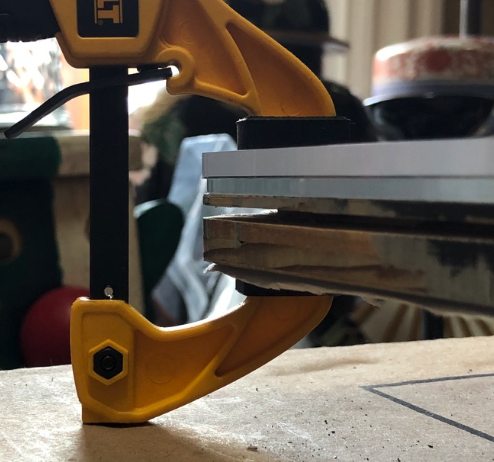

Laser etched the image:
Graphics applied:
Close up so you can see the contrast:
Unintended cool byproduct is a reflected image off the Acrylic that gives it a 3D look (didn't bother to clean up the dust sorry about that):
Assuming we can pull this off on a larger scale I'm running with this technique.
Thanks Mike!

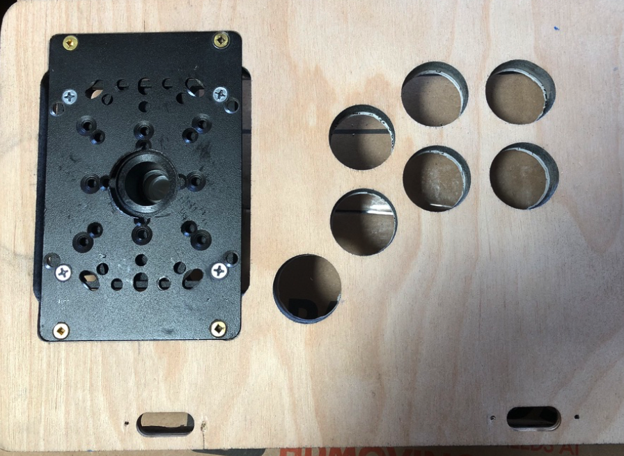

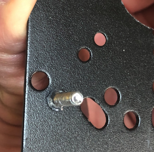

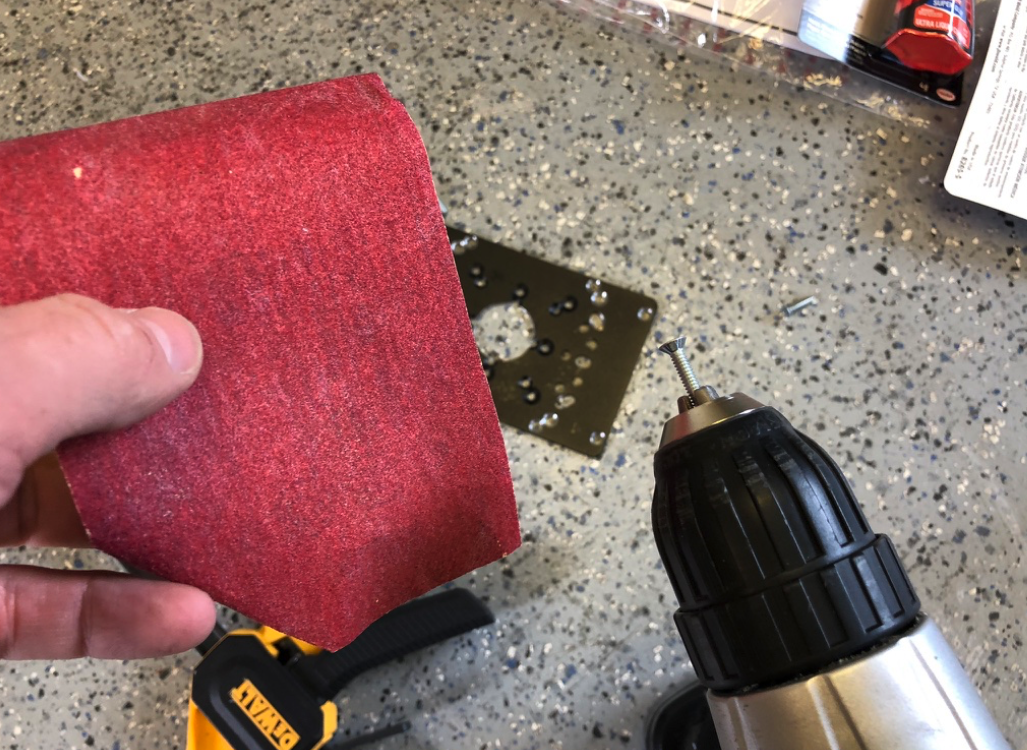

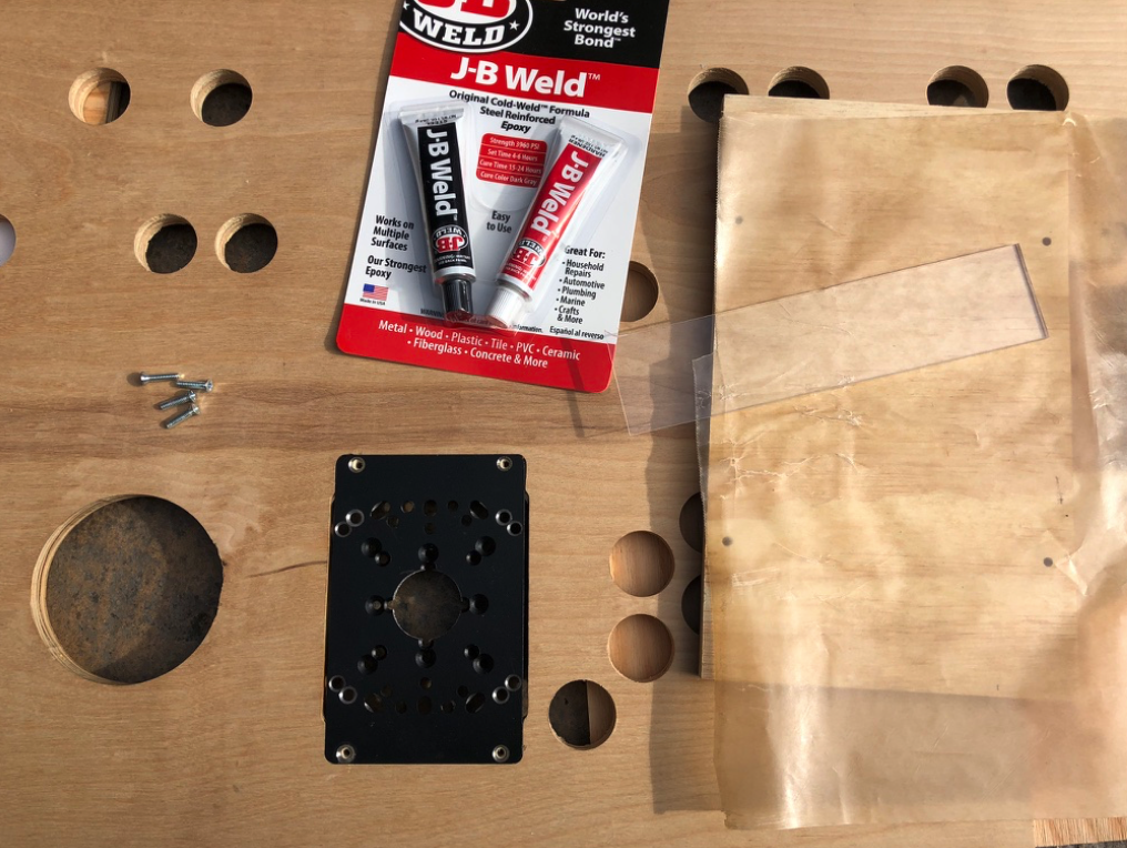

First thing was securing the screws into the mounting plate so I can swap out controllers.  Considered welding at one point, but it’s complicated without using the same materials (i.e. all steel, oh and I don’t own a welder might be a problem as well…hmmmmm), so instead started researching epoxies.  Seemed pretty good from what I read so decided to give it a shot.  First thing I read was that you get a stronger bond with a roughed up surface:
Busted out the J.B. Weld slow drying epoxy:
Mixed equal parts, used a piece of Acrylic to mix it together (wood stick probably would have been better), applied to the countersunk holes in the mounting plate and put the screws through till they were flush.  Noticed that I got some epoxy on the threads of the screw and quickly wiped off (would have been better to have used some plastic wrap to protect the threads).  Let it dry over 15 hours and:
Man this stuff is crazy strong.  It held up well to multiple attempts to over tighten the wing nuts I’m using

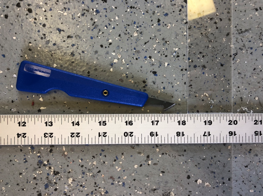

Side note: to quickly cut the Acrylic I used this tool that I picked up from Tap Plastics:
Instead of needing a special blade on a table saw, you just use this and a straight edge.  Make a few swipes till you get a decent depth, and then snap the remaining part over a straight ledge.  You get a very clean cut.
Anyway….

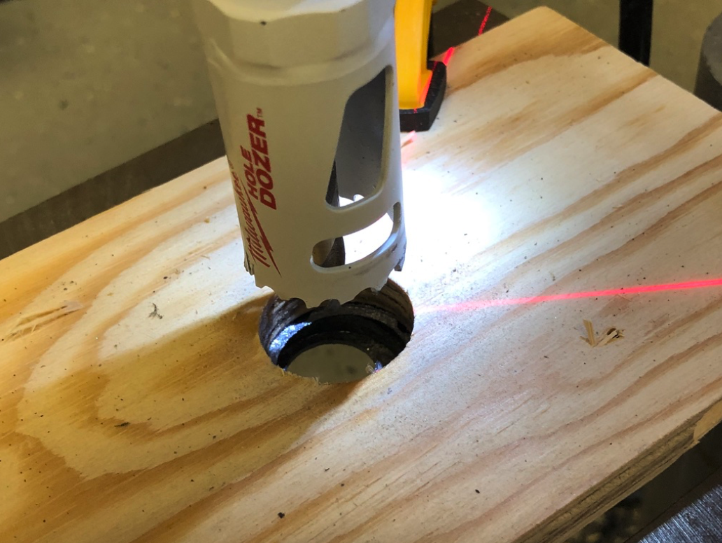

Needed to drill out the hole in the center of the mounting plate because I needed to fit the addressable (WS2812) ring LED that I will be using to light up the center of the joysticks.  Made a 1 1/8” forester hole through wood as a guide, and then used a 1 1/8” hole saw to make the cut (I did this before the epoxy FWIW):
With that out of the way, I put the mounting plate back into the CP wood to finally be able to make a permanent install:

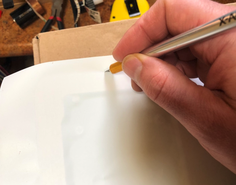

I’ve been using a white piece of paper behind the laser etched Acrylic (thanks again MikeA!), but needed something more permanent.  Picked up some Oracle 651 Matte White Vinyl:

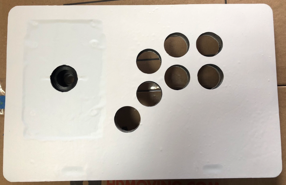

Did what most guys do and used a sharp Exacto knife and followed the edges to cut it to size:

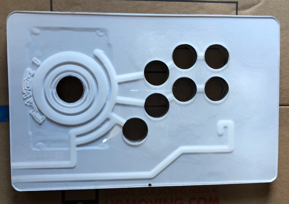

Cut out the etched Acrylic using the router mounted to the router table and used a flush trim bit to follow the wood outline:
I think I mentioned it before, but I love using this double sided adhesive (3M Scotch double sided mounting tape), it’s crazy strong, so much that you only need just a little before it becomes almost impossible to pull it back apart.  It makes pattern cutting very easy though.
Next I put the etched acrylic on top:
Then applied the graphics between the two pieces of acrylic and used the same Exacto knife then to cutout the holes:
I forgot to mention that while I was routing the etched Acrylic I had to do two things.  I needed to shave off around 1/32” all around so that it would create a gap between the top layer acrylic and the wood layer:
You can see that ever so slight offset of the lower plastic from the top and bottom above, that where the edge lighting from the LED’s is accounted for so as to not bulge the T-Moulding.

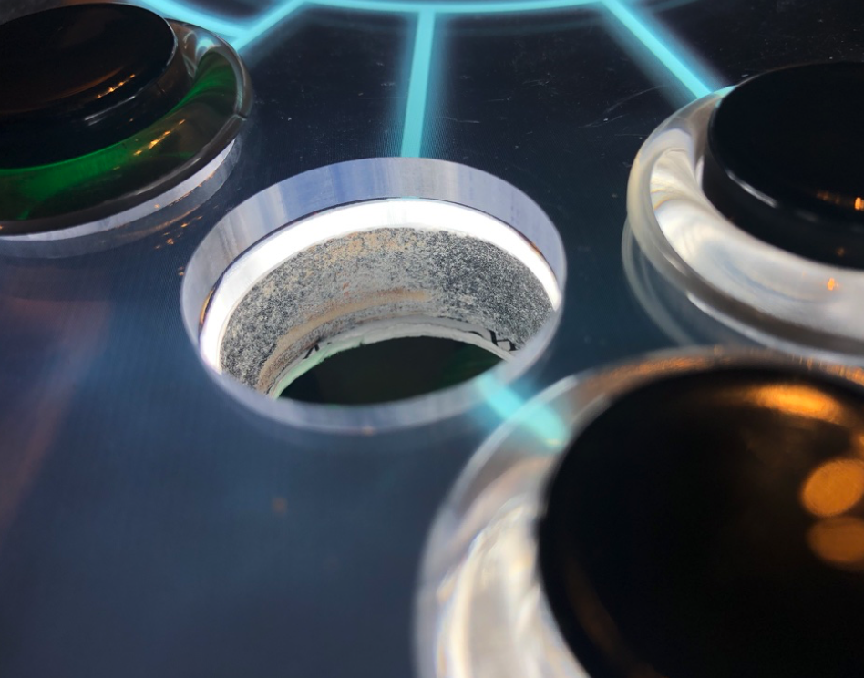

Also broke out the Map Gas Torch to make the edges optically clear for the LED’s (no I did not do it this way, the flame is far from the stuff around it) ;D

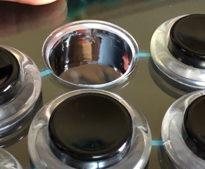

Next was putting the buttons in.  The buttons act as a clamp for all of the layers and hold things together.  The only problem I had was getting the lighting I wanted on the buttons.  The side lighting from the LED’s lit up the buttons from the sides and washed out the colors from below.  Looks cool without the buttons in:
It seemed simple enough to line the hole with some Oracle 651 matte black vinyl to block the light.  It worked, however I got a tunnel problem on the buttons where the light wouldn’t spread out to fill the edges:
I thought to use some mirror vinyl to help, and it did but still not quite perfect:
It got better as I lowered the mirror vinyl down from being flush with the surface allowing the light to bounce more to the sides and reach the edges of the buttons.  Still not being satisfied I decided to break out a router bit I’d been meaning try.
1/16” roundover to give a smooth edge to the button holes helped a lot (I tired many other things including black vinyl rings below the graphics, and all sorts of combos), this worked best:

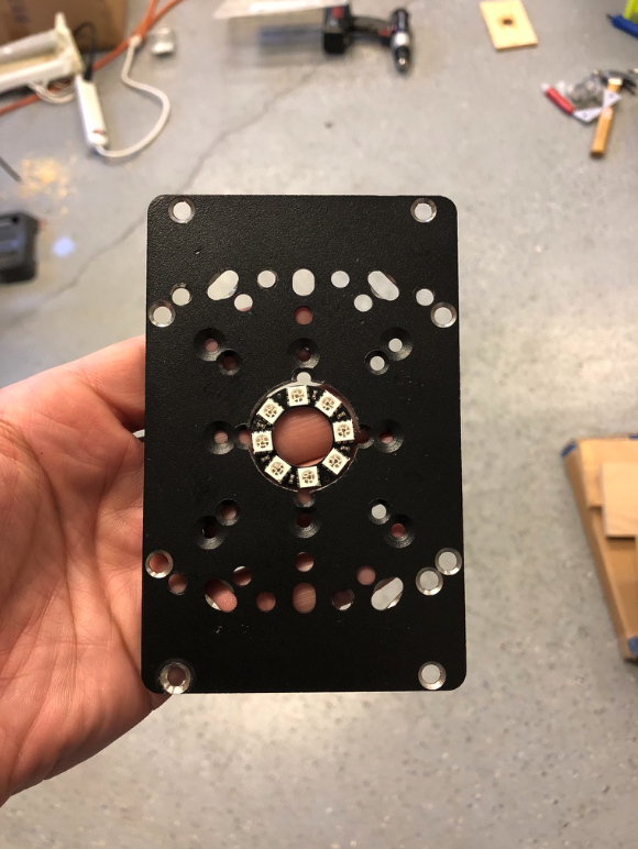

Continuing with buttoning this up, I needed to get the side lit LED’s mounted into the sides while not compromising the T-moulding.  As mentioned on my previous post I used the wood sides and shortened the middle layer of etched acrylic by roughly 1/32” on all sides to allow a channel for the LED’s to sit so they wouldn’t bulge out the sides and push out the T-moulding:
This is a cool white 24V LED strip I got off of AliExpress and it fortunately is just the right width to fit.
As I laid down the LED strip in the channel I braced it with black vinyl to hold it place so that I could apply the T-moulding.
Then I came around with the T-moulding:
Got a little tricky around the routed area for the hinges and the corners, but as others have done I cut the spine to make it fit.
Slapped in a Sanwa JLF just to see how it all looks:
You can see the LED ring around the joystick which fits perfectly in a 1 1/8” hole.
To try and keep this all compact I ordered a NanoLED addressable LED controller from Ultimarc.  I hadn’t really seen anyone use one in a build before. What I found out was that it wasn’t quite working with LED blinky.  I’ve been helping Andy and Arzoo with some testing in the background and we’ve made pretty good progress.  The WS2812 ring LED works perfect, and I’m experiment with some individual WS2812b LED’s under the buttons.
What’s nice about using addressable LED’s vs non is that you can get a clean wiring job (albeit a pain in the ass):
I’ve found that it’s always best to pre-solder the pads, and the tips of the wires (so the strands don’t fray).
I used 22AWG wire and then sleeved them with some heat shrink tubing:
Unlike the ring LED’s I’m having troubles controlling the individual WS2812b ones, it may be a bad solder joint we’ll see.
I also wanted to mess with how to handle the dust washer.  The plan was to use the same ring graphics and light them different colors underneath but I’m not sure if it works:
I had the idea to try some diffusing Acrylic, and picked up some 69% transparency white acrylic that matches the existing white ring.  I’m thinking of burying this just above the ring LED and putting a clear dust washer over the top. Cutting the acrylic that precise that small probably can only be done with a laser cutter……MikeA is becoming my new best friend. ;D

I wanted to keep the lighting really confined to just the graphics.  It’s really easy to get light bleed on the edges so I bought some Black 2.0 (supposedly the blackest paint you can buy), and painted the outside edge of the top layer of Acrylic, and the inner ring around the joystick:
I should have used black acrylic paint which I only later found out when talking with folks at Tap Plastics.  The other thing I will change when building the actual panel is not cutting the graphics so close to the edge.  There is still small areas of light bleed, that had I left the graphics to stick out some it would have covered over the LED’s better and not allowed any light in.

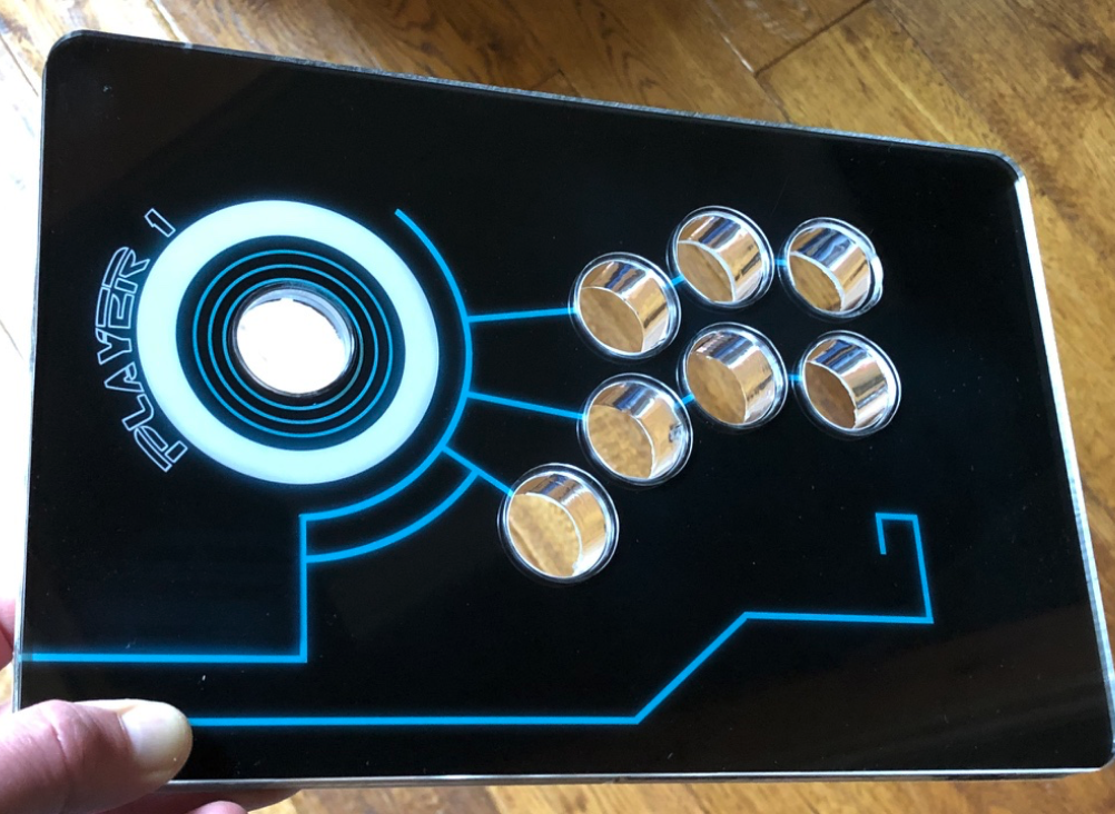

And completed panel:
Lit:
