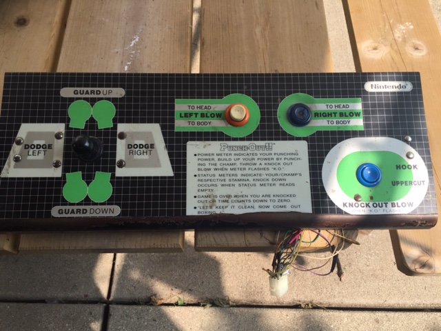

First thing first I decided to tackle the control panel.

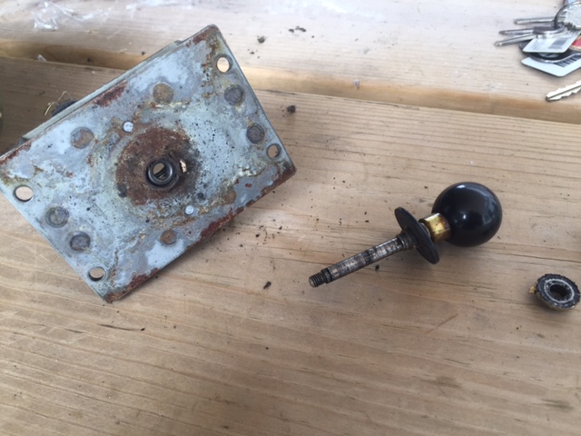

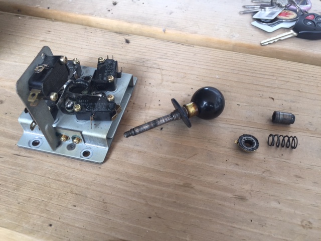

Joystick is missing pieces, there is a ducking feature when you pull on the joystick little mac ducks... there were missing pieces and broken pieces. The buttons are all wrong, the cp is ripped and the cp itself was rusting pretty good. Someone plugged in every single connector on the back so all three connections on the micro switches were being used... lol

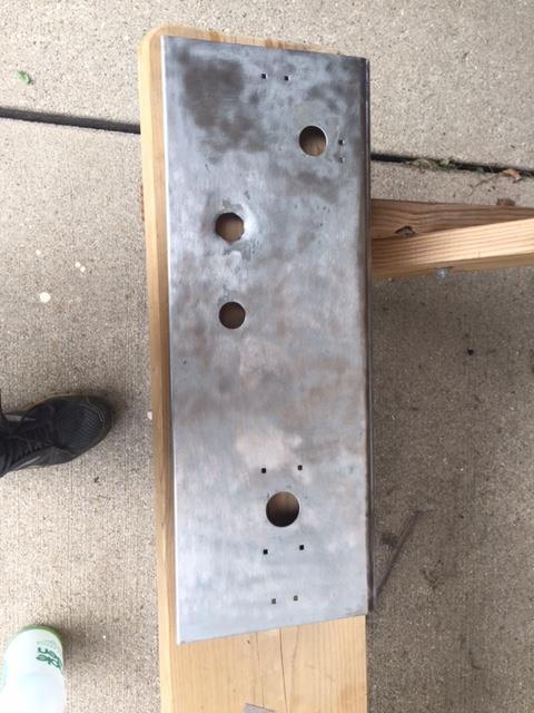

Removed everything including the Artwork (came off easy with a heat gun), then used a wire brush to remove rust and all of the glue residue. I tried Ooops to remove the glue but it wasn't working... then I went to the big guns and used Xylene which was working, but not so much that I could just wipe it clean. So a combination of Xylene a wire brush attached to my drill and a brillo pad cleaned up the control panel pretty decent.

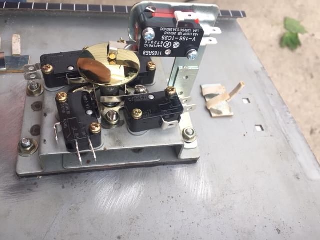

Next was the Joystick
More cleaning and got new parts from Mikesarcade.com
Finished
