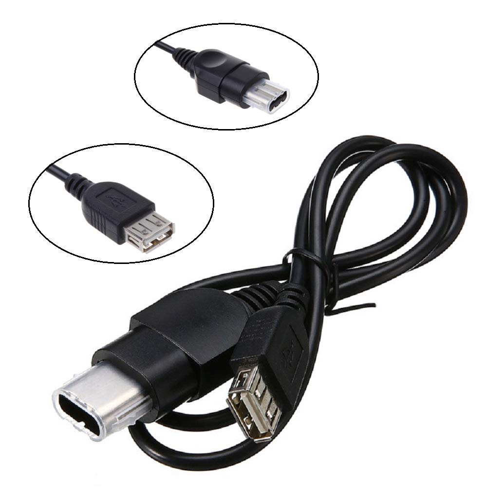

I was looking at the pinout and I have one question? Where does the out to the xbox get wired in? The micro usb port?
bootsector
  • Posts: 87
  • Last login:December 29, 2018, 12:48:52 am
Yes, you connect it to the XBOX via  the micro USB port.

- Xbox (USB cable + female USB to joystick port adapter cable)

Now when I attach it to my Xbox it's not recognised, I'm using a Xbox-USB adapter I used to connect a usb stick to the Xbox so I could softmod it a while back.  :dizzy:
Is this because the FW in post 82 is for Xinput in windows, or should that work with Xbox as well?
The way Bruno explained it, the original XBOXPadMicro firmware was designed to make an Arduino Micro into an XBox-compatible encoder.
Imp modified the pinout to work with the pins available on a Pro Micro board and mentions this.
I used this tool to map my buttons correctly: https://gamepadviewer.com/
AFAIK the Pro Micro USB cable should plug into a "female USB to XBox joystick port adapter" cable like this these and work just like an original controller.   :dunno

Here's where I'm at.
This is the Xbox - USB connector I have. It does recognise when a USB stick is inserted into it. I've tried 3 different USB cables, different lengths and different manufacturers. Also, I've tried grounding the pins on the Arduino directly. They register in Mapper but not on the Xbox. Hmm, I guess I'll try buying another adapter to see if that solves the problem.
