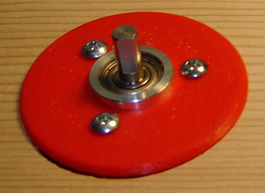

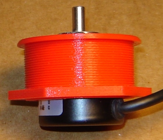

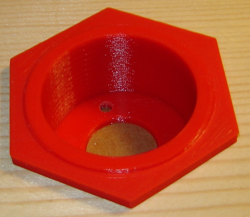

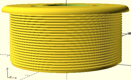

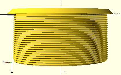

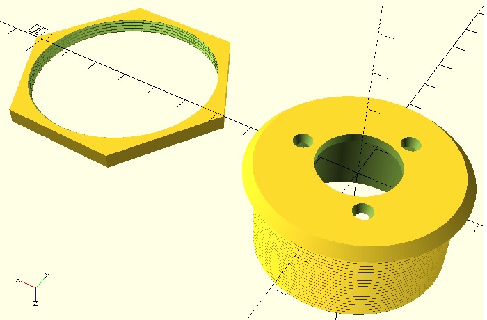

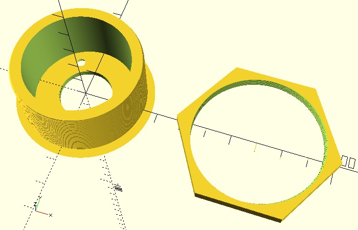

For anyone who missed Marsupial's  Build your own HID-mouse compatible spinner project, here are two parametric mounts created in OpenSCAD.
The first one has a chamfered bezel.
- The OpenSCAD code generates a model with both the nut and the mount.
- The .zip files linked below reorient the mount so it is print-ready. (i.e. face down)
- Be sure to download the .zip files for both the desired mount and the nut.  The mount .zip files do not include the nut.

translate([D_maj/2,0,(i+j)/360*P])
screwthread_triangle(P);
translate([0,0,P/2])
cylinder(r=D_min/2,h=2*P,$fn=360/step,center=true);
module thread(P,D,h,step) {
for(i=[0:h/P])
translate([0,0,i*P])
screwthread_onerotation(P,D,step);
// Variables:
ThreadPitch = 1;          // Screw thread pitch
ThreadMajorDiameter = 49; // Screw thread major diameter
ThreadedRodHeight = 23.8; // Threaded rod height
ThreadStep = 2;           // Thread step size in degrees
PlateThick = 2.4;         // Mount plate/bezel thickness
BezelTopDia = 50;         // Bezel top diameter
BezelBottomDia = 55;      // Bezel bottom diameter
BezelCenterHole = 21;     // Bezel center hole
ScrewHoleBottom = 3.45;   // Bottom of screw hole diameter
ScrewHoleTop = 3.45;      // Top of screw hole diameter, for non-countersunk screws use same value as ScrewHoleBottom
ScrewDistance = 15;       // Distance from center of shaft to center of screw hole, usually 14 or 15
CenterCylinder = 40;      // Center cylinder diameter
NutDiameter = 64;         // Nut diameter (point-to-point)
NutThickness = 4;         // Nut thickness
WiggleRoom = 1.02;        // Scale multiplier for threaded rod X-axis and Y-axis that allows nut to turn easier
NutOffsetX = 70;          // X-axis offset distance of nut
// Number of fragments (polygon sides) used to render a full circle.
    $fn = 180; // Default = 180  Typical range = 6 - 360
    // 6 will render a circular hole as a hexagon, 8 will render a circular hole as an octagon.
    // Lower the number for faster rendering, raise the number for smoother rendering.
// Make the part:
// Mount
    // Bezel/mount plate minus screw holes and center hole
    difference() {
        translate ([0, 0, ThreadedRodHeight + (PlateThick/2)])
        cylinder (PlateThick, d1=BezelBottomDia, d2=BezelTopDia,center=true); // Bezel/mount plate
        rotate ([0, 0, 0])
        translate ([ScrewDistance, 0, 0])
        cylinder (PlateThick + 0.01, d1=ScrewHoleBottom, d2=ScrewHoleTop,center=true); // Screw hole 1
        rotate ([0, 0, 120])
        cylinder (PlateThick + 0.01, d1=ScrewHoleBottom, d2=ScrewHoleTop,center=true); // Screw hole 2
        rotate ([0, 0, 240])
        cylinder (PlateThick + 0.01, d1=ScrewHoleBottom, d2=ScrewHoleTop,center=true); // Screw hole 3
        cylinder (PlateThick + 0.1, d=BezelCenterHole,center=true); // Center hole
    } // End bezel/mount plate minus screw holes and center hole
    // Threaded rod minus center cylinder and trim top
    difference() {
        translate ([0, 0, ThreadPitch/2])
        thread(ThreadPitch, ThreadMajorDiameter, ThreadedRodHeight, ThreadStep); // Threaded rod
        translate ([0, 0, ThreadedRodHeight/2])
        cylinder (ThreadedRodHeight + 20, d=CenterCylinder,center=true); // Center cylinder
        translate ([0, 0, (ThreadedRodHeight * 1.5) + 0.01])
        cube([ThreadMajorDiameter + 20, ThreadMajorDiameter + 20, ThreadedRodHeight], center=true); // Trim top
    } // End threaded rod minus center cylinder and trim top
// Nut
difference() { // Nut body minus threaded rod
    hull() {  // Nut Body
    translate ([NutOffsetX, 0, NutThickness/2])
    rotate ([0, 0, 0])
    translate ([NutDiameter/2, 0, 0])
    cylinder (NutThickness, d = 0.01, center=true);
    rotate ([0, 0, 60])
    rotate ([0, 0, 180])
    rotate ([0, 0, 300])
    } // End nut body
    translate ([NutOffsetX, 0, - ThreadPitch])
    scale([WiggleRoom, WiggleRoom, 1])
} // End nut body minus threaded rod
The second one  has a rounded bezel.
Code: [Select]
// Rotary encoder mount and nut created using thread library found at https://www.thingiverse.com/thing:31363
// Metric Screw Thread Library
// by Maximilian Karl <karlma@in.tum.de> (2012)
// only use module thread(P,D,h,step)
// with the parameters:
// P    - screw thread pitch
// D    - screw thread major diameter
// h    - screw thread height
// step - step size in degree
module screwthread_triangle(P) {
difference() {
translate([-sqrt(3)/3*P+sqrt(3)/2*P/8,0,0])
rotate([90,0,0])
cylinder(r=sqrt(3)/3*P,h=0.00001,$fn=3,center=true);
translate([0,-P/2,-P/2])
cube([P,P,P]);
module screwthread_onerotation(P,D_maj,step) {
H = sqrt(3)/2*P;
D_min = D_maj - 5*sqrt(3)/8*P;
for(i=[0:step:360-step])
hull()
for(j = [0,step])
rotate([0,0,(i+j)])
for(i=[0:h/P])
// Variables:
Roundover = 2.2;          // Bezel roundover, must be less than PlateThick
BezelDia = 55;            // Bezel diameter
// Make the part:
// Mount
    difference() {
        minkowski() // Apply roundover to cylinder
        translate ([0, 0, ThreadedRodHeight])
        cylinder(d=(BezelDia)-(Roundover*2),h=(PlateThick) - Roundover); // Bezel/mount plate body
        sphere(r=Roundover); // Roundover
        cube([BezelDia + 20, BezelDia + 20, ThreadedRodHeight], center=true); // Trim bottom of bezel/mount plate body
        rotate ([0, 0, 0])
    difference() {
// Nut
    rotate ([0, 0, 0])
    rotate ([0, 0, 60])
    } // End nut body
Installation instructions:
1. Drill a 2"/50mm hole in your 3/4" thick (or less) control panel.
2. Fasten the mount to the CP using the nut.
- Keep in mind that it is very easy to cross-thread if the nut isn't kept level.
- Use the "turn the nut backward until you hear a click then turn it forward" trick to avoid cross-threading.
3. Fasten the encoder to the mount using M3-0.5 x 8mm screws.
4. Install the knob.
Links to .ZIPped, ready-to-print .STL files made using the OpenSCAD code above:
    Chamfered mount - http://forum.arcadecontrols.com/index.php?action=dlattach;topic=164992.0;attach=387887
    Nut - http://forum.arcadecontrols.com/index.php?action=dlattach;topic=164992.0;attach=387888
    Roundover mount - http://forum.arcadecontrols.com/index.php?action=dlattach;topic=164992.0;attach=387889
*** Be sure to download both the desired mount and the nut. (the mount .zip files do not include the nut) ***
« Last Edit: May 17, 2021, 03:36:15 am by PL1 »

I was putting away some spools of filament this morning and thought I would share my storage method.
   It requires a vacuum sealer.  11" rolls for the vacuum sealer are just large enough for a 1kg filament spool to squeeze into.  The trick is to make the bag extra long so that instead of making a new bag every time the filament is stored, you can just trim off the end and reseal the same bag.
   Toss a dessicant packet in and vacuum seal.  The vacuum is strong enough to deform the spool, so hit the seal button just before the spool is pulled against the vacuum sealer.
From there I put the spool back in the original box it came in, which is much easier to stack or place upright on a shelf.
« Last Edit: July 02, 2021, 08:47:56 am by BadMouth »
  • Posts: 9752
  • Last login:Today at 06:04:22 pm
Re: So ... 3d Printers....
« Reply #1119 on: July 02, 2021, 02:41:10 pm »
Nice.   ;D
Turns out that most filament spools *just barely* fit into a 1 gallon ziplock bag if you turn the bag diagonal so the top corners of the bag align with the edges of the spool.
A small (2" diameter) analog hygrometer (humidity meter) like this one is an easy way to see how well your desiccant is -- or isn't -- working.
- It fits inside the hub of most spools.
For desiccant, I like to use two of these small (2" x 1" x 1/2") 10 gram aluminum canisters per spool.
*** Avoid the old, toxic Cobalt Chloride canisters with blue beads. ***
- They fit inside the hub of most spools.
- When the beads turn from orange to dark green, put the canister in the oven for 2 hours @ 250 degrees. (F)
- The only downside is that the top and bottom halves of the canister are not solidly connected.
-- You can easily mod them by drilling out the corner vent holes and using 0.020" lock wire/safety wire.
- The 40 gram versions are more sturdy but are overkill.
