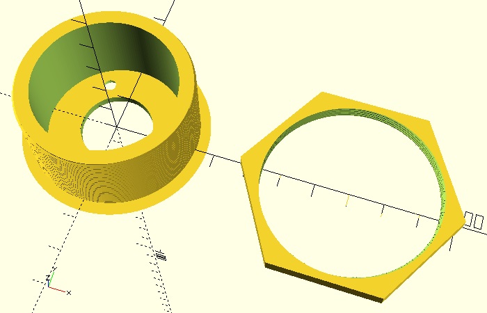

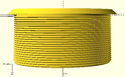

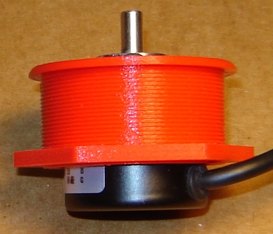

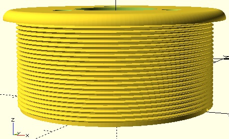

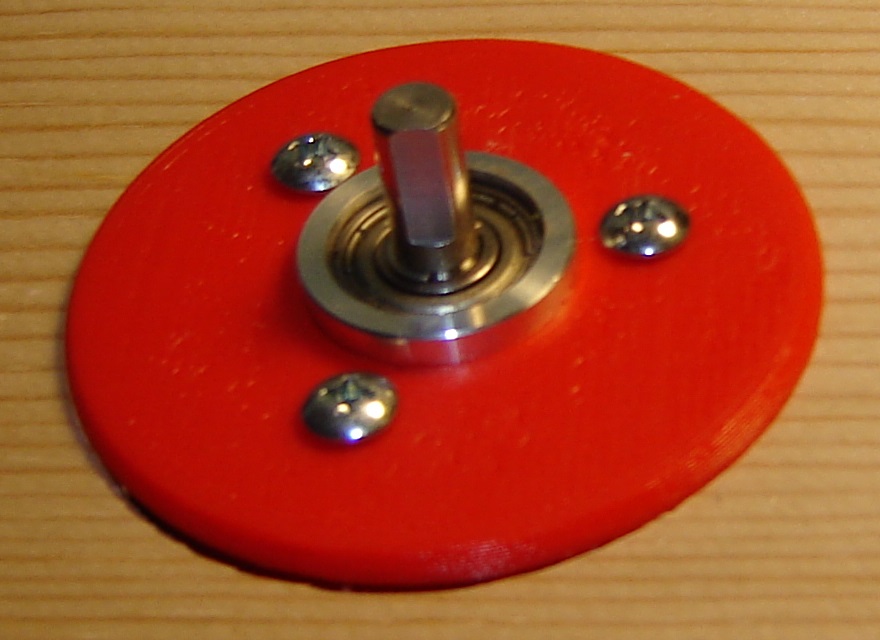

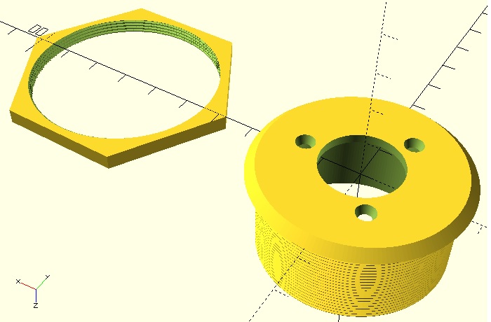

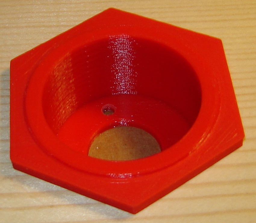

For anyone who missed Marsupial's  Build your own HID-mouse compatible spinner project, here are two parametric mounts created in OpenSCAD.
The first one has a chamfered bezel.
- The OpenSCAD code generates a model with both the nut and the mount.
- The .zip files linked below reorient the mount so it is print-ready. (i.e. face down)
- Be sure to download the .zip files for both the desired mount and the nut.  The mount .zip files do not include the nut.

H = sqrt(3)/2*P;
D_min = D_maj - 5*sqrt(3)/8*P;
for(i=[0:step:360-step])
hull()
for(j = [0,step])
rotate([0,0,(i+j)])
translate([D_maj/2,0,(i+j)/360*P])
screwthread_triangle(P);
translate([0,0,P/2])
cylinder(r=D_min/2,h=2*P,$fn=360/step,center=true);
module thread(P,D,h,step) {
for(i=[0:h/P])
translate([0,0,i*P])
screwthread_onerotation(P,D,step);
// Variables:
ThreadPitch = 1;          // Screw thread pitch
ThreadMajorDiameter = 49; // Screw thread major diameter
ThreadedRodHeight = 23.8; // Threaded rod height
ThreadStep = 2;           // Thread step size in degrees
PlateThick = 2.4;         // Mount plate/bezel thickness
BezelTopDia = 50;         // Bezel top diameter
BezelBottomDia = 55;      // Bezel bottom diameter
BezelCenterHole = 21;     // Bezel center hole
ScrewHoleBottom = 3.45;   // Bottom of screw hole diameter
ScrewHoleTop = 3.45;      // Top of screw hole diameter, for non-countersunk screws use same value as ScrewHoleBottom
ScrewDistance = 15;       // Distance from center of shaft to center of screw hole, usually 14 or 15
CenterCylinder = 40;      // Center cylinder diameter
NutDiameter = 64;         // Nut diameter (point-to-point)
NutThickness = 4;         // Nut thickness
WiggleRoom = 1.02;        // Scale multiplier for threaded rod X-axis and Y-axis that allows nut to turn easier
NutOffsetX = 70;          // X-axis offset distance of nut
// Number of fragments (polygon sides) used to render a full circle.
    $fn = 180; // Default = 180  Typical range = 6 - 360
    // 6 will render a circular hole as a hexagon, 8 will render a circular hole as an octagon.
    // Lower the number for faster rendering, raise the number for smoother rendering.
// Make the part:
// Mount
    // Bezel/mount plate minus screw holes and center hole
    difference() {
        translate ([0, 0, ThreadedRodHeight + (PlateThick/2)])
        cylinder (PlateThick, d1=BezelBottomDia, d2=BezelTopDia,center=true); // Bezel/mount plate
        rotate ([0, 0, 0])
        translate ([ScrewDistance, 0, 0])
        cylinder (PlateThick + 0.01, d1=ScrewHoleBottom, d2=ScrewHoleTop,center=true); // Screw hole 1
        rotate ([0, 0, 120])
        cylinder (PlateThick + 0.01, d1=ScrewHoleBottom, d2=ScrewHoleTop,center=true); // Screw hole 2
        rotate ([0, 0, 240])
        cylinder (PlateThick + 0.01, d1=ScrewHoleBottom, d2=ScrewHoleTop,center=true); // Screw hole 3
        cylinder (PlateThick + 0.1, d=BezelCenterHole,center=true); // Center hole
    } // End bezel/mount plate minus screw holes and center hole
    // Threaded rod minus center cylinder and trim top
    difference() {
        translate ([0, 0, ThreadPitch/2])
        thread(ThreadPitch, ThreadMajorDiameter, ThreadedRodHeight, ThreadStep); // Threaded rod
        translate ([0, 0, ThreadedRodHeight/2])
        cylinder (ThreadedRodHeight + 20, d=CenterCylinder,center=true); // Center cylinder
        translate ([0, 0, (ThreadedRodHeight * 1.5) + 0.01])
        cube([ThreadMajorDiameter + 20, ThreadMajorDiameter + 20, ThreadedRodHeight], center=true); // Trim top
    } // End threaded rod minus center cylinder and trim top
// Nut
difference() { // Nut body minus threaded rod
    hull() {  // Nut Body
    translate ([NutOffsetX, 0, NutThickness/2])
    rotate ([0, 0, 0])
    translate ([NutDiameter/2, 0, 0])
    cylinder (NutThickness, d = 0.01, center=true);
    rotate ([0, 0, 60])
    rotate ([0, 0, 180])
    rotate ([0, 0, 300])
    } // End nut body
    translate ([NutOffsetX, 0, - ThreadPitch])
    scale([WiggleRoom, WiggleRoom, 1])
} // End nut body minus threaded rod
The second one  has a rounded bezel.
Code: [Select]
// Rotary encoder mount and nut created using thread library found at https://www.thingiverse.com/thing:31363
// Metric Screw Thread Library
// by Maximilian Karl <karlma@in.tum.de> (2012)
// only use module thread(P,D,h,step)
// with the parameters:
// P    - screw thread pitch
// D    - screw thread major diameter
// h    - screw thread height
// step - step size in degree
module screwthread_triangle(P) {
difference() {
translate([-sqrt(3)/3*P+sqrt(3)/2*P/8,0,0])
rotate([90,0,0])
cylinder(r=sqrt(3)/3*P,h=0.00001,$fn=3,center=true);
translate([0,-P/2,-P/2])
cube([P,P,P]);
module screwthread_onerotation(P,D_maj,step) {
H = sqrt(3)/2*P;
hull()
for(j = [0,step])
rotate([0,0,(i+j)])
for(i=[0:h/P])
// Variables:
Roundover = 2.2;          // Bezel roundover, must be less than PlateThick
BezelDia = 55;            // Bezel diameter
// Make the part:
// Mount
    difference() {
        minkowski() // Apply roundover to cylinder
        translate ([0, 0, ThreadedRodHeight])
        cylinder(d=(BezelDia)-(Roundover*2),h=(PlateThick) - Roundover); // Bezel/mount plate body
        sphere(r=Roundover); // Roundover
        cube([BezelDia + 20, BezelDia + 20, ThreadedRodHeight], center=true); // Trim bottom of bezel/mount plate body
        rotate ([0, 0, 0])
    difference() {
// Nut
    rotate ([0, 0, 0])
    rotate ([0, 0, 60])
    } // End nut body
Installation instructions:
1. Drill a 2"/50mm hole in your 3/4" thick (or less) control panel.
2. Fasten the mount to the CP using the nut.
- Keep in mind that it is very easy to cross-thread if the nut isn't kept level.
- Use the "turn the nut backward until you hear a click then turn it forward" trick to avoid cross-threading.
3. Fasten the encoder to the mount using M3-0.5 x 8mm screws.
4. Install the knob.
Links to .ZIPped, ready-to-print .STL files made using the OpenSCAD code above:
    Chamfered mount - http://forum.arcadecontrols.com/index.php?action=dlattach;topic=164992.0;attach=387887
    Nut - http://forum.arcadecontrols.com/index.php?action=dlattach;topic=164992.0;attach=387888
    Roundover mount - http://forum.arcadecontrols.com/index.php?action=dlattach;topic=164992.0;attach=387889
*** Be sure to download both the desired mount and the nut. (the mount .zip files do not include the nut) ***
« Last Edit: May 17, 2021, 03:36:15 am by PL1 »

« Reply #1115 on: June 30, 2021, 07:46:18 am »
First large format print complete (clear petg).  Not as oem looking as the design in my head, but it got done.  I did concentric infill at just under 100% hoping it would come out clearer.  It isn't clear, but it's solid as a rock.  Someday I'll graduate from Tinkercad to Fusion.
« Last Edit: June 30, 2021, 08:54:57 am by BadMouth »
So my understanding is the best you are going to get out of clear filament is sort of opaque frosted and the way you do that is with a lot of sanding and polishing.
