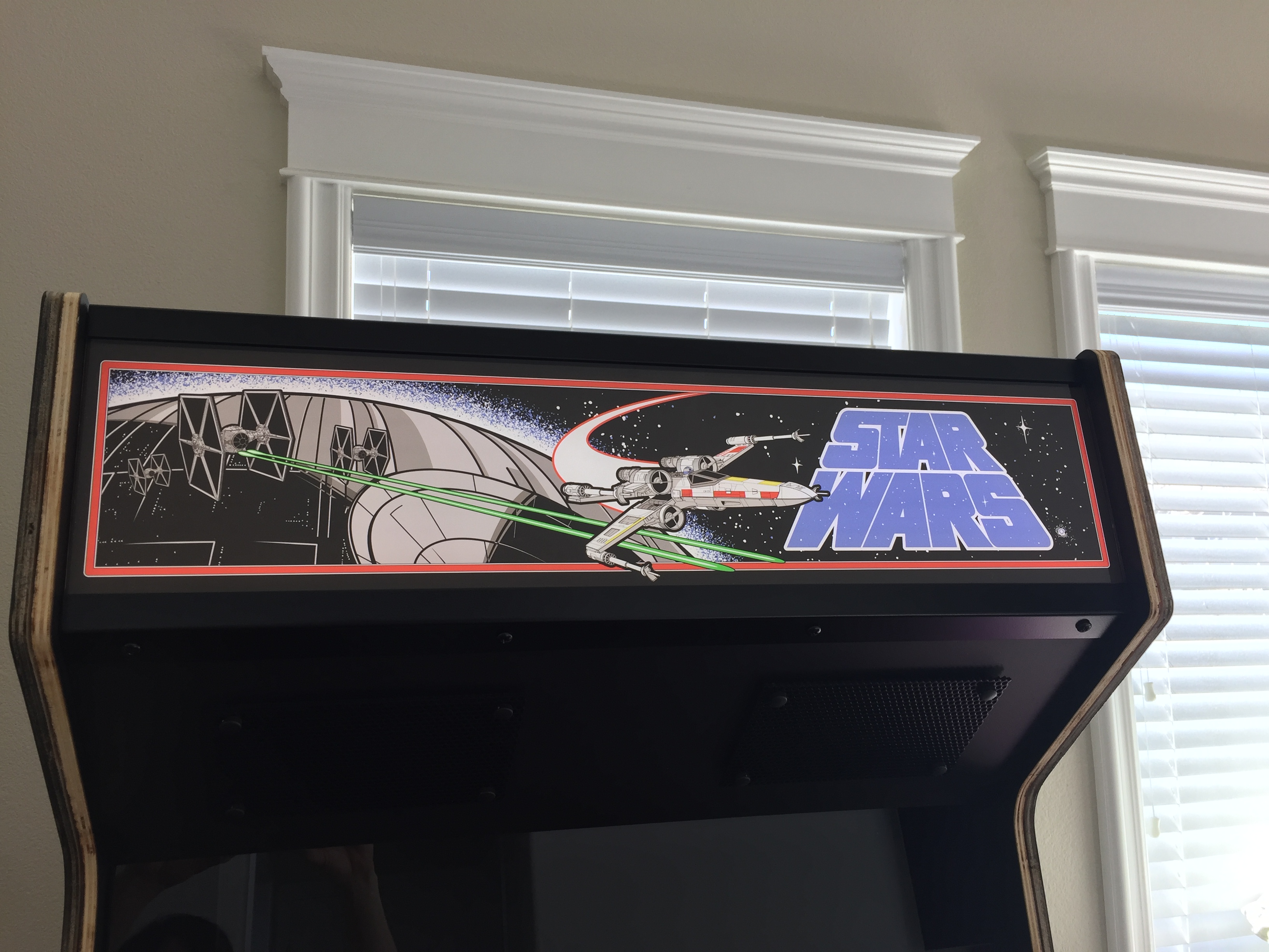

Ok, gotta get this build out of hibernation and finally finish it! Here's a marquee I whipped up. I put the logo on the side like the original Star Wars movie posters. What do you think? Anything you would change? Thanks for looking  :)

Superb marquee graphic, I like it a lot, great drawing style, nice!
Most marquees I've seen usually place the title in the center for maximum attention / focus point for your eye, but I totally understand how that would disturb the action scenery of the Tie fighters chasing the X Wing. I wonder how it looks like if you mirror the picture: the title on the left and action on the right (so the fighters flying right to left). But maybe Im just nagging here idk, bc it looks pretty awesome as is!!
Also, and this is just personal, I would change the astromechs reds to blue to like r2d2, but of course it doesnt need to be Luke's X-Wing.

Ah, how could I forget R2?! Good catch lol. Yeah, I agree about the dogfight being the main focus. I thought about putting the title in the center, but I couldn't come up with anything I liked except for slapping a tie and x-wing on either side. I don't know, maybe I should tinker with it a bit more.
Here are a few variations reflecting your suggestions. Also, I thought about taking out the border. Better? Worse? Doesn't matter?

I like the look of no border :)  :applaud: :applaud:

I would go for border + logo on the right.

Now that you have mirrored it I must admit I like it better originally after all (with the title on the right side).
I like your marquee either with or without the red border. Losing the border gives a slightly less cramped / more spacious feeling, but I do like how the laser shots and X-Wing pops over the red border. I also wonder how the red border would look like without the thine white out lining.

It's hard to choose cause I like all of them. That's probably because there just isn't that much difference between them lol. For reference, the below pic is how it will look installed. The excess black on top and bottom will be covered by the retainers.

Ditch the words "classic arcade". It is fairly obvious what it is just from looking at it.
My television doesn't say "television" on the front.
My car doesn't say "car" on the front.

1. The red border looks too wide.
2. Do you want both red and white strokes around the text or would it look better with just the white?

Thinner border without red in title:
In this one the border is the same size but I thinned out the red. Took out the red from the title, too.
I think the title without the red looks good, and between the two here I like the second.

Text looks great.   :cheers:
The width of the red part of the border looks good, but the red on black on white border is stll the same width as the original border.
You may want to reduce the width of the black and white so the red to black to white border width proportions are more like the original.

Since the latest is 50% of original border width, you might want to try 20%, 30%, or 40%.
A little bit of red goes a long way on that dark backround and you want the viewer's attention drawn to the ships, lasers, and text instead of the border, right?
P.S. White or yelow/gold for the text outline?

Here's the border at 40%. Any smaller than that and it looks like a solid red line, which is what I was trying to avoid with the black and white. I may as well change the design of the border altogether or change the color, which I am open to btw. I agree with you, the red does stand out, and I don't want it to have too much of a presence as to distract from the rest of the marquee.

In place of.
There's already quite a bit of white from the stars, Death Star backlight, X-wing, and "swoop".

I like the second one of these. In the last ones the border is too thin to my taste.

In the end I've decided to keep the red border, but I did thin it 80% from the original one. I really appreciate the suggestions from everyone.  I've sent this file as well as the side art over to Brad for printing. Looking forward to getting it installed!

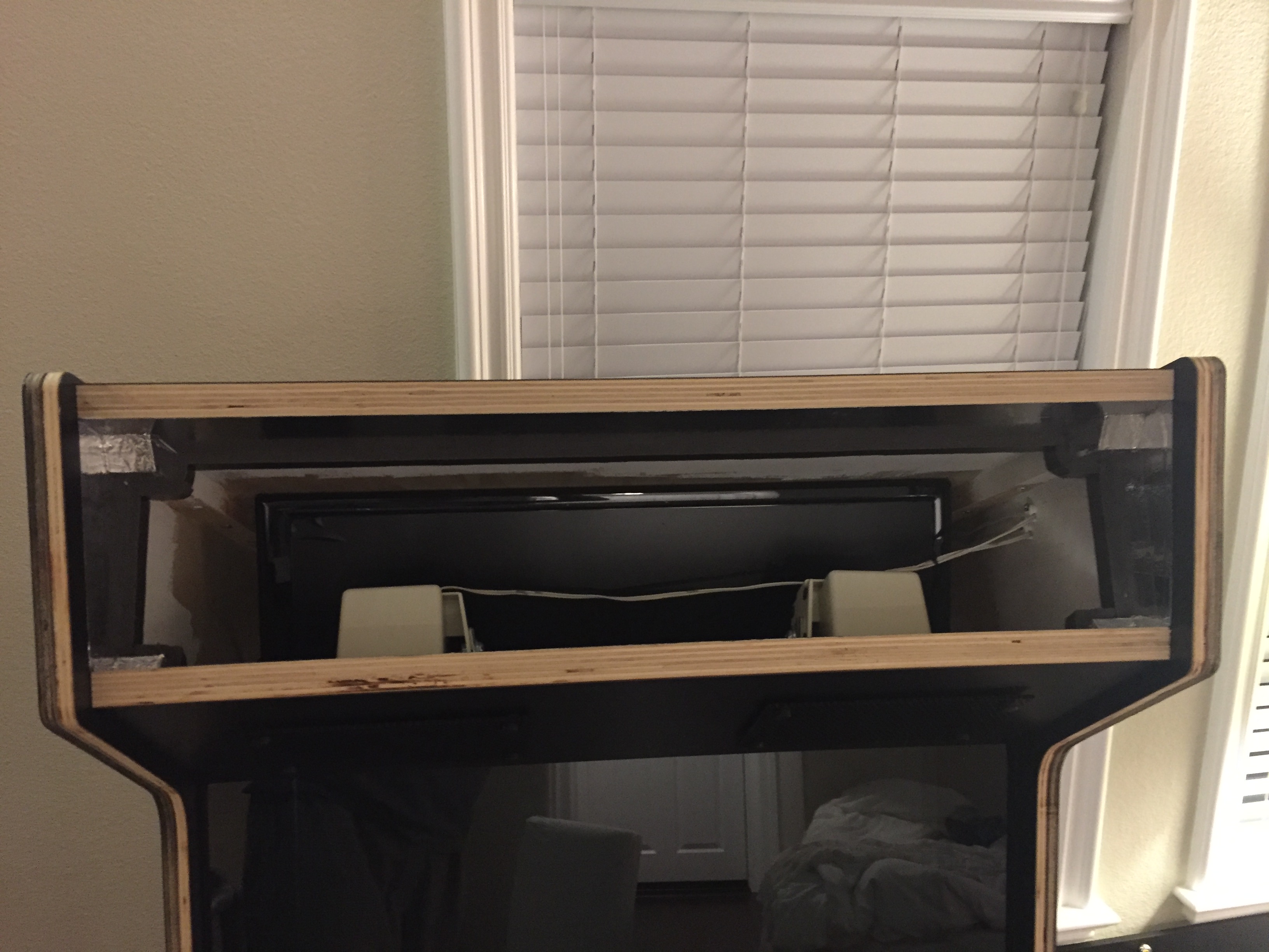

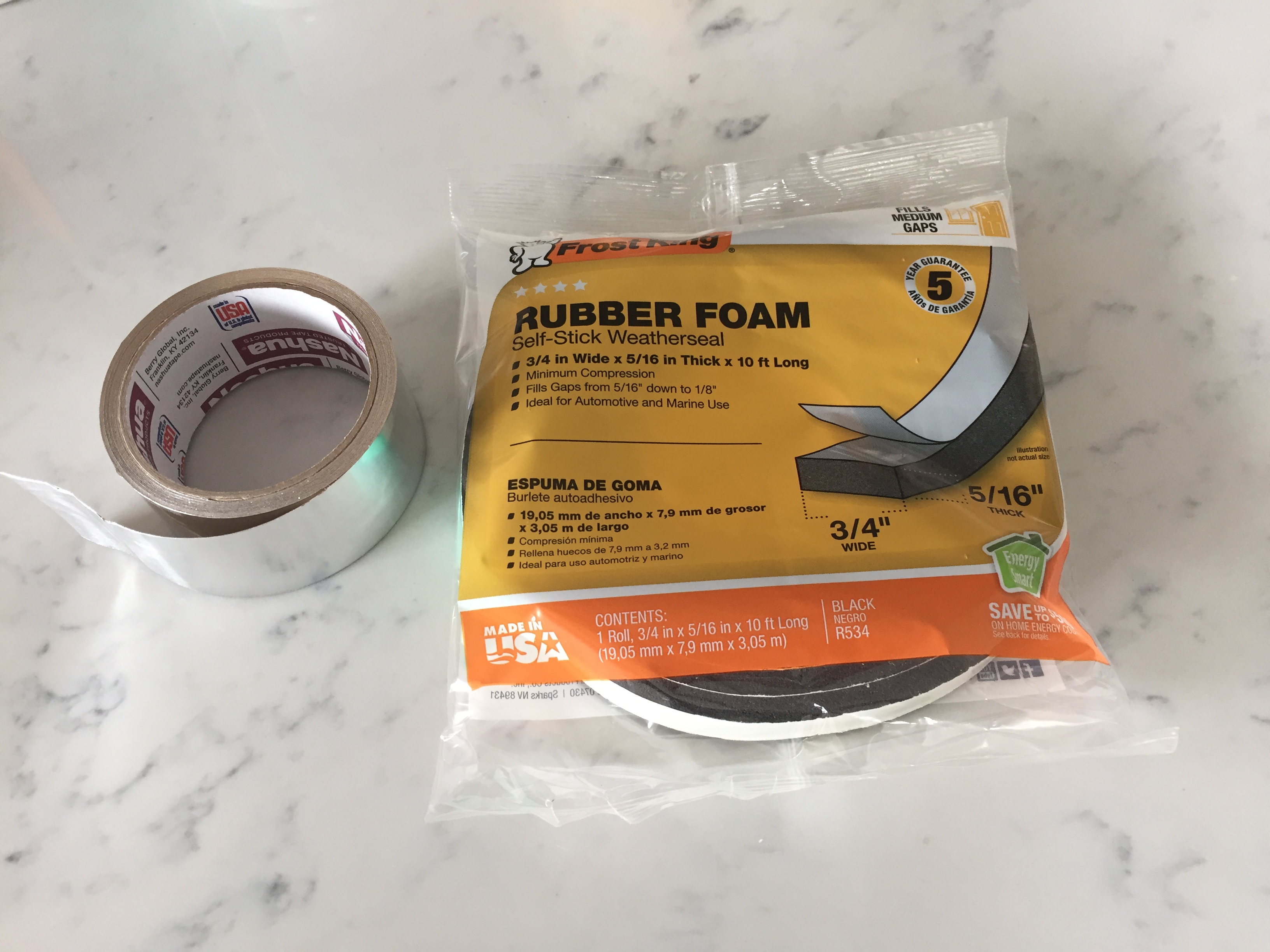

Hey guys, I'm back with another update. I'm excited but also sad to finally be nearing completion of this thing; I feel like I won't know what to do with myself during my spare time when this is over!

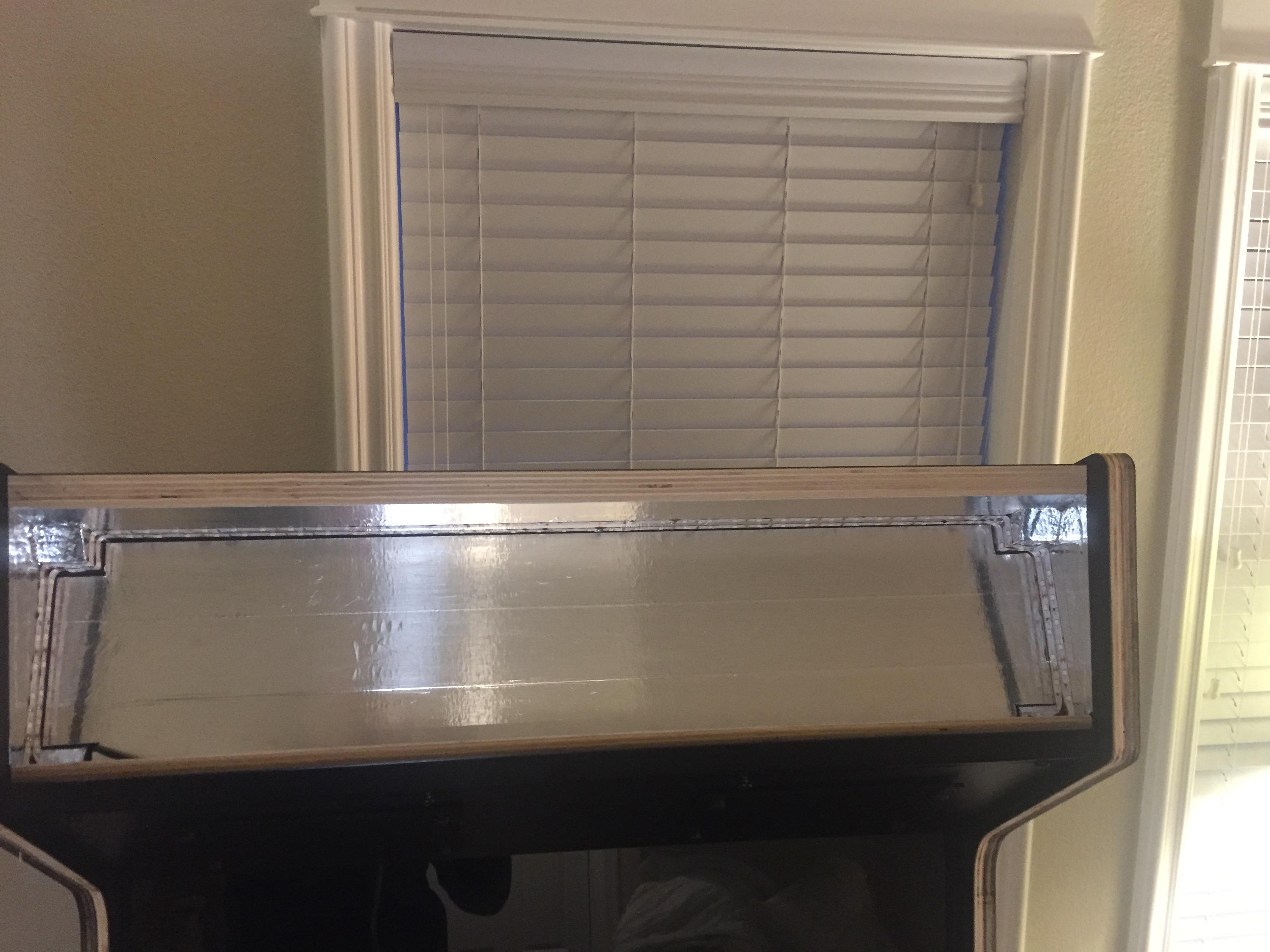

With the artwork in I got to preparing the marquee area. I hadn't closed it off or covered the speakers yet, but I didn't want any light to shine through the speaker grills. My problem was that with the TV extending all the way to the top of the inner cabinet (you'll be able to see this in pictures below) there is no room to access the speakers from behind in case they needed attention. In addition, I wanted an enclosed box to diffuse and reflect the light behind the marquee so that it would light up evenly. So, I bought some foil tape and rubber foam weather stripping:
Next, with 1/8" MDF I measured and cut out a piece that would work as the back to the marquee box. I scribed the corners to accommodate for the batons. Then I covered the piece with foil tape:

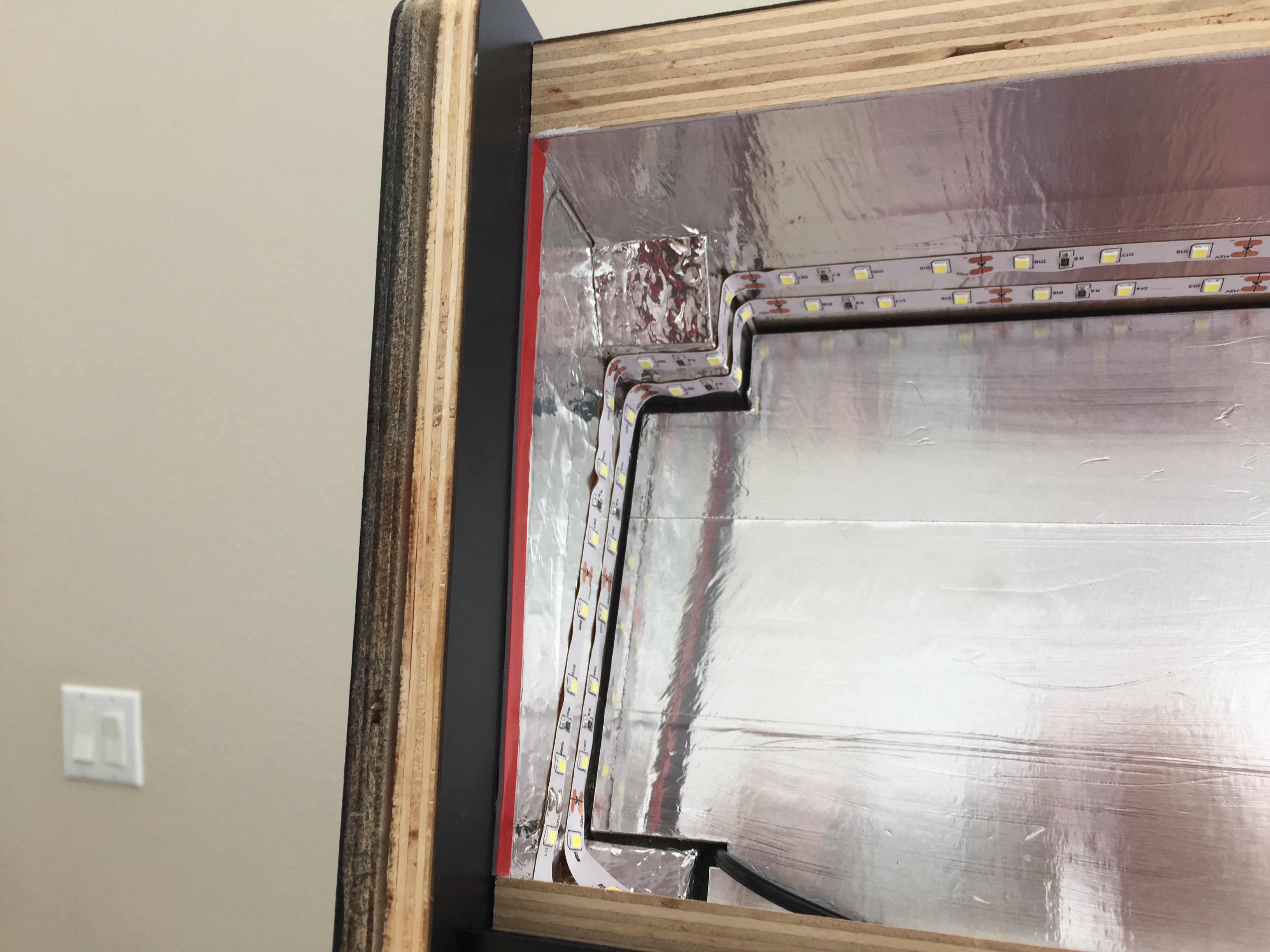

I then took the weather stripping and created a barrier outlining the posterior portion of the marquee area to which the back piece could abut, and covered the sides, top, and bottom with foil tape:
Gravity holds the board in place as it leans toward the back of the cabinet. The weather stripping is soft enough so that there aren't any cracks for light to sneak through while also eliminating the possibility of the board vibrating from sound. It's easily removable in case I have to work on the speakers. Problem solved!
I bought some LED tape and followed as a guide for installing it. I like how the LED tape kit comes with a dimmer so that the brightness can be adjusted to my liking.
Here's how it looked at that point:

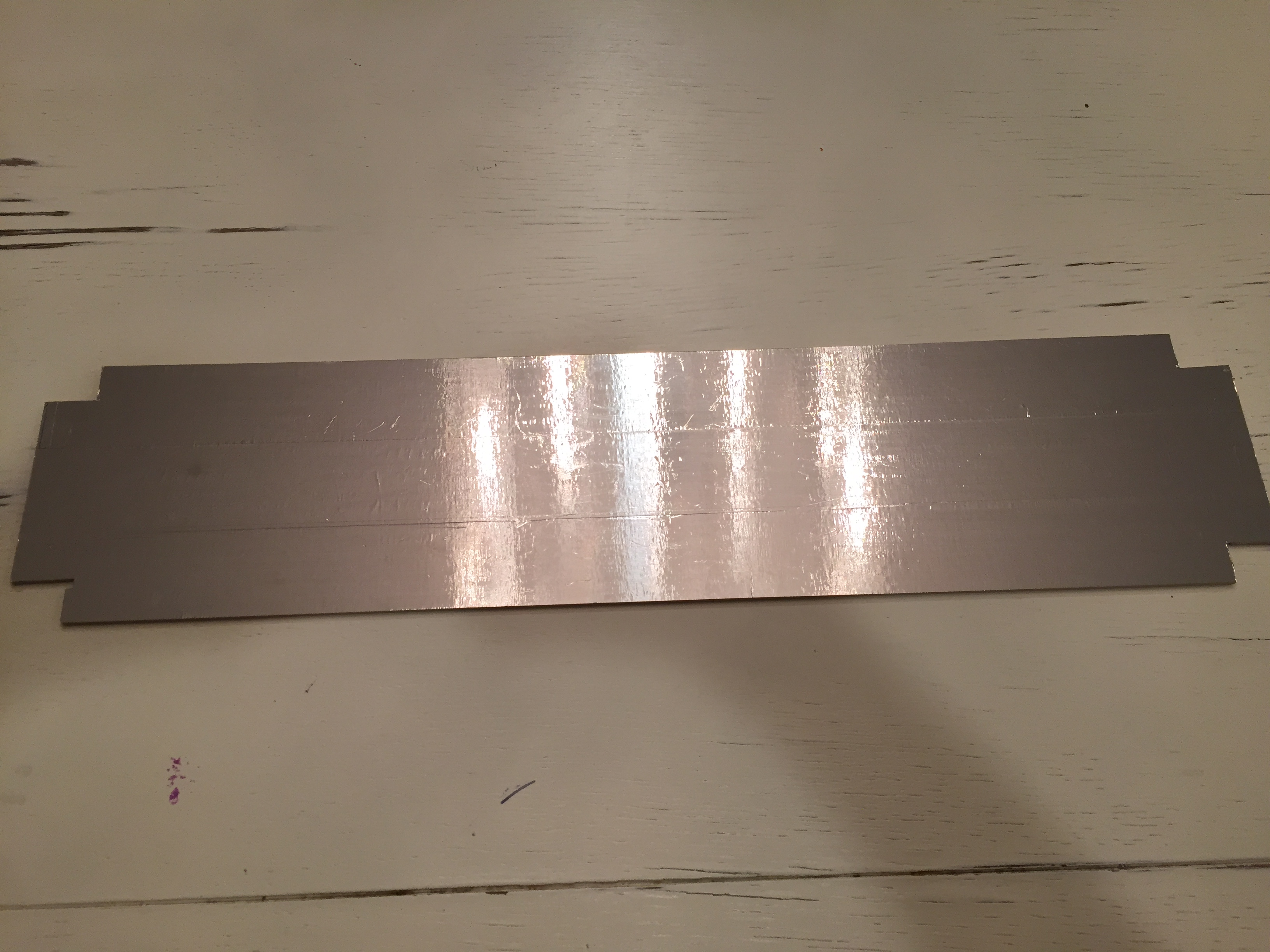

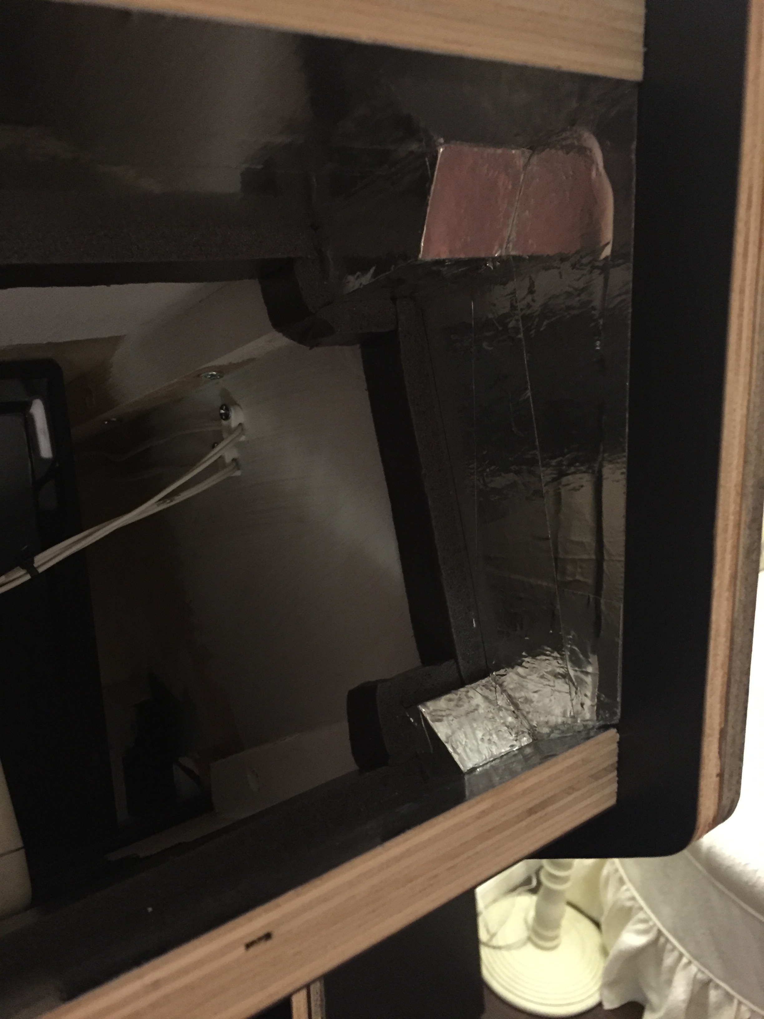

Now that the marquee box was finished there was another dilemma: light bleeding out of the sides of the marquee. I read that others have used the same foam weather stripping shown above, so I bought the thinnest I could find (3/16" thick) and gave it a try. It worked very well, but I wasn't satisfied with it because it created shadow lines on either side of the lit marquee that were each 3/16" thick. I needed something thinner, but not too thin, so I tried some of this foam mounting tape I had laying around.

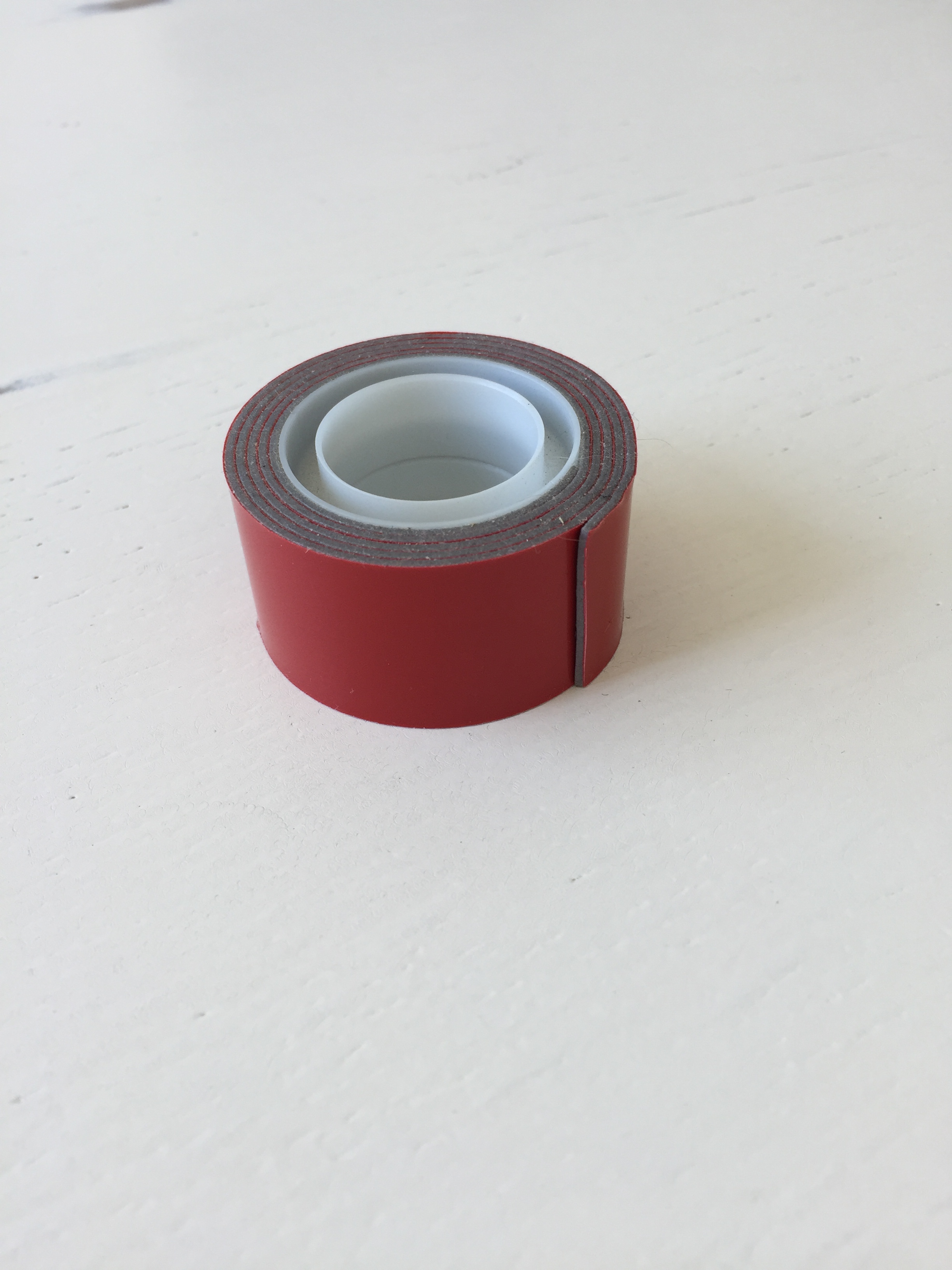

I laid out a strip on wax paper, cut strips about 1/4" wide, and carefully adhered them to the sides of the cabinet just behind where the marquee sits. Here's a pic showing that.
I removed the red backing prior to placing the marquee. The color of the tape is grey. I thought it might be too thin, but it worked perfectly! No shadows, no light bleed.

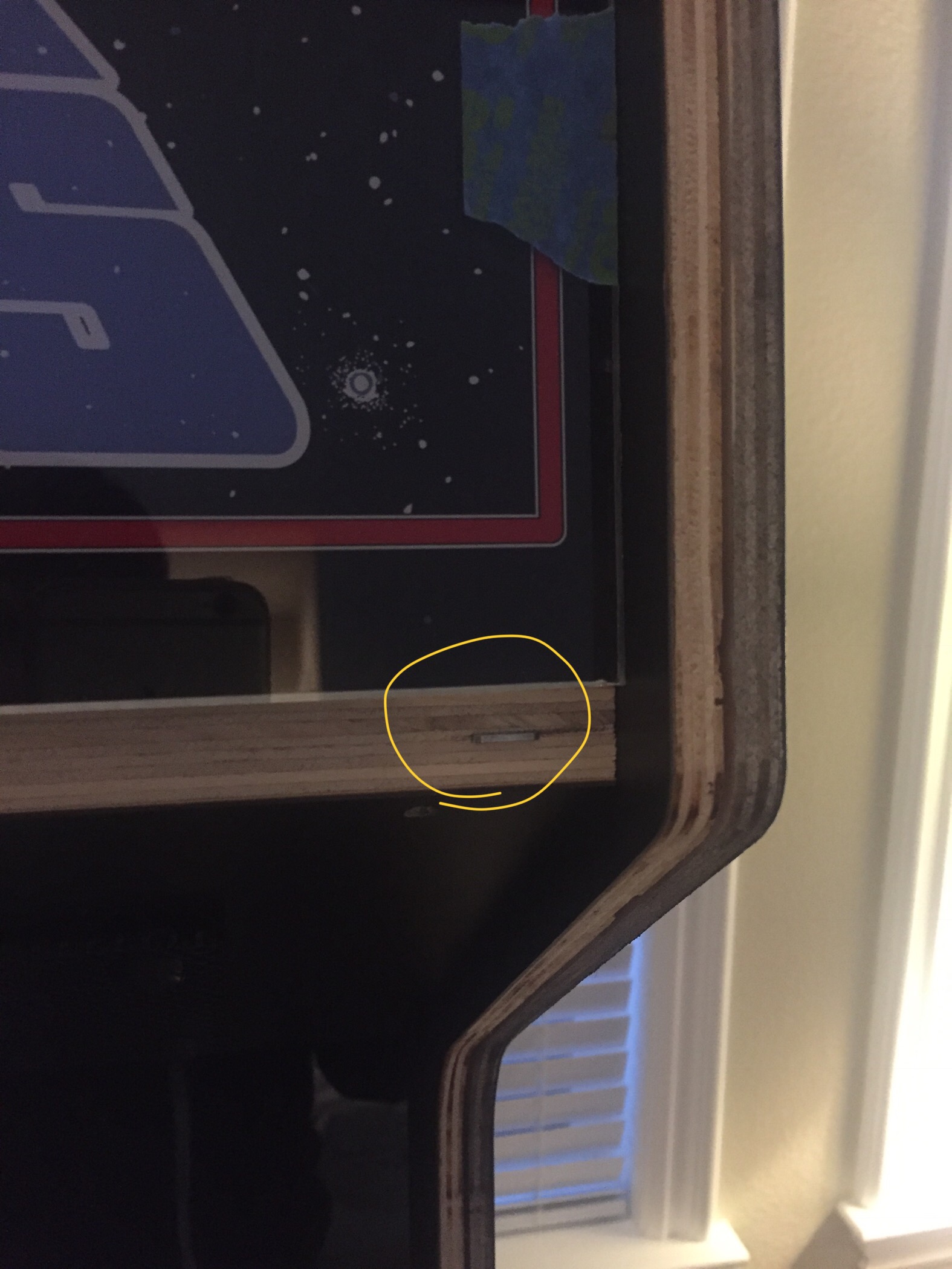

Finally, to ensure the marquee was centered vertically I held it in position and marked the panel just below it with a pencil. Then with that line as a guide I took a staple gun and drove staples on both sides of the lower panel for the marquee to rest on. I made sure that the staples didn't stick out beyond the thickness of the marquee.
Here's one side with a staple:
The marquee resting on the staple:
With the marquee sitting in place on the staples it was easy to position the marquee retainers and use a Vix-bit (celf-centering bit) to predrill holes for them. I then fastened them down with screws that were spray-painted black.
Here's the completed marquee!
Oh, I almost forgot. The marquee was reverse printed by Lucian045. I purchased 3/16" Plexiglass from a local glass shop and followed to adhere the "stickers." It was a little more difficult than I anticipated but it turned out great!
