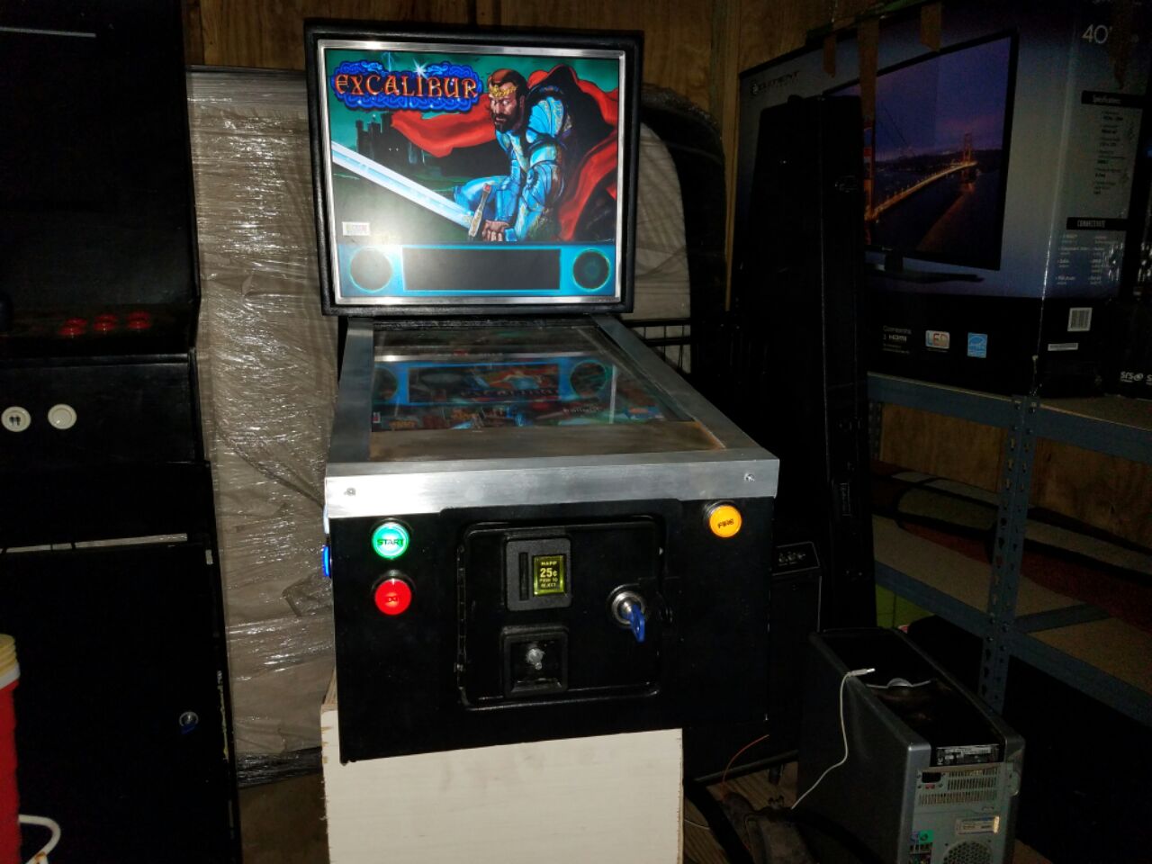

So the time has come to begin my mini pin build.

So I found this 22" (I think) at goodwill
Picked up a cheap 19" for the backglass on ebay
Ordered some Cheap led pushbuttons. And a cheapo encoder on ebay.
Also the pc (don't be hating it does what it needs to)

First thing was to decase the monitor.
Got a sheet of 1/2" blondewood from lowes. I was going to go with mdf but this lowes didn't carry it. But this word seemed pretty cool. I guess it's like plywood but sanded and primed.
Got to love my sloppy lines. Post production will fix that.
Coin door measurement (I'm making a small coin door)
More sloppy lines. ( Couldn't find my jig so I winged it)
I decided to not go with a removable lock down bar. Instead just a palm rest.

The backbox 17" x 14" x 4.5"
Still planning on making some hinges.
(The front L brackets have been removed once the liquid nails dried)

Got some bondo. First time using the stuff. Nobody  told me how fast this stuff hardens.
Also cut a hole for the power and video cables from the backbox.
Sanded a bit.
Flipper button placement. Buttons came out a little closer together  than I hoped, but it's fine.
The side rails should cover that slight curve in the side. (I can't cut straight)

Got some more done today.
My backdoor
The hinges

I got the hinges sorted out.

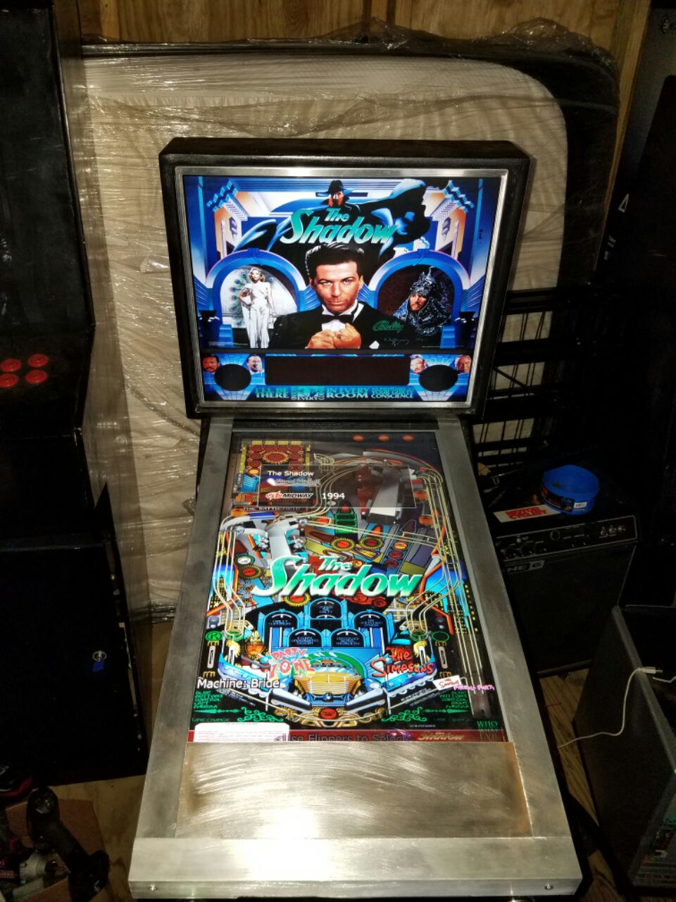

So I got a coat of paint on. That's right I'm a sprayer.

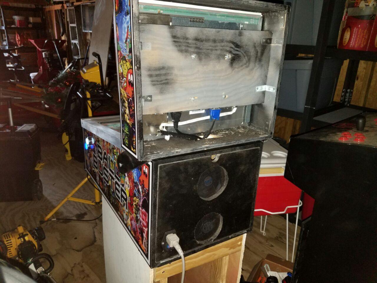

I was going to buy some speakers and an amp on ebay until I saw my old motorcycle speakers and amp while working out in the shed.
So I finally figured out where I was going to mount them. Under the backbox.

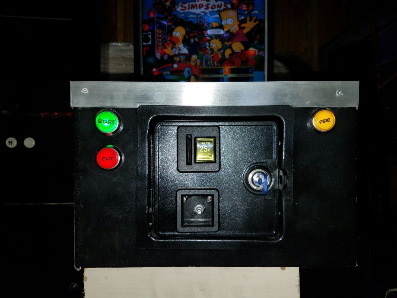

I bought a small coin access door on ebay that was the perfect size. Since no actual coin door was small enough. Unless I went with a roll down.
I then cut out and drilled holes for the coin entry and coin reject bezels. I don't have the proper tools, so I drilled a bunch of holes and used a steel file.
Re: Ball Buster - A Gingerballs Tribute

I put some magnets on the back door.
Sprayed the coin door to cover my scratches.
Attached the door.
Monitors in place.

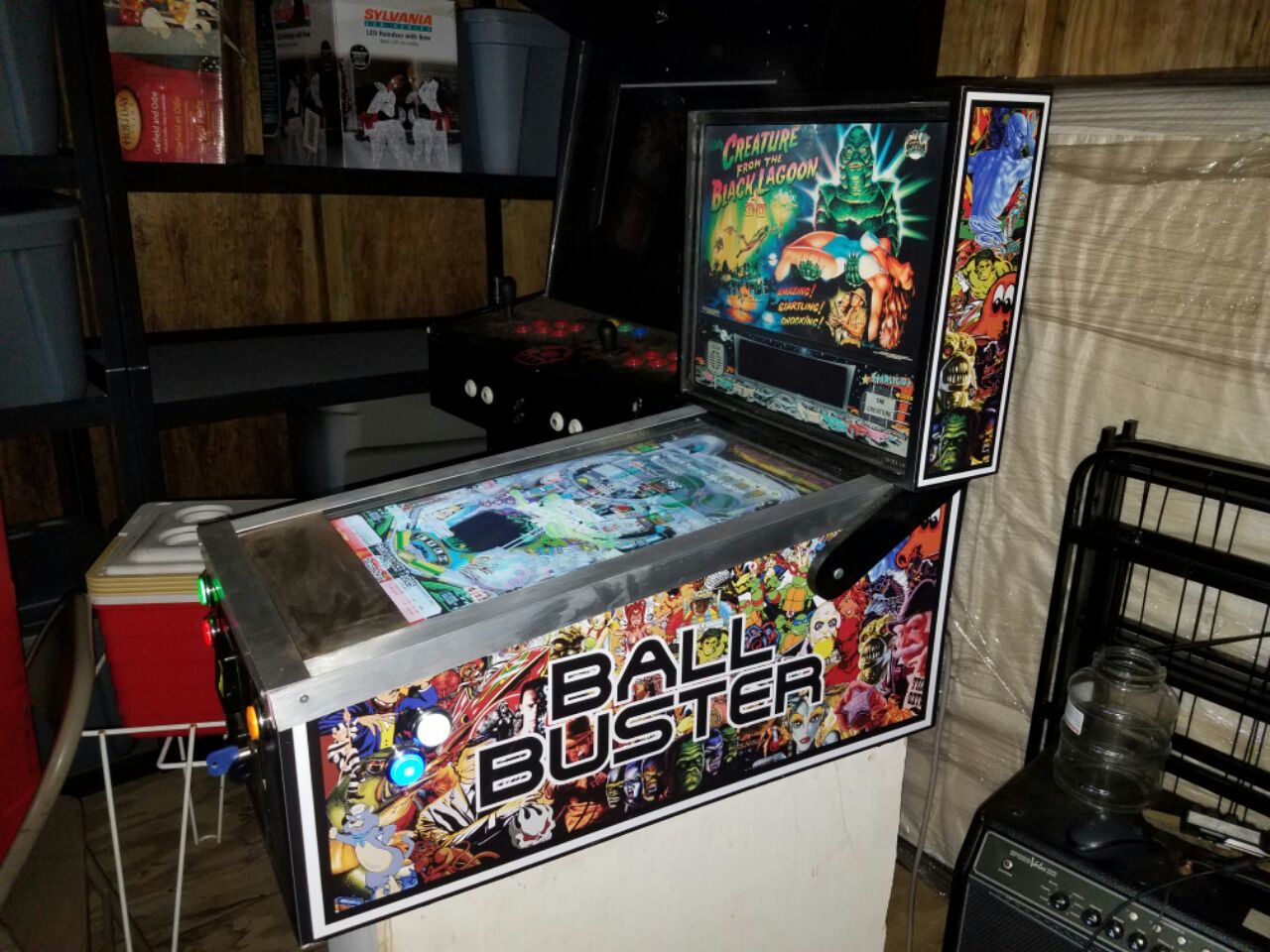

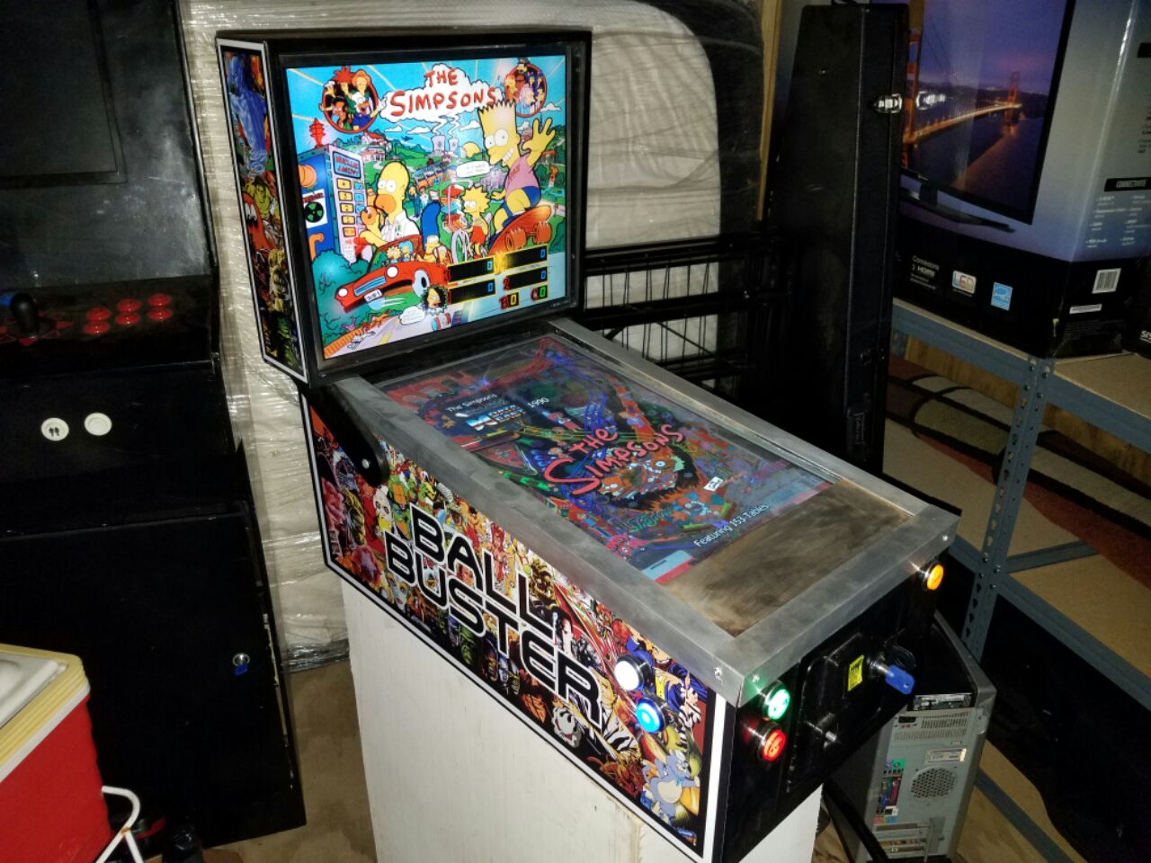

Stuff to do:
- Add side rails
- add art
- install pc
- wire buttons
- glass
- make power button
- cooling

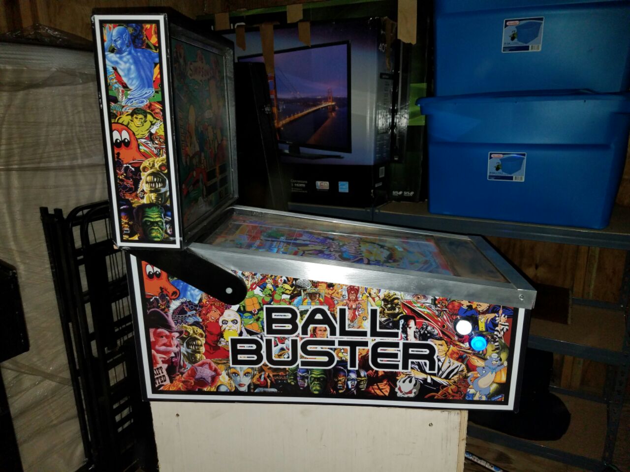

So I made another poor planning mistake. The side rails I was planning on using need to be a 1" L to reach the edge of the screen, but if I do one across the front it will overlap the coin door and top buttons..
I could get smaller ones but then John might get mad at the gap to the monitor. Or I can move the buttons and coin door a little lower and screw everything up.. any thoughts?

Just rail the opening part, not the entire top box?

That could work. I've also considered doing a black poster board frame inside around the edges of the monitors behind the glass.

I wanted to do the L rails the way you did it. On the sides and one on the front, and a piece of metal on my lock down area.

Not really. Still waiting on the art. I haven't done a whole lot in a while. I can share the art if you are ready to start hating this project. But I will attach a couple.
Waiting on Ken?    And I love everything about this project so far. Any issues with the rear door and those USB ports?
Yeah. I plan on putting an upper fan on the rear door as well. And remember painting it. The usb ports aren't attached to
Really just kinda dangling from the motherboard.

Alright so I know there is a general hatred for collage art, But i did it anyway. So feel free to hit the dislike button.
« Reply #38 on: September 17, 2016, 09:32:40 am »
I like it, at least it's a mash up of pinball art. Hard edges? Thats.........BALLSY  :laugh2:
