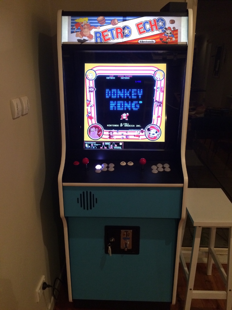

OK, a progress report.
Took the painters tape off the front of the cabinet, and found that the paint had bled underneath:
So I taped it up again and touched up the paintwork.
Then I installed the t-moulding. Put a cloth around the end of a hammer so I didn't damage it - felt very Fix-it-Felix when I  was doing this! What a difference it makes to the look of a cabinet:

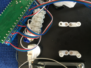

Wired up the buttons on the control panel into the Ultra Stik 360s:

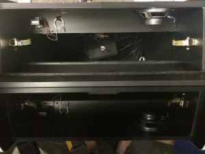

Built the power panel - the IEC is pass through to a smart power board, which will turn on all devices when the PC power is turned on. The red button will be wired into the PC's power button, so I can start the PC from outside the cab.
Installed the speaker - a cheap 5" speaker from Jaycar electronics, using flyscreen as mesh in front of it. I'm using an old Logitech Z323 speaker system to power this, it connects into the back of the Logitech subwoofer. I've taken the satellite speakers apart to salvage the amp and volume control, but don't know whether I'm going to make the volume control accessible from outside the cabinet, or only inside - mostly because I can't think where to mount a volume control on the outside of the cabinet without it spoiling the lines of the cabinet.
Then I turned my attention to a problem I had to solve. The TV that I bought was a 40" Soniq LCD, refurbished stock from JB Hi-Fi online for $250. Unfortunately, it doesn't turn on automatically when power is applied. No options in the menus to do so, even after downloading and applying the firmware update from the Quatius ftp site.
I knew I couldn't live with having to use the remote control every time I wanted to use the cabinet, so I started looking for a way to emulate the remote control signal from the PC. I came across a product "USB Infrared Toy v2" at dangerousprototypes.com, which looked like it would do the job, and found I could order it from SeeedStudio for $22 delivered.
So I plugged it in to the USB port of my PC and installed the driver and software package. I used the record utility to generate a file of the remote control power button being pressed, and then used the playback utility to play back this file with the IR Toy pointed at the TV. Success - the TV would power on and off. I'll be able to script this to run when the PC starts up,  to power on the TV as part of the cabinet startup.
Happy I had a solution, I attached the IR Toy to the front of the TV:

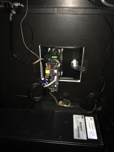

Next problem, the coin acceptor. I bought the coin door and a Wei-Ya acceptor from Arcade Bits, before I had done any investigation in to how to hook it up. At the moment I don't have a separate keyboard encoder, only the interface on the Ultra Stik 360s, and it doesn't appear I can connect the acceptor to them. Looking at the coin mechanism, I could see that after a coin was validated, it would cause a plastic tab at the rear of the acceptor to rise when the coin dropped out of the acceptor. Using inspiration from this forum, I got out my hot glue gun, and stuck a microswitch in a place that it would get triggered by this action:
It turned out I glued it a bit too close - the coin would get accepted, trigger the switch, but not be able to drop out. But a couple of minutes with a file, and that was all fixed. So now I can connect one of the U360 inputs to this switch to enable the PC to register credits from coin insertion.
And I connected a coin counter as well:
Lastly, I got some foam board to use as bezel around the visible area of the LCD. I'm going to set up the display as 1080x1080, so I only want to be able to see a central square. I cut the board to size, and spray painted it flat black:
 The sewer drain cover won't be the same for a while:

Tried to tidy up the wiring inside the cabinet:
Fitted the control panel lockdown latches. Not very happy with these, they flip out horizontally in to the cabinet, and the right hand one gets too close to the player 2 buttons & wiring. It all works, but I have to be quite careful when putting the panel in place, and when taking it out. I may have to replace then, particularly if I can find something that stays more vertical when disengaging.
One of the wiring tasks I have left to do is to put some kind of quick connects on the wires that go from the control panel to the coin mech switch. I was wondering if you could use the latches to complete the circuit between wires going from one half of the latch to the coin mech switch, and the other half of the latch to the U360? Haven't seen anyone else try this...

Next I decided to try out some new marquee artwork. I'm going to call the cabinet Retro Echo - it echoes a previous time, is a smaller version of the original, and makes the sounds of yesteryear. And given it's a Nintendo based cab, I tried a donkey kong style to the marquee. I tried to do a mashup of the Double Donkey Kong style marquee (because I like the colours), with Donkey Kong and Mario images from the DK sideart (because I prefer the images of Mario in colour and DK holding Pauline).
I used the Jumpman font for the text, but had trouble with it. In Word, I used the text effects to put a double outline round the letters; but wherever there were two straight lines coming together in a point, the outline was corrupting. I ended up exporting this corrupted text into Paint, touching up the corrupted areas, then importing this text into Inkscape and using the trace function to convert it back into vector art. It ended up looking OK, but more work than I expected.
I quite like it, but the text isn't big enough and isn't centered. And now I've put it on the cabinet, I think I'll probably end up ditching Mario and DK - looks OK while I'm playing Donkey Kong, but I think I need a more generic marquee to go with all the other games. But still thinking about this.
Next step was to get my software up and running. Windows 10 installed, and latest Nvidia graphics drivers. I used the Nvidia utility to set a custom display mode that was rotated 90 degrees, and 1080x1080 resolution. I was concerned that there didn't seem to be a way to have this non-centered on the LCD, but luckily centred was in the perfect spot. I know I could have used retroarch to give more control over placement on the screen, but the great thing about having this done at the OS level, is that every app should use this resolution.
Then I installed the Ultimarc software for theU360s. I wasn't able to find the firmware on the Ultimarc site, so checked with Andy. Apparently newer U360s need different firmware from the old U360s, so good to check - he sent me the right ufw file.
I decided to use Attract Mode as my front end. I know a lot of people here like Mala, but it doesn't appear to have any active development any more; and I don't like Hyperspin for a cab. And Attract Mode has got plugins for U360s and LED Blinky, has a simple interface, and supports shaders - and I like that it has active development.
I put a set of MAME 0.161 files and ROMs on the cab, no CHDs (if I find a CHD game I really want, I'll copy it) and then cut the set down with MCM Plus to remove all preliminary drivers, mechanical, not working, mature, mahjong,  utilities, casino, print club, tabletop, and foreign language quiz games. I've seen the arguments about the pros and cons of keeping everything on the cab or not, but I know I don't want to play these, and I want everything to fit on my SSD. Total space for these ROMs is 13GB.
Installed Autohotkey, and a simple script to pause mame when pressing my admin button, or exit back to Attract Mode if pressed for more than 3 seconds. I want to do more in this script, but haven't investigated yet. It would be good to be able to control volume with admin+ joy up/down, and reset the game (F3) if I hit the admin button 3 times in quick succession.
Then I converted the MAMEUI "Golden Age" game list into Attract Mode format, and did the same for the "BYOAC Top 100" list. I thought those would be a good starting point for cut down lists, before I get a chance to hand craft a list of my own favourites.
And then I moved the cabinet from the garage into the house:
And despite needing to sort the artwork, and fix a couple of wiring issues, am a proud owner of my very own arcade cabinet.

This cab needs some artwork. Like bad. Bezel art, CPO art, Side-Art...something. Heck, even a Coin decal would help.
I'd definitely ditch the virtual bezels for a real bezel too. Keep the colors from the marquee throughout the bezel. (Blue, white, red)
And +1 what Chance said about getting a reverse printed Marquee.
And if you really don't want to wait, you can get very reasonably priced translite prints too. However, that does not include shipping to Europe I'm sure.
