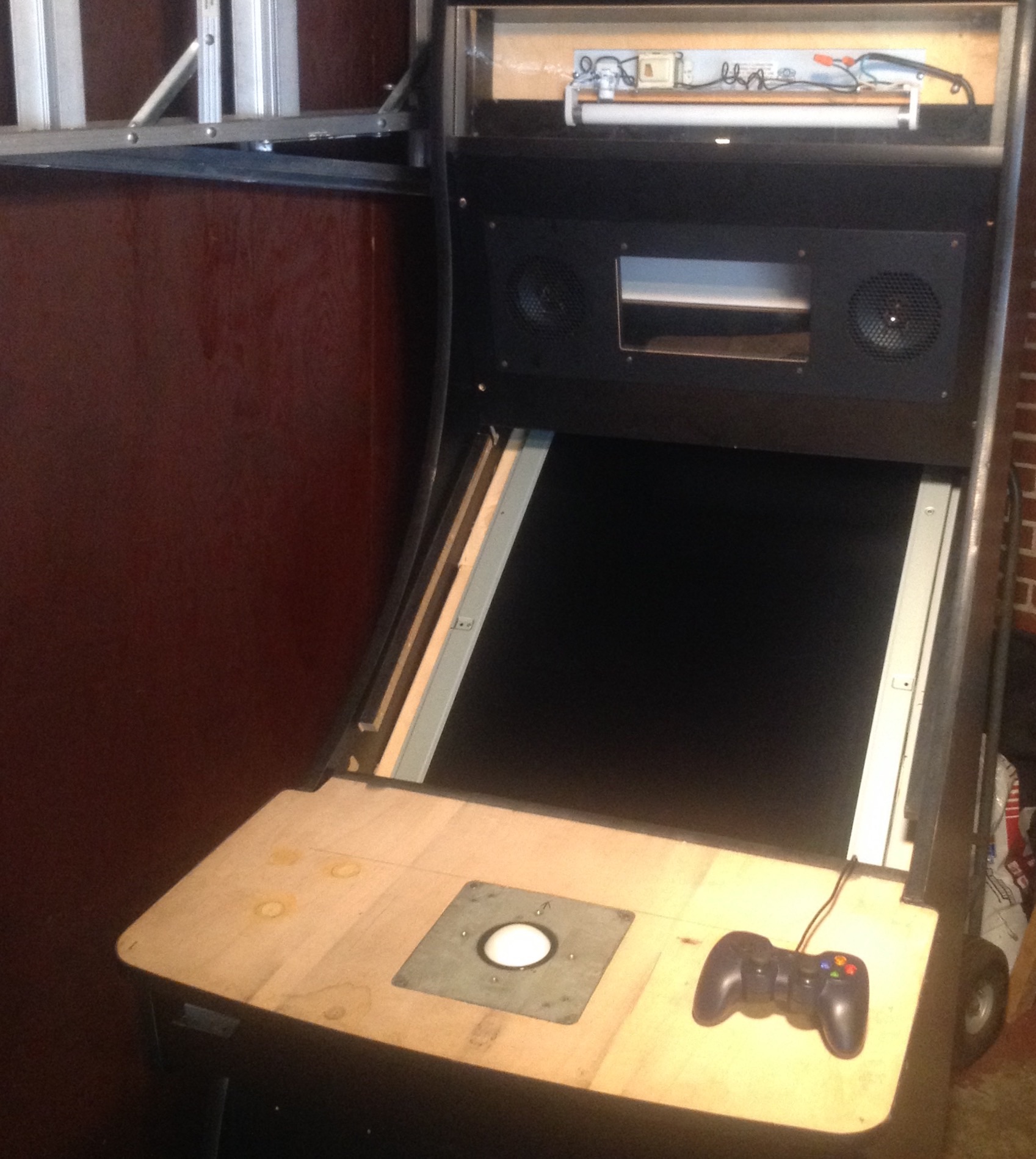

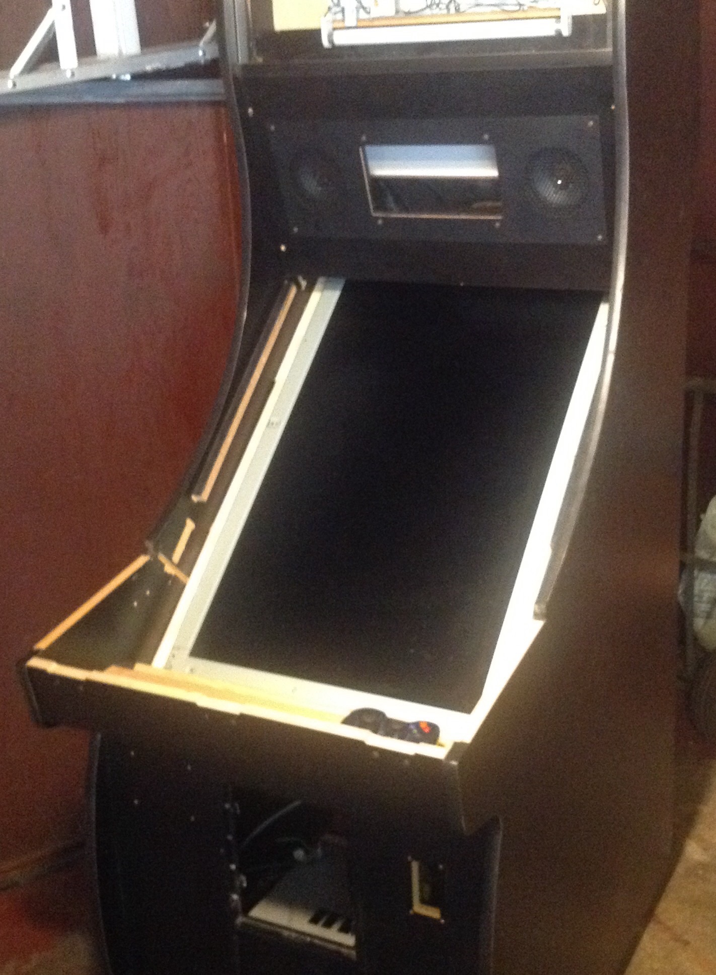

There's not much to see at this point, but since you asked and I happened to have one of the CP:
« Last Edit: October 06, 2015, 10:49:47 pm by Token »

Looks like you have a good foundation to work from. Although you are going to have to plug those existing button holes I'm sure.
Also, I noticed that this cab originally had a 2nd (smaller) monitor below the marquee and between the speakers. Any plans for that? Keeping the speakers? Removing both and have the TV fill the entire space?
Yeah, so this seems like a good cab to convert to MAME. I was originally going to build my own cab (modeled after the Artifact build), but when I saw the price and that it came with working coin doors and trackball, I couldn't say no. The only downsides are the size - this sucker is DEEP - and the shallow angle of the monitor. Oh, and existing button holes have been filled and sanded smooth (that picture above is a couple of weeks old).
The space between the speakers is actually a backlit information card. But if there was ever a cabinet where a secondary monitor would look right, this is it. I keep telling myself, "Baby steps, baby steps" but I have entertained some thoughts on how to use that space...  8)

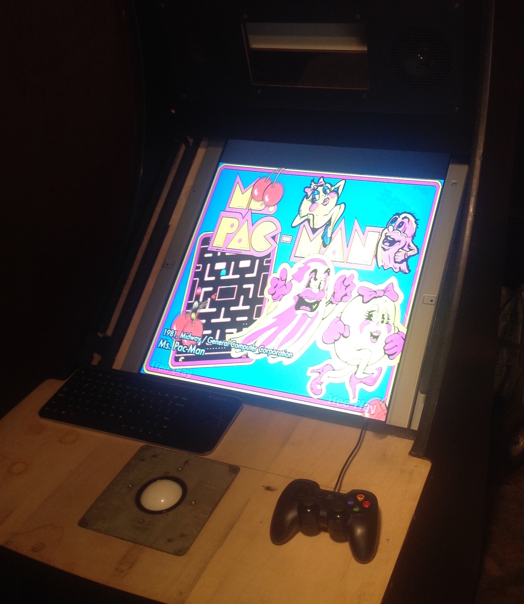

UPDATES
Sorry for the low-light pics ahead.
The Coin Mechs
I have given up on trying to force these coin mechs to accepts tokens. I did manage to modify the pins so that a token would be rerouted to the acceptor slot (I'm pretty sure that's not the right term), but it got rerouted by the magnet.  :angry:
As a child, my friends and I found a cache of metal knockout slugs left behind by an electrician on a jobsite. Through trial and error, we found one arcade cabinet that didn't seem to care if they weren't quarters and we spent several days having our way with a Battlezone machine. I guess my sins are now catching up to me.
Despite my username, this cabinet will only be feed with quarters.  :-\

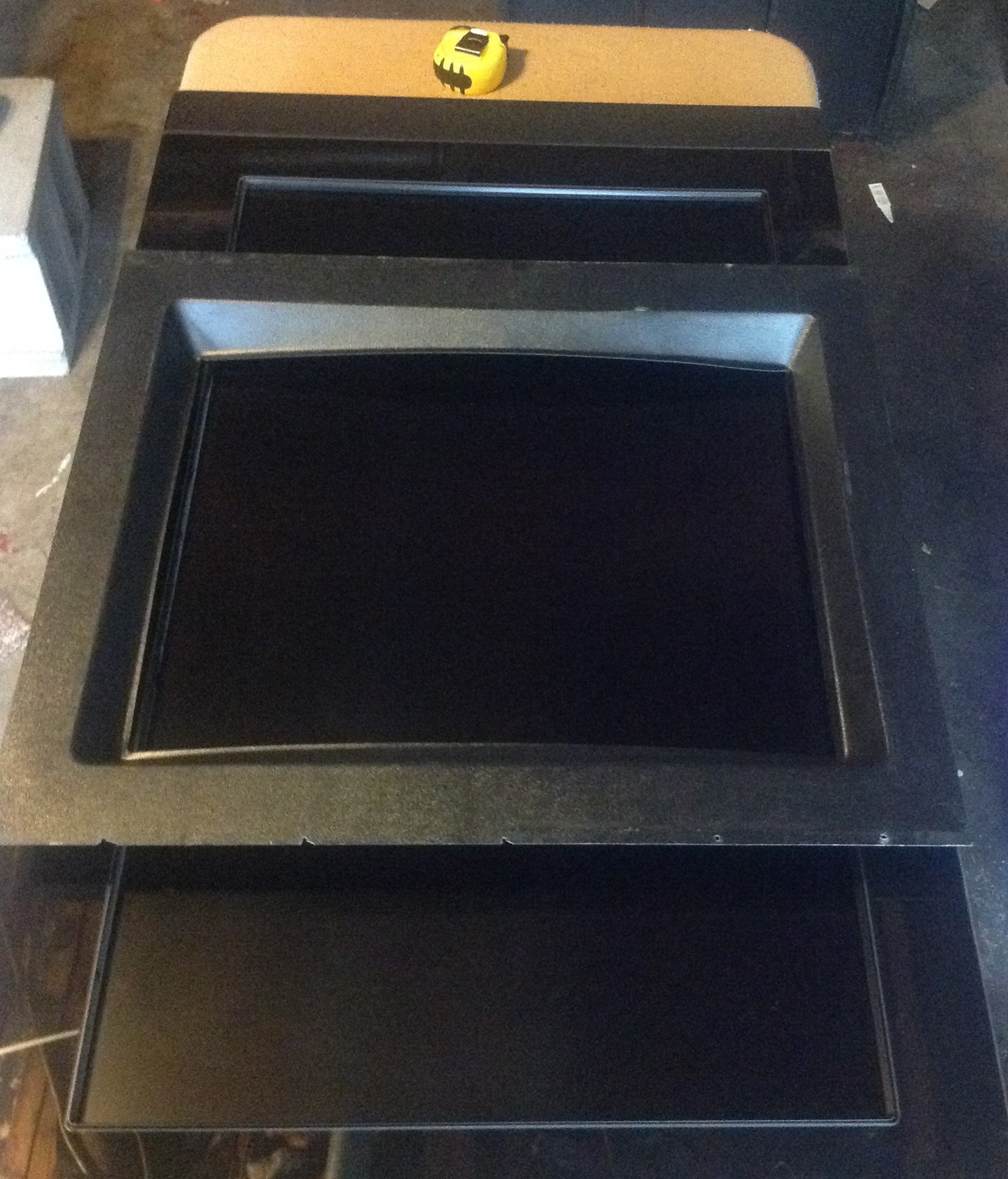

The Screen - It Lives!
Found an older 42" widescreen on craigslist for $75.
Now how do you fit a 42" widescreen in a 27" wide cabinet?
I don't think it will fit the existing bezel.
De-casing this was much easier than I thought it would be. Unscrewed the back, the speakers, the plate with the controls, and a doo-hickie with some inputs. Remove back panel. Secure input doo-hickie and controls plate. Detach speaker wires. TV de-cased!
Sorry there are no pictures of the decasing. I was too excited/nervous and didn't stop to get out a camera.
Then I had to tear out all the existing interior woodworking and build supports for this beast. I pocket-hole screwed a 2x4 at an angle to act as the bottom "shelf," and then screwed two ripped 2x4" to the interior sides of the cab to act as "runners."
It's a tight fit, but the TV is in!

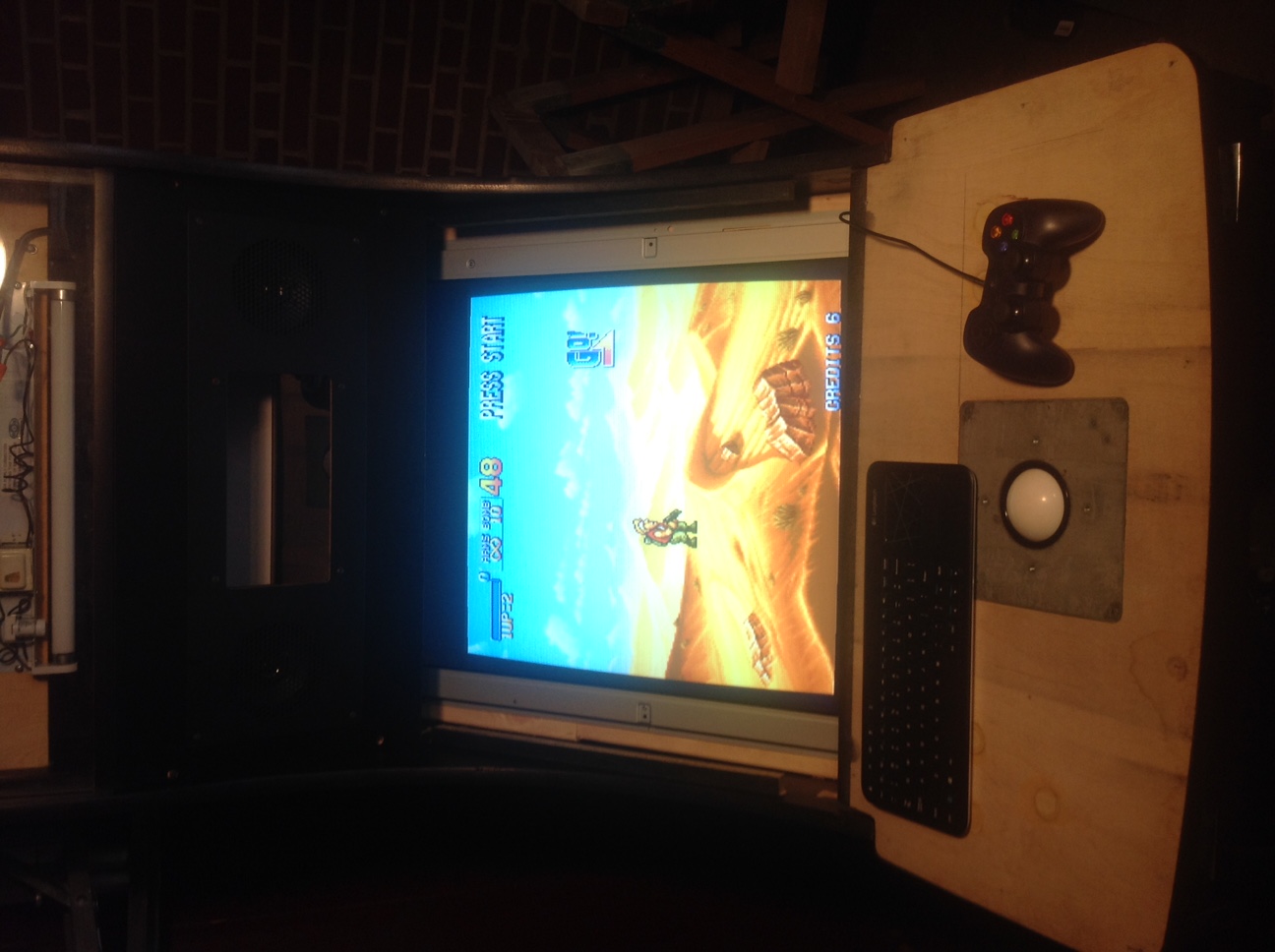

With the CP on-

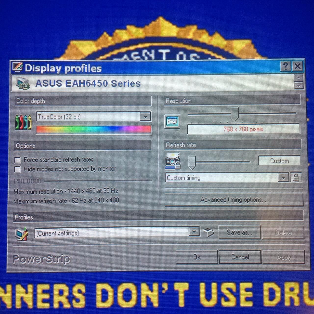

What to do now that there is a 42" vertical TV in the cabinet? Download powerstrip and create a custom resolution!
I'm currently running a square 768x768 on the desktop.

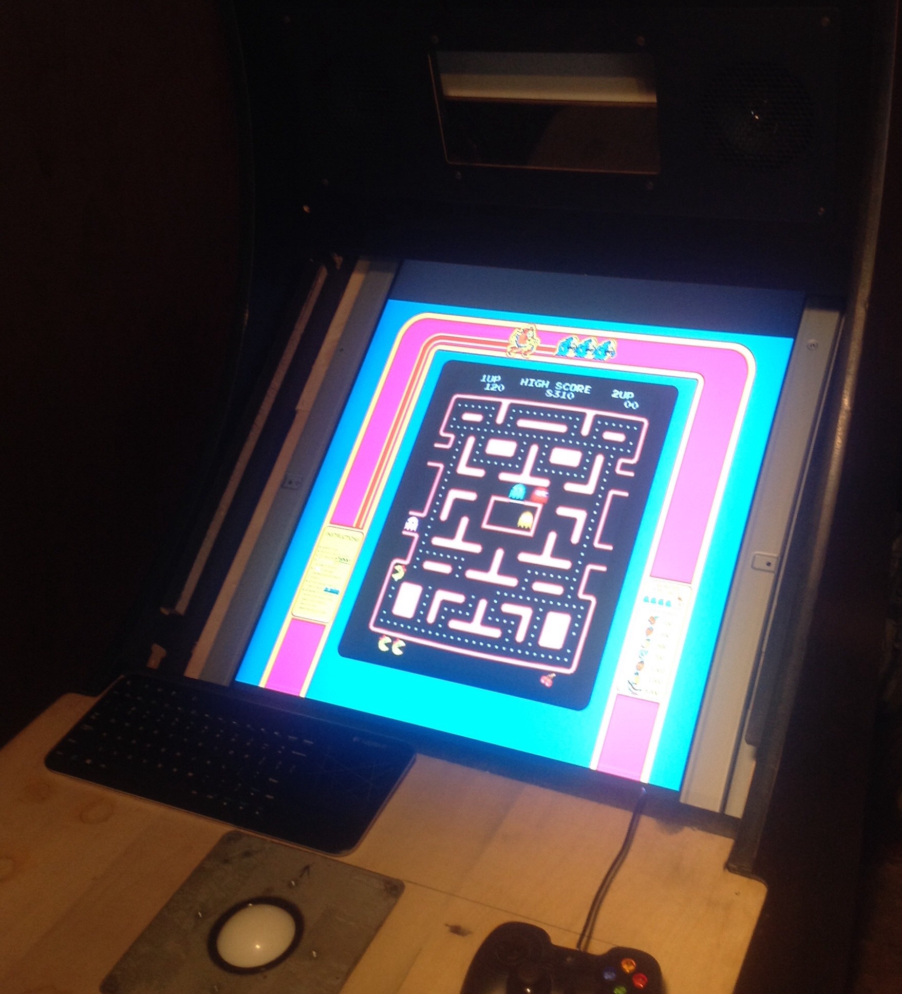

Hyperspin-
MAME-
I haven't dug into the settings yet, but there is definitely something wrong with the MAME resolutions. Everything is being stretched out.
And I need to stop uploading pics from the iPad...
I couldn't be happier about how this worked out with the 42" TV. Once I get my video settings right, I will have a 25" vertical and 25" horizontal 4x3 display, without having to build a rotating mechanism!

In the meantime, I measured the control panel and started working on the layout. I am set on 6 buttons per player. I also want to minimize admin buttons. I will be using an I-Pac. Ultimarc has a cool feature that when you hold down P1start it acts as the shift key, so I'm considering six buttons per player plus P1 and P2 start, and no admin buttons. Am I crazy? I see most MAME cab builders add a few more.
Two questions today:
1. For anybody who has used MAME in a cab with very few admin buttons-- Did you find it confusing or annoying to not have an ESC or PAUSE or TAB button?
2. Do you see any flaws in the layout below? Before X2 asks, the P2 joystick is 2.5" away from the trackball. Should I move all controls higher up the panel? I really don't want to move the trackball as the panel is already routed for the recessed metal plate. Ideas?
I certainly have room on this panel to add more buttons or move controls around. Let me know your thoughts!  :cheers:
« Last Edit: October 14, 2015, 11:15:49 am by Token »

In the meantime, I measured the control panel and started working on the layout. I am set on 6 buttons per player. I also want to minimize admin buttons. I will be using an I-Pac. Ultimarc has a cool feature that when you holding down P1start it acts as the shift key, so I'm considering six buttons per player plus P1 and P2 start, and no admin buttons. Am I crazy? I see most MAME cab builders add a few more.
There are pros and cons to both dedicated buttons and shifted functions.
http://newwiki.arcadecontrols.com/index.php?title=FAQ#Number_of_admin_buttons
Either way, keep this bit of wisdom in mind:
To keep guests or children from accidently messing up their cab configuration, many individuals choose to not include a Menu (Tab) button and disable the shifted function for Menu. (P1 Start + joystick right on I-Pac)
Token

I think an escape button is a necessity, and a pause button is really handy.  I use a single button for both on my latest cabinet. It is pause with a quick press, and exit if held for 3 seconds. This minimizes button clutter, and also prevents people from accidentally exiting a game.  All other admin functions use shifted buttons to prevent others from screwing everything up
Sent from my SM-G900V using Tapatalk

My MAME cab is similar to yours. It is a golden tee. I left the trackball in the stock location and fit in a 7 button layout on each side. Straight street fighter style with the 7th button for MK3 run. Then I have a start button for each player above their set of controls. No other admin buttons are present. I am solely using the ipac admin functions. The newer ipac even supports the trackball natively. I just cut off the original connector and wired up a connector using the .100 pin ends.
For admin functions, shift plus p1 button 6 is esc, shift plus p1 down is pause. I also used the built-in macro for buttons 7 and 4 to shift function left and right click if I do need to do something on the cab without plugging in a mouse. I can attach the visio for my cp if you are interested. It is to scale.
