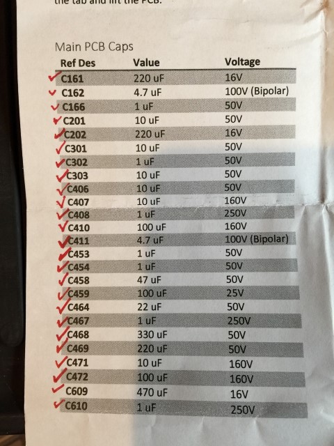

So I got a cap kit from twistedquarter.com for this monitor, but the list they sent me is off. I am comparing it to johns arcade's Sanyo recap video he did a few months ago, and the values for which cap going where on the sheet he sent me don't match up. C201 for example should be a 10uF 50V but the sheet says 100uF 16V. Can anyone please find me the correct listing? I really need to get this monitor capped today!
vwalbridge
  • Posts: 2082
Re: DK JR restoration!
« Reply #72 on: January 10, 2016, 04:26:42 pm »
I literally just capped the sanyo 20EZ on my DK. I used Ian Kellogg's Kit
His kits come with each cap labeled very clearly and with included directions:
Ian's kits come highly recommended and I trust what he gave me. After all, my CRT looks fantastic after using his kit.
Also, the uF rating of the cap you remove needs to match the cap you are putting in. Just like John's video says, the voltage can be higher (not ever lower) but the uF must match.
Can you tell if your monitor has been capped before? Mine was and some of the caps ratings we way off.
In the end, your caps should match what the above image states. Let us know what you come up with. :)
« Reply #73 on: January 10, 2016, 04:35:39 pm »
The original schematic for the sanyo called for a 100uF 16V cap. The later revisions of the schematic have 10uF 50V there. I don't believe it will be harmful either way so if you already have a cap kit, use it if you want.
Just for your own sanity. check the cap that is on your sanyo. I ran around my basement looking for all the sanyos I haven't capped yet to verify and they all had 10uF 50V. So I am going to keep packing the 10uF 50V in mine.

Thanks for the replies! I bought this capkit six months ago and it has been on the shelves since then, as I have been busy and am just now getting to it. Ian, I have heard nothing but praise about your kits, and I really wished that I had ordered one from you instead.

« Reply #76 on: January 11, 2016, 09:36:08 am »
Well, I got the Capkit installed. I did find one that was leaking, so hopefully this will fix the problem. There were a few tricky spots where the connections are very close to another one, and I had to use a flat head screwdriver to keep them separate. I am very much a noob at this, as this is my first capkit and my second time using a soldering iron. I am going to try to assemble the monitor and get it reinstalled tonight. Hopefully the thing won't explode! lol,  :timebomb:
