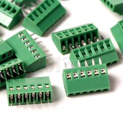

Here are pics of it.  It's currently programmed as an HID Joystick encoder,  but let me know if you need me to make it a keyboard. (You could also easily program it yourself at home with whatever keys you want).
PS - You can pick it up when you help me move my 3 cabinets. Lol.
Del

I can never find a decent price on those screw terminals.  Ever time I go looking they are stupid expensive.  I'd love to just order a whole bucket of em.  Currently I use the euro-terminal strips; I solder wires to the AVR then clip them to the strips and then mount the 2 strips on a small board - this gives me a placeable unit.
These are the ones I used ( http://www.ebay.com/itm/6-Pin-5PCS-2-54mm-Pitch-Panel-PCB-Mount-Screw-Terminal-Block-Connector-YG-/111323143255?hash=item19eb605c57 ) - fit nice and tight (almost do not need soldering) $3.00 for 5 pcs. and you need 4 pcs per minimus ( I ordered 4 sets for $12 and had enough for 5 encoders)

Awesome, thanks for the link JD!  Just bought some.
Re: Cost effective encoder solutions
« Reply #23 on: June 30, 2015, 02:18:38 am »
Yup. Those are the same ones that I bought. They work great!
