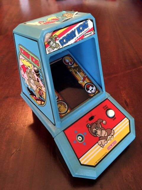

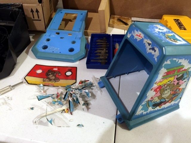

Well here she is. Found this broken Donkey Kong Coleco on eBay for $35. These little guys are getting a bit expensive...even the broken ones!
As you can tell, it is in bad shape. Joystick broken off. Decals are faded and peeling off. Battery cover is missing. Battery terminals are totally rusted out and it doesn't power on. But that's fine because this thing is going to get totally overhauled.

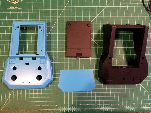

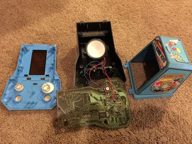

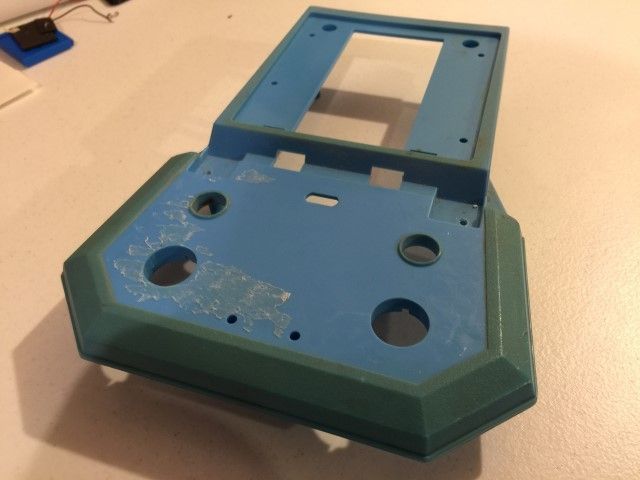

I disassembled the entire machine:
De-soldered the main board from the battery terminals:
Removed all the decals:
You can see how badly the plastic discolored over 30 years. The edges almost turned green:

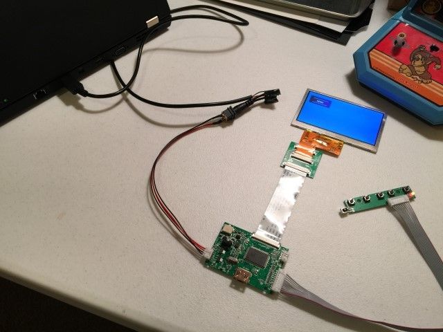

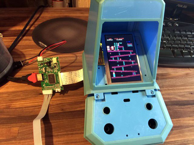

Found 4.3 inch HDMI LCD screen from eBay. Looks like it will fit perfectly:

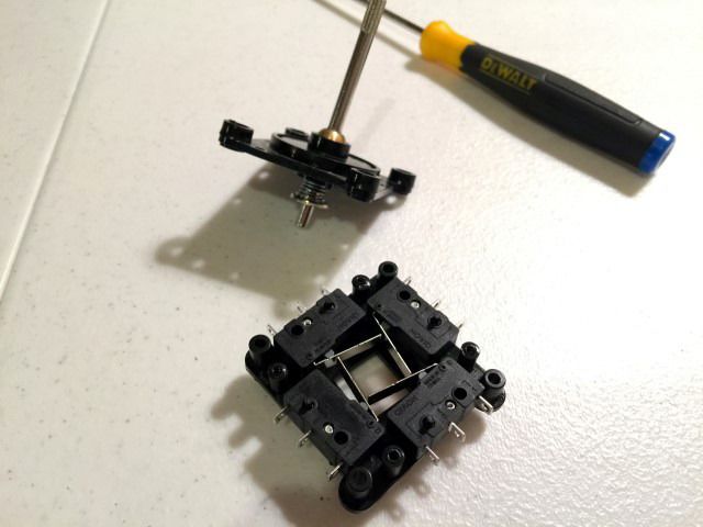

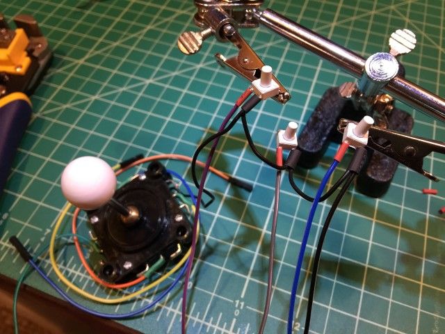

I also took apart my joystick to replace the switches with micro leaf switches just like Vidiot. The stock switches click way to loud:

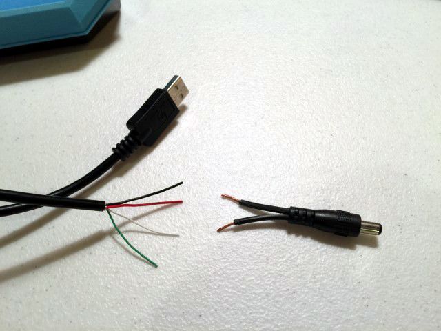

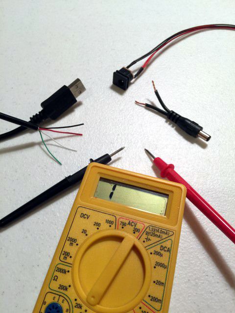

I wanted to see if I could power my LCD screen from USB so I found and old power plug and USB cable. I then stripped the ends off. (The green and white cables on the USB are not needed here). I just needed to match up the black and red cables.
However, the power plug I have didn't have colors so I have to use my volt meter to determine the polarity. Turns out the inside of the barrel plug was red and the outside was black:
Twisted all the wires together, plugged the USB cable into my laptop and boom!...it turns on! This makes it really easy to power my micro cab because now I only have to worry about powering the computer. Everything else will power over USB.

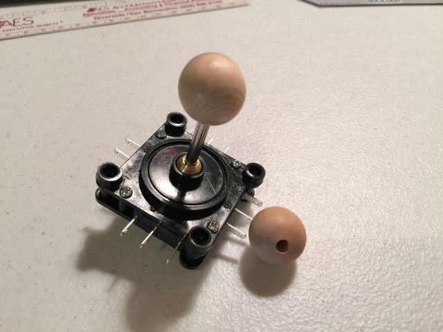

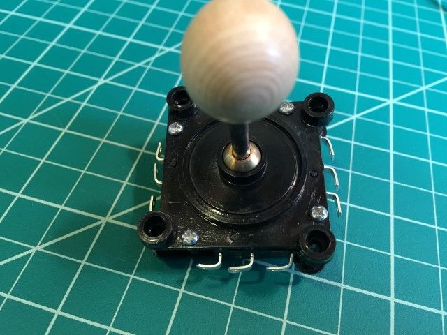

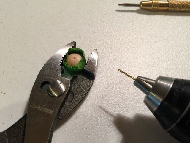

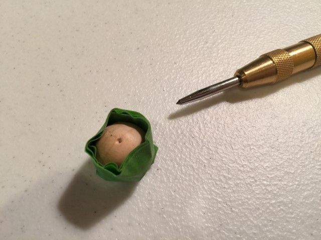

Working on my joystick and case. (all the credit goes to Vidiot for the Joystick idea...thanks!):
I center punched the ball top for my joystick:
Then wrapped it with tape so that my pliers didn't scratch it while I drilled it. Started with the smallest drill bit I had and worked my way up:
I drilled out a few if these so that I can test paint on them. I think that I'll just epoxy the ball top on when ready.

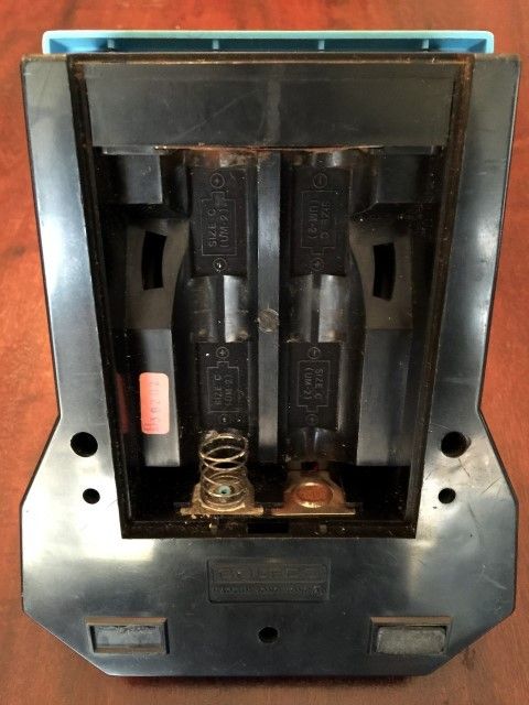

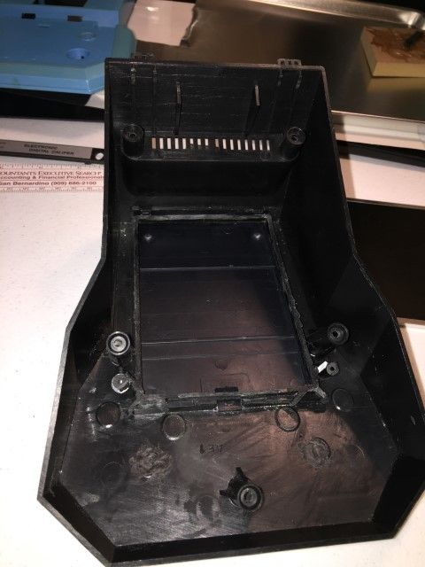

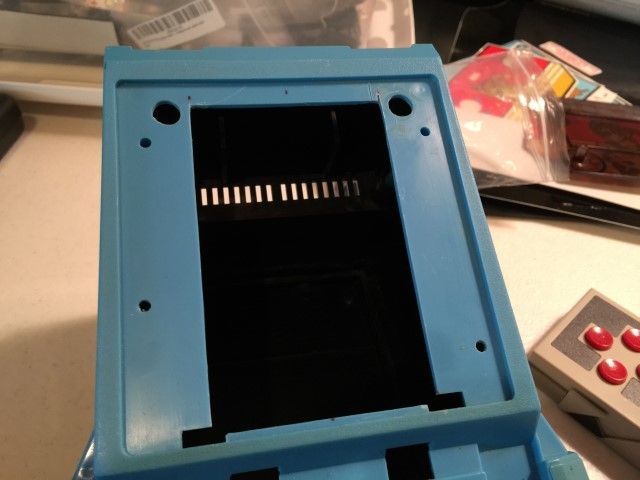

I also used my dremel to cut away the battery chamber on the Coleco base. Surprised how easy that was to remove. I was really worried that was going to difficult:

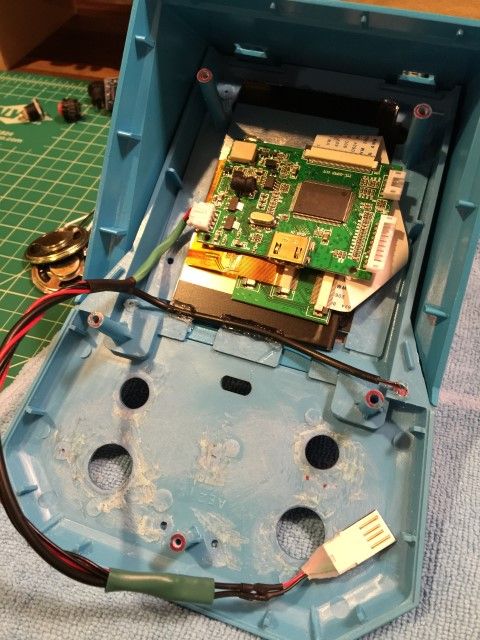

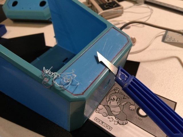

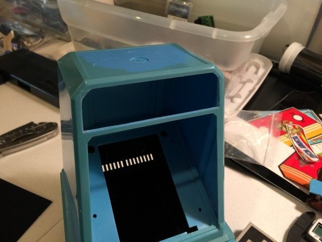

Removed the unnecessary posts from the upper-inside of the cab to make as much room as possible:

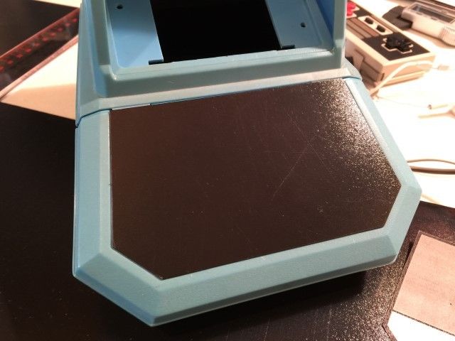

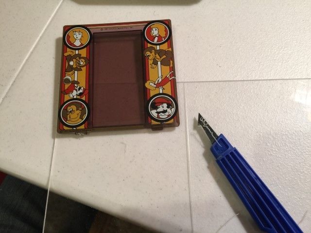

Cut out a piece of Kydex to become the new control panel surface:
Used a plastic scoring knife to cut out the marquee:

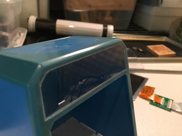

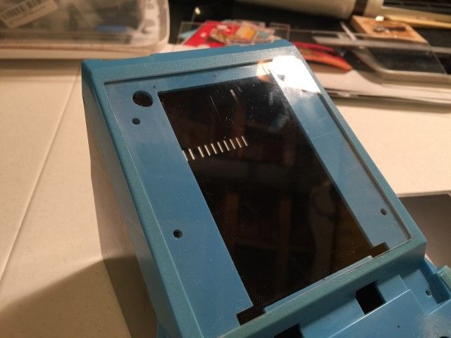

Cut the opening for the 4.3 inch LCD screen:

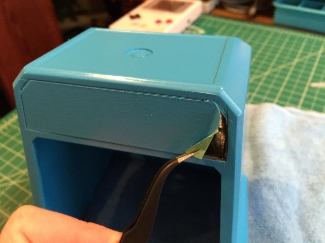

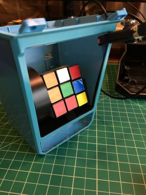

The opening for the marquee. This took some patience to ensure that I didn't crack the bottom edge:

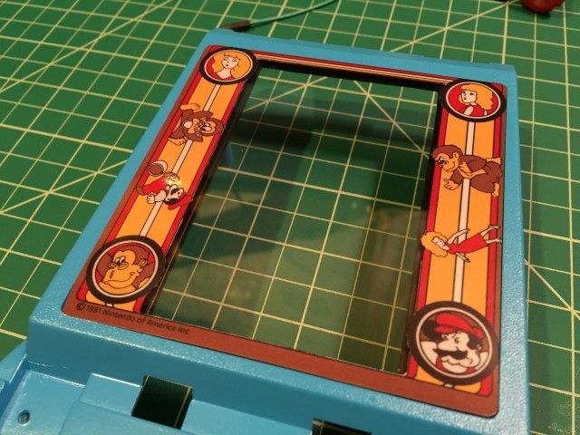

Measured for the exact width of the existing bezel plastic:
Rounded the corners and the new bezel plastic fits right in:

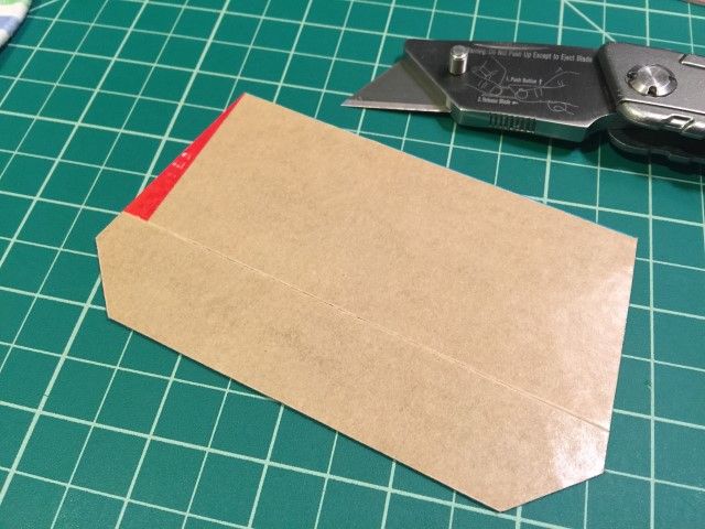

I also cut out the new marquee plastic. This was really hard. I couldn't really trace anything so I had to cut it by eye and sand the edges like crazy:

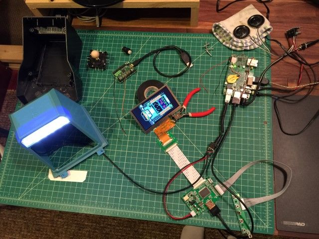

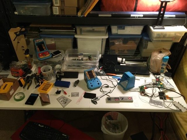

I also threw in a picture of my current work space. I can't believe how many parts and tools this little project requires! You will notice the NES30 controller on the table...I'll be integrating that into this build.  ;)

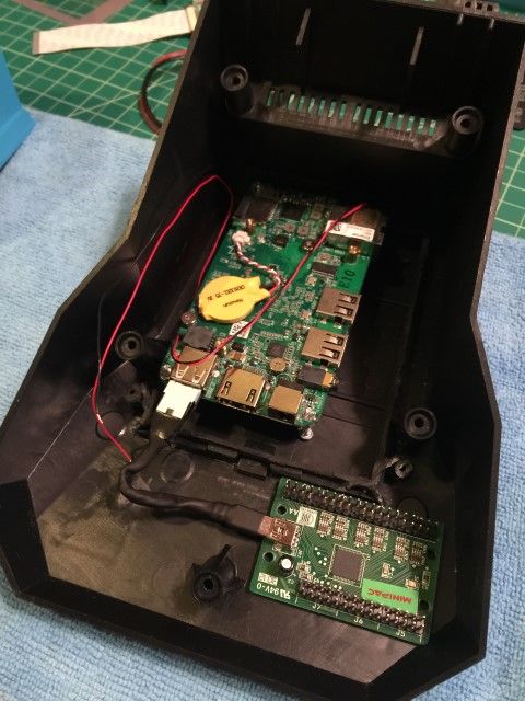

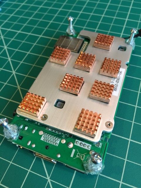

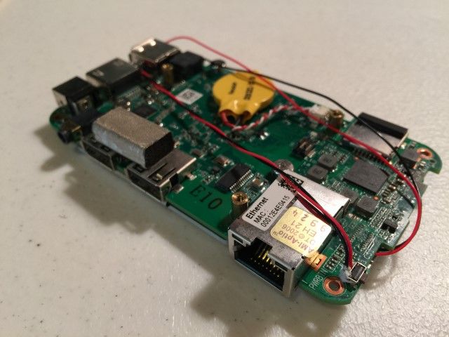

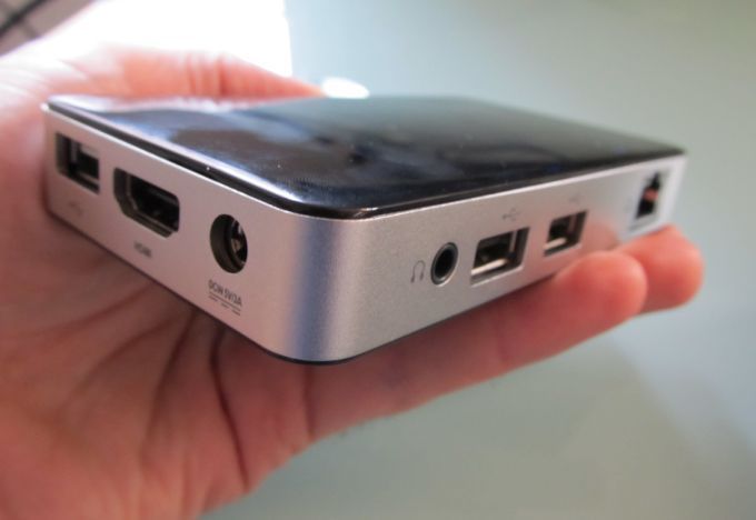

For the brains of the arcade, I'm using a Zotac Pi320. It normally looks like this:
But I have de-cased it and it now it looks like this. (It's about the size of an iPhone 4. It's amazing this thing runs Windows 8.1  Quite frankly, I wish it didn't because I really love win7 better. I had to make MAJOR changes to get win8 to behave the way I like it. )

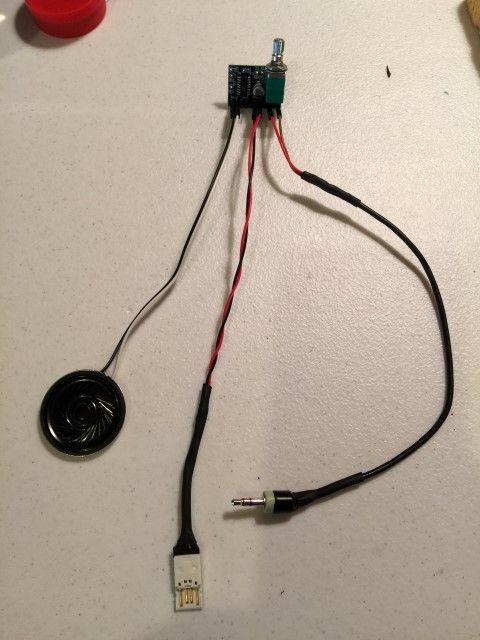

For my sound setup, I'm using a 5v potentiometer. So I could easily strip down a USB cable and solder the power from that to the potentiometer. I also soldered up a speaker and the mini-plug. It sounds pretty good and loud enough but I'm getting some background static. There is a GROUND pin-out on the potentiometer so maybe I need to use that. This potentiometer actually supports 2 speakers! Not sure how "stereo" it will sound in such a small space but I guess I might as well use them both.

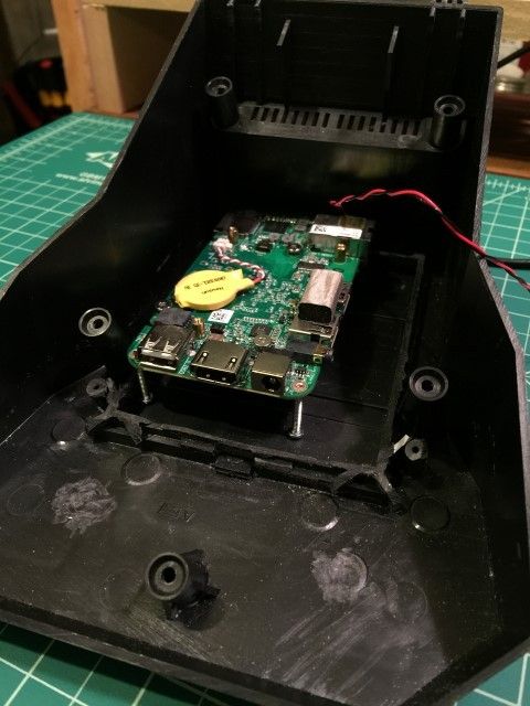

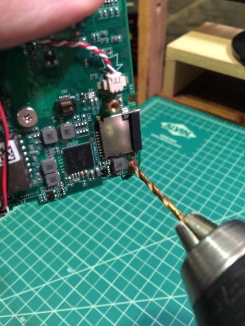

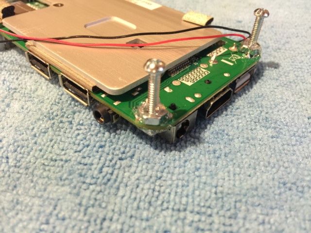

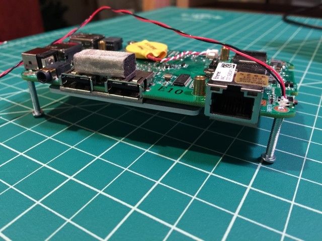

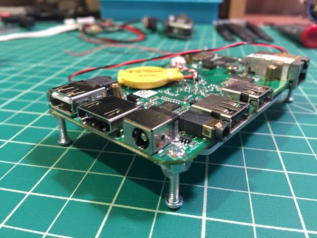

I couldn't find motherboard stand-offs small enough for my computer so I had to go to my local hardware store and find some screws that were small enough. However, I needed to slightly drill out the existing holes on the board to accommodate them. I had to be super careful doing this.
The screws lift up the board just the right amount and give it a stable platform
Here it is inside the Coleco shell. I needed it raised up so that i clears the cut edge of the existing battery chamber.

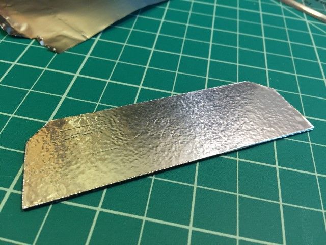

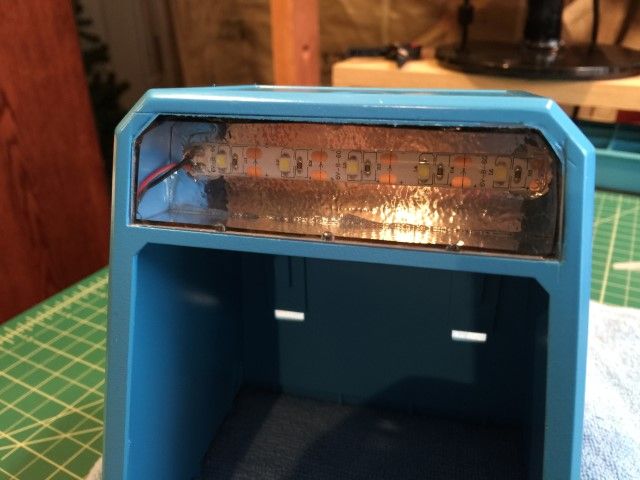

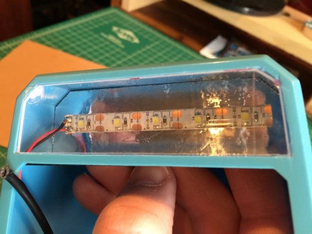

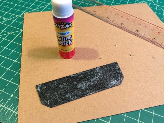

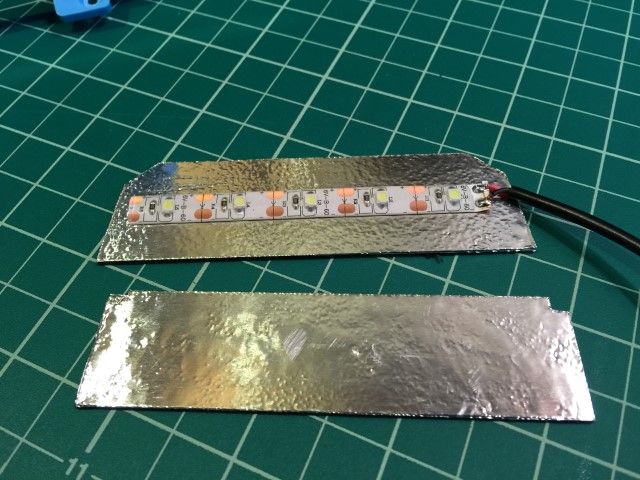

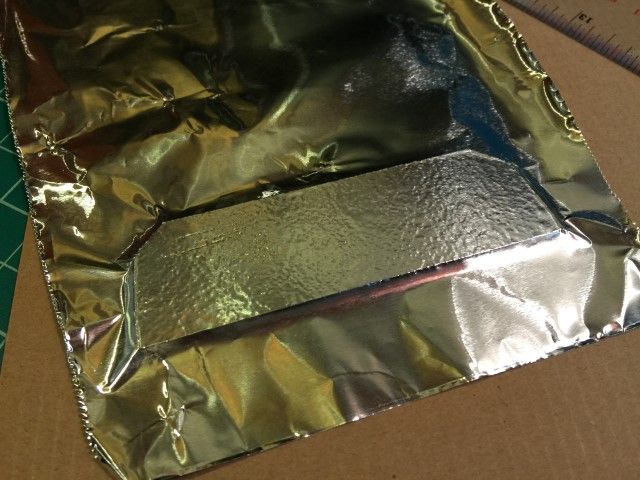

Working on my backlit marquee. Applied glue to the back of the marquee:
Pressed aluminium foil to the glue:
Cut the edges of the aluminium foil off:
My LED strip already had adhesive material on the back so I just stuck it down:
I then used epoxy to glue the 2 sides behind the marquee. Turns out a roll off electrical tape and a rubics cube were the perfect weight to hold it in place.   ;)
Here is it is glued in place:

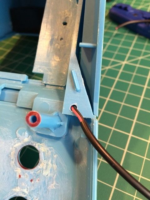

I then spliced an opening in the power line so as to fit it inside the case:
Ran it down the inside edge. I'll just hot glue it in place back there.
It will slide through this opening in the face-plate nicely.

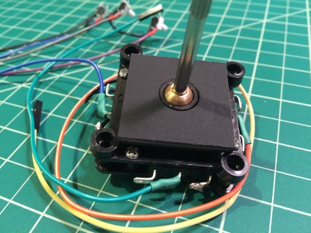

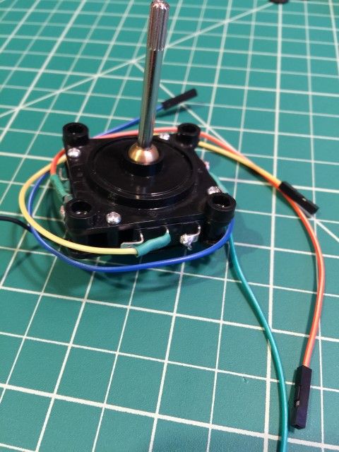

I also started working on my joystick and soldering in the ground wires. I first needed to bend the pins over. I need make as much room as possible inside.

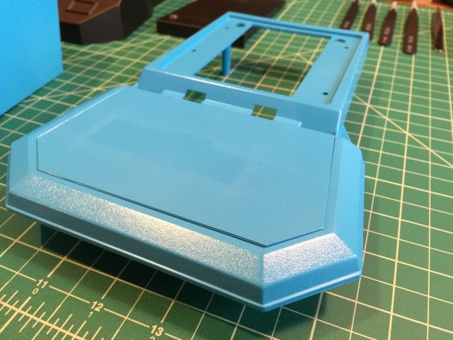

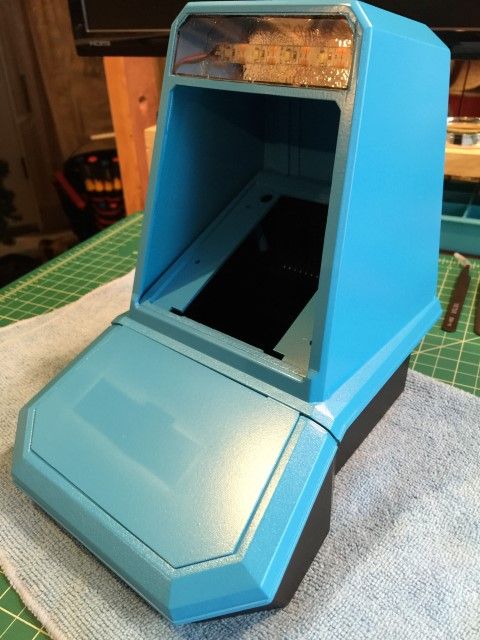

My first coat of paint has gone on pretty well. I was nervous to paint plastic. I've never done it before but this new plastic paint is really looking good so far:
Peeled away the tape on my marquee.
That Frog Tape did a good job keeping the paint from bleeding:
Painted control panel:
Roughly assembled:

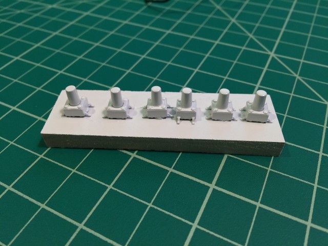

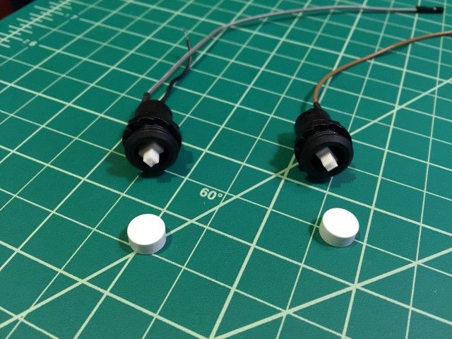

Control switches. (I put 3 layers of paint on these and then realized it started to gum-up the movement. I might need to paint another set and tape them off this time)

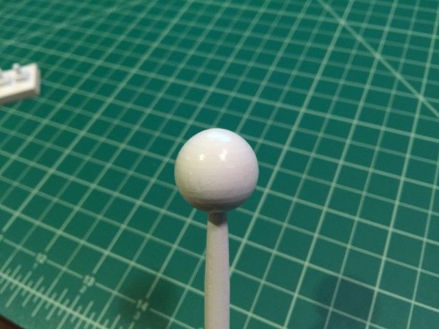

Joystick ball top. This has been a royal PAIN to paint. The wood soaked up all the paint on the first 2 coats. I'm on coat number 4 right now and will still need to do another 4 at least. Then I will clear coat it.

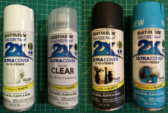

I heard mixed results with Krylon so I ended up going with the Rust-oleum brand paint. This stuff is legit. Sprays so clean and leave a very smooth finish. I'll be using the "Clear" can to give my buttons and joystick ball a nice clear protective layer.

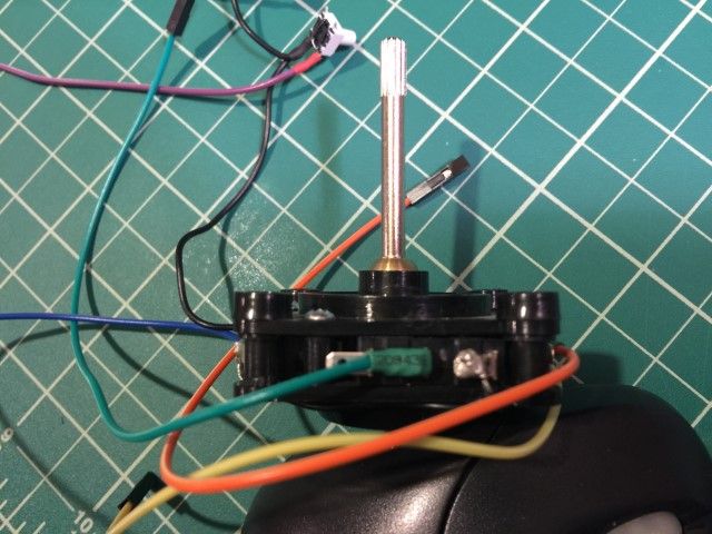

Soldered the wires to my joystick. You will notice I also put some heat-shrink tubing around the solder connections. They are pretty delicate so that tubing really helps. I LOVE shrink tubing.

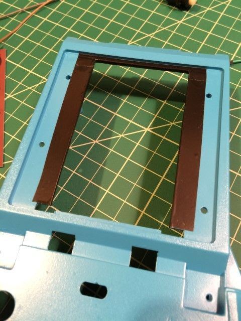

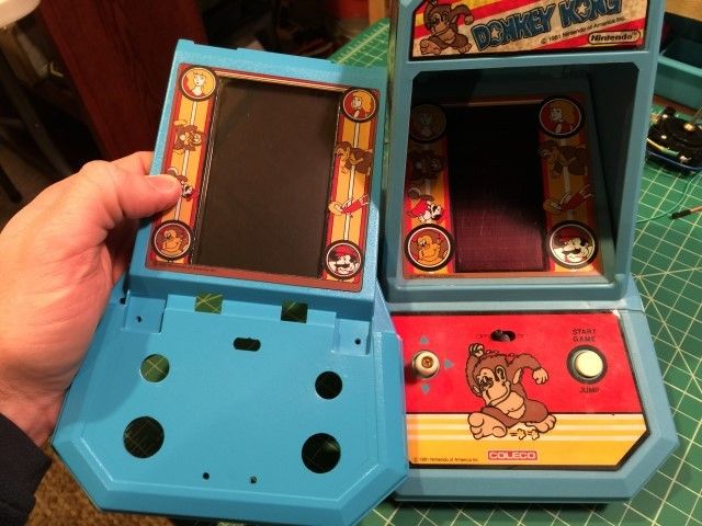

Put some black electrical tape around the inside edge of the bezel. This will prevent any blue color from showing on the edges of the screen.
Applied the bezel artwork to my bezel lexan
Here it is in comparison to the real thing. You can see how much wider the screen is on mine. I had to Photoshop the snot out of it to get it to fit but still look as original as possible.
Soldering up my 3 admin buttons and attaching them with the joystick to my mini ipac for button testing. All the buttons appear to be working! My joystick ball took 8 coats of high gloss white and 2 coats of clear coat.

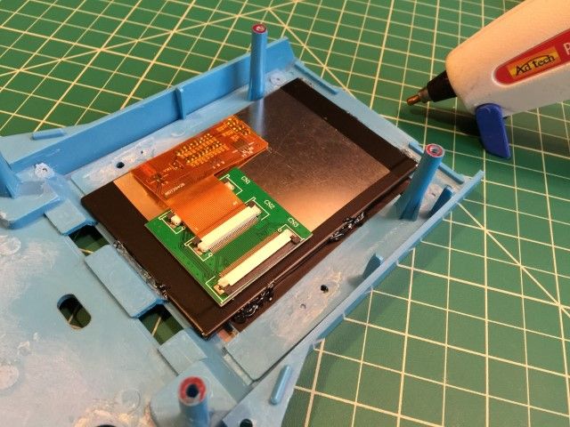

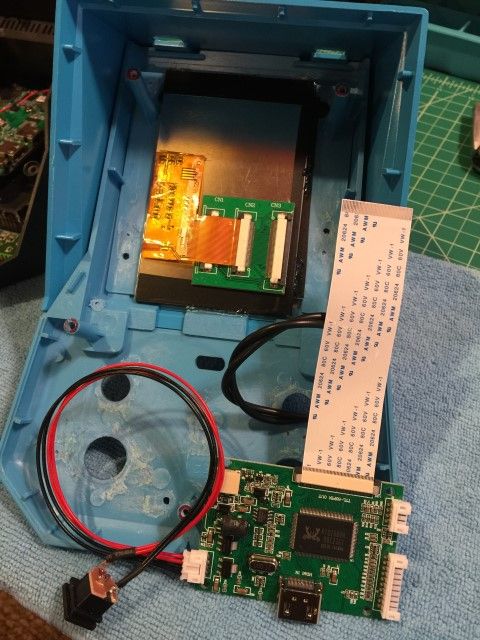

Hot glued my 4.3 inch LCD to the back of the bezel. I didn't go overboard with the glue. Just tacked it down in some strategic places.
I screwed the bolts onto my stand-off screws about 1/2 cm down. Then pushed them in through the bottom and tacked them in place with hot glue.
I then flipped the board over and hot glued the protruding portion into place. I couldn't just use the same bolts on the top side because there were parts of the board in the way. The final result is a home made stand for my compute to rest on. The hot side of the board is on the buttom so it will help with air-flow. Lifting it up also helps save room on the inside because it lifts it up above the edge of the battery door.

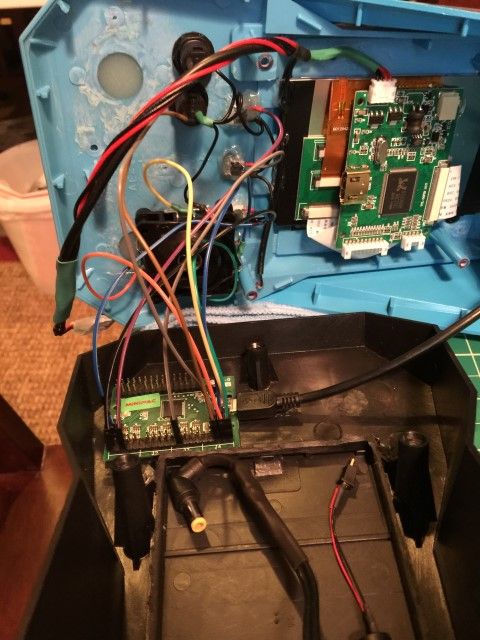

I also tacked my minipac into place and connected it via USB.

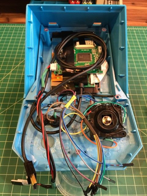

Now that I have my LCD mounted, I need to figure out where to put its control board. It has a rather large and in-flexible ribbon cable that is going to make it difficult to put anywhere but exactly inline with the connector port. I think that I have a pretty good idea the only way it will fit in there but it's going to require some strategic hot glue placement.
Finished wiring up the control board for my LCD screen. The power for the LCD comes out the left side there and then combines with the power coming from the LEDs in the marquee on the right. The are soldered together and will plug into one USB port on the computer.  The HDMI port is easily accessible. (The gold square in the middle) I had to fold my ribbon cable twice to get it to all fit in there. Then just hot glued it down.

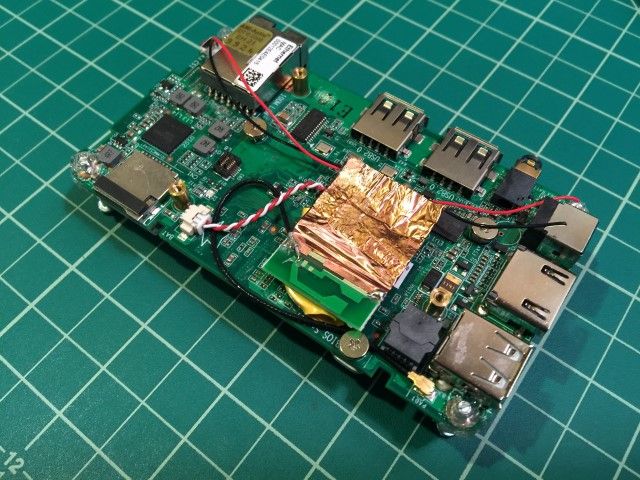

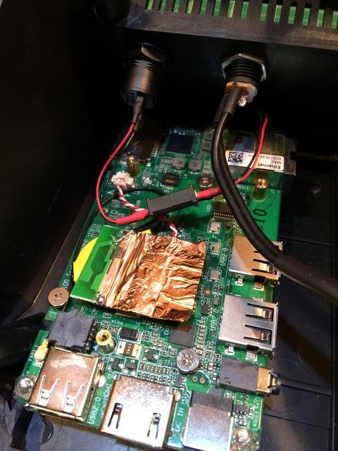

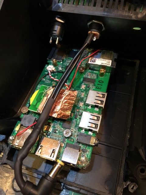

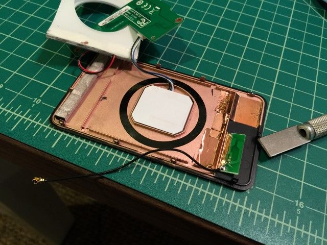

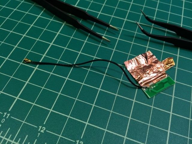

I needed to restore Wifi and Bluetooth connectivity to the computer and the antenna was embedded in the top shell of the computer case. So I used a razor blade to pry it off:
I was careful to take all the copper tape with it as well. I assume this helps with signal strength:
I then reattached it to the computer and glued it on top of the cmos battery. It's not pretty but it will work. (I put some electrical tape on the bottom of the copper to keep it from shorting anything out.

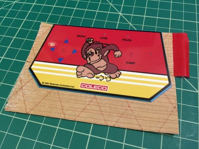

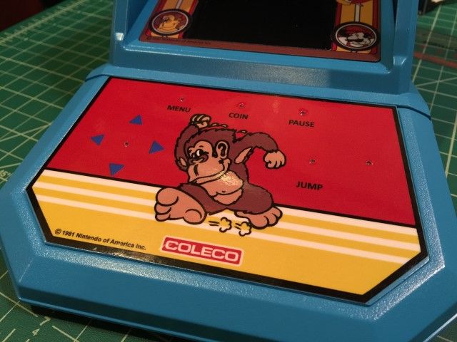

I took some really strong carpet tape and applied it to the back of my control panel.
Then cut off the excess
Peeled off the backing and stuck it into place. The nice thing about this carpet tape is that is is VERY sticky but also very thin. Almost like a membrane. It doesn't add any thickness

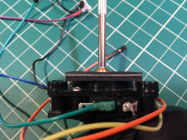

If you look at the side of my joystick, you can see that it doesn't sit flat. There is a black collar in the middle that protrudes up. I need to level that out so that I have something flat to glue to the under-side of the control panel
So I cut out 2 small squares of kydex plastic and glued them together. Then drilled a hole in the center the same diameter of the black collar.
Put it over the top and glued it into place
Now the joystick has a flush mounting surface.

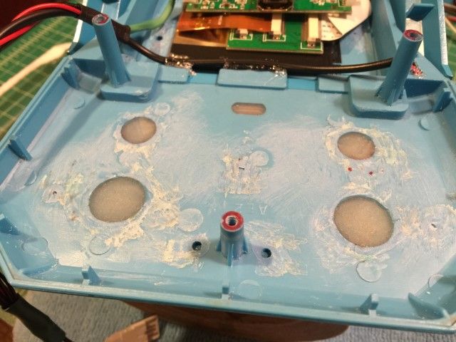

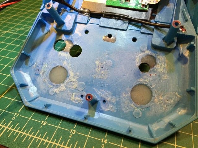

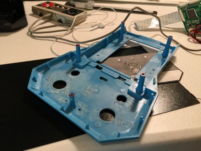

I also needed a flush mounting surface on the under-side of the control panel. I simply filled the original coleco holes with self-leveling epoxy

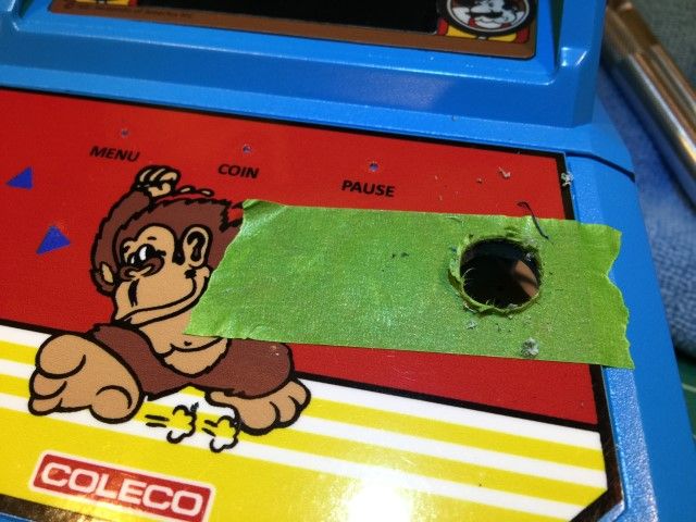

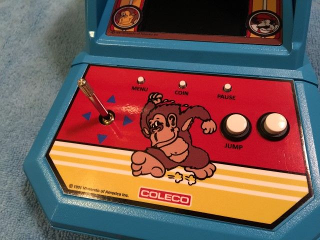

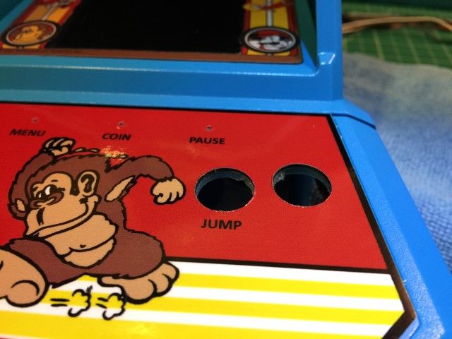

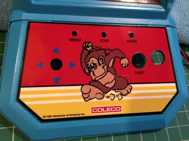

Drilled the button holes in my control panel. I was very worried about this step because I didn't want to tear the decal.
However, I used a unibit and top-layer tape and it protected the decal
I was also very pleased how well the epoxy held up on the back. Especially between the two "jump" buttons on the left.
It took me nearly 2 hours to drill 6 holes because I was being so careful.

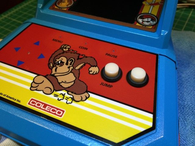

I had a very hard time finding some buttons I liked and finally settled on these. The are a bit smaller than a NES A and B button but at least they are white to match my Joystick....at least I thought they would be. Unfortunately, after I painted my joystick ball, I realized how opaque or off-white these buttons really were.
So I popped the button tops off and just sprayed them the same high-gloss white as my joystick ball. My OCD just wasn't having it!

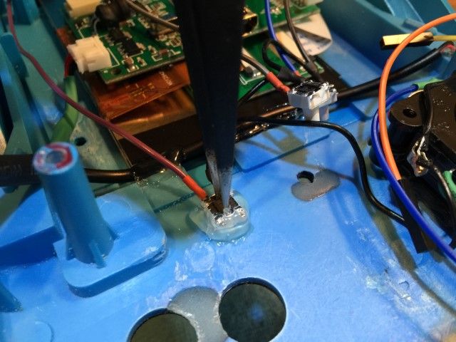

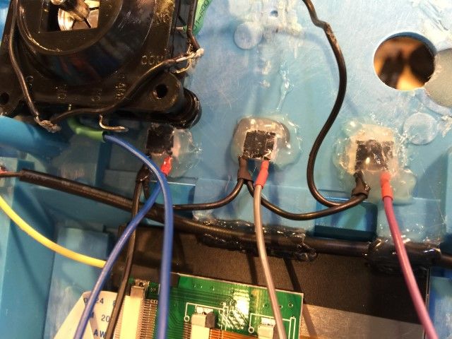

Installed my 3 admin buttons. I decided to just use big globs of hot glue. It's not pretty but it appears to get the job done. These buttons are so tiny I had to use tweezers to hold them in place while the glue cooled.
My middle button is a bit twisted and tilted. I might have to re-mount that one. That's the great thing about hot glue, I can just peel it off and start over. If the hot glue doesn't work long-term, then I'll use epoxy. I was just too timid to commit to something permanent just yet.

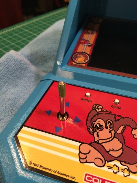

I also glued down my joystick. Used hot glue here too. Just applied it to contacting surfaces and around the edges. Seems to be holding pretty good.
So far so good on the top side. I think the last step here is to mount the joystick ball. I didn't include a "START" button for two reasons:

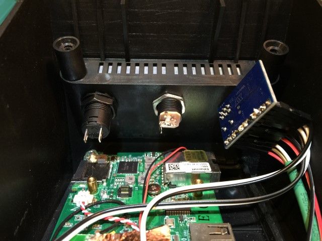

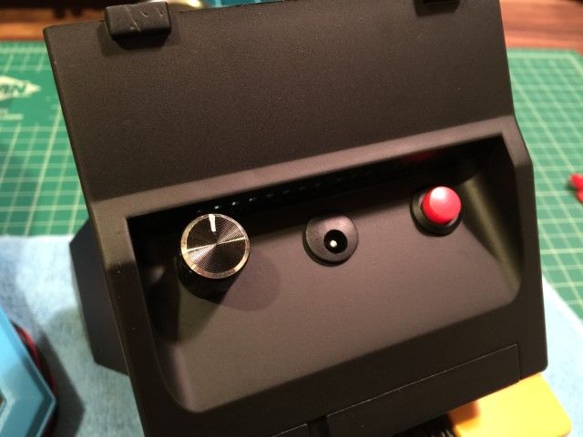

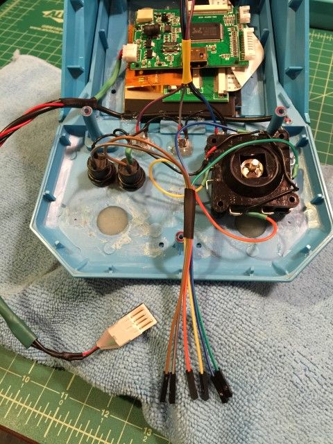

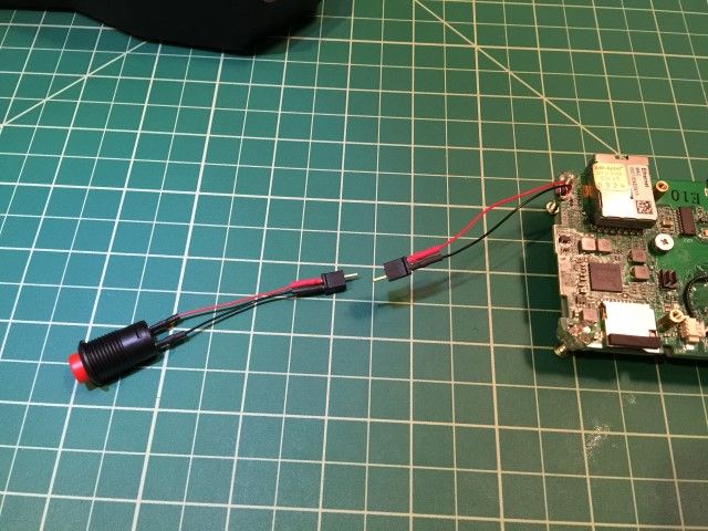

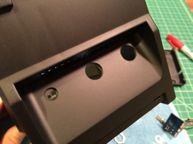

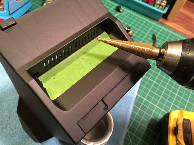

Marked the spots to drill holes for power, volume knob, and power button. Another job for the Unibit.
The Unibit does such a great job drilling holes in plastic. It makes a perfectly sized hole and doesn't "bite" into the plastic like a regular drill bit. Leaving a perfectly round and smooth hole.

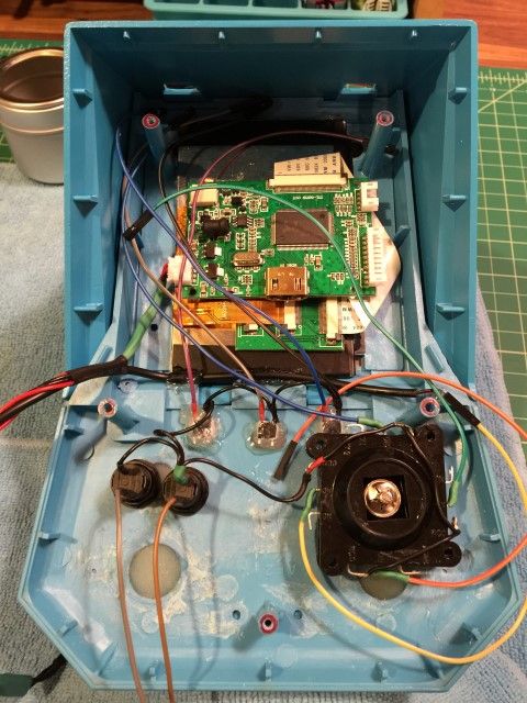

A view of the inside with the input components
A view from the outside with all the inputs installed
Soldered in the power cord

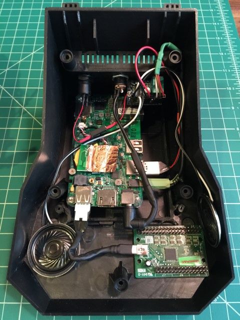

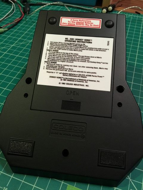

I wanted to be able to fully remove the computer from the Coleco if I needed to. So I found some very small wire "Quick Disconnects" and soldered them in-line with the power button.
Here it is inside the case.
Adhered the bottom instructions and battery warning decal. Also put on some new rubber feet. Just used some left-over cabinet/drawer liner material.

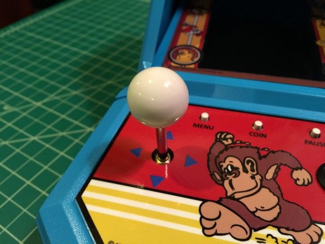

Testing all my control panel buttons with my MINIPAC.  I bought the MINIPAC used on ebay months ago and never tested it when I first received it. Luckily it works but the owner before me never bothered to mention that he had completely re-mapped all the inputs. It took me 2 hours just to figure out what was going on and another hour to find the proper software to set it back to default inputs.   :banghead:
Placed a little tape around the top edge of the joystick
Then pressed the ball top down. The tape provided just enough thickness to hold down the ball top but not so much that I could never get it back off if I needed to.

I've been doing a lot of system configuration and testing now. And while doing so, I noticed that this computer can get very hot at times. As we all know, emulating is very taxing on the CPU so the heat goes up. This little computer relies 100% on passive cooling so I picked some tiny copper heat sinks and stuck them to the bottom of the computer. I didn't think they would do much but I thought "what the heck I"ll give it a try" I was shocked how much they helped. They lowered the temp dramatically and now I don't need to worry.
I'm finally done configuring the software and getting it to all work properly with my hardware. WOW, I spent a lot of time working on the software but I think it's finally where I want it. I'm just about ready to close up the case so here is one final look on the inside. (I should have some pictures and video of the completed project soon)
Top half:
Bottom half:
« Last Edit: May 29, 2015, 03:09:49 pm by vwalbridge »

I must have missed it - what's the CPU?
vwalbridge
  • Posts: 2082
Re: Micro Coleco Donkey Kong Tabletop
« Reply #14 on: May 29, 2015, 02:45:28 pm »
Here are the quick specs of the Zotac zbox pi320
- Atom Z3735F Quad Core (1.33 GHz)
- 2GB DDR3 32GB eMMC SSD
- Windows 8.1 32-bit  (Yes it's bold on purpose, and good luck getting Windows 7 64 bit on it with a 32bit UEFI bios)
- Intel HD Graphics
- 10/100 LAN
- 3 USB Ports
- 1 headphone jack
- 1 micro SD/SDHC/SDXC slot
- HDMI video out
- Integrated WiFi and Bluetooth
« Last Edit: May 29, 2015, 02:56:22 pm by vwalbridge »
