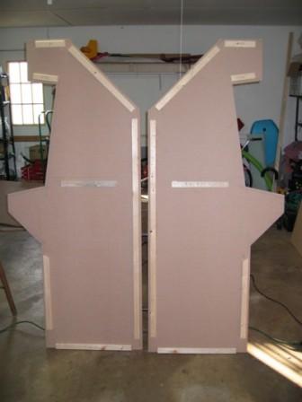

I've been considering different construction techniques for the Gauntlet cabinet that I want to start building next month.  I'm a woodworking noob with few tools and little budget, so I think I'm going to go with the simple technique I see many builders use: an extra piece of wood at each join, into which both visible boards are screwed.  You can see these extra bits of wood here:
This image is from Doc's MAME Cabinet, and he refers to them as "battens."  From Wikipedia, it seems like this is a reasonable term for any extra strip of wood.  But I'm unable to find any reference, outside of MAME cabinet sites, for the use of battens in making a 90 degree join.
So: in woodworking circles, what do you call this joining technique?  And, is "battens" the proper term for the wood used?
Finally, since I'm on the topic, I'm hoping that I can use 1x1 pine for my battens (or whatever), and screw into these without pilot holes.  My thinking is that the pine will be soft enough not to split when I do this, and by skipping pilot holes, I avoid the possibility of having them misaligned.  What do you think — will that actually work?

I'd do pilot holes if you have the equipment, personally. Countersunk, even.

That and pine will split very easily without pilot holes, especially on something that small and if you are anywhere near the end.

OK, it sounds like pilot holes are necessary.  Rats.
I was planning:
  • Drill and countersink holes in the MDF/plywood panel, large enough that the threads slide right through.
  • Clamp the batten in place, carefully measuring to make sure that the second panel will end up positioned correctly.
  • Drill smaller pilot holes in the batten (through the holes in the panel) — only as wide as the shank of the screws.
  • Screw 'em down.
My concern here is in step 3; since the batten pilot holes are smaller than the panel holes, it will be hard to get them exactly centered.  And if they're off at all, it's going to cause the batten to shift when I put the screws in.
I suppose what I could do is reorder things a bit... clamp it down, drill the small holes first through both pieces of wood, then go back with the larger bit to drill (and then countersink) the panel.  This would ensure that everything is perfectly aligned.
Wow!  It's such a simple thing, and probably seems obvious to most people, but I feel like I've had a real epiphany here.  Not only will this new procedure be more reliable, but it's less steps too!

My technique:
Put some glue on the batten
Put the batten into place
Use my little brad nailer to attach it
Even if you are planning on screwing, I would recommend using some glue in there.

Mostly hear batton, and I use furring as terminology, but they are both technically wrong. (Furring and Batton are both used in woodworking as spacers, not a joining method.)
The actual, technical term for the joint is a block joint, or a block reinforced butt joint. The name of the wood strip is a corner block. Also called glue block.
