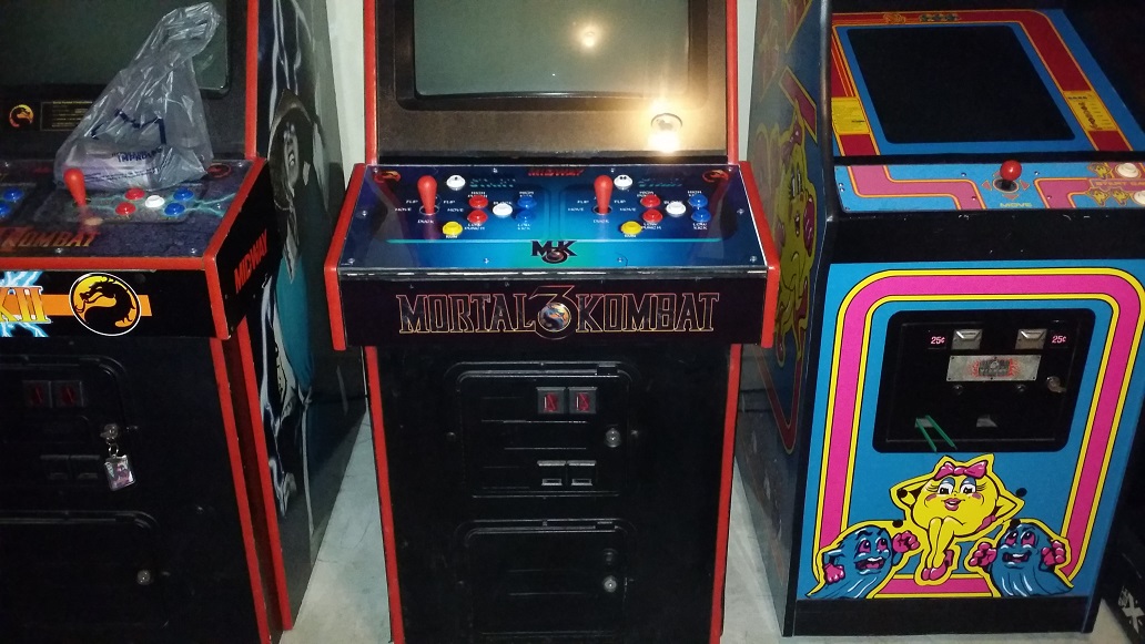

Here is how I got Ultimate Mortal Kombat 3 Golden Tee98:
stripped the CPO and swapped the marquee:
sadly the MK3 board I got with the cab was DOA
guess they had to make room for the trackball!
Luckily I got a UMK3 board from MK3Fan, with the UMK3TE public beta roms:

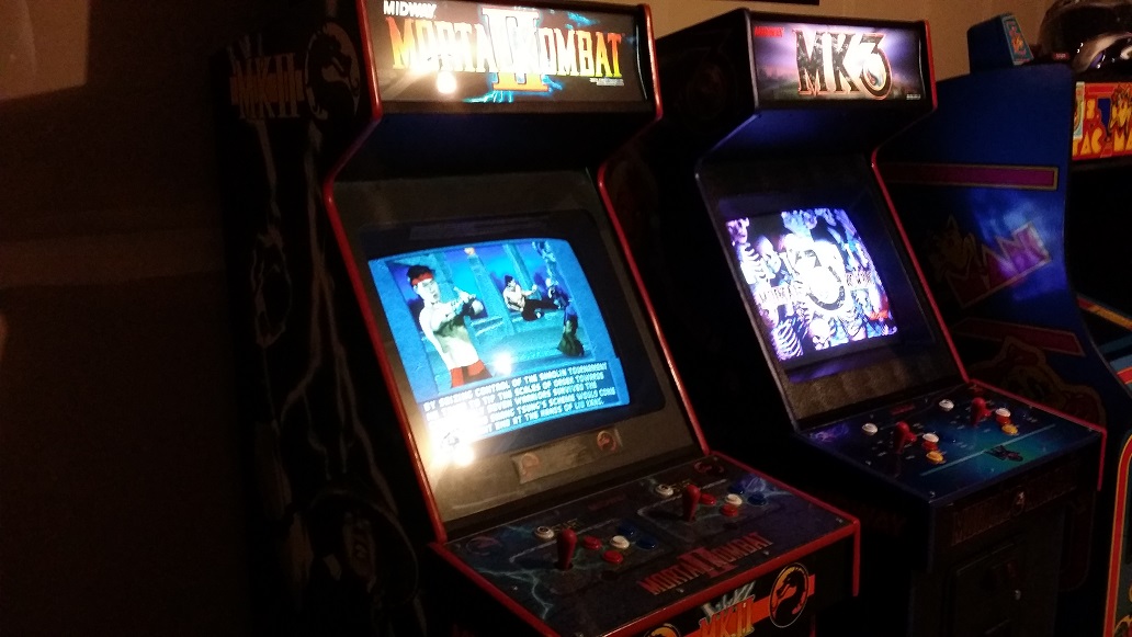

UMK3TE public Beta select screen, its like the juggernaught hack but with some other changes:
Jax vs Noob

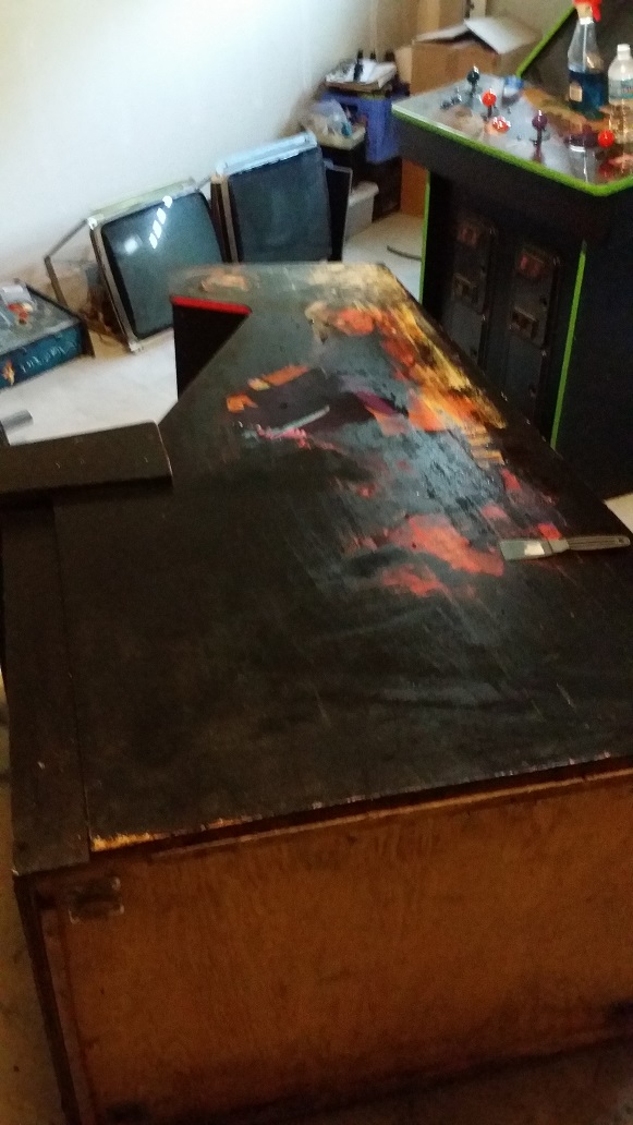

so , thanks to MK3Fan, I got the front art, and thanks to stpcore I got it printed:

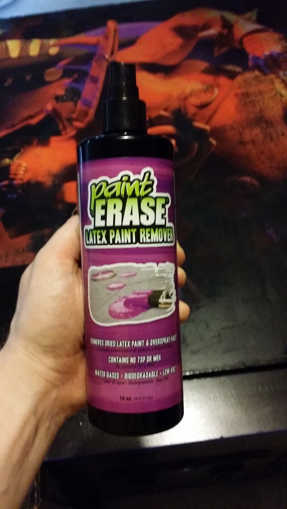

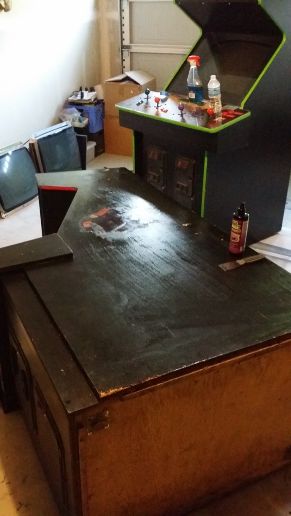

Now everyones favorite part, getting rid of this ---steaming pile of meadow muffin---:

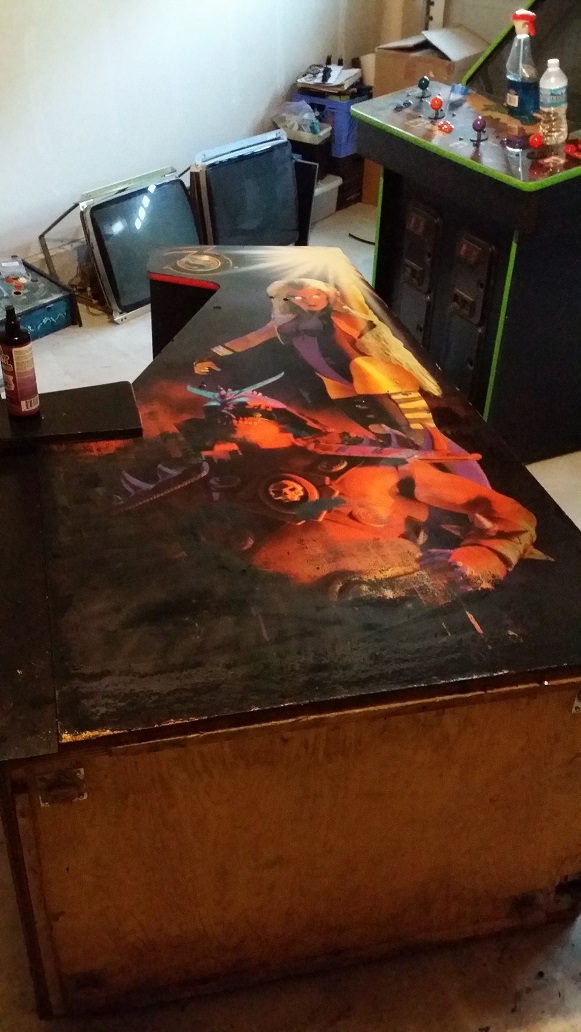

I have a new favorite paint remover:

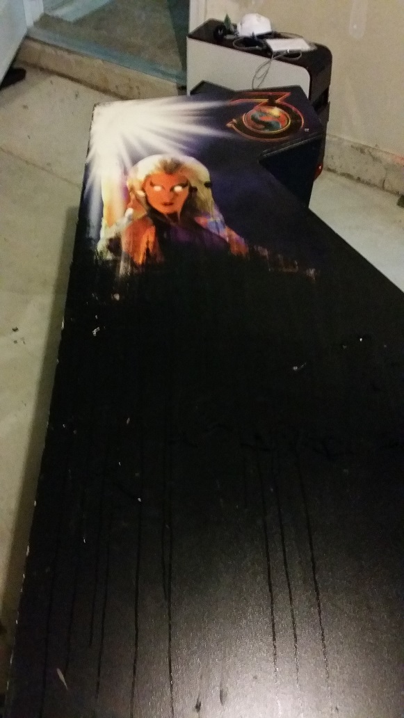

A little bit of progress:
WOAH, We're half way there......
and done this side:
there is just a little bit of paint on the bottom (both sides actually) that just wont come off. Its good enough for me.

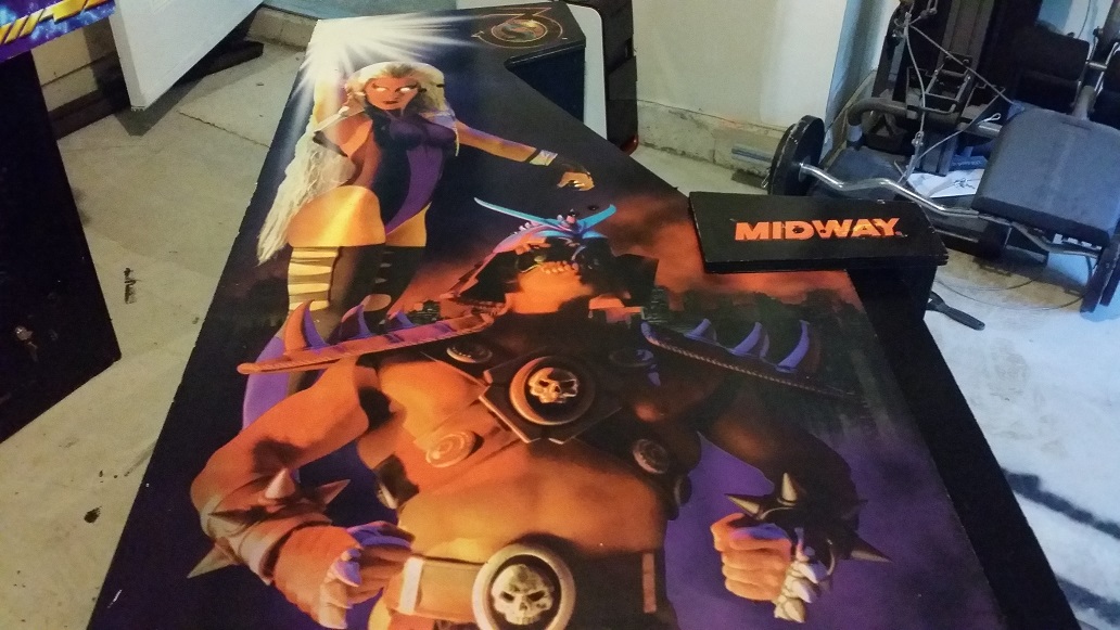

Applied the PURPLE tmolding:

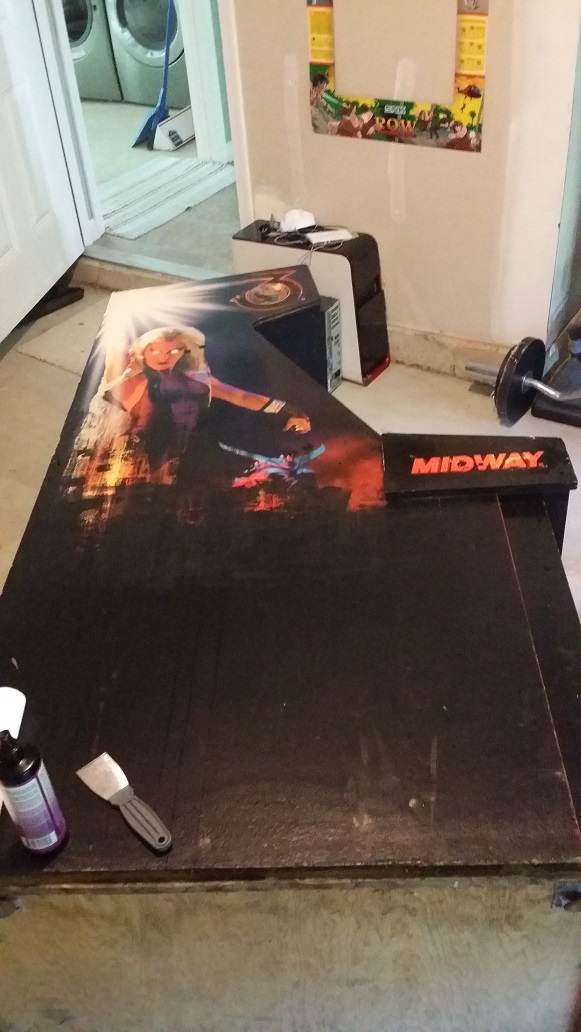

laid it back down, and got to work on the other side:
feels so weird scraping Lia Montelongo and Brian Glynn chests.

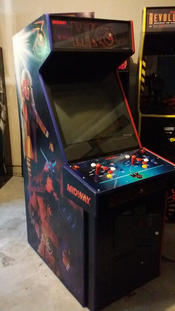

starting to see the light at the end of the tunnel:

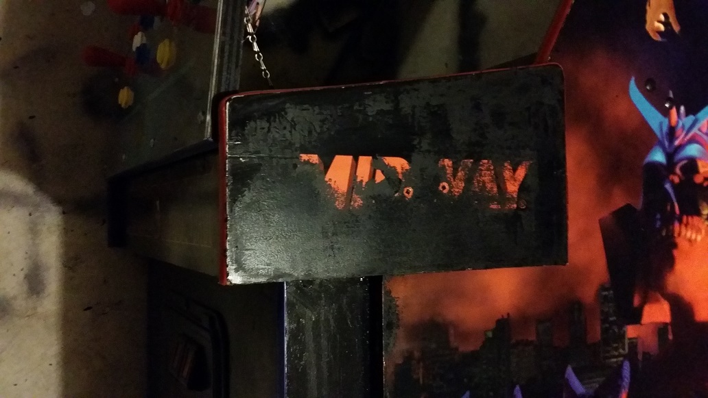

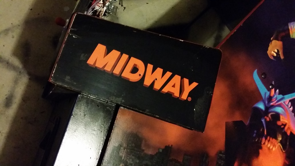

MIDWAY done scraping this logo /pun
all the way done so you can see the MIDWAY logo
just need to get the rest of the purple tmolding ordered and installed, then Im done!

That remover seems to work wonders.
Re: Lets watch Malenko turn GoldenTee98 back into UMK3!
« Reply #5 on: May 10, 2015, 08:30:45 am »
using it right, and scraping with a 2" scraper for about 10 hours works wonders.

Where'd you buy that stuff at, anyway?
« Reply #7 on: May 10, 2015, 02:19:46 pm »
Lowes
I went out and bought some at Lowes today, thinking it would remove the paint on my Stargate cab.  Well it cleans up the dirt pretty good and the odd drips of white paint, but the undercoat is still there.  I'm thinking if it would be better leaving the blue paint on.  It works OK but just don't get any on you.
I'm sure the artwork is hidden under this blue coat, but is there another method to get this blue ---steaming pile of meadow muffin--- off?
<I will insert pic>
« Reply #12 on: May 24, 2015, 10:27:31 pm »
<I will insert pic>
You have to remove the paint 1 layer at a time. The stuff I bought is for removing latex based paint, if its enamel you need to use something else.  If it is latex paint, the only way to use the stuff is to leave it on longer and scrape harder. When I paint scraped Mortal Kombat 4 , Mortal Kombat , and Killer Instinct it took at least a dozen hours each. This time with the UMK3 cab, it only took a total of maybe 6 hours. Whatever you do, dont use Citristrip unless you want to strip it down to the bare wood.
