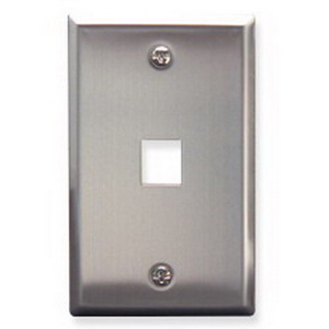

I got a little carried away with the jigsaw and made the hole bigger than I needed. There's NO way to redo the whole piece so is there a smart way to fix the problem.  This is a IEC plug/port and I tried to look for a bigger one to fill the hole. My next thought was to find some kind of do-it-yourself rubber grommet or something rubber like that I could cut out around the plug in a nice square or rectangular pattern.
Any other ideas how to fix this. It's in the back of the 'cade on the very bottom so it's obviously not noticeable but still...... Would you want your perfect work of art to have this on the back. Me neither if I can help it.

Maybe fill in the void with wood putty or bondo then paint?

Or a metal Face plate cover painted black to cover the area and make the cut out for the plug port in it  :dunno

I would do a faceplate as JDFan mentioned. Buy 3 just in case you need to practice your cutting skills. The "indestructible vinyl" ones cut nicely and don't shatter the way the brittle plastic covers tend to, and I think they are like $.70 each for the blanks. The metal ones are a little more, but if you're going to be painting it anyways might as well save the hassle of cutting metal...

Thanks for the suggestions. I was able to go to my local electronics store and find a wall plate mini.  I had the worst time trying to cut out a hole for the IEC plug. Too small to use a router on.

To me, the switch plate would likely look like a band-aid fix. I would either go with the larger switched plug or fill it and sand it and repaint it.
