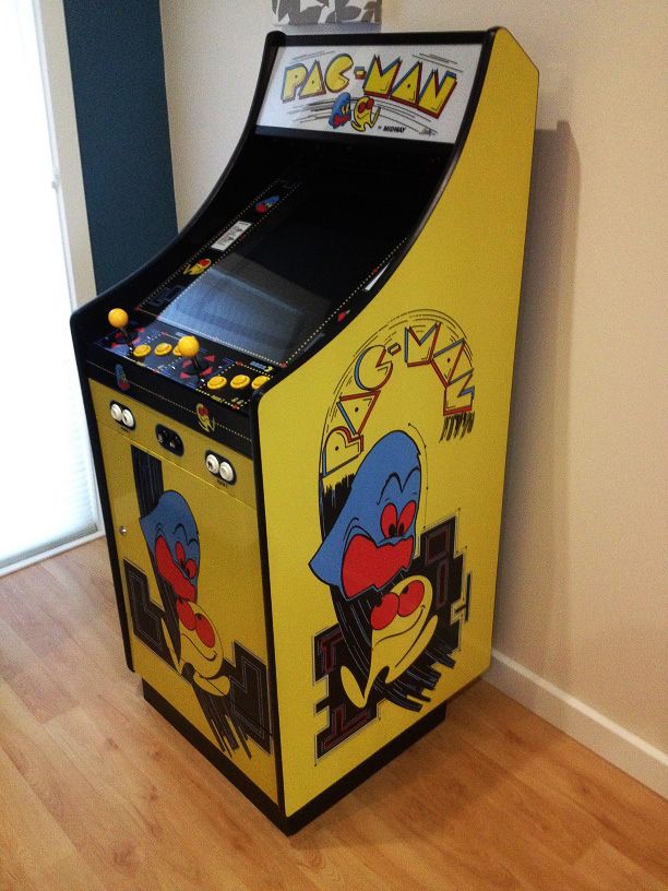

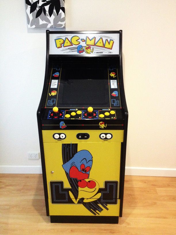

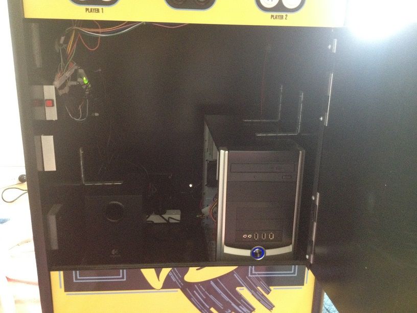

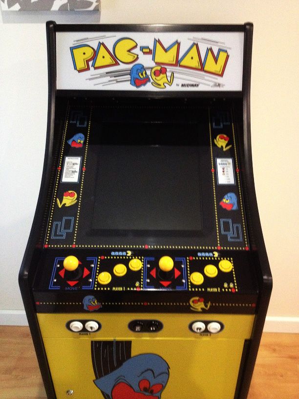

Finally finished off my pacman lowboy arcade machine.  Got this old gutted lowboy cab a couple of years ago and have been working on it slowly ever since.  Runs a 19" LCD in vertical orientation, Mamewah running Vertical games only.  Custom made CP and bezel art using the original Pacman art.  Thanks to the arcade art library for the original art!

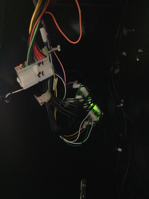

I used the cabling off of an old ATX Power supply  as the main cable for the control panel.  This gives me one plug to allow the CP to be fully removed if need be.  It connects to an ATX power supply extension cable which in turn connects to the IPAC.

Love the idea of recycling the ATX connector!

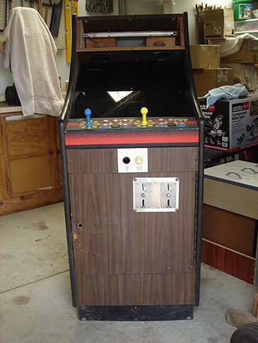

This cabinet looks great. I am a huge fan of lowboys and I'm strongly considering building one.
This is what an actual pacman lowboy would have looked like (except for a coin door and single stick).

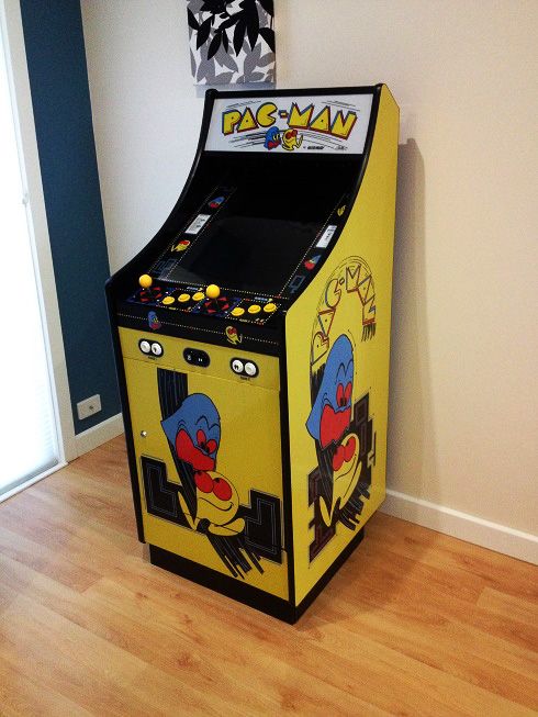

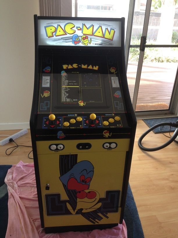

Thanks for the compliments.  I love lowboys too.  Probably the most common cab here in Australia back in the 80s and 90s.  Yes unfortunately the photos don't do it justice.  Here are a few more photos with the room clean.  The iphone camera still would not take a decent photo though!

Wow, those pictures really do show off the build a lot better. Either the first or second of the pictures look like candidates to update the 'I completed my project' post ;)
