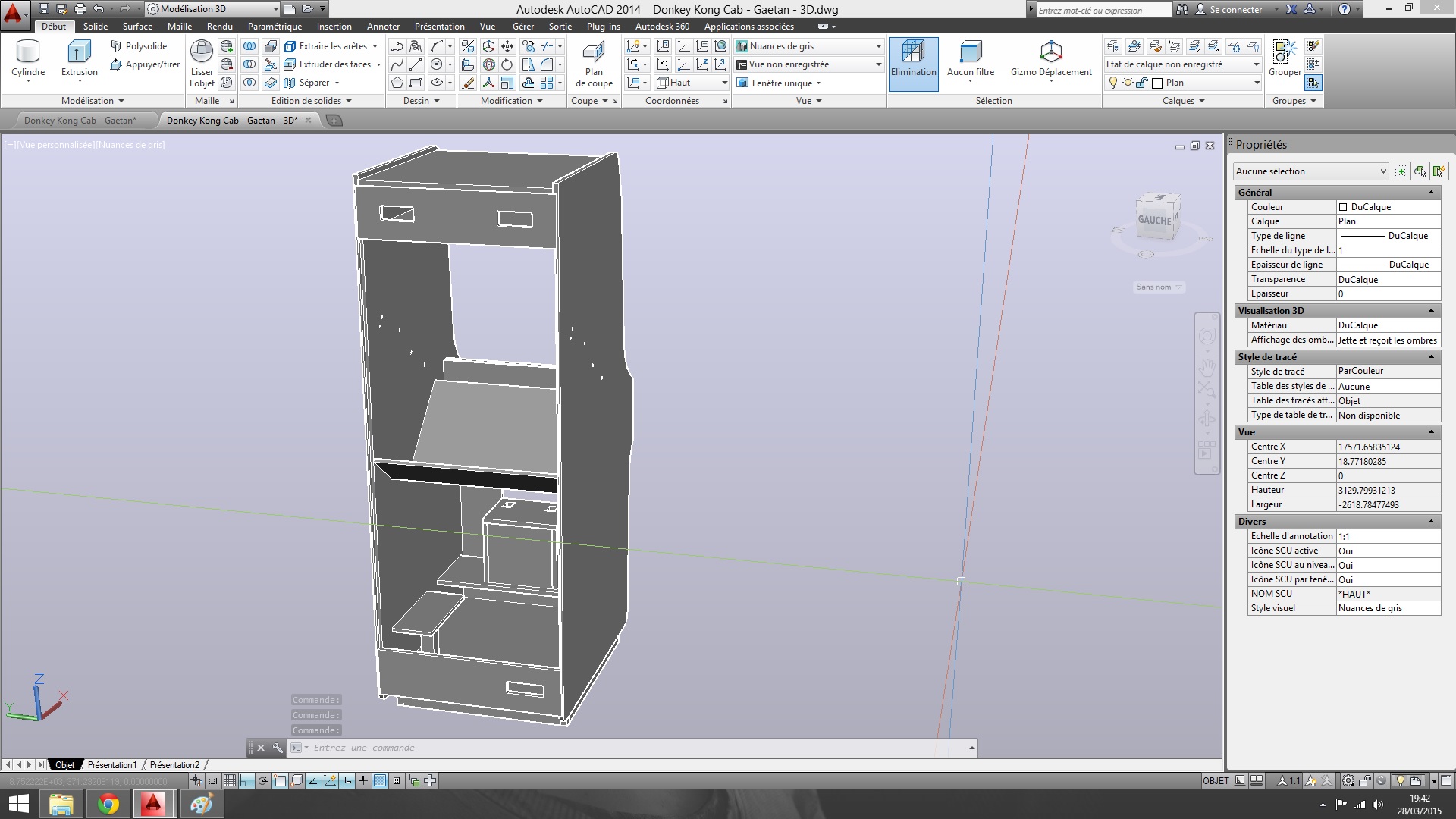

Hi !
I start making plans of the Donkey Kong cabinet.
Does someone can help me and give me some measurement of the original cab ?
First i would like to check measurements N°26, 29, 30 and 34 (on the side)
My plans are in millimeter (because i'm french  ;D) but you can give me in inch.
Thank for help !
Gaetan

Gaetan
  • Posts: 62
  • Last login:February 03, 2018, 01:12:51 pm
    • Arcadecab.fr
Re: Donkey Kong plans
« Reply #3 on: March 08, 2015, 04:18:56 pm »
Thank you ChanceKJ for this deal !  :applaud:

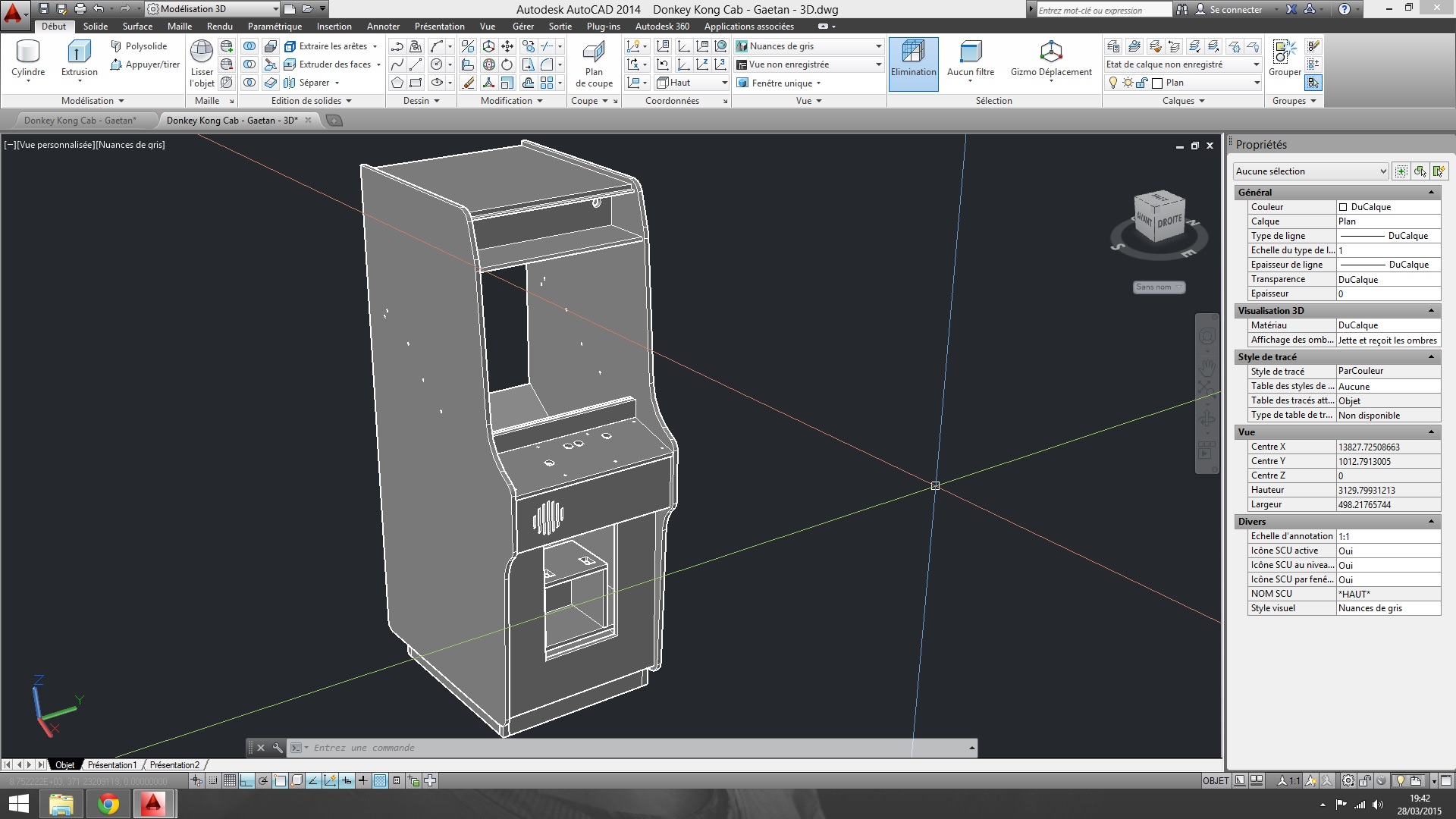

All my files (plans DWG, DXF, PDF, photos about the cab) can be download at this adress :
http://www.arcadecab.fr/
There is a word file call "Diverses dimensions.docx" with measurement i found on the web.
Yes i know about internal things.
I thing we must start with the side and external things.
I can update my plans with your measurement and put it on my website.
And why not make a 3D model in the end.
Sorry if my english is bad.  :embarassed:
I try to do my best.  ;D

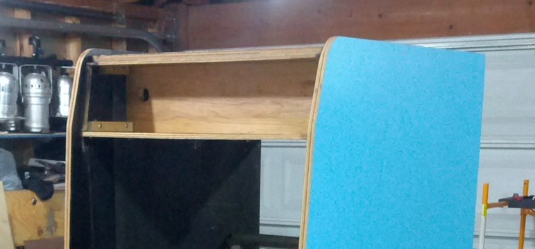

ChanceKJ
  • Posts: 3229

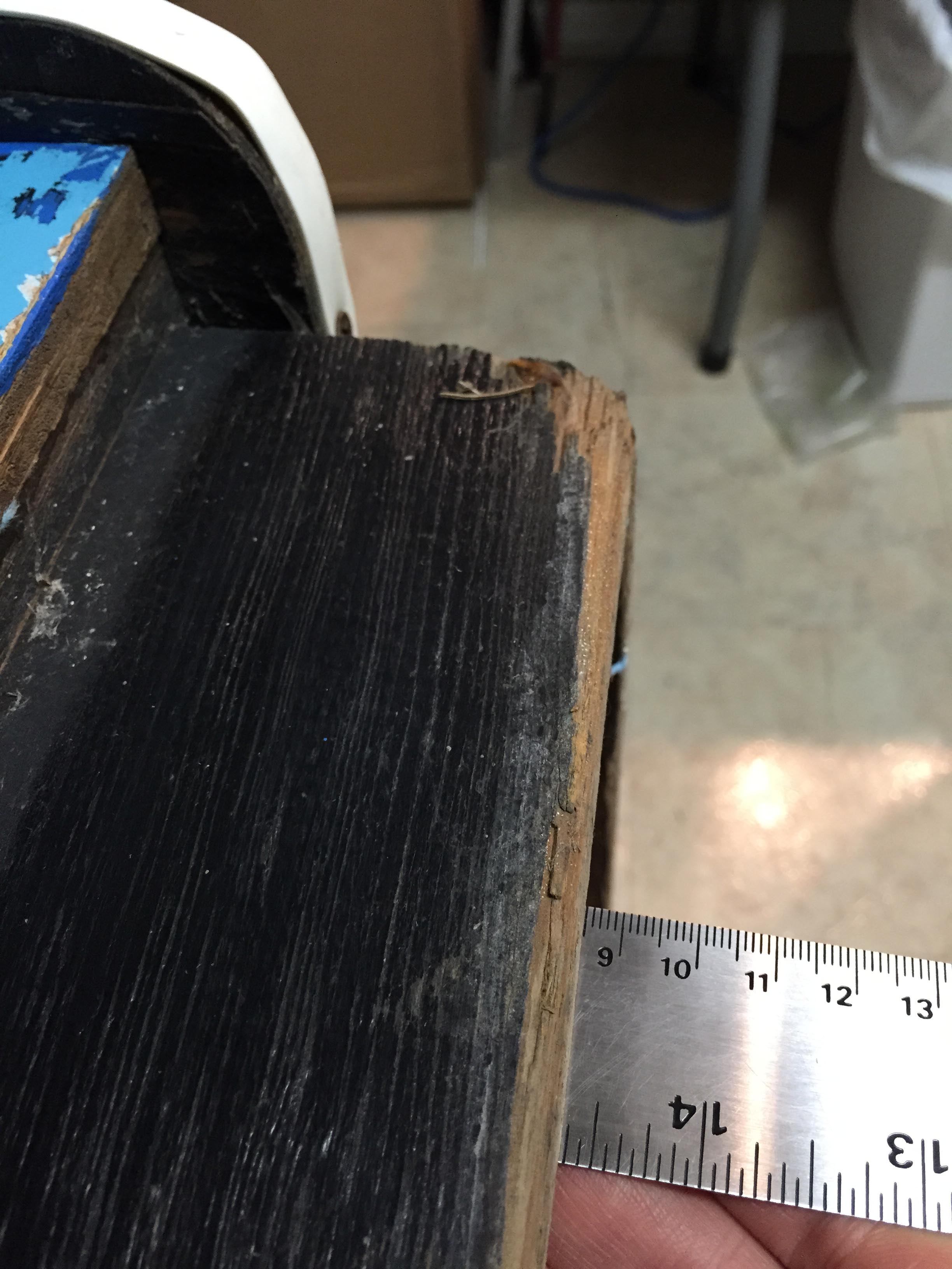

« Reply #4 on: March 08, 2015, 05:29:25 pm »
No worries,
Yeah, the crappiest thing in the world when building these are the exact dimensions of the side panel curves. If you can make your file something people can just print out and cut with that would be AWESOME.
I took some pictures so you could make some decisions on what measurements you wanted. She's a little beaten up, but these should work. Also took some shots of the inside for when you're ready for those. You're mystery height on the inside as well. The pictures look a little crooked, but i used a level and a square to make sure the measurements were as close as possible. All measurements were taken without the edge of the t-Moulding (like the height), so its wood edge to wood edge.
Here's your mystery internal one. There is no piece of wood here. These cabs used a cardboard bezel that came off of the top surface. This picture just shows what i'm measuring on the inside:

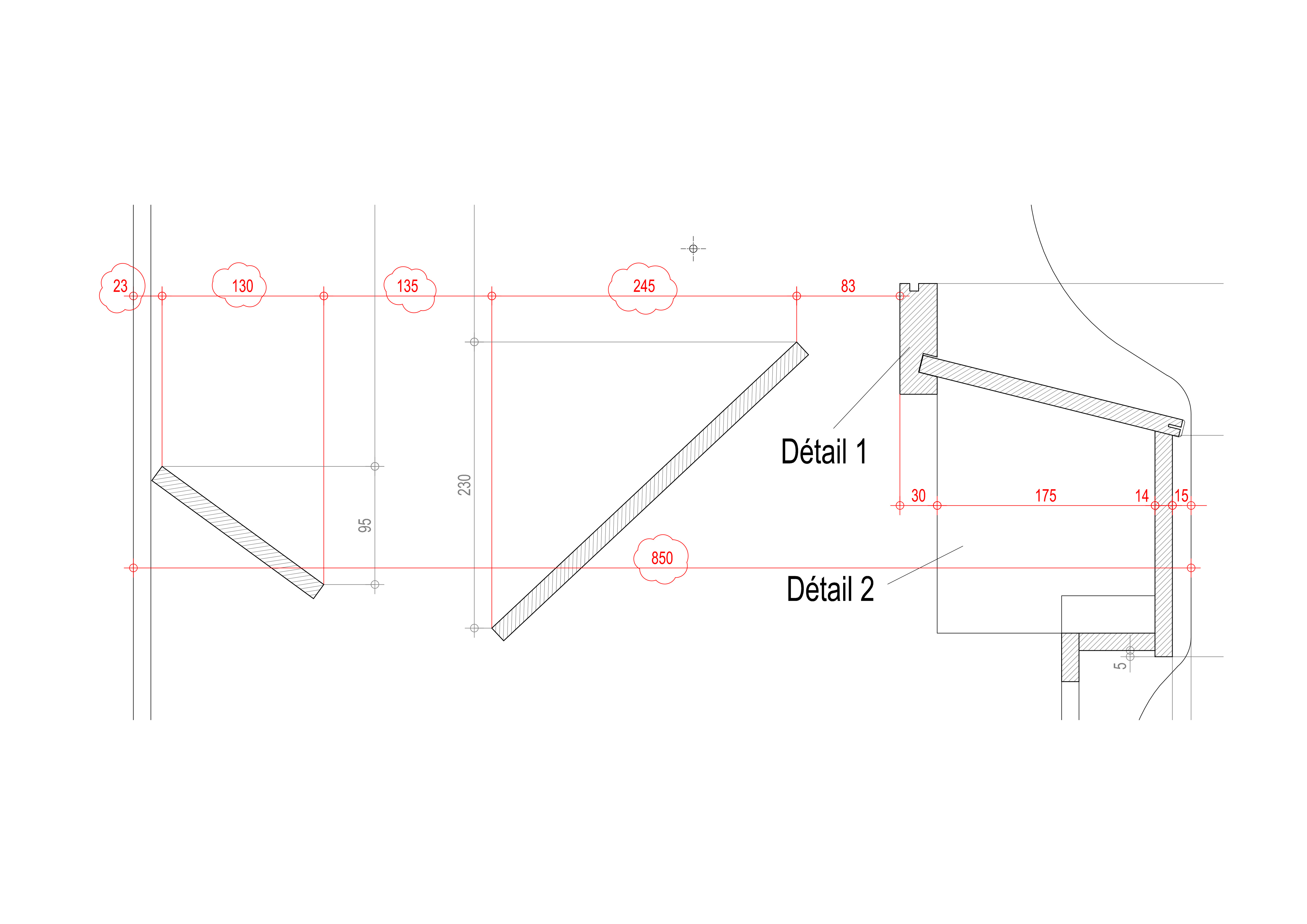

« Reply #9 on: March 09, 2015, 04:11:37 pm »

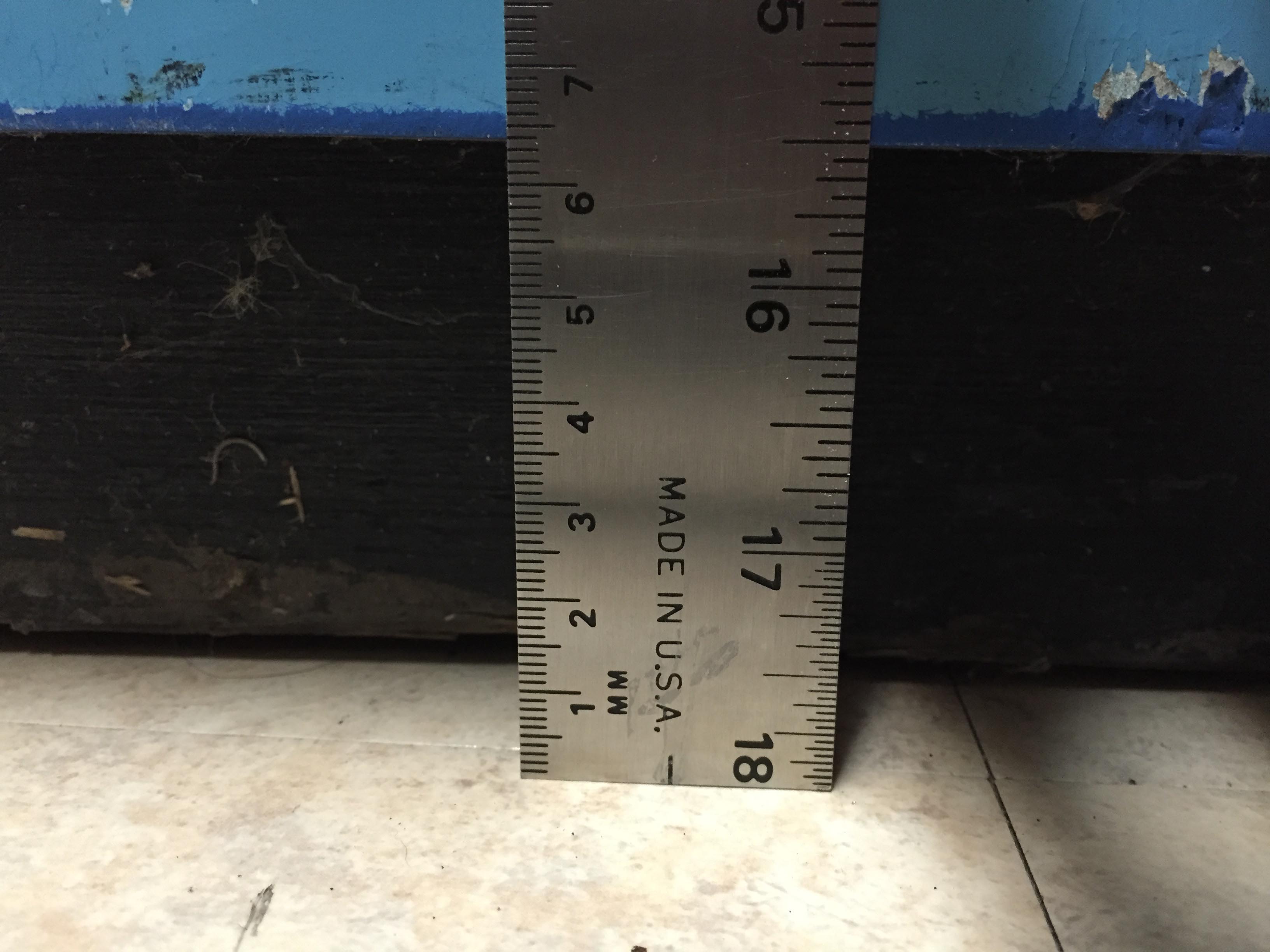

Ok ChanceKJ !
I think I undestand what you want : A PDF file scale 1:1 ready to print to draw directly on the wood.
Of course it's possible !
Your empty cab is perfect to take measurements !
I keep your pictures preciously.
It's measurements without T-molding and it's perfect.
So :
N°26 = 850 mm
N°29 = 64 mm
N°30 = 1632 mm
N°34 = 180 mm (about)
Now i know exactly overall dimensions of the side panel.
Do you think you can send me a picture with good resolution and taken profile of the cab (at half height) ? If necessary I can correct perspective of your picture (with photoshop) and supperpose with my plan. That will give me idea of real curves.
Now i'm interested for the measurement n° 6, 7, 8, 9, 10, 11, 20 and 21.
Ho juste a detail. You gave me measurement n°29 = 64 mm but i think there is little "feet" under the base. It's 64 mm from the floor. Therfore i need measurement n°11 from the floor too (or the difference between n°29 and n°11).
I hope you will anderstand (i think so). ^^
I think we can do a good job. :)
Thank you again for your help.
Gaëtan

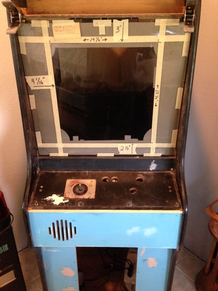

ChanceKJ
  • Posts: 3229
« Reply #12 on: March 13, 2015, 12:29:05 am »
Yeah, sorry, the floor is uneven, and the base on this thing is a little beaten up. :D
Just more work for me later when i restore it i guess.  :dunno
Click each for a high res version.
#6
#7 (i think?)
#8
#9
#10
#11
#20
#21

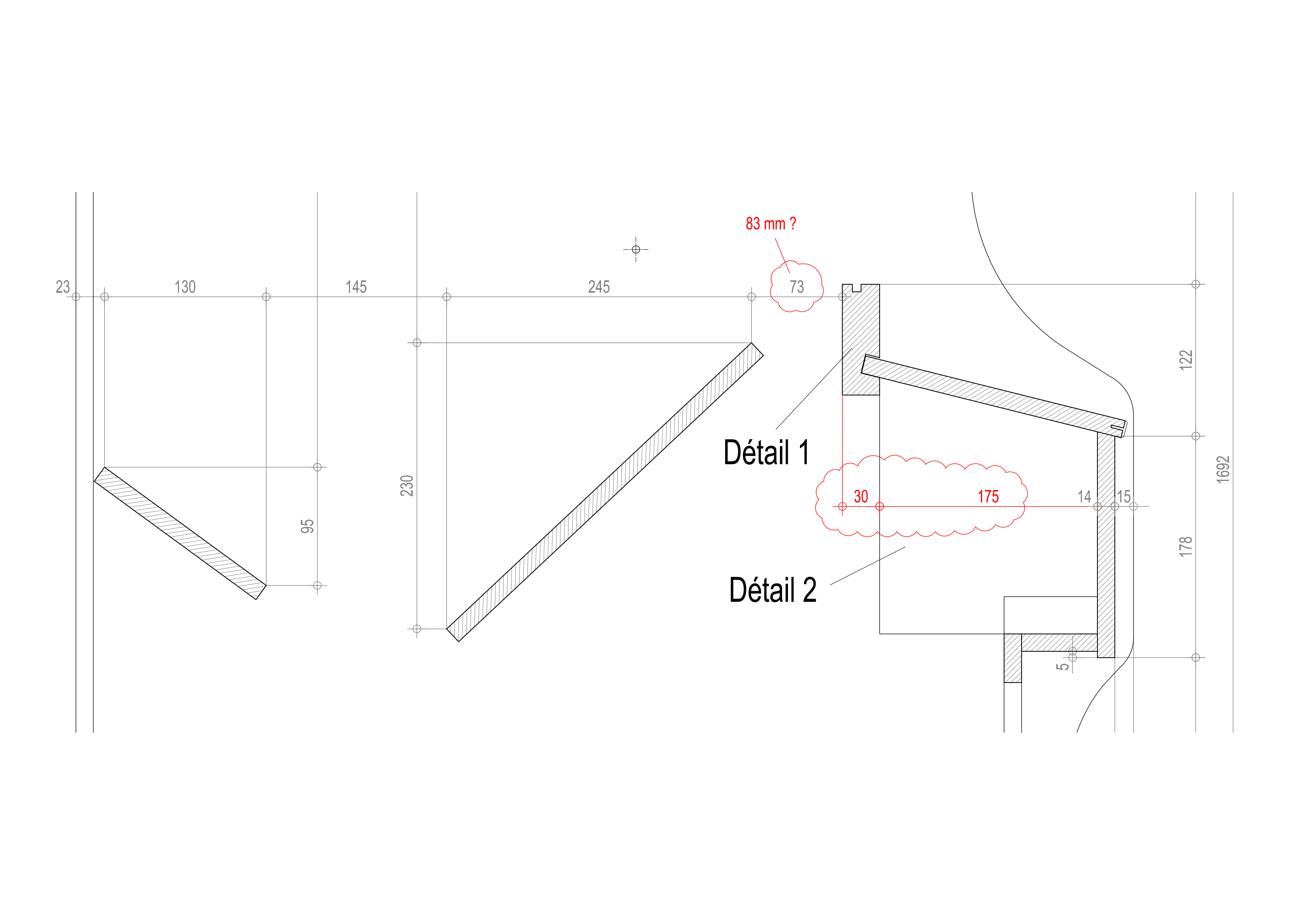

Gaetan
  • Posts: 62
    • Arcadecab.fr

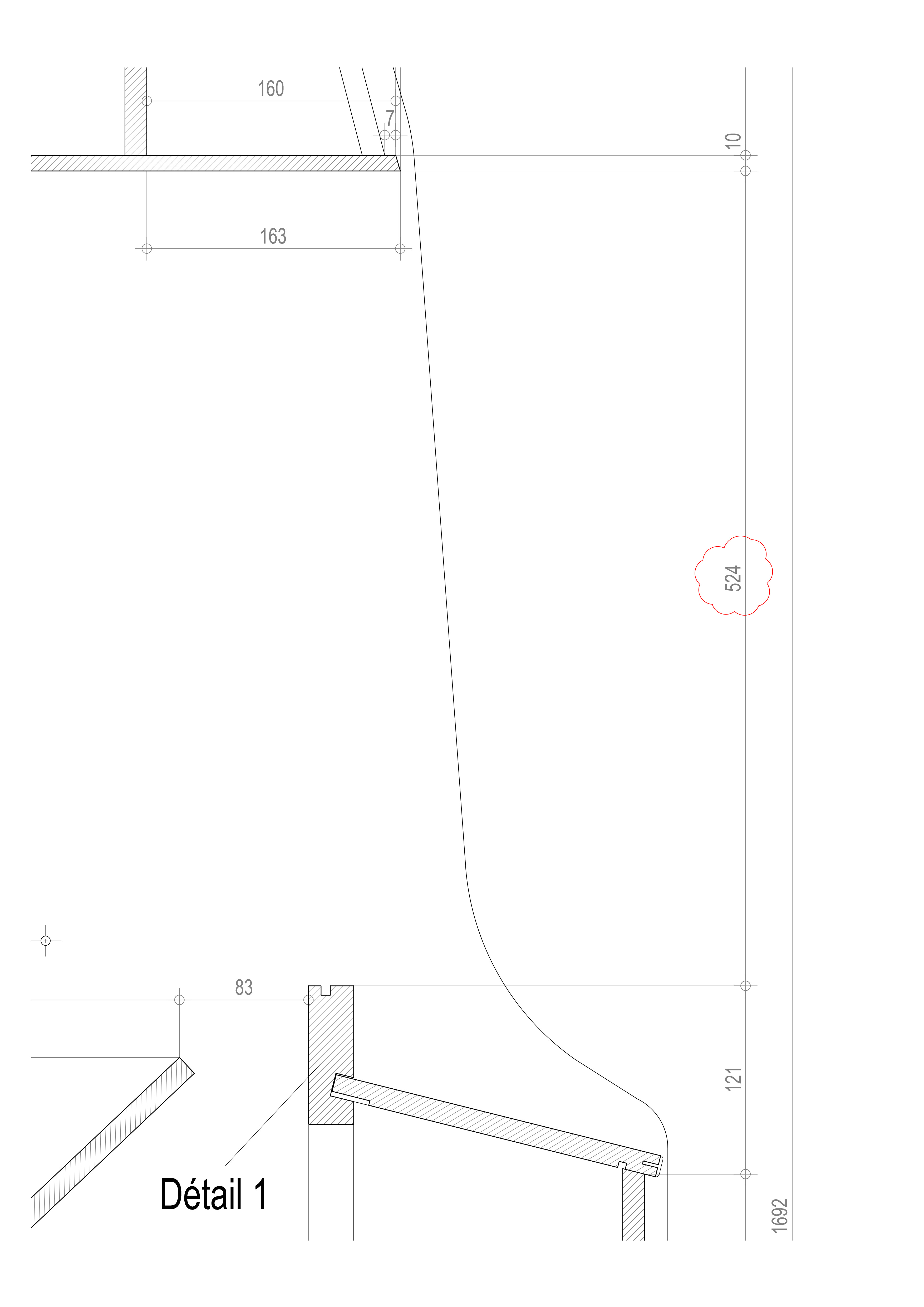

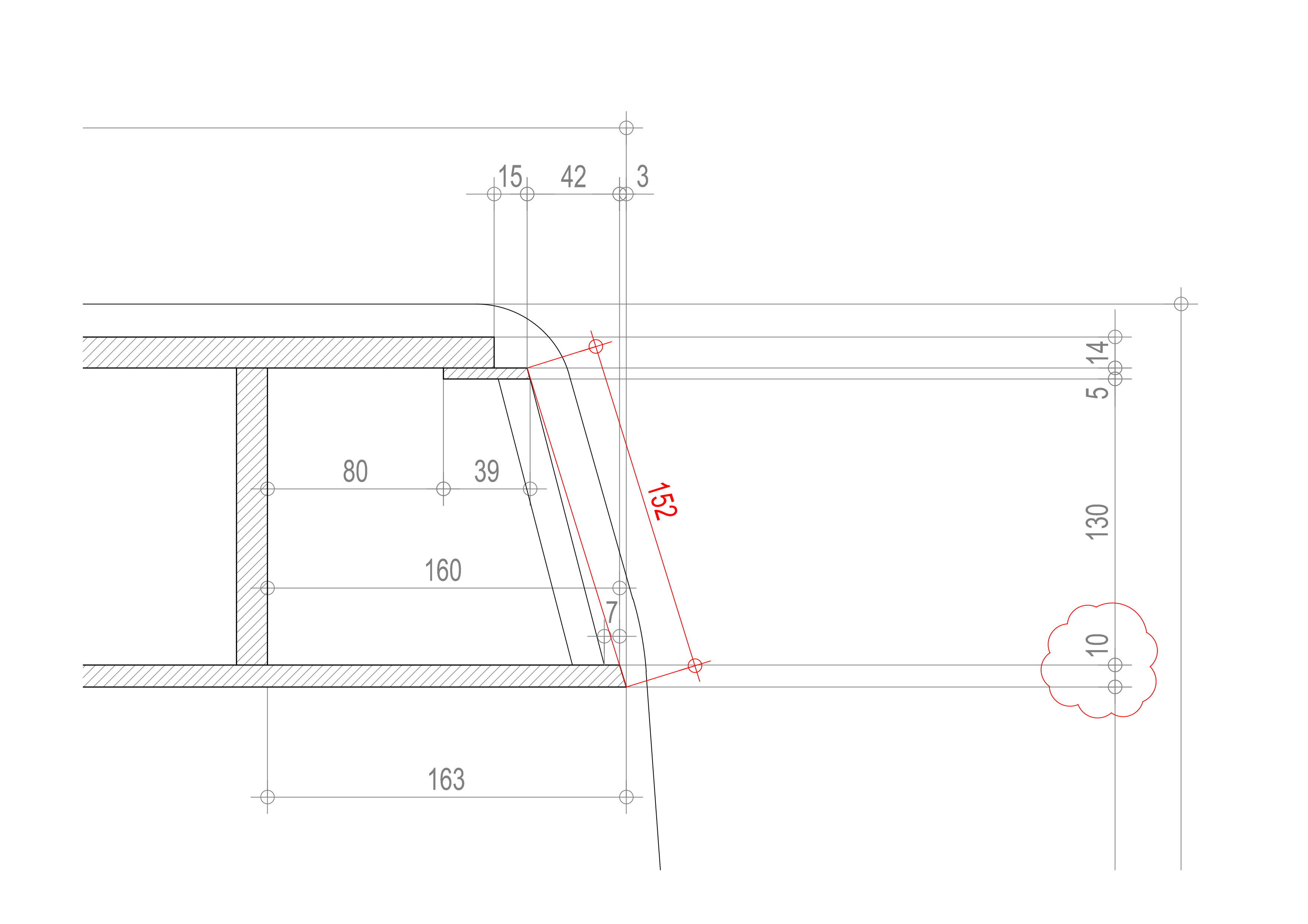

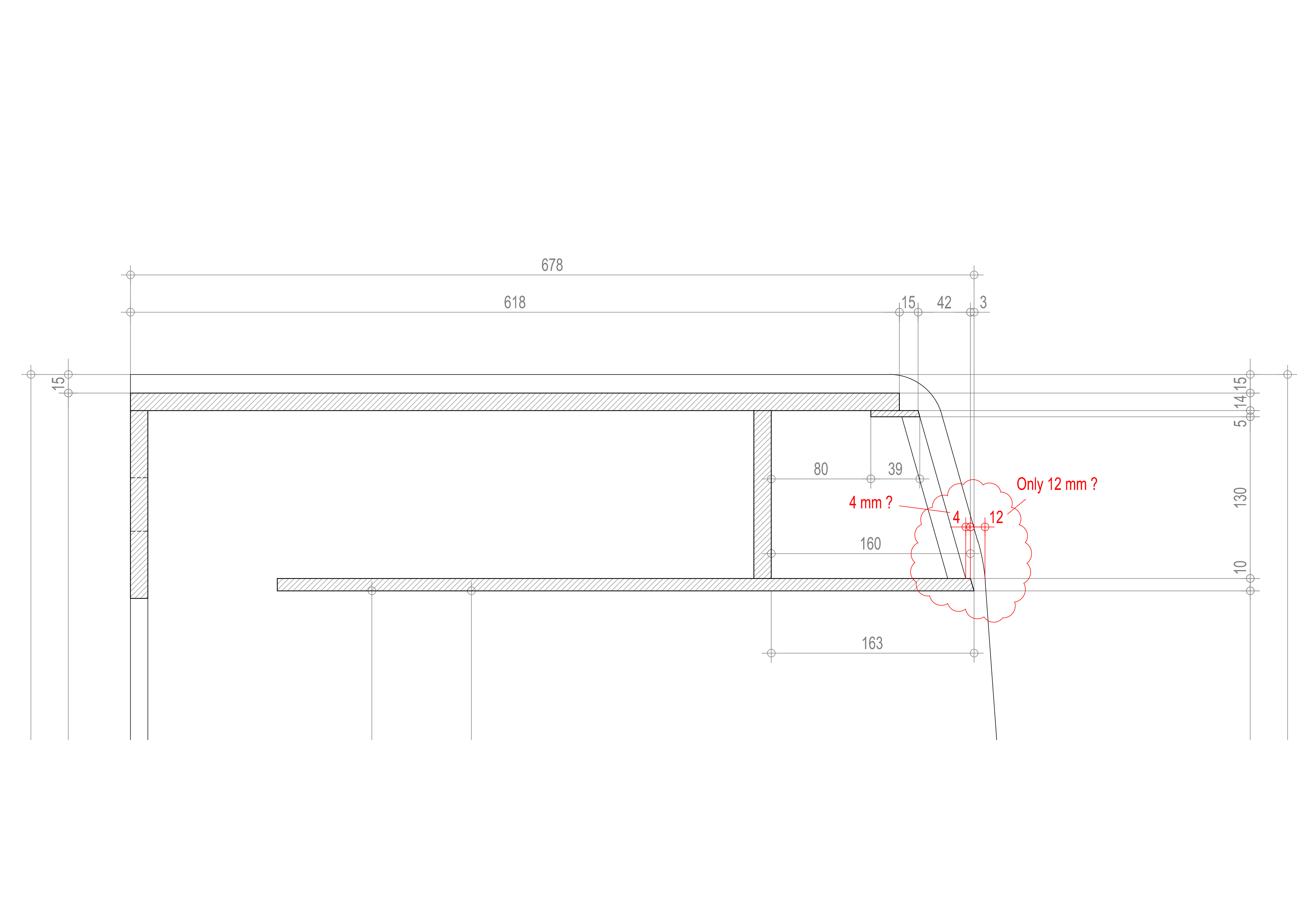

« Reply #13 on: March 14, 2015, 10:41:46 am »
Thank again for all these measurements.  :cheers:
The side :
The side with picture :
New plans :
Rear view :
Details 1 et 2 (panel zone) :
All files are here : http://www.arcadecab.fr/Donkey%20Kong/Plans/Gaetan/
Green measurements should be ok.
Red measurements must be checked...
Much work for ChanceKJ... :-[
Do you think you can check it ?
Gaëtan
ChanceKJ
  • Posts: 3229
« Reply #14 on: March 14, 2015, 07:33:16 pm »
everything on there looks pretty solid with the exception of two things. The first is #13, you have it at 20mm, it should be 13mm.  The second is the way the back panel cuts into the sidewalls but i mean, its more of a complicated thing to build. I'd say just leave this out of the design as it requires quite a bit more woodworking skill/tools/time.
Other then that it's pretty much the front speaker grill location and a couple internal structures for the coin box, PCB tray, and monitor shelf
Gaetan
« Reply #15 on: March 15, 2015, 01:51:23 pm »
Ok !  ;)
#13 = 13 mm (ok)
My details 1 and 2 are good ?
Just to not to make mistakes can you give me this measurements (#54 to #73) ?

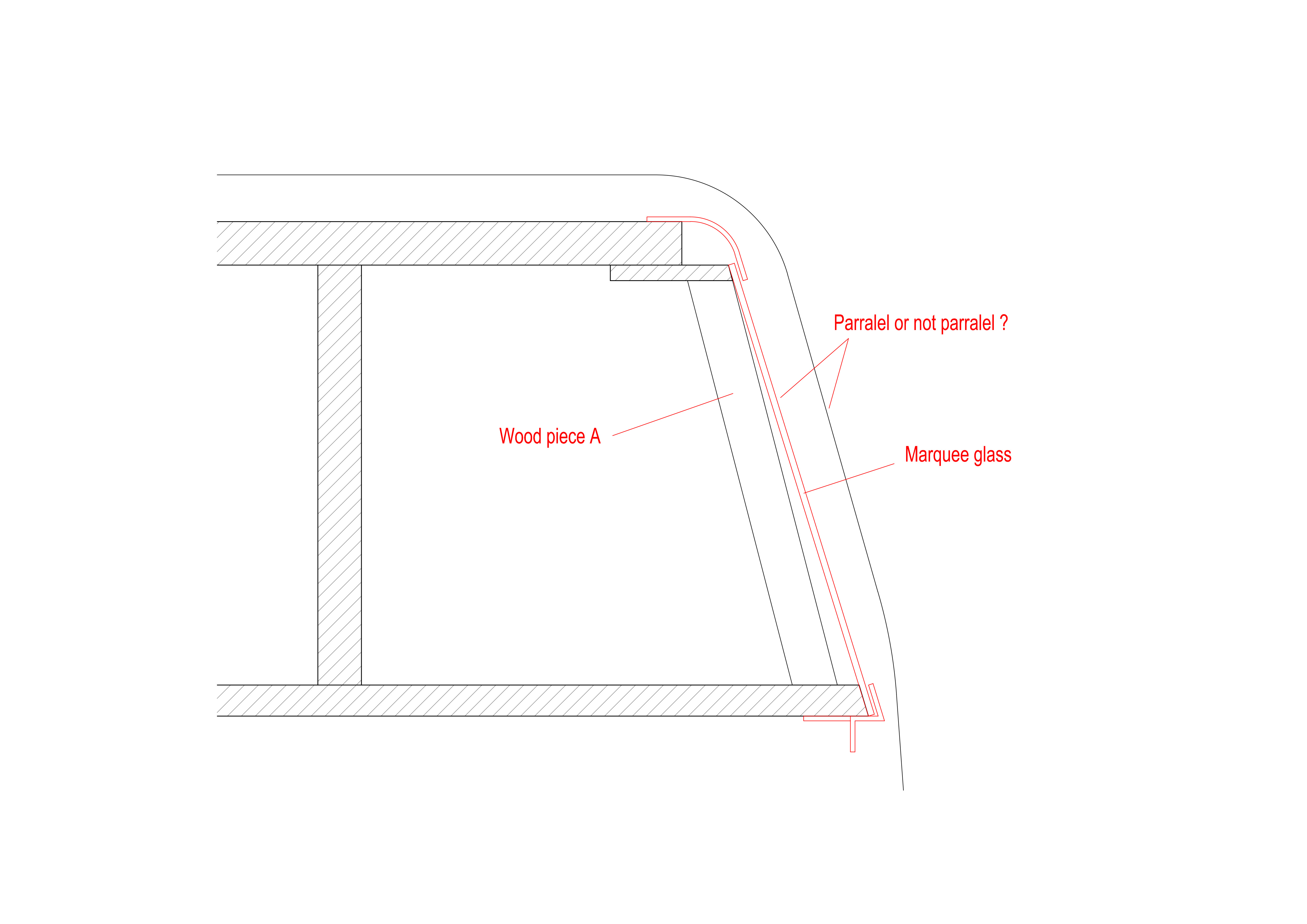

Marquee zone :
(2 wood pieces at #60 and #61 ?)
Hole for coin door and speaker grill :
I thing that after we can continue with internal things.
Do you have the control panel too ?
Gaëtan

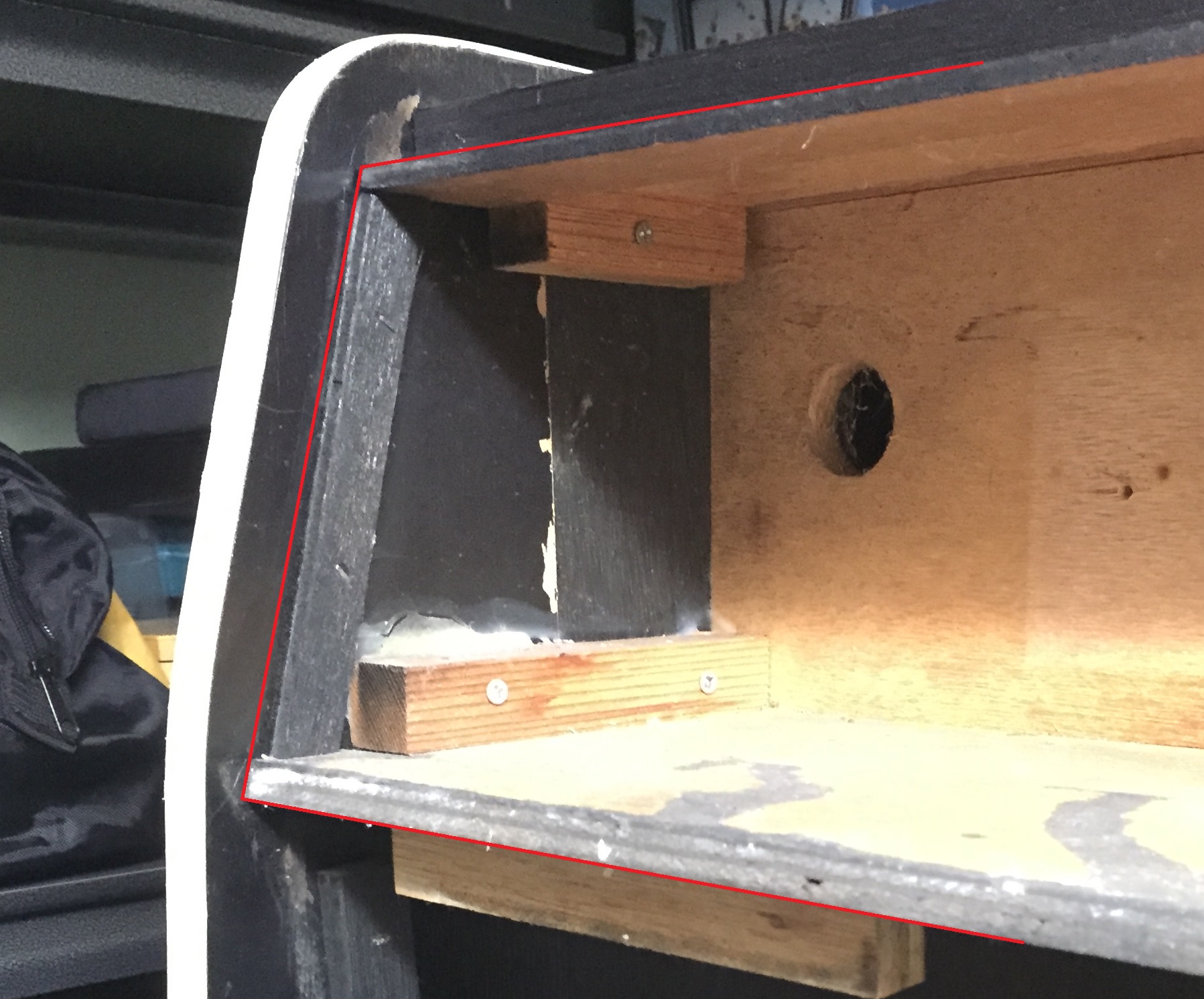

« Reply #16 on: March 15, 2015, 04:47:59 pm »

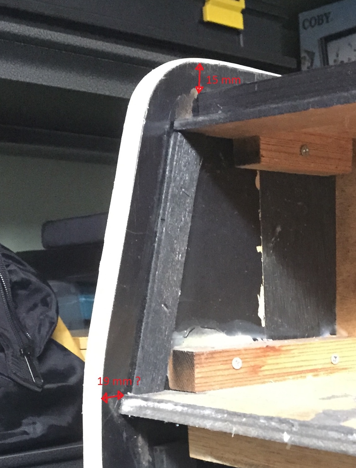

i only have metal control panels. I have 3 Vs panels and a DK3 CP coming in the mail over the next day or two.
Here's a look at the structure that makes up the inside of the Marquee area.
#60 = 15mm
#61 = 5mm
Haha, anyone following this thread is getting a real intimate look at my cab. ;)

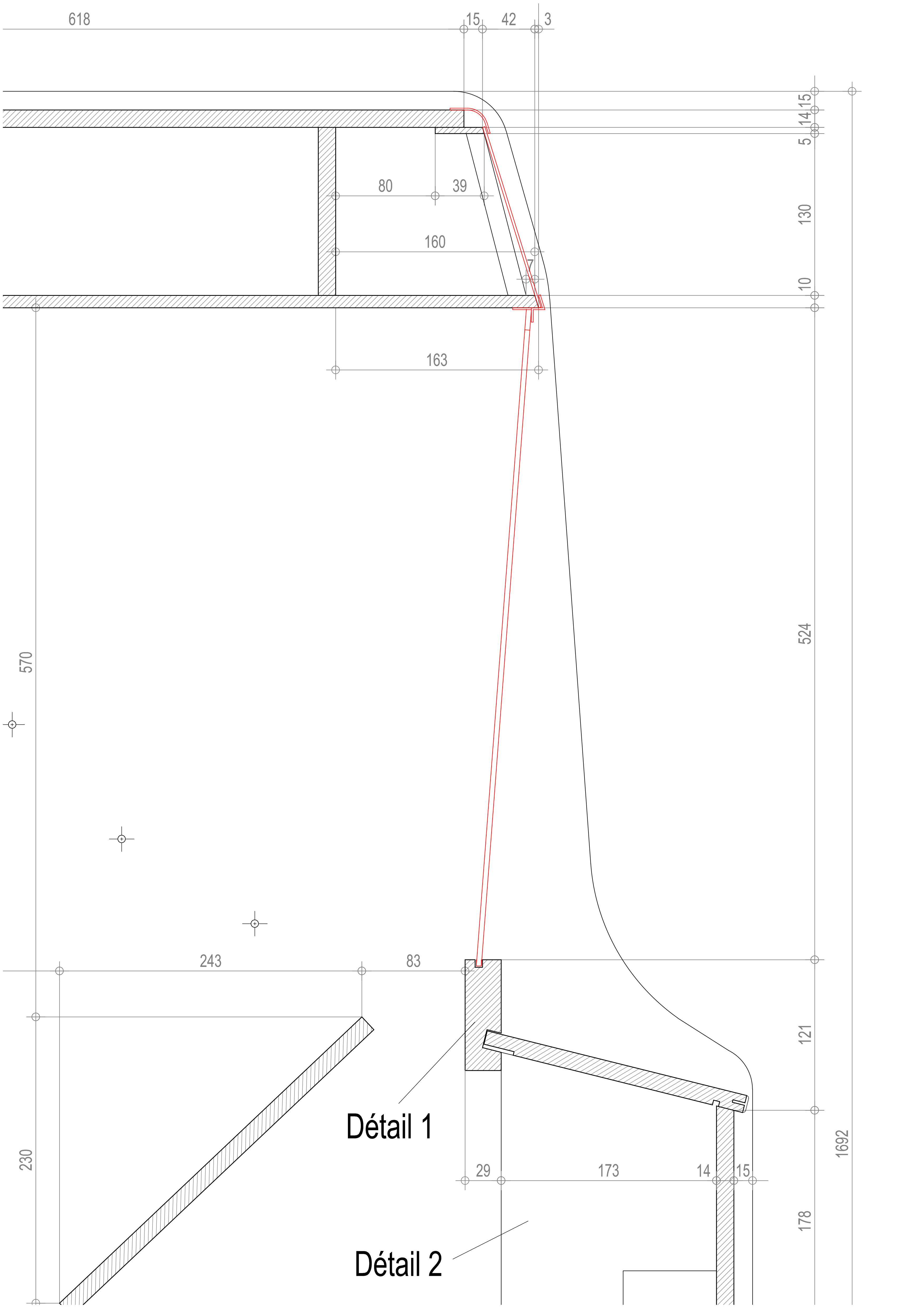

« Reply #17 on: March 15, 2015, 05:33:24 pm »
Ok. I correct.  ;)

    • Arcadecab.fr

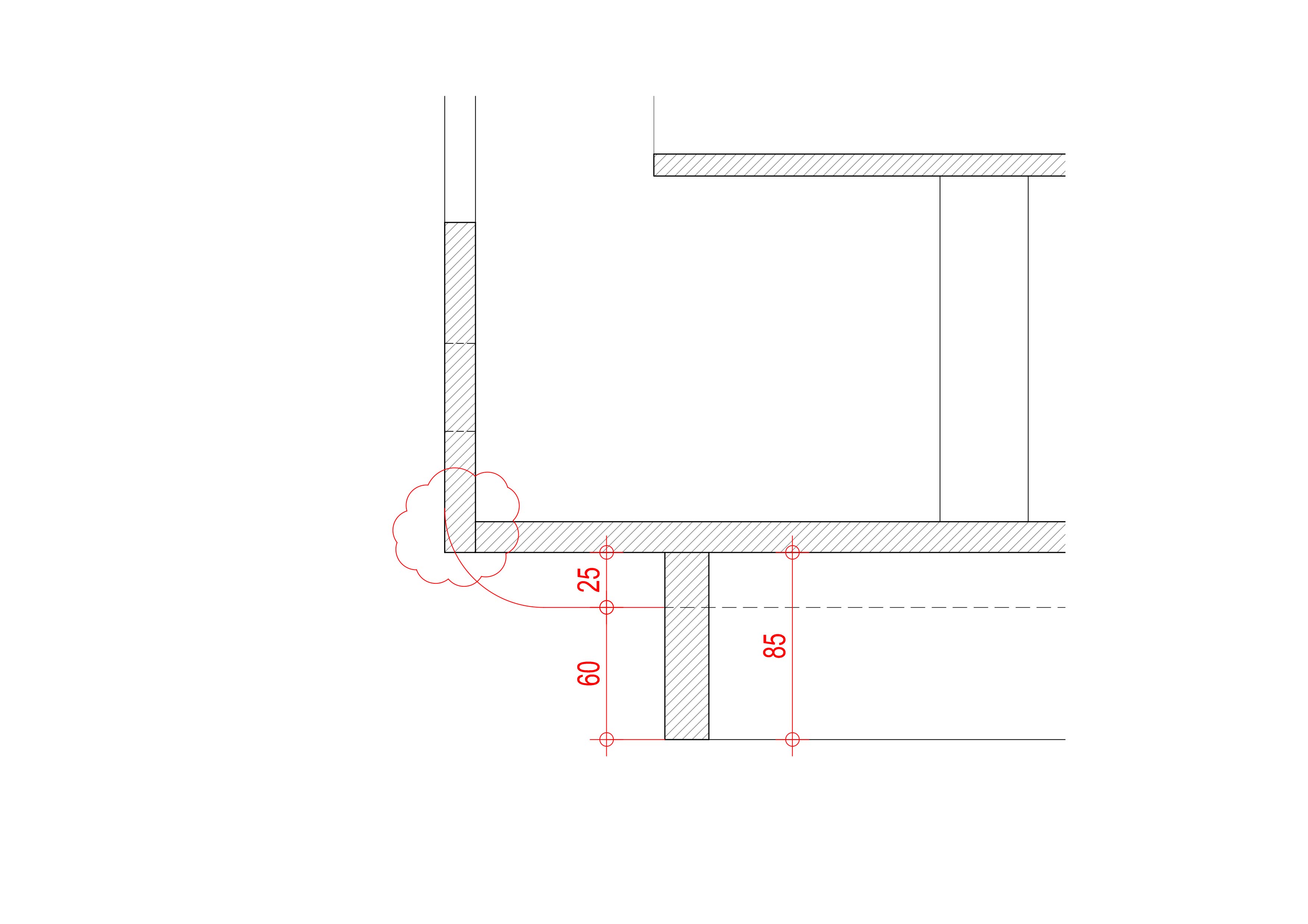

« Reply #18 on: March 15, 2015, 05:48:22 pm »
Here are the new plans :
Oups you just forgot #57, #58 and #59.  :-[
And the coin door hole (#65 is important because it's the widht of the cab)  :-[
Thank !  :notworthy:

« Reply #29 on: March 16, 2015, 07:09:57 am »
I continue with internal things.
I have no idea of the internal measurements. I drew from pictures.
And don't foget : ^^

Also, i can't seem to find the picture of it, but another thread has a picture with the dimensions of the top of the coin box enclosure showing the holes for the coins to fall through from the mechs to the con box. Mine's been ripped off. Here's a picture with my coin box inside its enclosure...

Here are the last plans :
Side :
Cut :
Front view :
Rear view :
Details :
Panel :
With a PDF 1/1 scale : http://www.arcadecab.fr/Donkey%20Kong/Plans/Gaetan/Donkey%20Kong%20Cab%20-%20Gaetan%20-%20Coupe%20(1.1).pdf
It's late for me now.
Good night every one !  ;)
Gaëtan

We still need to add the top of the coin box.
Hope this helps guys..
Gaetan
  • Posts: 62
    • Arcadecab.fr
« Reply #53 on: March 24, 2015, 09:51:21 am »
Perfect !  :)
Now i understand what is the top of the coin box. ^^
I will add it.
Thank !

« Reply #55 on: March 24, 2015, 04:48:30 pm »
Re ChanceKJ,
The two areas to be checked :
First (Marquee again) :
Is it real like this ?
Second (Panel) :
You gave me 83 mm but I have 73 mm...
Maybe you can find where the problem is.
Check details 1 and 2.
Gaëtan
ChanceKJ
  • Posts: 3229
« Reply #56 on: March 24, 2015, 10:23:47 pm »
Ok, for the first two i get: 7mm and 19mm.
for the second image (from left to right) i get:
-83mm,
-29/30mm
-174mm
Gaetan

« Reply #57 on: March 25, 2015, 04:25:58 pm »
Sorry if I ask you again...
But i can't reconcile the measurements...
First :
Are you sure for the 19 mm ? It doesn't look like the picture and it's not parallel.  ???
Second :
I think 850 mm is good but if I add up the other I have 10 mm more.
Maybe a problem with 130 mm, 145 mm or 245 mm (this doesn't seem easy to measure for you).
 :dunno

« Reply #58 on: March 25, 2015, 11:09:38 pm »
The 19mm on the top is actually 12mm.
I'll grab the rest durring the second intermission in the Flames/Dallas game ;D. Stand by.
ChanceKJ
  • Posts: 3229
« Reply #59 on: March 25, 2015, 11:59:36 pm »
Ok, in the second picture it's 145mm between the two monitor shelves. Is that your missing 10mm?
I just checked my previous post as well, #86: 14.5cm
« Last Edit: March 26, 2015, 02:50:37 am by ChanceKJ »

Yes I know you gave me 145 mm... It's precisely m'y problem because the width of side panel is 850 mm.
I will check all measurements again. ;)
Ok for the 12 mm ! :)

« Reply #62 on: March 26, 2015, 04:28:04 pm »
So, I check pictures and measurements.
You gave me :
A = 20 mm
B = 130 mm
C = 145 mm
D = 245 mm
E = 83 mm
F = 29 mm
G = 173 mm
H = 14 mm
I = 15 mm
A+B+C+D+E+F+G+H+I = 854 mm
and J = 850 mm (not so far finally... just 4 mm)
I will take these measurement for my plan :
A = 20 mm
B = 128 mm (-2 mm)
C = 145 mm
D = 243 mm (-2 mm)
E = 83 mm
F = 29 mm
G = 173 mm
H = 14 mm
I = 15 mm
A+B+C+D+E+F+G+H+I = 850 mm !  :applaud:
It's looks good for you ?
Gaëtan
ChanceKJ
  • Posts: 3229
« Reply #63 on: March 26, 2015, 09:09:51 pm »
Yeah that's cool. I figure with those two monitor shelves it really doesn't matter if they are a couple mm off either way. Haha. They are a ---smurfette--- to measure.

Here's the top bracket, It screws in from the top with 4 screws last.
Does that help?

« Reply #70 on: March 29, 2015, 06:38:38 am »
Yeah. Thank you.
Good quality pictures as usual.  ;)
If I understand, the position of the wood piece A is not important because the marquee glass is not placed on it ?
And the marquee glass is not exactly parallel with the side ?
And maybe all cabs are not the same.
Watch this one :
« Reply #71 on: March 29, 2015, 08:12:46 am »
Here's the lower bezel bracket. It sits in the wood grove. Its basically a "U" of metal.
Mine is just a dado, no metal (it might be missing tho I guess). Is it screwed in somehow? Can you post pics of it out of the wood? I also had another piece of wood that went from lower bezel retainer board -to- monitor shelf. Pic Attached
I have come to the same conclusion, mine is different in some areas from Chances (piece of wood mentioned above). My marquee light box area looks nothing like that super basketball you posted.. that looks like a "5 o'clock on a Friday" cabinet because most the pics I have seen the marquee matches the angle of the side..
If you can draw up the side panels (curves and all) and then Chance can print them (full size) and it match his cab, your a winner in my book..

You drew 3D plans too ?
If yes, i'm interested.
Hey ChaneKJ, it's your cab :  :)

What do you think about the placement of the marquee glass on my plan ?
ChanceKJ
  • Posts: 3229
« Reply #76 on: April 01, 2015, 12:32:55 am »
Mine is just a dado, no metal (it might be missing tho I guess). Is it screwed in somehow? Can you post pics of it out of the wood? I also had another piece of wood that went from lower bezel retainer board -to- monitor shelf....
...If you can draw up the side panels (curves and all) and then Chance can print them (full size) and it match his cab, your a winner in my book..
Yeah, you're missing this:
I'm 99% sure the little tang edge of it faces into the cab, but could be wrong. It's not screwed in or anything, just sits inside the dado.
I've never seen that other bit of wood on the lower shelf from your drawing. Like ever.  If anyone can head some light on that i'd be interested.  I do know that some cabs that were converted into any of the cabs that had the large FCC cage may have the wood PCB "rails" removed, but thats because the conversion instructions from nintendo ask you to do it.
As soon as we're certain these plans are accurate i'm going to test them by taking the side panel to staples printing off a copy and seeing if we need to make any adjustments. Don't you worry.
...What do you think about the placement of the marquee glass on my plan ?
Yeah, thats about right. the plexi for the marquee is 568mm x 148.5mm x 2mm (plus the thickness of the artwork)
In case anyone is curious the dimensions for the bezel plexi is: 568mm Wide x 512.5mm High x 4mm Thick (including artwork, it's screen printed on to the plexi)
Oh and check out these shots from behind the marquee. Propped up the iPhone and used the timer to get these. /DropsMic
And yes, as in your drawing, they are not parallel,

« Reply #80 on: April 01, 2015, 08:25:58 am »
I guess I will have to order that too now.. damn it, lol
The board itself was removed from my cab for my conversion, I saved it all though.. I will dig it out of the parts box and take some pics for ya. If I remember correctly it is just furniture stapled to the lower bezel retainer and glued to the lower monitor shelf. My cab was originally Popeye, I will find the tag and get a date..
That pic makes it look awful roomy in the light box, now it makes sense why there was so much rat ---steaming pile of meadow muffin--- up there when I gutted mine..
I took a pic of mine also for reference. Chance is right they aren't parallel, but neither Chances or mine is as exaggerated as that super basketball..

Chance you said 512.5 mm high for the bezel plexi.
Maybe a little error on my plan ?
And here another Buick455 picture :
3'' + 15.25'' + 2.5'' = 20.75'' --> x 25.4 = 527 mm
I think that marquee plexi is less high than the wood. We can see that on Buick455 picture.
But we should check the 524 mm on my plan to be sure.
The last plans are on my website.

Gaetan, those numbers in my pic are for the area covered by artwork (rough guesses).. I wouldn't use them for anything your trying to do..
My bezel glass is 32 1/4" wide X 30 1/2" tall
Don't worry, i haven't changed my plan yet.
I'm just looking for to check the 524 mm. :)
32.25'' x 30.5'' = 819 mm x 775 mm
How is it possible ?   ???  ;D
Finaly for me the important thing is not the plexi measurement but the vertical measurement wood to wood (524 mm ?).
ChanceKJ
  • Posts: 3229
« Reply #85 on: April 02, 2015, 09:57:27 am »
The plexi is actualy shorter then the area it lives in. If you open the back panel, there's a bar along the top of the inside that comps down on the bezel plexi. If you release it you can slide the bezel plexi up out of that metal bottom bracket.
Buick455
  • Posts: 154
  • Last login:April 03, 2024, 03:24:29 pm
  • I MUSTA WRECKED IT!
« Reply #86 on: April 02, 2015, 02:31:26 pm »
OMG!! I'm so sorry, what a bad place for a typo.. 22.25'' x 20.5''
Gaetan
  • Posts: 62
    • Arcadecab.fr
« Reply #87 on: April 02, 2015, 02:36:50 pm »
 Then it's not a giant Nintendo.  :(
Buick455
  • Posts: 154
« Reply #88 on: April 02, 2015, 02:40:00 pm »
Nope, just a normal one  :laugh2:
Again so sry about that, what a dipshit I am sometimes  :banghead:
I believe your 524mm should be 20 1/2".
I would go with whatever chance tells you, but mine is 20 1/2" triple checked

ChanceKJ plexi high : 512.5 mm (very accurate)
Buick455 plexi high : 20.5'' = 521 mm
I have 524 mm wood to wood on my plan but it's a vertical measurement and plexi is inclined a bit.

And I have a little difference with this measurement (152 mm and 10 mm) :
Another difference between your cab and ChanceKJ cab ?

I don't think any two are identical, but the way they did Chances makes me think it was a mistake.. I think those small batons are there to prevent lamp/light bleed. I would think they need to be against the marquee.
If you use numbers from another cabinet (i.e. mine) its going to through off your entire plan.. I only held the rule there to show the three angles are flush.

Yeah I think I must use only ChanceKJ measurements for my plan.
Because I started with his measurements. ^^
But it's interesting to know that there are differences.
I agree it makes more sense to have this small batons against the marquee.

Are there different side profile variations?  I'm copying a particle board DK JR that is in pretty bad shape.  I have a template that matches the existing radius almost exactly for the rear corners.  The plans below show a 25MM radius but my pattern looks more like a 45mm radius.
The front corners of my cabinet are so far gone I don't have a reference point to go by.
Side :
Gaetan
  • Posts: 62
    • Arcadecab.fr
« Reply #101 on: May 13, 2015, 07:48:27 am »
Hi WP34,
I don't know if there are different side profile variation.
But an error on curves on my side plan is possible.
I drew 25 mm because it's the difference between the bottom of the side and bottom of the cab (if you prefer the top of the base).
You can see that on my plan "Coupe".
What is this measurement on your cab ? 45 mm too ?
And what is measurement of your base ? On ChanceKJ picture I have 85 mm.

Hi WP34,
The rear corners were 45mm.  The front corners are so mangled I don't have a reference.
What I try to explain (with my perfect english  ;D) is that :
If I draw a 45 mm round corner I have a problem with other measurements.
So I'm interested to know what is this measurements on your cab (60 mm and 25mm) ?

Sorry my cabinet has been buried.  Does this picture help?
« Last Edit: May 22, 2015, 09:02:20 pm by wp34 »
