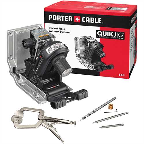

The $200 porter cable one seems cool, it automatically adjusts to the thickness of the wood, but it is $200ish

That thing ain't electric, it is just beefy. Biscuit jointer is on my list though.
