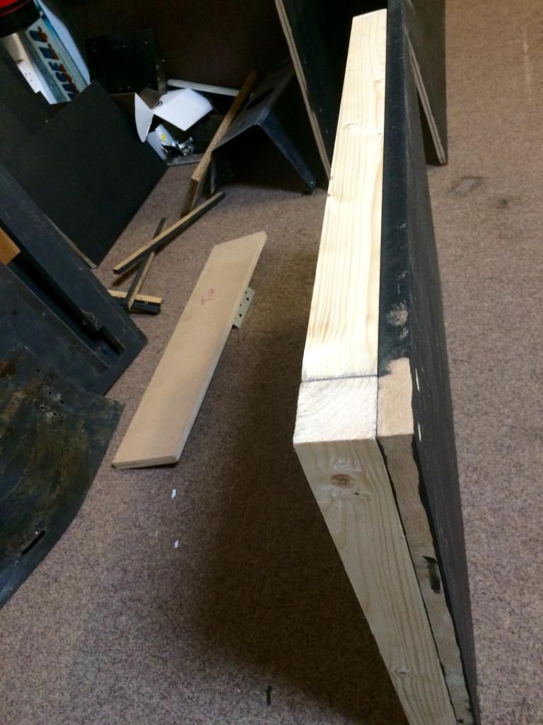

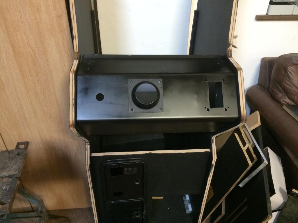

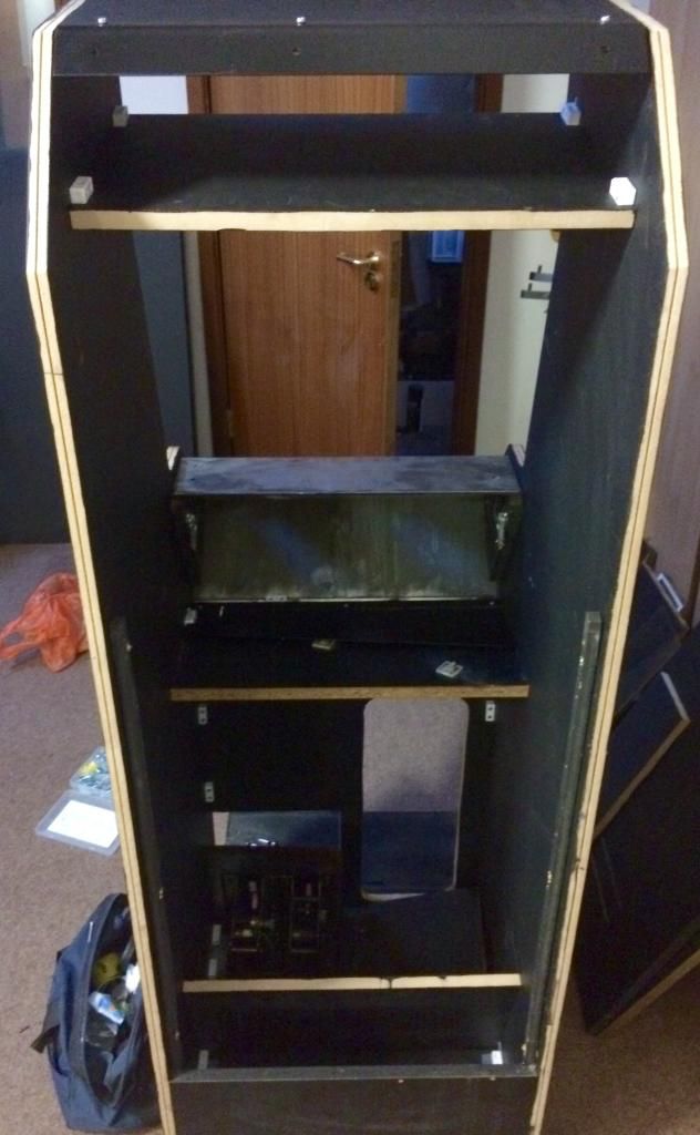

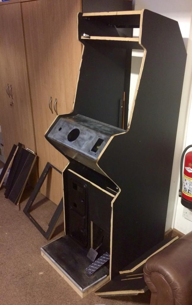

I'm cloning piece by piece so let take the can apart
Side off

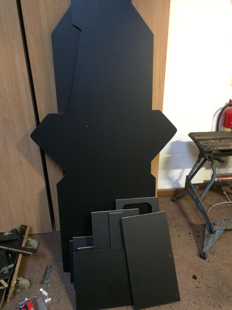

Quick sketch
Both sides cut at once
Not a bad match
Some of the others panels like coin door
It fits
The original back door is 2mm to big due to my cuts bit allowing for the saw blade
So I used my router to match other pieces
Test for the wheel
Old and new side by side
Not bad for a afternoons work

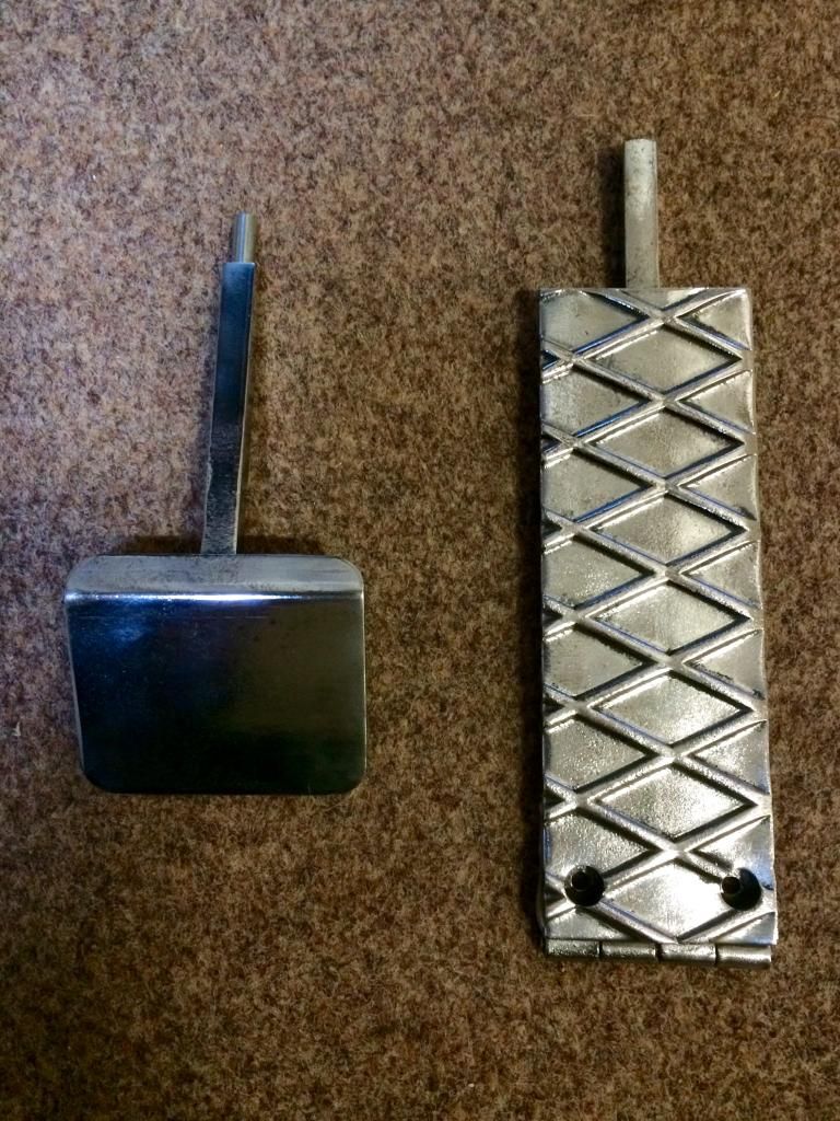

I then dropped the pedals off to a friend that has a polishing wheel and I think they came up pretty nice
Before
After

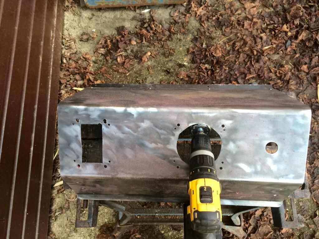

I painted all the wood parts even though I'm add art work it's good to seal the wood

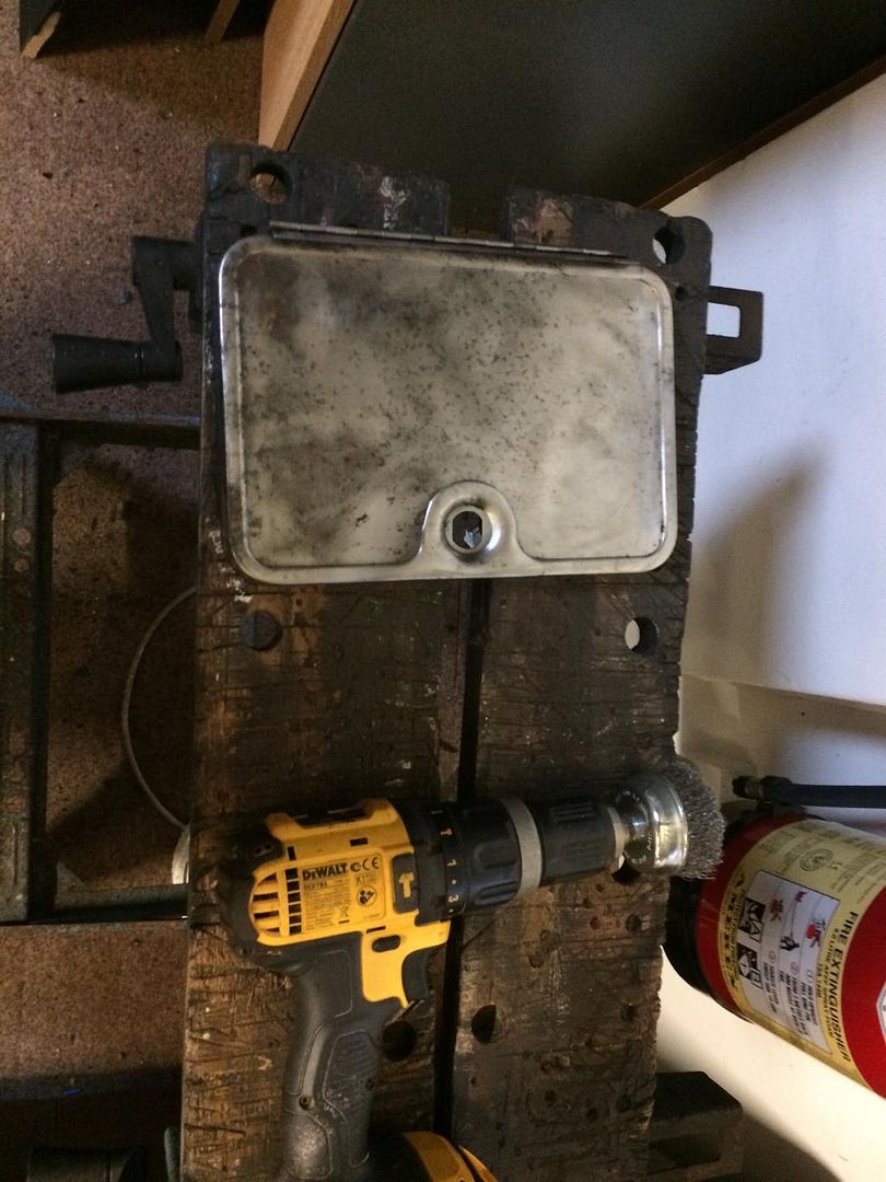

I cleaned up the rusty coin door and and back brace
And all stacked up
This stuff is great

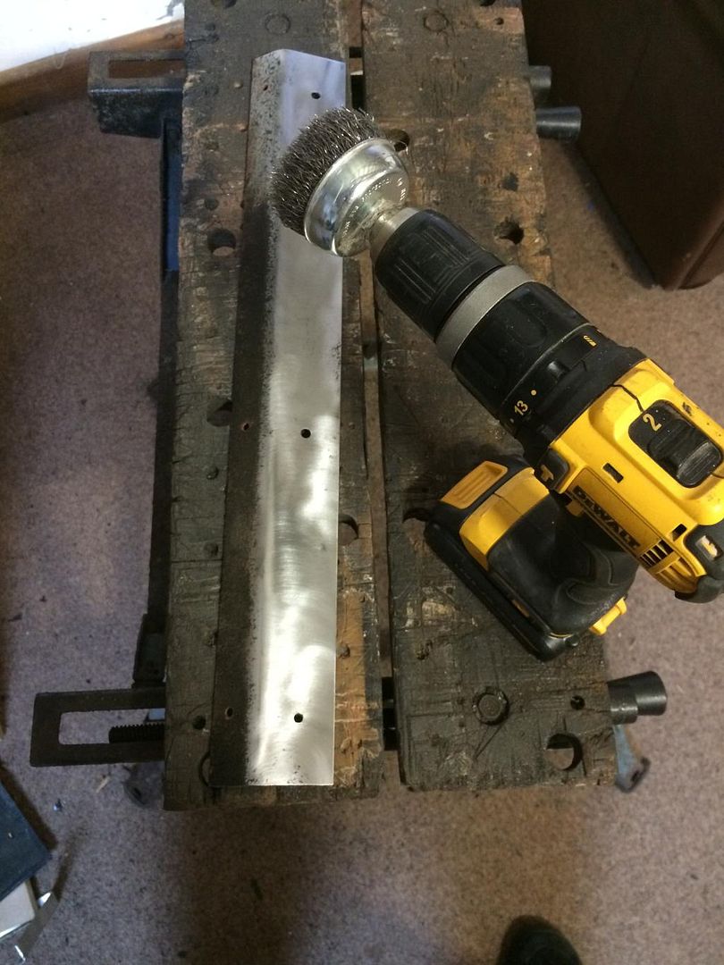

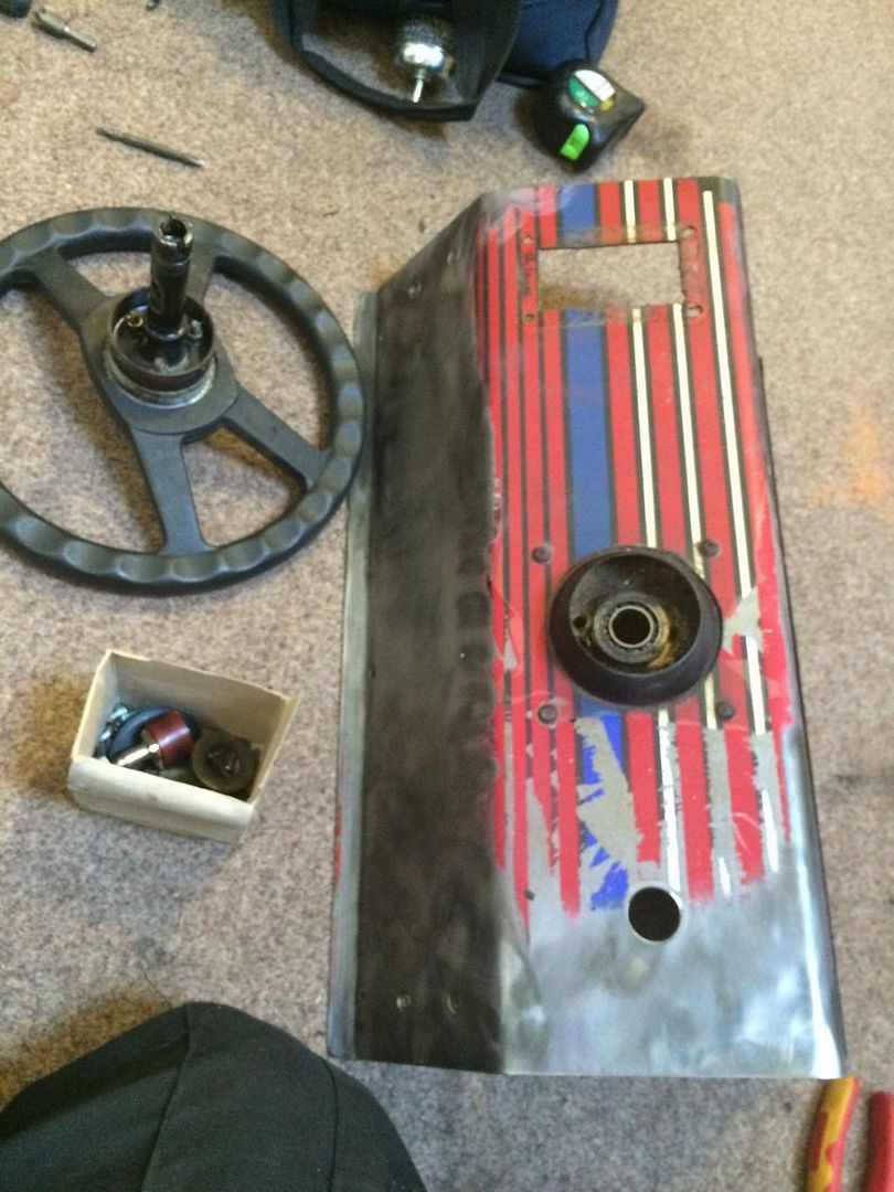

Out with the old
And after a lot of work I finally got the original artwork off off and all the sticky glue

And did a test fit with a spare piece I have
All about that base
Bought some wood for the bottom of the machine ( I'll paint later)

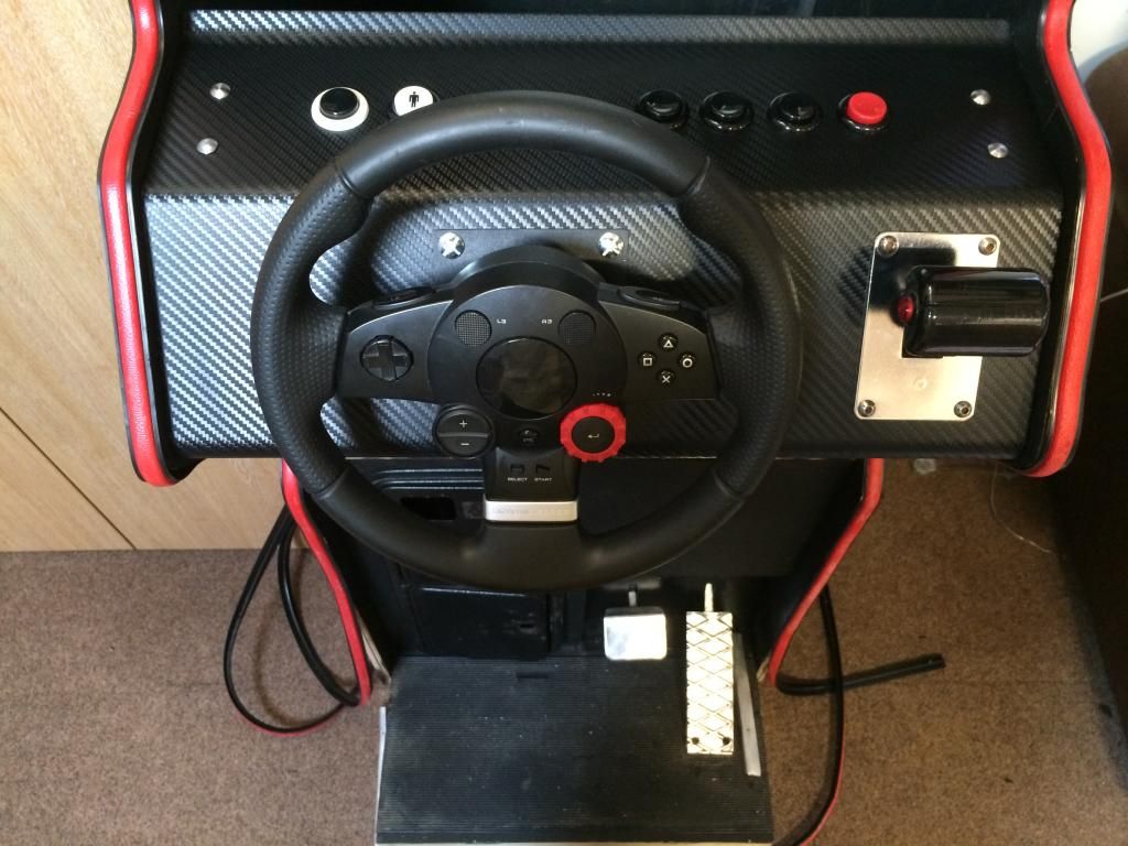

Wheel man

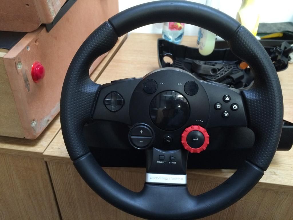

so after researching my options for using the original wheel works out to expensive to buy a  optipac board £30 and after setting it up I would be limited for options
So I glanced on gumtree and picked up this bargain locale to me a Logitech g force steering wheel for £20

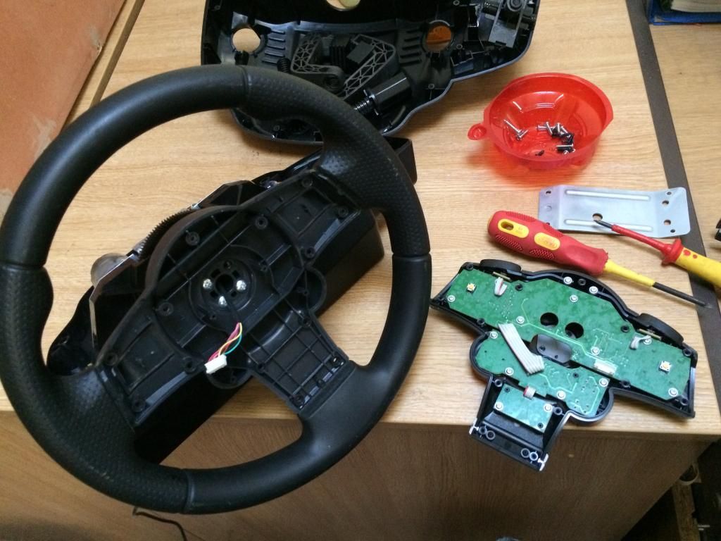

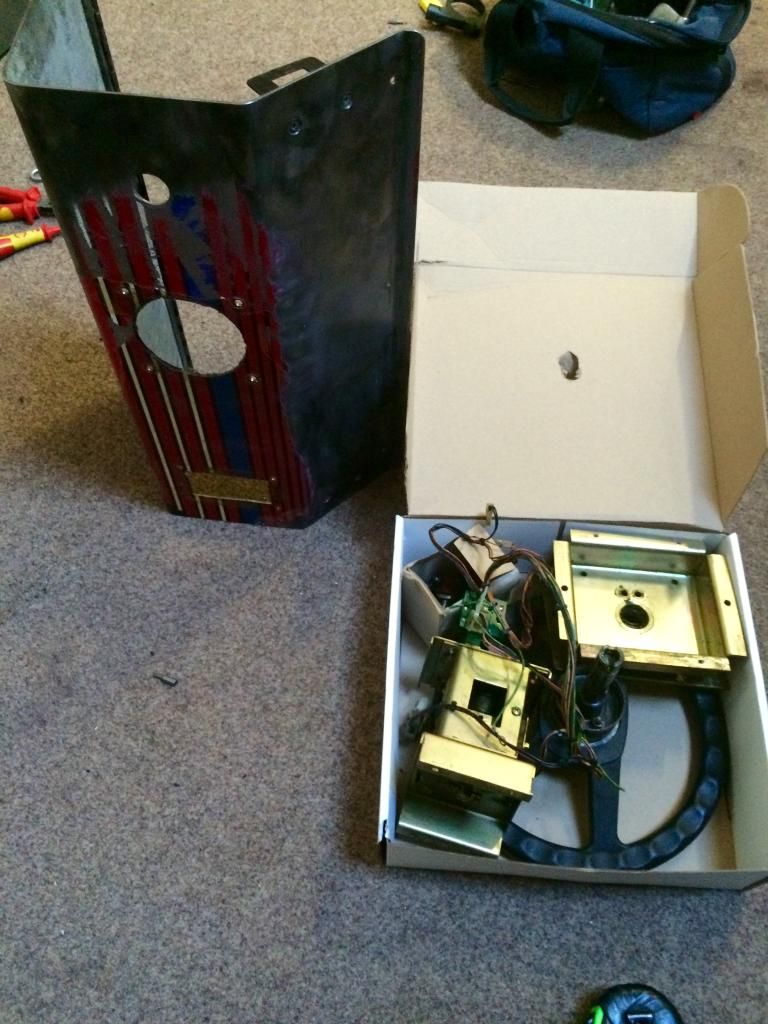

So I stripped the original wheel down and boxed it up
I open up my new wheel to see how to mount it onto the old control panel
I'm sure I'll figure a way

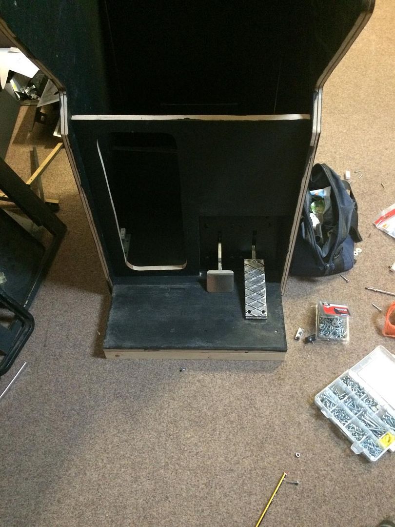

Now to try and use the original pedal

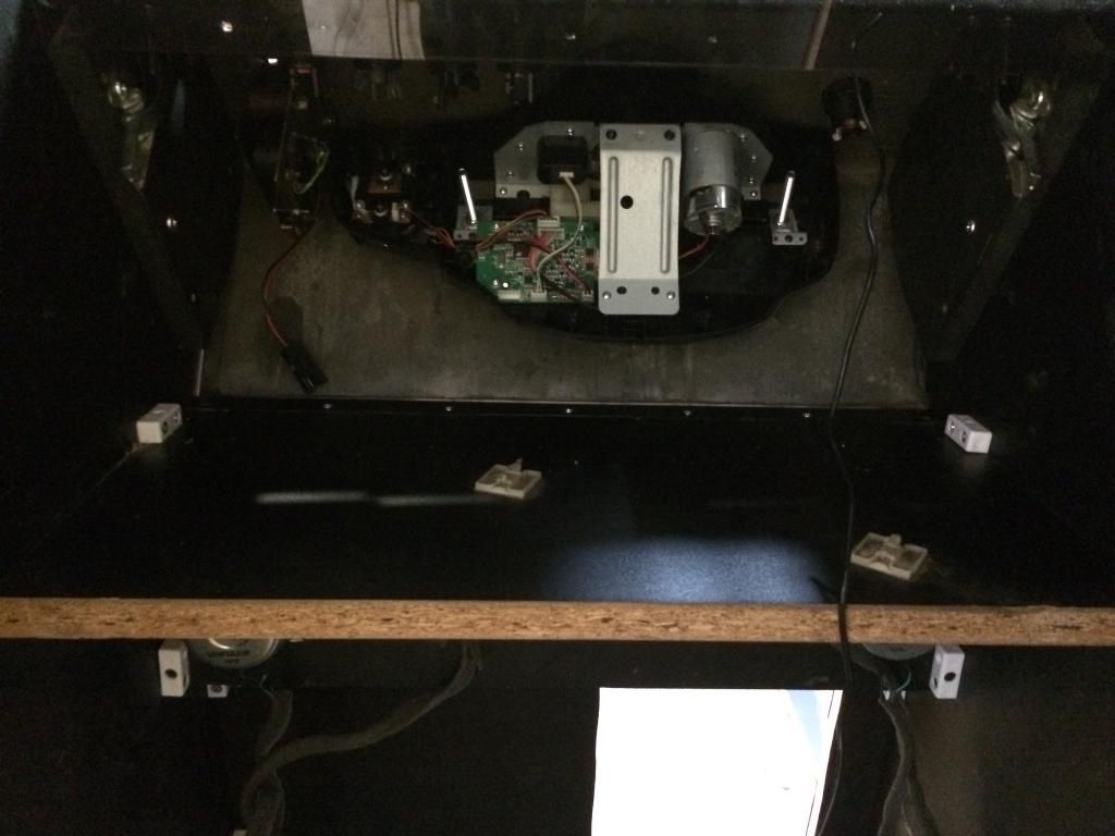

The original pedals use a 30k variable resistor so I thought I was doomed until I played around and found the new one swapped perfectly
Old
New

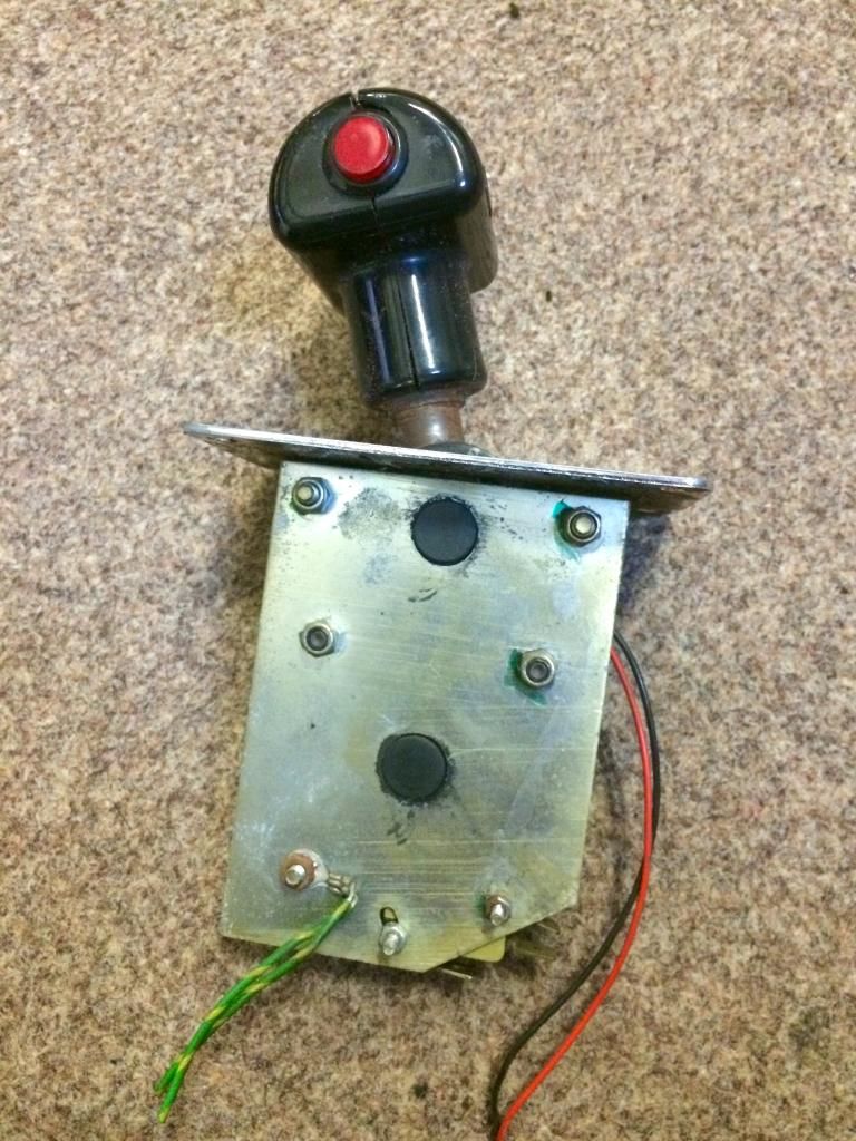

The brake isn't a simple swap out I think I'll use the original on/off microswitch
And find a way to connect it to the wheel

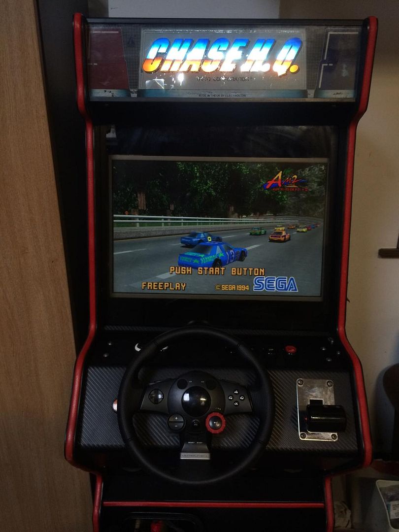

I sprayed the control panel and did a loose test fit

thanks for the feed back little progress fitted the glass to get an idea of monitor mounting position and a test fit of a few bits

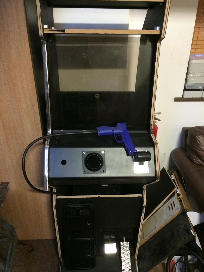

and do i add guns to this cab?
Only if you want it to do dual duty.
Might not be a bad idea if you had a separate menu or front-end for it.
I really wanted to get Lucky & Wild working on my driving cab, but never did succeed.
The game originally had positional guns (think analog joysticks).
My Act Labs guns wouldn't track like positional guns.
AimTraks would work from a distance, but while using the driving controls you are too close for an IR gun to work.

More progress
I cut and fit some back panels

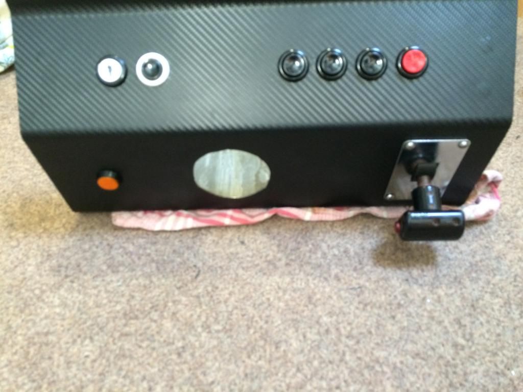

I drilled holes for buttons to control the front end player coin etc
It will also be fit view change for virtual racing

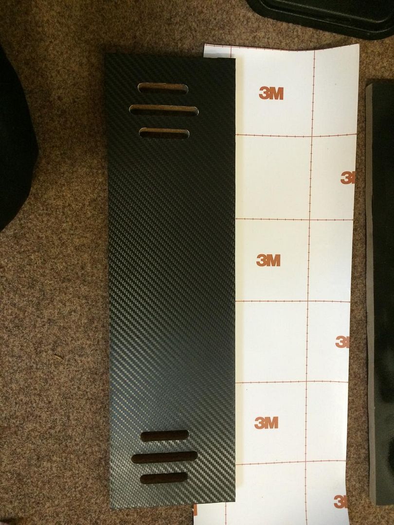

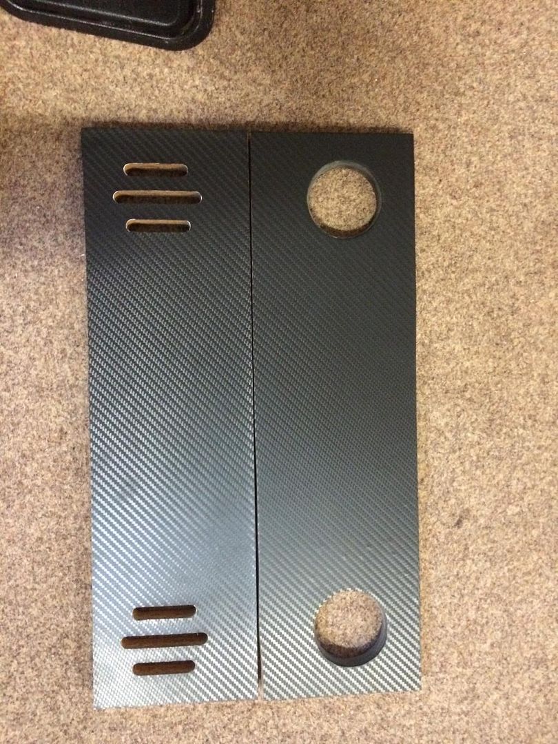

The carbon fibre vinyl wrap I bought is great it's got a real texture on it

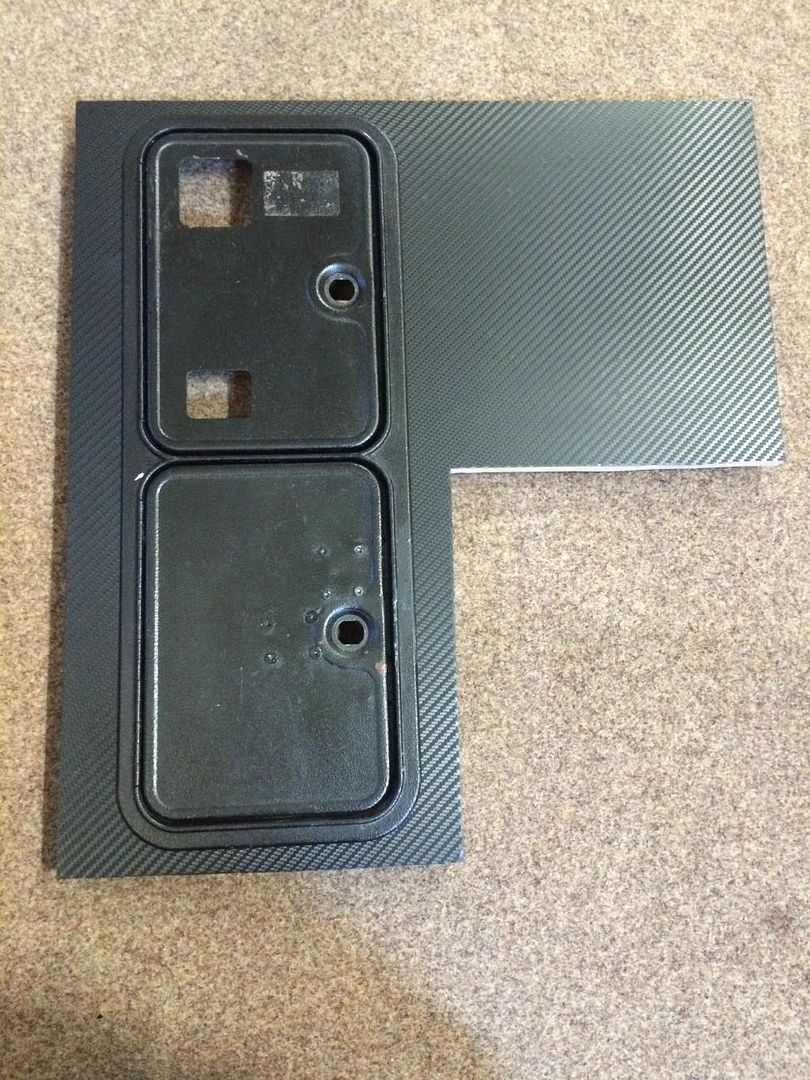

Here's me putting it on the control Panel
And the Coon door panel
And I have two option for the speaker
Original or my round one anyone got a preference ?

I like the red t-molding, and for the speaker. go with the slotted  :cheers: How do you have that wheel mounted?

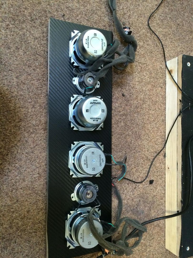

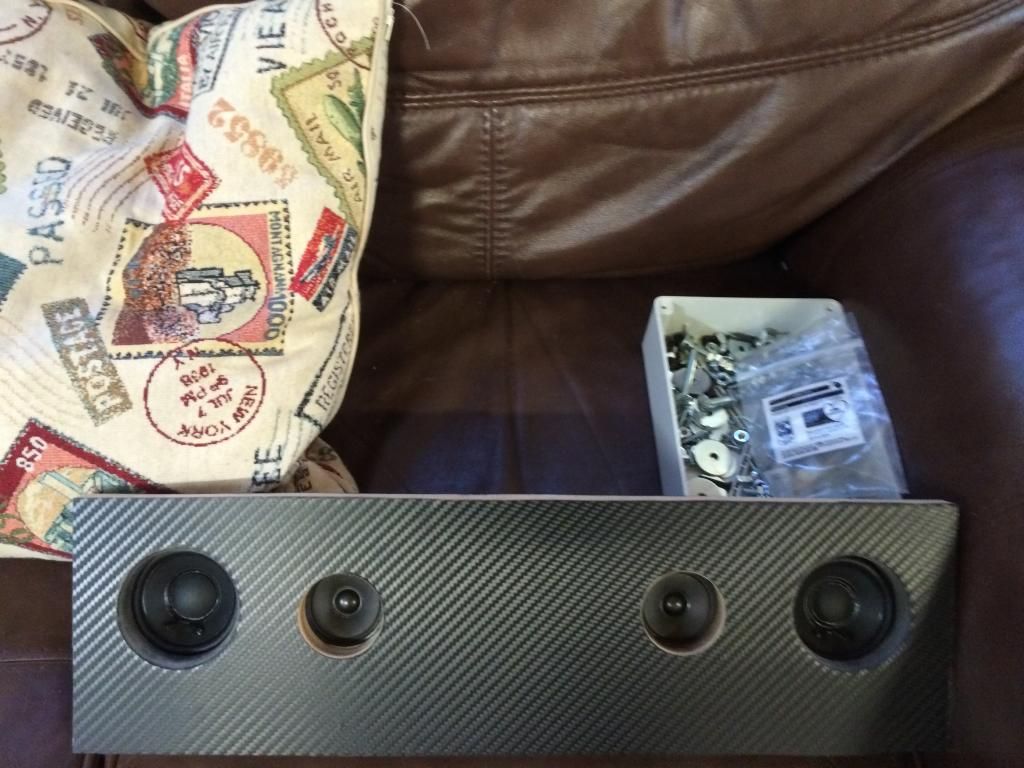

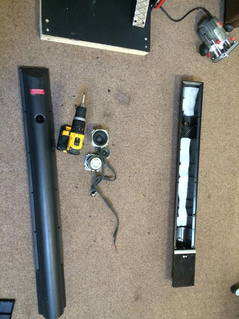

Speaker time today
So I pulled these surround speakers apart to use with the £5 sub that I picked up
Is that to many speakers ?
All fitted with tweeters too

And then I had to figure a way to fix the wheel in place at the right angle
So I fixed it in place with long bolt and tightened everything up
And I put the glass in place
My only worry is that I didn't place the wheel back on correct cog and when I turn it on the motors gonna kick in and rip itself apart!

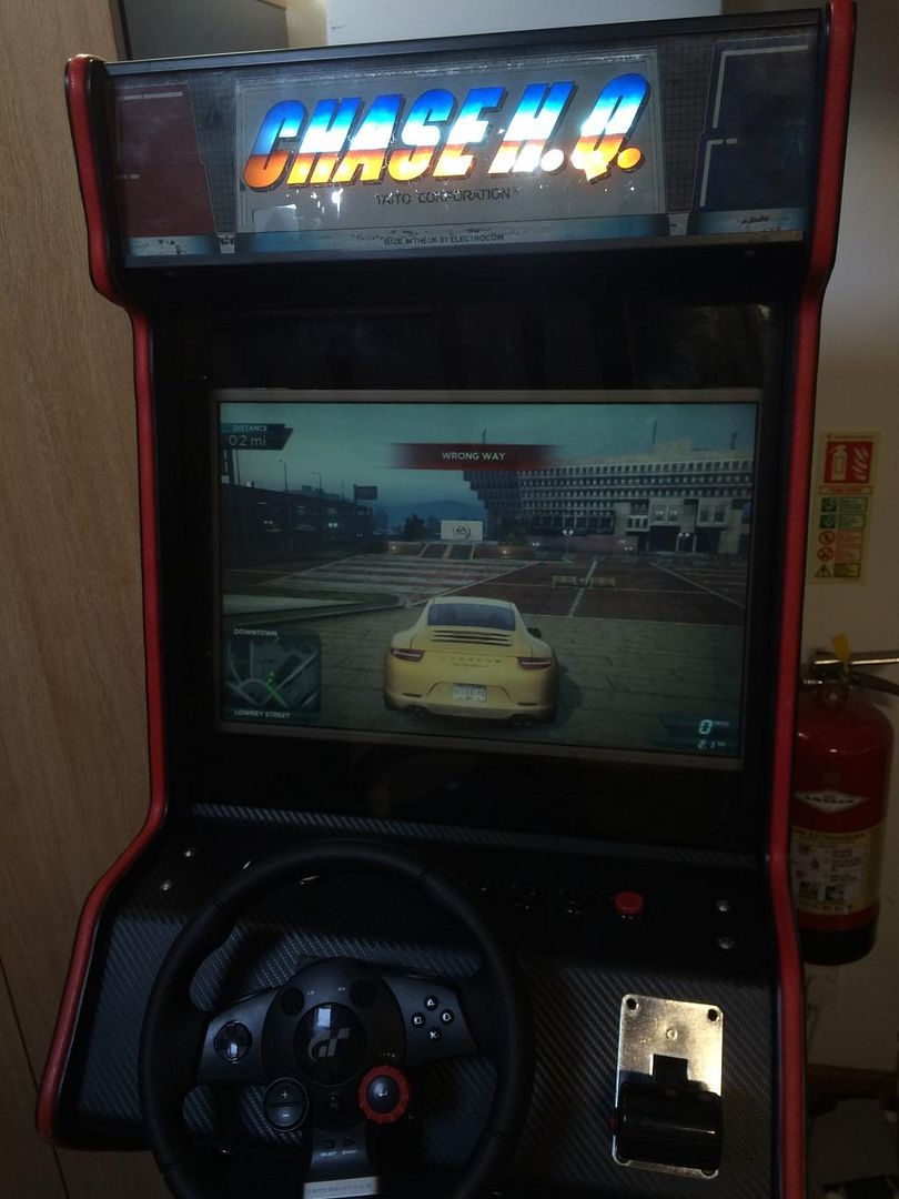

A Chase HQ cabinet demands flashing lights in the marquee :) (which is possible with MameHooker and so on..) Anyway, a great job so far.

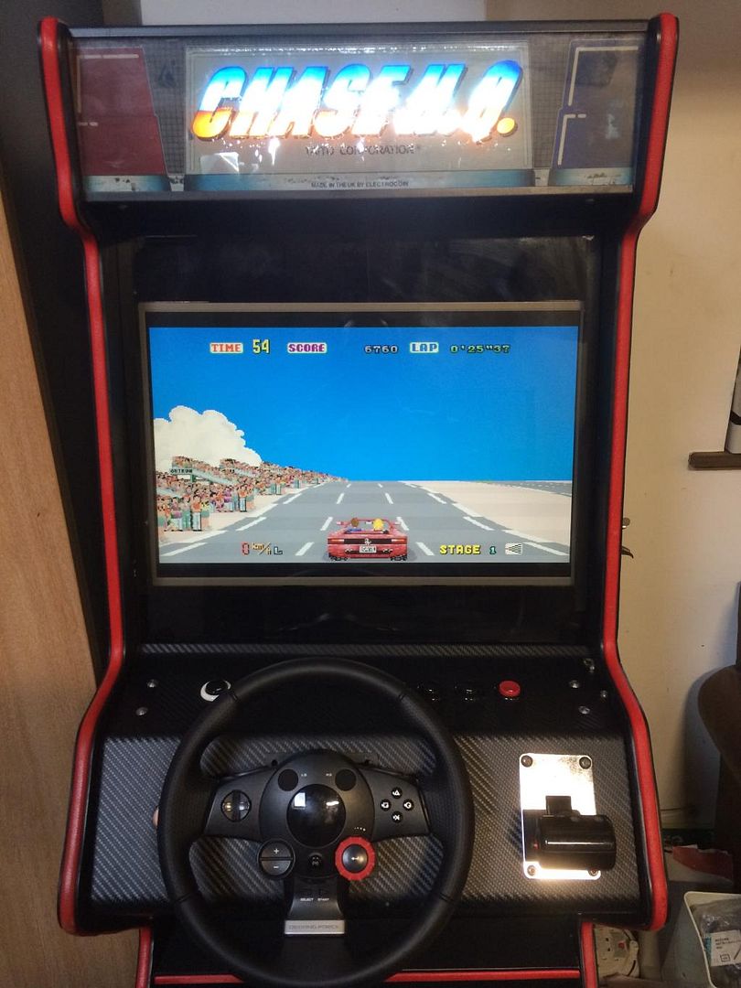

Yup im on it ill be fitting Blue and Red LEDs and trying to work my way through MameHooker and making circuit that i can also override and make them flash at the press of a button.

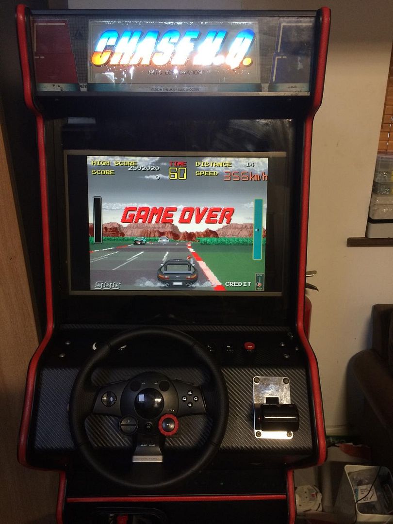

Now back to todays work ive wired the marquee lights and fited the monitor and finished the back panels completely
Just need to find a place where i can get orginal Chase HQ artwork so i can make my own?
and i tested a few games,the Lg wheels is not set up so the force feedback etc didn't work but it was fun to play
untill the end when it just stopped working and flashing : (
and ive started to wire my menu buttons up

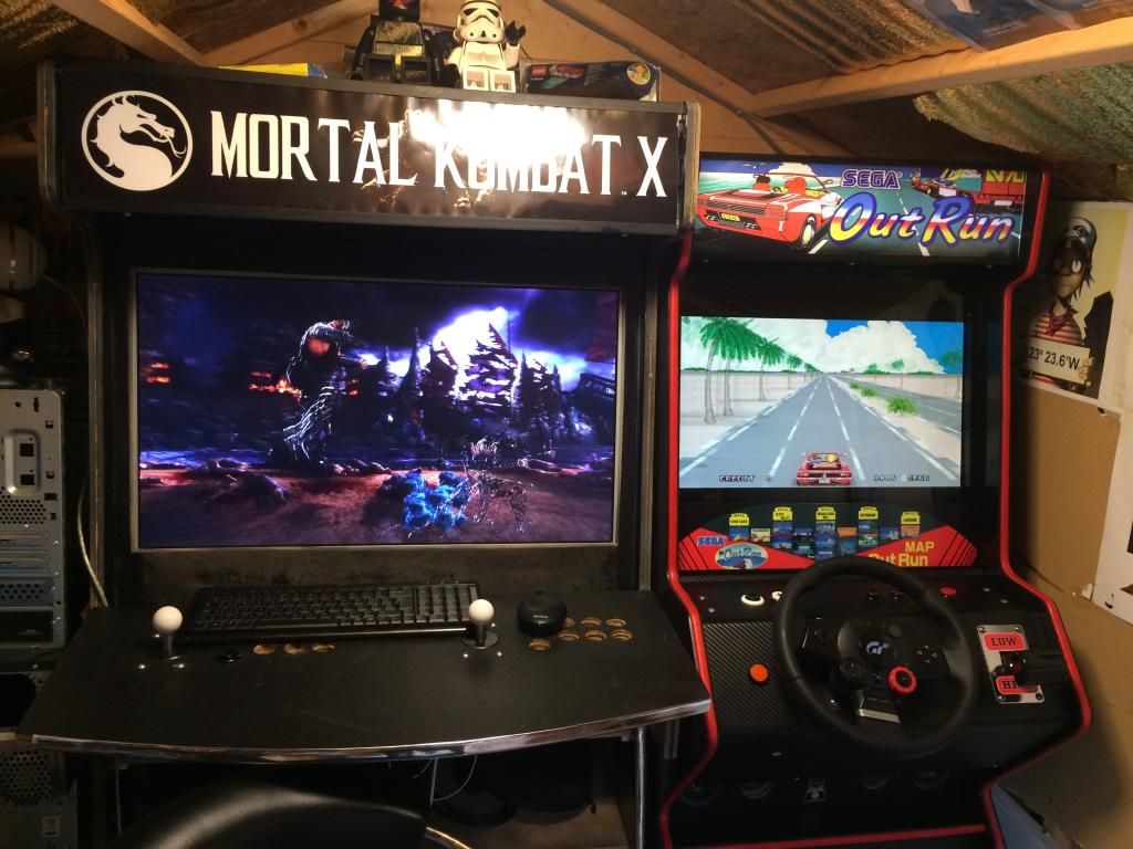

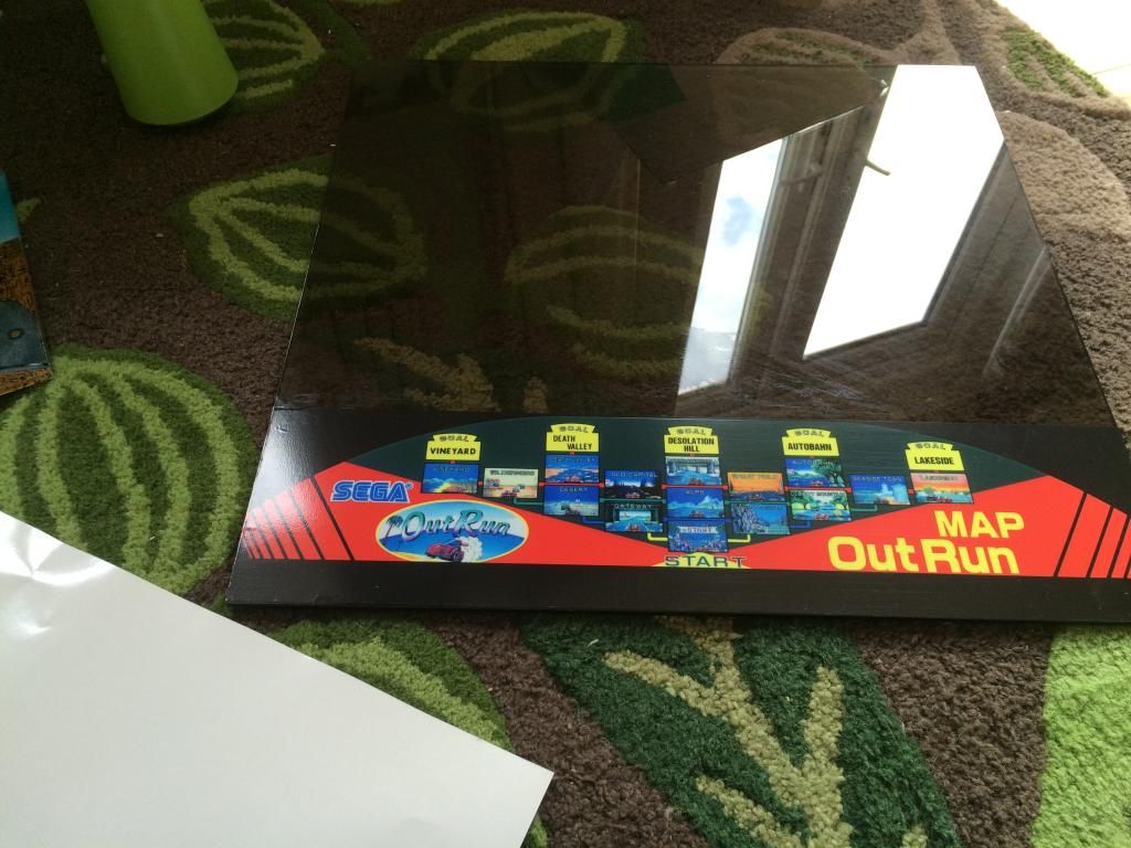

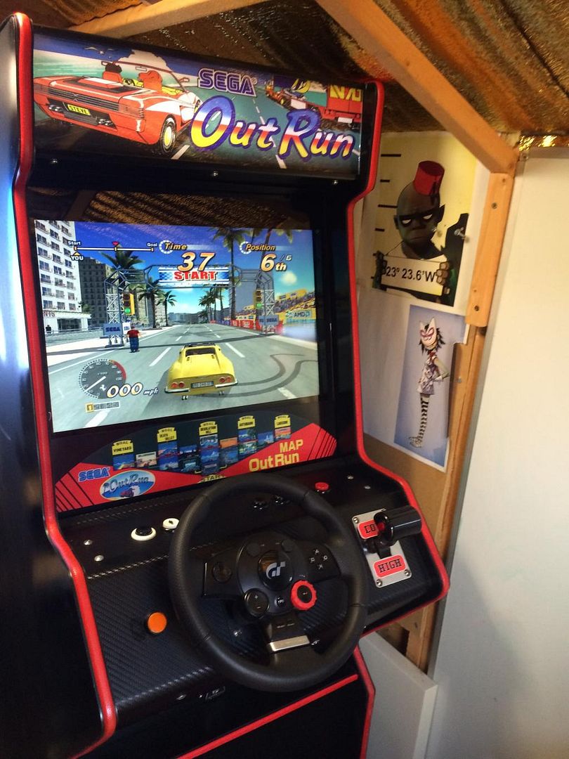

Well been busy,I also decided to change the theme to Outrun
Have the insides another coat of paint
Got the artwork printed along with another cabs
Fitted the marquee to the backing
And the map to the glass
Loaded her into my van
Hmmmm gonna be a tight fit
At home at last
