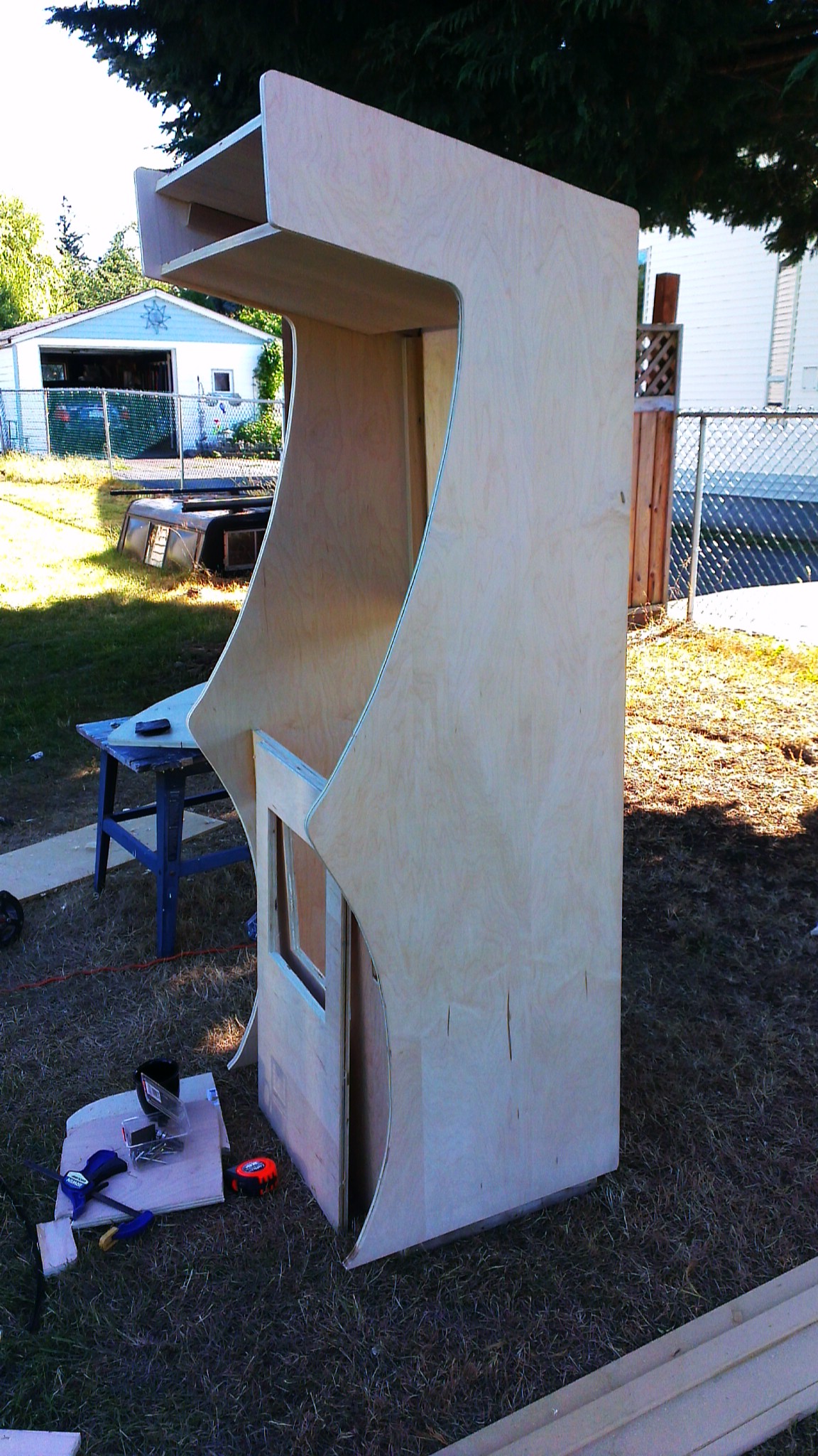

...only because I don't think there's another smurf build.
This one is for a friend, his anniversary is coming up and his wife is crazy for arcade games and smurfs. I have all the artwork done, starting the woodstuffs tomorrow.
Using smooth faced cabinet grade plywood and a 22" widescreen LCD, it is 6' tall and 2' wide, 26" deep.
The boot screen to replace the windows boot. It's the best I could do with 16 colours. I might change the background to grey.
The Mala menu screen I zipped up
Marquee
And finally the whole thing put together. There will be a coin door with the novagem coin drop buttons in blue. Before I get the artwork printed, I will tweak the smurf blue to match the t-molding and buttons and joysticks.
The only other art is the possibility of a flower around the trackball, and there will be 2 half flowers that are inserted into the gun holsters on the front until he can afford the guns, so hopefully she won't even realize that they aren't just for decoration.

Theme aside I really like the design of your cabinet.  The curved CP and the detail by the coin door are fantastic.    :cheers:
Will the CP top hinge from the back?
eds1275
  • Posts: 2169
  • Rock and Roll!
Re: The best smurfing arcade evar
« Reply #12 on: July 08, 2014, 09:01:23 pm »
Thanks! A friend of mine and another friend were brainstorming and came up with this design except pointier for a thundercats cabinet he plans on building. And then our mutual friend wanted this smurf cab so I just rounded out the corners and it was born. The actual cabinet had a revision from the render and the marquee comes out further.
I don't like the look of control panels that stick out from the sides as I think it sort of kills the "arcade look." Even though most of my favourite games had that design, and it does give you more real estate to work with for controls... it just doesn't look as nice to me.
The coin door protrusion is taken from Ond's Metropolis, and the inset gun holsters are pretty much the same as on my spinal tap machine.
The control panel will no be hinged in any way. It is an open-bottom design, and locks into the machine. The whole thing slides out if need be.
Today, I built the thing. It is standing out in the sun drying. I didn't take many build pics, but here was the process. Glued and installed the battens early in the day with my nail gun. I don't have enough clamps so that is the next best thing. Cut a sheet of plywood to 26", then hacked that into the top, back upper, front, and tiny back lower. With the remainder I cut out the protrusion and the bottom marquee area. Marked out biscuit locations and cut the slots, then ran the router around anything that needed a slot for t-molding. Cut out any details like the gun holes and the coin door bit, added a button hole up top for a power button.
Laid one side down, added glue, threw in some biscuits, and frantically put it together. Fired in a few brads to hold it in place, then slapped the other side on top with glue and biscuits. It was sort of leaning into a parallelogram so I straightened it out and put in a few screws in places that won't be seen. I let it set for about an hour then put in some plastic wood wood filler.
