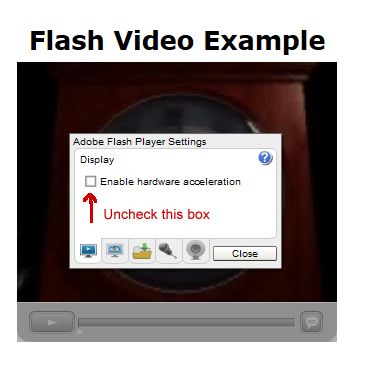

Well guys, it works!
What I did was disabling hardware acceleration for flash in IE!
It did NOT work when I did the same in Chrome, so be advised.
If you've got the same problem and want to give it a try:
Browse to a flash video (youtube or on the Adobe flash website), right click, go to settings and uncheck the box for hardware acceleration.
After that the .mp4 videos showed fine in Hyperspin with my HD 4400 unit!  :applaud:

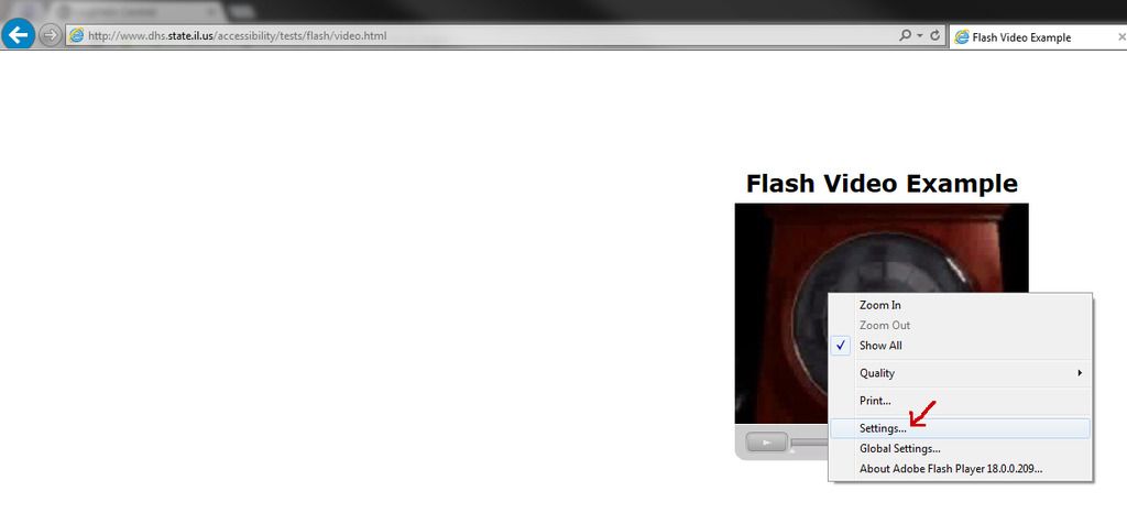

vwalbridge
  • Posts: 2082
Re: No video in Hyperspin with HD 4400
« Reply #17 on: August 06, 2015, 04:56:48 pm »
OK, I just tested this on my Win7 x64 Pro comptuer and it works every time. I can fix the videos in hyperspin and break them again with this one simple box. I can go back and forth fixing and breaking so I know this is the setting that impacts it.
Steps:
1. Open IE and go to THIS sample flash video page.
2. Then right click on the video on that page and click "Settings"
3. Uncheck the box labeled "Enable hardware acceleration"
4. Close IE
5. Open Hyperspin and bask in the glory of working MP4s in Hyperspin.  :)
NOTES:
-Restarting my computer was not necessary
-Pretty sure this works on win8/8.1
-Have not tested this on win10 but I'm willing to bet the steps are totally different (if even remotely the same) with the Edge browser
