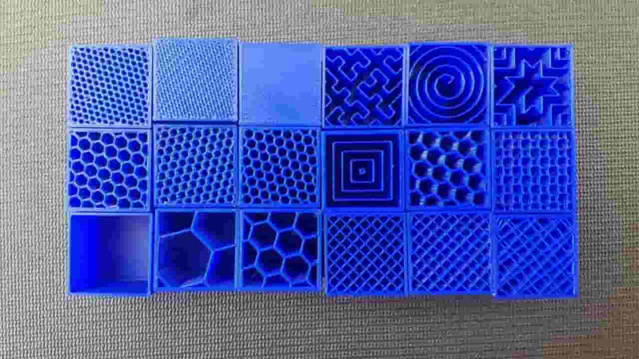

I'm assuming "infil" is how much stuff is used when printing?
Yes.  100% infill is a solid piece of plastic.  0% infill is a hollow shell.
The "slicer" program that converts the 3d model (.stl file) into the G-code for the specific printer you will be using allows you to select the desired pattern and percentage of infill, the outer layer thickness, and many other options.
- Something like gyroid or cubic pattern at 20 or 30% infill with a 2mm outer shell (5 layers * 0.4mm nozzle) should work for printing this part with PETG filament.  PETG is more flexible than the more commonly-used PLA.
