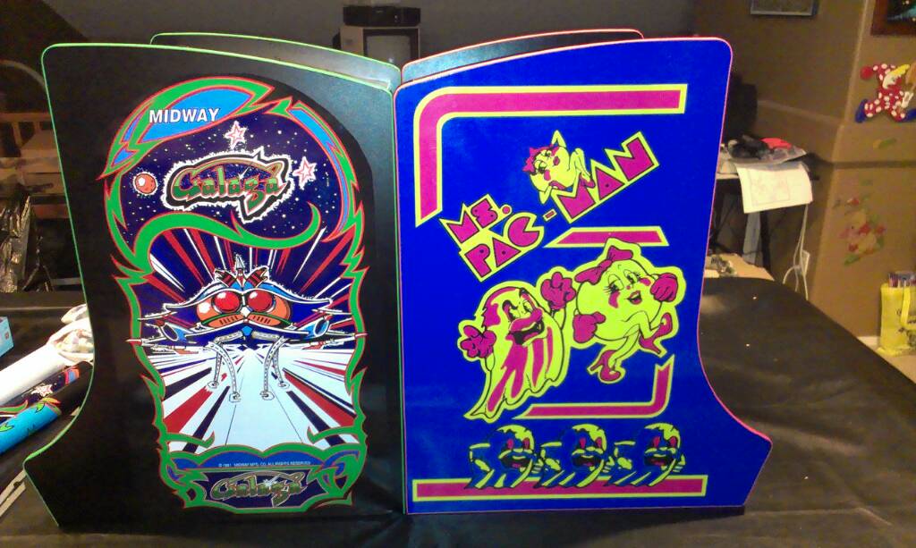

Welp, over the last 2 years Bonnie sorta wants to keep the full sized MsPac, so I decided to build her a smaller version of a MsPac. I ordered a Midway style vertical from Haruman and he did me a HUGE favor by letting me order pink tmolding and having it delivered to him, so he could flush trim it to the 1/2" MDF . The only 1/2" tmolding I could fine was either black or white, and that just wouldnt do.
Here are pix from his potato camera from forever ago:
The Blue was too dark (which is 100% my fault, I made the art) so I remade it lighter blue. more updates after I find the data cable for my phone :)

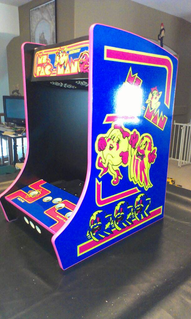

So pulled the dark blue art off:
Also pictured is the icepack for my ankle, my POS Ryobi "drill", and 2 dog toys.
Also pictured is my driving rig, that I cant use because HoBoJoe has my pedals.
The light blue applied:
another slight art issue, if you're OCD like me, you''ll notice one side's MsPac is slightly closer to the curve than the other. I mis-measured when I designed it, and corrected the art for anyone else who gets a whole kit from HaRuMan. Personally it doenst bother me, cant see both sides at the same time. If my mom complains (not likely) I'll get it reprinted and reapply.

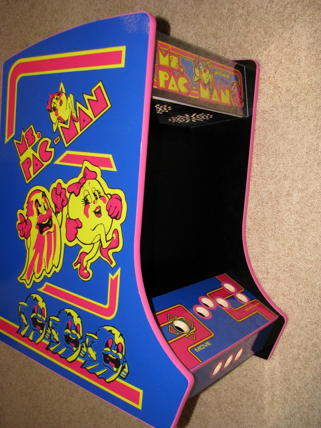

And here is the CP and front art applied:
left and right are coin ups, center button is the test switch
I had planned to NephRing this project, but I changed joysticks after ordering the nephring, so I'll prolly need to use this on a different project.
Here is the CP completely assembled:
Also pictured is an almost empty bottle of 1800 (Bonnie had a social event, I dont drink), and the AIMTrack from Ginsu Victim
Took this so I knew which way to orientate the monitor:
