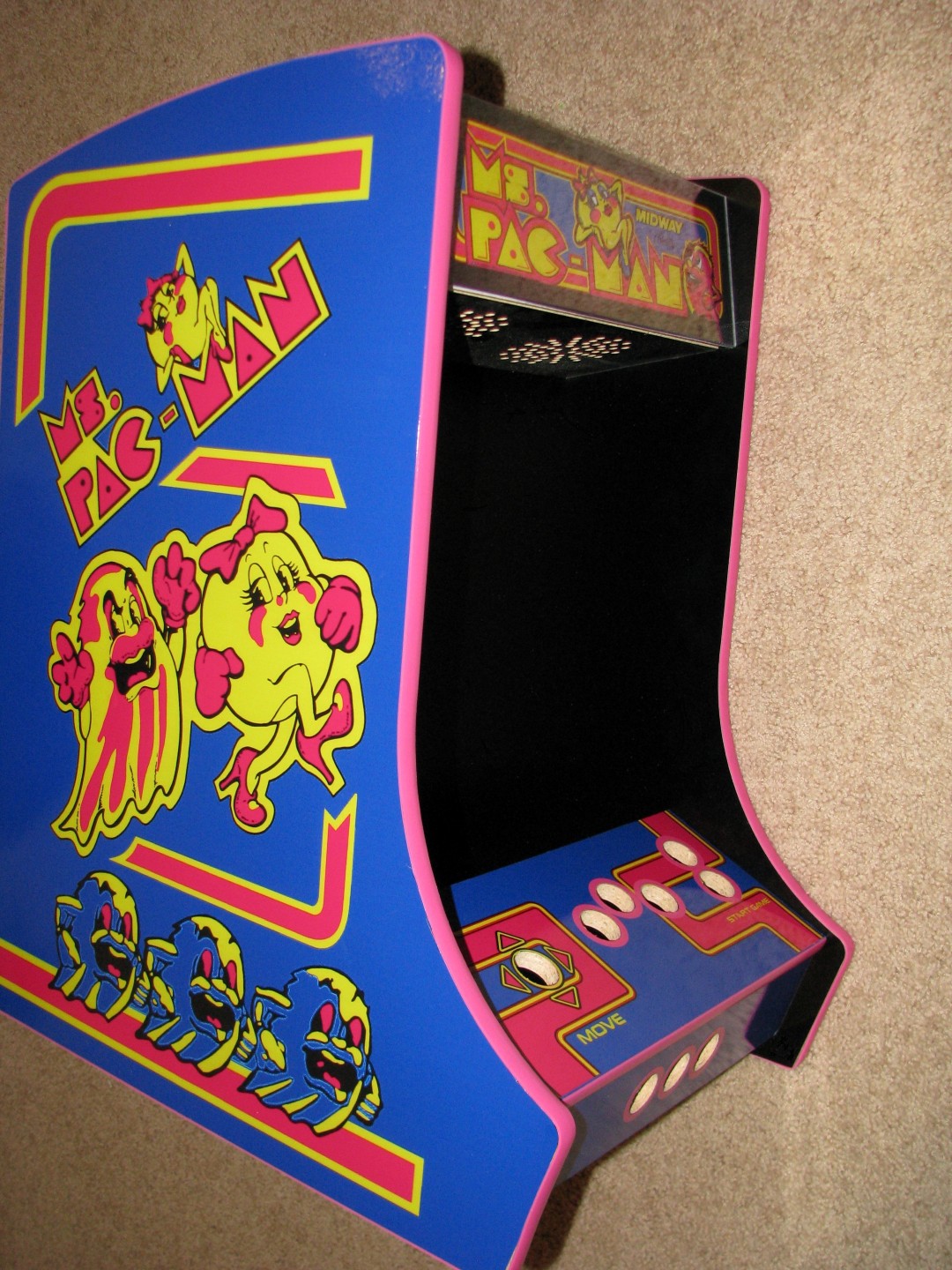

That is, mini in the sense that its smaller than a full sized MsPac :)
My mom is set to retire this year after 35 years working the assembly line at Chrysler. Her favorite game is MsPac so when one popped up on Craigslist local to me, I went and got it:
http://forum.arcadecontrols.com/index.php/topic,121331.msg1286989.html#msg1286989
Welp, over the last 2 years Bonnie sorta wants to keep the full sized MsPac, so I decided to build her a smaller version of a MsPac. I ordered a Midway style vertical from Haruman and he did me a HUGE favor by letting me order pink tmolding and having it delivered to him, so he could flush trim it to the 1/2" MDF . The only 1/2" tmolding I could fine was either black or white, and that just wouldnt do.
Here are pix from his potato camera from forever ago:

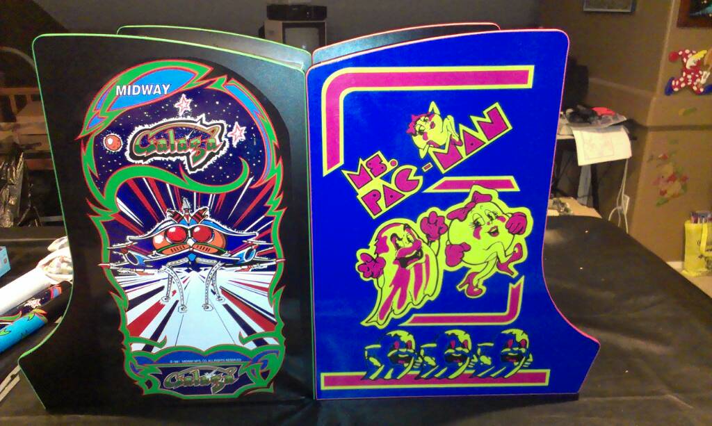

The Blue was too dark (which is 100% my fault, I made the art) so I remade it lighter blue. more updates after I find the data cable for my phone :)
Price Breakdown all prices approximated, rounded up, and include shipping:
Haruman Vert Kit: $190 (Haruman)
MsPac Art: $80 (Shady Lee / Soul Draw)
TMolding : $20 (tmolding.com)
60 in 1: $75 (paradise)
Sticks and Buttons: $20 (paradise and Haruman)
LED light bar: $25 (Home Depot)
JAMMA Harness: $10 (eBay)
Monitor: $Free (spare)
Total: $395

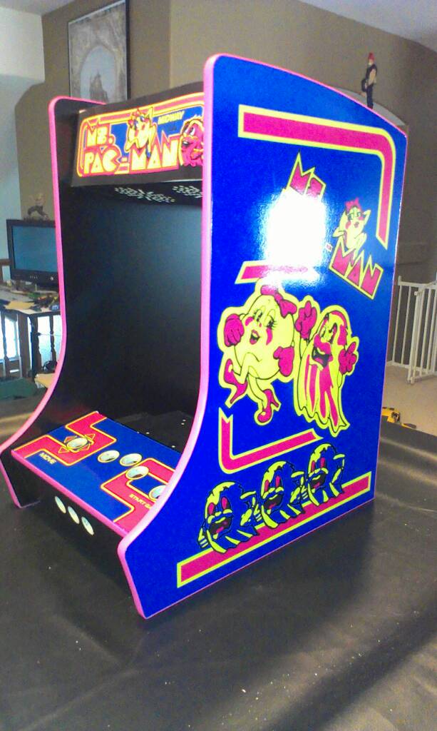

So pulled the dark blue art off:
Also pictured is the icepack for my ankle, my POS Ryobi "drill", and 2 dog toys.
Also pictured is my driving rig, that I cant use because HoBoJoe has my pedals.
The light blue applied:
another slight art issue, if you're OCD like me, you''ll notice one side's MsPac is slightly closer to the curve than the other. I mis-measured when I designed it, and corrected the art for anyone else who gets a whole kit from HaRuMan. Personally it doenst bother me, cant see both sides at the same time. If my mom complains (not likely) I'll get it reprinted and reapply.
