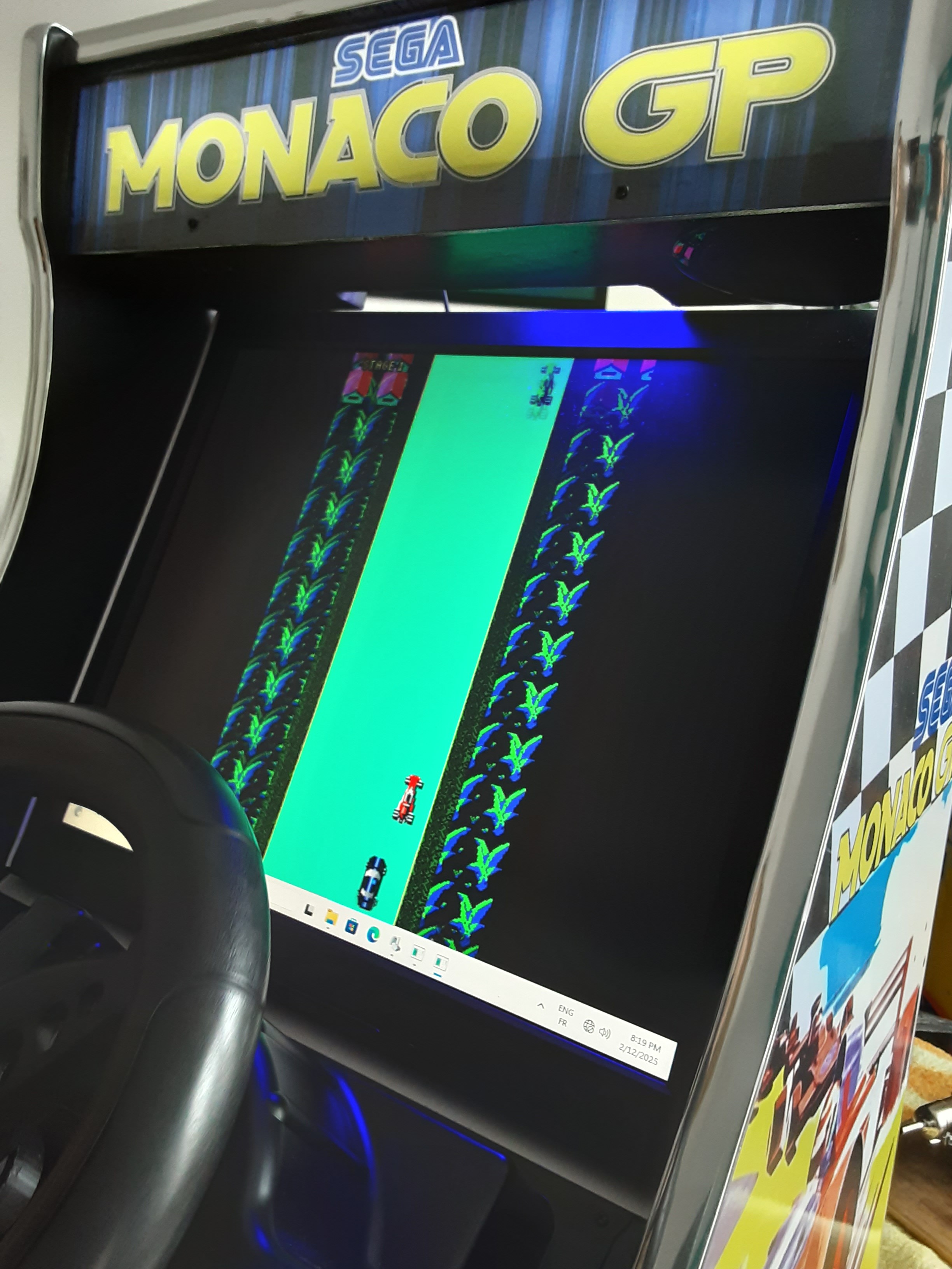

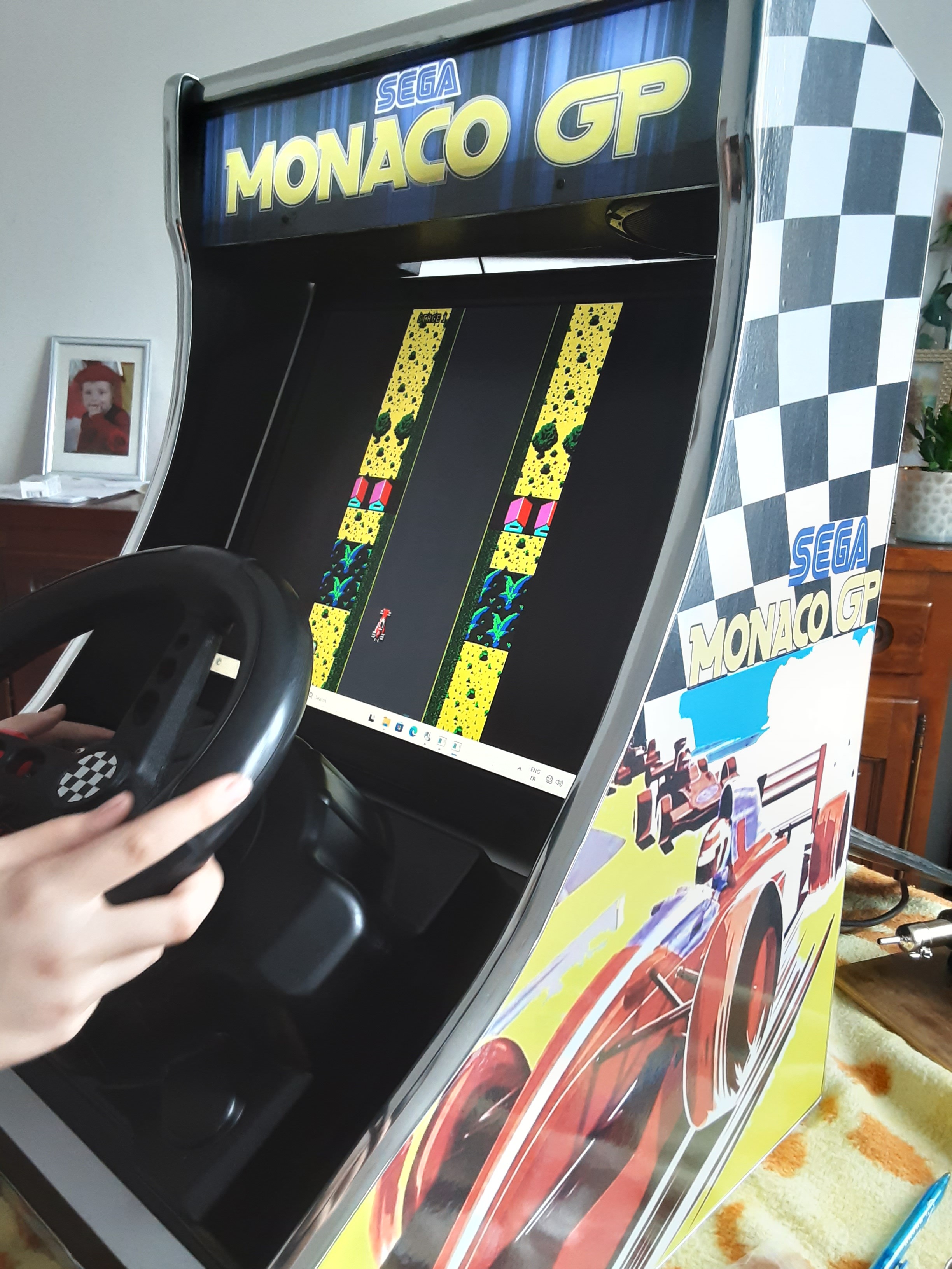

Hello
New to this forum.
I'm in the process of creating a Monaco GP race cab remake.
First of all, I would like to thank GEECAB for its superb work and all the participants!  :applaud:
I am having some problems with my 4 relay ch340 module whose drivers are well recognized and which is tested functional under windows 11 and mgpr_v1_5_1D2 .
I am in administrator mode in properties.
But I can't get it up and running with scoreboard to relay?
I just want to use relays with on the game with a single screen 19" in 1280X1024 mode.
Can you help me?
« Last Edit: February 11, 2025, 12:39:56 pm by MicroPixels »
geecab
  • Posts: 356
  • Last login:January 21, 2026, 08:37:13 am
Re: Sega Monaco GP 1979/1980 - My Remake
« Reply #526 on: February 11, 2025, 02:29:41 pm »
Hi MicroPixels!
Welcome to the forum and thanks for posting pics of your table top Monaco GP Cab, excellent work!!  :applaud:
I can see from the scoreboard_to_relays.exe output that it has connected to your CH340 relay OK. The problem is scoreboard_to_relays.exe can not connect to the mgpr.exe instance that is running the game.
Before you start scoreboard_to_relays.exe, can you ensure that you have the mgpr.exe game instance running as administrator, and that its DISPLAY -> SCOREBOARD_MODE configuration option is set to EXPORT.
Note. On Windows 11, scoreboard_to_relays.exe and mgpr.exe both need to be running in administrator mode.
Hope this helps!

MicroPixels
  • Posts: 7
  • Last login:February 23, 2025, 04:44:17 am
« Reply #528 on: February 12, 2025, 11:46:07 am »
Hi Geecab and GPForever2024,
Thank you for your advice. ;)
I managed to get the relays to work by putting everything in administrator mode and putting Mgpr in Export mode.
On the other hand I don't have the bezel and the scores on the side anymore.

Hi all, I want to add this superb remake to my OutRun cab that I made recently. I知 using Attract Mode as my front end. The version that I want to be able to launch from Attract Mode is Pro Monaco GP with resolution at 1280 x 1024 with the arcade bezel. Any help would be greatly appreciated.
geecab
  • Posts: 356
« Reply #552 on: June 16, 2025, 04:31:07 am »
Hi Swainy!
I'm not too familiar with Attract Mode, but hopefully it has an option to start a particular game by running a batch file?
If so, you could create a batch file called, say, "run_mgpr_pro.bat" and have Attract Mode run that when you want to start the game.
The batch file needs to contain something like:
Code: [Select]
c:
cd c:\mgpr_v1_5_1
call mgpr.exe -cfg 1280x1024_pro_monaco_gp_arcade.cfg
Note you might have to tweak the "c:" and "cd c:\mgpr_v1_5_1" lines a little depending on the drive / directory where mgpr.exe resides on your system.
This is all assuming you are running Attract Mode on windows. If you are running on Linux then let me know.
Hope this helps! :)

Thanks geecab, I値l give that a try as soon as I get home from work. Thanks for such an amazing game, I used to play the original when I was a kid and yesterday my 12 year old son played your version for the first time and really enjoyed it.

« Reply #557 on: June 20, 2025, 01:34:49 am »
Great stuff Swainy! Glad you and your son are enjoying the remake! Remember there are other modes you can play the game in ('Pursuit' and 'Stunt Park') which you could create batch files for also, should you fancy a slightly different challenge to the arcade faithful modes.
It worked a treat mate! Thanks again 👍
