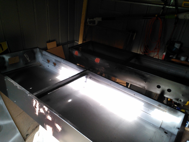

Started out with my old converted Virtual On cab and an Initial D cab.  It took a while, but eventually found another VO seat base so the seats would be the same height.
Bases are nearly identical.  The Virtual On one is pretty rough.  I regretted not fixing it up for the previous incarnation.
The Initial D base was in pretty good shape, but some of the spot welds under the decals were sloppy, so I ground them down.
They're far from perfect, but at least the look nice and clean now.  I started out using semi-gloss paint, but couldn't get it to look even.
Gloss went on a lot more evenly.  Just happened to have 8 shiny new chrome feet in my shed too! (not attached yet)
I don't care for the original Virtual On black ribbed floor material that I used last time.   Even the new stuff looks filthy now and is impossible to clean.  I'd planned to have the bases completely together, but decided to find some other material first.
The more time the paint has to cure and harden, the better anyway.

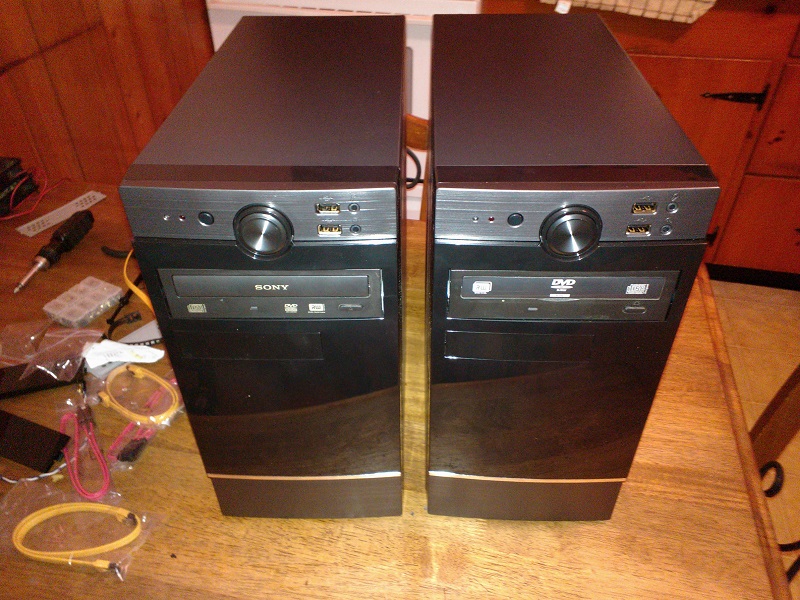

Keeping the PCs in some cheap $18 cases from Newegg.  Went ahead and threw in DVD drives in case they're needed to load new games.
I've also never been able to get the Sega Rally Revo no-dvd crack to work.   :-\
Specs:  3.4Ghz Althlon X3, 2GB Ram, Nvidia 9800GT
I wish I could build a pair of killer systems, but I just don't have the money right now and already had these matching PCs from other emulator setups.  I did spend $30 each on the 9800GTs hoping they would help out on newer games.
They currently have XP64 on them, but I'd like to move to Windows 7 so the Gaelco games in the newest version of Demul would be playable.  I have one copy of Win7, but I'm not sure how well it's going to work with only 2GB.  Don't really want to spend money on more DDR2.

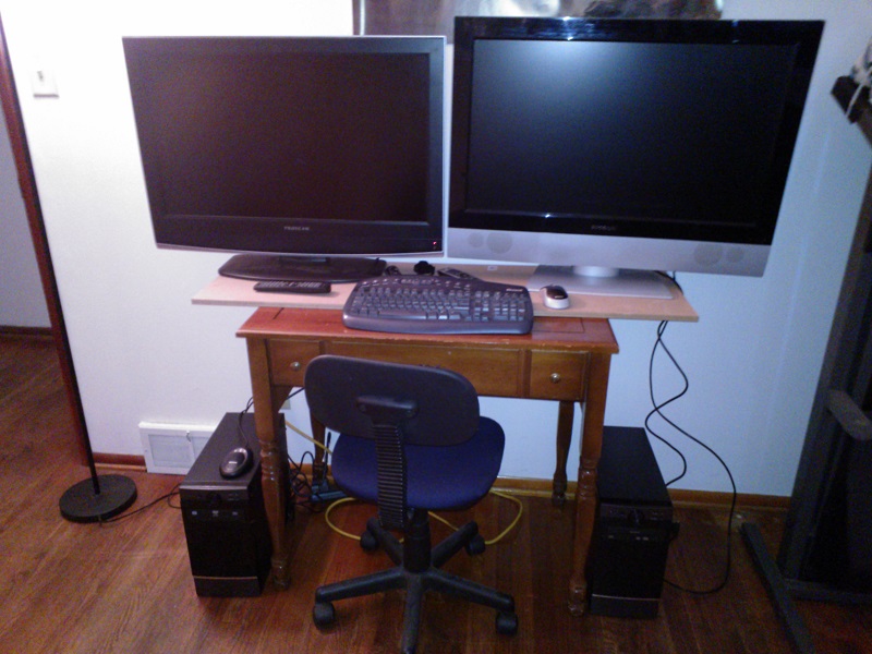

My test bed to set up networking and widescreen.  I'm hoping to have enough spare time to write a tutorial of setting up each emulator.

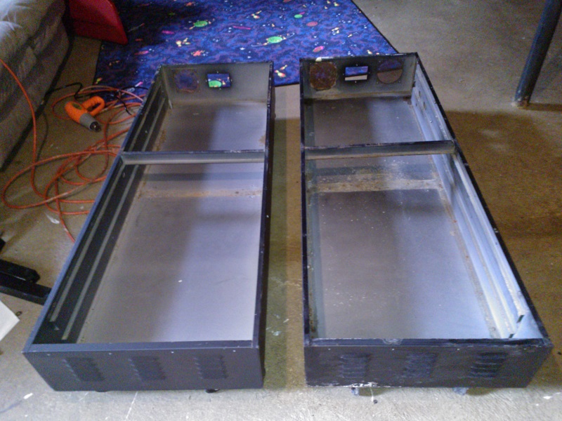

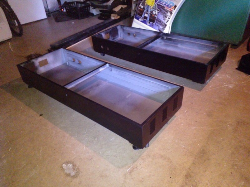

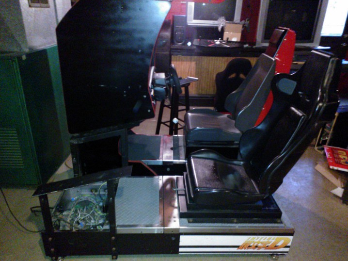

Getting the base of the two cabs to look the same involved making a new front floor section for the Initial D cab.
Luckily the angled trim pieces from the Initial D could be cut down to match the ones from Virtual On.
I decided to make new front floor sections for both cabs and leave less of a gap on the end than they originally had.
The rear floor section that came with the second Virtual On seat base was more severely water damaged than I'd realized before, so I ended up making a new one of those too.
I didn't see much point in taking pics of the process of making replacement parts using the old ones as templates.
New floor mat down, trim polished, new stainless steel hardware in place:
(still missing some carriage bolts on the far one since I mis-counted when I ordered)
The rubber mat is exactly what I wanted, but it stank pretty bad when first unrolled.   Definitely plan to air it out somewhere outside your house if using it in your main living area.  After a week of it airing out, it either doesn't smell as much or I've become accustomed to it.  :lol
Be careful not to over-tighten the hardware on these cabs.  You're just holding the trim on, not holding the cab together.

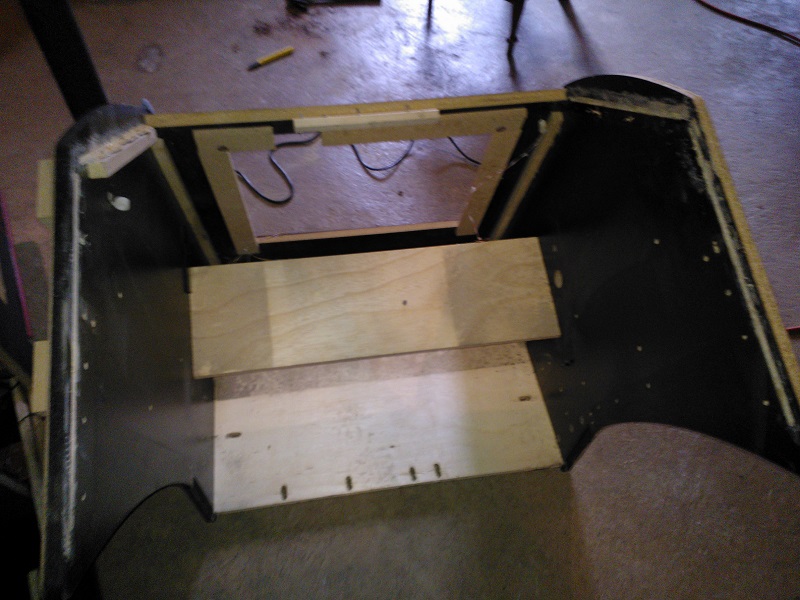

The driving position is a bit higher than expected.  I knew the Virtual On seat bases were taller, but I didn't think the cloth seat was much thicker than the Virtual On ones.  They are a good two or three inches taller.  I tried the seat without Virtual On base, but didn't care for it.
If designing from scratch, I'd have the seat bases about half this height which is probably close to what is on the regular Sega Model 2 driving cabs.  I'm sticking with the VO bases though since I already have them and forked over more than I'd like to admit to get a second one.
The old footbox sides are just there to experiment with pedal angle and other ergonomics.
Once that is worked out, I'll cut out new ones which will be shaped slightly differently.
Next on the to do list is ergonomics & maybe some software setup.

Spent yesterday wrestling with the Windows 7 installation.  It seemed fine before updating, but after all the updates some Windows background BS would hog the hard drive access to the point of nothing else being able to function.  Looking at performance monitor, it seemed to be nothing but logs, reports & report queues.  Disabling everything I could think of made no difference.  The only other thing I could find online suggested that the hard drive had issues.  I thought it was a longshot, but after swiping the HD from the PC for the 2nd cab and reinstalling Win7, it seems ok.  Sucks that I wasted a day messing with it, but relieved that it's working now.  This crap happens when re-using old parts I guess.
Loaded up the Steam download queue before going to bed, then spent most of today installing PC games.  ;D
The SimBin games I picked up at a discount store activated on Steam which was kinda nice.
I'm very satisfied with how the new games perform on this PC.
I went ahead and configured the games for a Logitech G27 which I'll probably use in the cab.
I'll have to go back later and change certain things that will be handled by a keyboard encoder.
As they're configured, the shortcuts will be moved from the desktop into a folder and launched from the front-end.
I still have a few more old ones that have issues installing on newer OSs.
Also have to add a half dozen no-cd cracks, but need to install antivirus first.
A few only work with xbox360 controllers, so I'll have to install the workaround for that.
Squeezed some extra money out of the budget to splurge on leather seats which should be here in a week.
They were $389, but all the cheap seats were $230.  So an extra $159 to get what I really want instead of making do.
I didn't like the felt like material the red seat is covered with and definitely wouldn't like pleather.
These are the same cheap seats,...but covered in leather.  Hope I'm happy with them.
