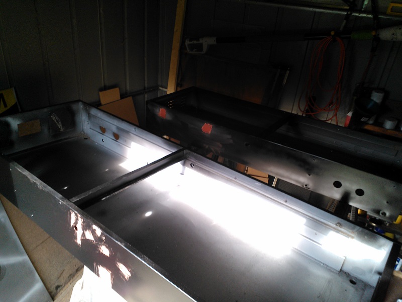

Started out with my old converted Virtual On cab and an Initial D cab.  It took a while, but eventually found another VO seat base so the seats would be the same height.
Bases are nearly identical.  The Virtual On one is pretty rough.  I regretted not fixing it up for the previous incarnation.
The Initial D base was in pretty good shape, but some of the spot welds under the decals were sloppy, so I ground them down.
They're far from perfect, but at least the look nice and clean now.  I started out using semi-gloss paint, but couldn't get it to look even.
Gloss went on a lot more evenly.  Just happened to have 8 shiny new chrome feet in my shed too! (not attached yet)
I don't care for the original Virtual On black ribbed floor material that I used last time.   Even the new stuff looks filthy now and is impossible to clean.  I'd planned to have the bases completely together, but decided to find some other material first.
The more time the paint has to cure and harden, the better anyway.

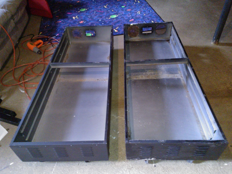

Getting the base of the two cabs to look the same involved making a new front floor section for the Initial D cab.
Luckily the angled trim pieces from the Initial D could be cut down to match the ones from Virtual On.
I decided to make new front floor sections for both cabs and leave less of a gap on the end than they originally had.
The rear floor section that came with the second Virtual On seat base was more severely water damaged than I'd realized before, so I ended up making a new one of those too.
I didn't see much point in taking pics of the process of making replacement parts using the old ones as templates.
New floor mat down, trim polished, new stainless steel hardware in place:
(still missing some carriage bolts on the far one since I mis-counted when I ordered)
The rubber mat is exactly what I wanted, but it stank pretty bad when first unrolled.   Definitely plan to air it out somewhere outside your house if using it in your main living area.  After a week of it airing out, it either doesn't smell as much or I've become accustomed to it.  :lol
Be careful not to over-tighten the hardware on these cabs.  You're just holding the trim on, not holding the cab together.
The driving position is a bit higher than expected.  I knew the Virtual On seat bases were taller, but I didn't think the cloth seat was much thicker than the Virtual On ones.  They are a good two or three inches taller.  I tried the seat without Virtual On base, but didn't care for it.
If designing from scratch, I'd have the seat bases about half this height which is probably close to what is on the regular Sega Model 2 driving cabs.  I'm sticking with the VO bases though since I already have them and forked over more than I'd like to admit to get a second one.
The old footbox sides are just there to experiment with pedal angle and other ergonomics.
Once that is worked out, I'll cut out new ones which will be shaped slightly differently.
