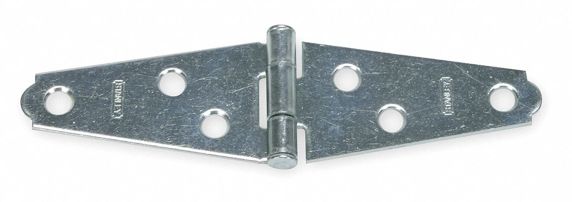

I figured everyone in here has thought about or wanted to bend some acrylic, so i figured I'd attempt to document a build on one for the forum.
This isn't an original idea as there are tutorials out there on how to build these things, just figured it would interest a few folks that may want to build there own as well.  It's also an alternative to the dreaded heat gun weight it down with clamps theory :banghead:.
I'll be asking electrical questions as i suck as electrical formulations, amp, watts, voltage etc...
The idea is to make it as safe as possible, fairly efficient, durable and cheap to build, hopefully under $100.00
  • The area will will be about 36X40, i doubt i'll be bending any CP panels wider than that.
  • It will have an angle set/stop
  • On/off switch
  • Variable heat control
  • Portable
Here are some of the parts I'll be looking into, and testing during this process.
  • 12v 5a power supply, 24v 10a power supply
  • Nichrome wire
  • 12v dimmer
  • Led voltmeter
  • Angle finder
I'm trying to keep the output DC if possible AC scares me.
I'm in the process of ordering parts now, and will post photos of the build, I'm also researching nichrome wire and its heating specs (hence 2 types of power supplys).  12v should be plenty for a CP overlay, but thicker plexi may call for higher voltage/heat.....
Anywho, any comments or suggestions are welcome, especially on the electrical side..Looking forward to the project... :applaud:
« Last Edit: September 28, 2013, 07:55:59 pm by rablack97 »

I'm guessing you already know the trick about using a spring to take up the slack/sag created as the Nichrome wire expands/lengthens due to heat, right?
It would be great to incorporate swappable bend radius forms (green) so you can choose between several bend diameters.
The heater (red) is mounted on an adjustable-height support frame that allows you to heat the bend point.
An adjustable roller (blue) keeps the plexi close as you bend it to the desired angle.
Yep, will be using tension springs to take up the slack.
Never thought of having this thing bend down, but wouldn't that limit the rig to be used at the ends of tables only.
For the the radii swapout, what about different thicknesses of dowel rods?
I was thinking about the compress roller as well, as i'm trying to keep things low cost, what about small quick release clamps.  I'm not sure how to get compression on the roller or or pull it down and have it stay.

give me some ideas on how to mount that thing, and i'll look into it.
Whether you end up using an up-bend or down-bend setup, design the table so that the top of the working surface is level with the center pivot point of the table arms.
Put the pivot point of the Protractor at the pivot point of the table arms.
The rest of these directions are for a down-bend table (fixed arm on the left, movable arm on the right), but can be easily adapted for an up-bend table.
Two screws through the protractor arm into the movable table arm.
On the back of the protractor face, attach two L-brackets on the part by the fixed arms using epoxy, spot-welding, or small countersunk screws sunk flush or slightly below flush.
The L-brackets allow you to fine-tune the angle by using screws that come up through the fixed arm and several nuts layered like this:
Upper adjustment nut
L-Bracket
Lower adjustment nut
 (small gap)
Nut to hold screw firmly to fixed arm
Split or star washer
Fixed arm
Screw head under the fixed arm
True.
The top-heat down-bend design uses gravity to assist the bend.
A bottom-heat up-bend design traps rising heat better.
Either concept works as long as you remember to heat the outside of the curve.
I also have a dual-heater (top/bottom) up-bend design with a hinged upper heater that swings out of the way of a lockable hinged bend form -- this design is for working with thicker plexi.  LMK if you are interested.
Dowel rods won't work very well because they are different diameters which changes the bend point.
Use a router and several roundover bits to shape 1x2's into swappable forms secured by machine screws and t-nuts.
Something like this could work too....
Either that or two of the el-cheapo Harbor Freight bar clamps connected to a slick flat-bottom "sled" sounds good.
Before clamping down, put a piece of thick paper or thin cardboard between the plexi and sled.
After clamping down, pull out the spacer and you have just a bit of wiggle room.
Alternate method -- use some sheepskin wrapped around the clamp bar and press down gently as you clamp.

What are you using for hinges?

Just using some simple strap hinges.  Works pretty good.
