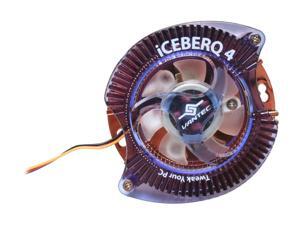

Ventilation in the xbox has different views.  Apparently the case was designed with airflow channels to keep it cool, so some folks say decasing it actually makes it run hotter as you dont have the channels any more....
I haven't run into any overheating issues, especially with the 2 fan setup, 1 for in and the other for exhaust.  So there is really good circulation over the mobo.
If you want to be super sure buy these and follow this TUTORIAL....

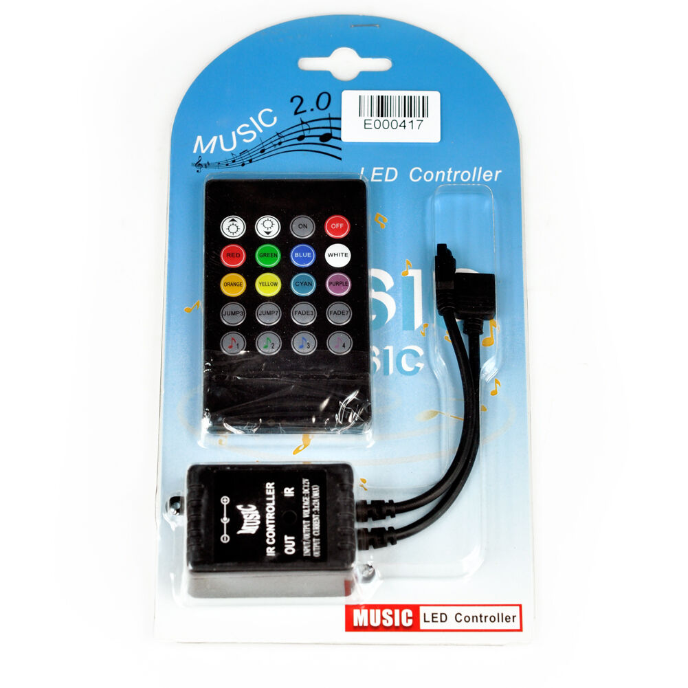

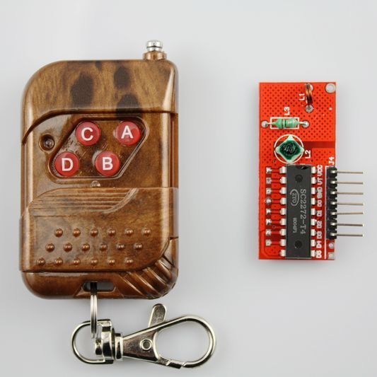

I'm gonna do some music controlled underlighting with RGB strips, and looking into a remote turn on with eject button as well.
Toying with adding the custom t-ball lighting to the Music IR controller too....
http://forum.arcadecontrols.com/index.php/topic,132054.0.html

Cant just thorw away a good fan, so I mounted it to the CPU...
