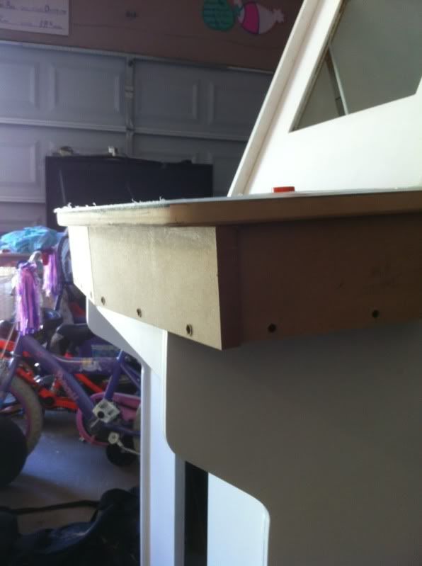

Knievel tries to show how he did it in the Evolution thread:
The glass slides up behind the speaker panel and then the bottom drops into a slot routed in the top of the admin panel. I use 1/4" thick glass so it's heavy and won't go anywhere.  :)
Here's a pic, different machine but the same idea..

« Reply #49 on: October 09, 2013, 09:15:48 am »
Yeah, you'll want to chamfer the bottom edge of the CP so that the mean dimension is 3/4".
I also routed out about 1/4" from the bottom of my joy mounts.  You probably can't do this because of your sandwich:
Here's a pic of the 1/8" chamfer that I routed around the bottom of my CP to make the dimension 3/4 for the t-molding.  It's hard to see, but that's 1/8" off the bottom edge and 1/8" plexi on top.:
You can't notice it's like that even a foot away from the arcade because the edge matches the t-molding.  Also, it feels good in the hand.

It's been a while since I've been able to do some work on my cabinet, but things have been getting better so I've been able to do some work. Lots of stuff in the background, little things here and there. I've also gone through 3 separate control panel tops -- yes, 3!!  :angry: The first one I cut my 1/4" birch plywood panel, stained and varnished it, then cut my 1/2" MDF and drilled all the holes and the cut-out area for the trackball. I lay it on top of the control panel box and find out it's just too short. So I start over on my second one - cut everything out, NO staining or drilling yet, round off the corners on the bottom edge, lay it on top of the control panel box...and you can see the corners of the box underneath my rounded corners. Third one - make it longer by an inch, NO rounding of corners on the bottom edge, cut, drill, glue together, stain, varnish...everything is looking great...and then I try to install a joystick and realize they won't fit! Wow...so much work...wasted. How did I not see that? The only thing I can figure is that the control panel top dimensions I got were not the exact same dimensions as the control panel box that I made based on Knievel's plans. I'm not upset with anyone but myself because some double- and triple-checks would have caught these before I spent extra time and money buying new pieces of 1/4" birch ply. They are only $10 at Home Depot, but it's the time spent staining and varnishing and waiting for each layer to dry... :timebomb:  There's some lessons to be learned here...
Well, I now have a control panel top that fits, it's stained, varnished, drilled...and it is ready. I had my Plexi ready and used my router cloning bit to copy the curves and straight edges of the wood sandwich. Gotta say, that router bit goes through that plexi so easily, but it does throw plastic shavings everywhere. So I started drilling holes, and, I don't know what I was thinking, but I still had a spade bit in my drill and started with that. Big mistake. Spade bits crack Plexi. I ran to Home Depot, picked up another sheet ($25!) and a Forstner bit ($7). I just had to keep switching out between drilling holes through the plexi sheet and taking the router cloning bit to make the holes match up and everything went fine. I got into a little routine and all went well. I had a flat-tip screwdriver handy to chip the melted plastic off the tip of the Forstner bit and break off the melted stuff from the edges of the drill hole so the router bit could fit in and then widen out the hole.
Pic updates!!
#1: Bottom side of the control panel top, spray painted satin black, holes drilled, and joysticks mounted.
#2: Close-up of the dedicated 4-way joystick mounted above the trackball area.
#3: Close-up of joystick mounted on left side of control panel top.
#4: Holes drilled and ready for the threaded screw inserts to mount 3rd joystick.
#5: Two inserts threaded into the MDF - they screw in flush to the MDF...perfect!
#6: All 3 joystick mounts in place!
#7: Top side of control panel top with Plexiglass in place, all holes drilled for buttons, joysticks, and trackball.
#8: Close-up of edge showing 1/2" MDF, 1/4" birch plywood, .093" Plexi sandwich. If you look close you can see the slot for the t-molding (not installed yet).

More updates! After getting the plexi cut and drilled, I cleaned up the plexi using a micro-fiber towel and some water and then did a quick assembly of the control panel top.  I had also picked up a 1/8" roundover bit (with bearing) and ran it around all the edges, the trackball hole, and the three joystick holes. I no longer have an edge to have worry about scraping fingers and hands on and it sure looks nice. I placed it on top of the control panel box and it fits all around. I'm loving it...excuse me for a second as I think I have a tear or two forming in my eye... :D
Pic #1: Overhead shot of the control panel with 3 joysticks, spinner, trackball, and all buttons mounted.
Pic #2: Another shot, zoomed in. If you look you can see the edge of the trackball area is rounded. I also put a circle of the Happ pica vinyl around it to dress it up a little. If you recall when Knievel did his "Woody" he put large and long ovals around his controls but I am going "minimalist" for right now. I can always take it apart and slip some vinyl in there...Ideas/thoughts/opinions on leaving it as it or putting vinyl 'rings' around some (or all) of the controls?
Pic #3: Angled shot so you can see the rounding of the edges around the edges, joysticks, and trackball. And yes, that trackball does have a slight recess to it. It does stick above the metal mounting plate, but not above, or flush, with the surface of the 1/4" ply. I think I wanted it to sit flush with the wood surface when I first dry-fit things, but it doesn't, so I must have figured it's not enough to worry about. You can still easily put 2-4 fingers or your palm on the trackball and have plenty of surface to grip so I am hoping it won't become a problem. If I remember, on games such as Golden Tee you want to have a lot of ball action to drive the golf ball really far, but...yeah...again, we'll see.
Pic #4: Side view to show the t-molding in place and the height of the joysticks above the surface. I tried grabbing the sticks and working them a little to see if they would be too short (yeah, yeah, insert several "...that's what SHE said!..." jokes in here  ;D ) and everything seems to be fine for me. Again, I'll have to play some games and then decide, but for now, that's what they look like and that's where they sit (not to mention that I can't re-mount them so that's definitely where they will sit! ;)  ).
