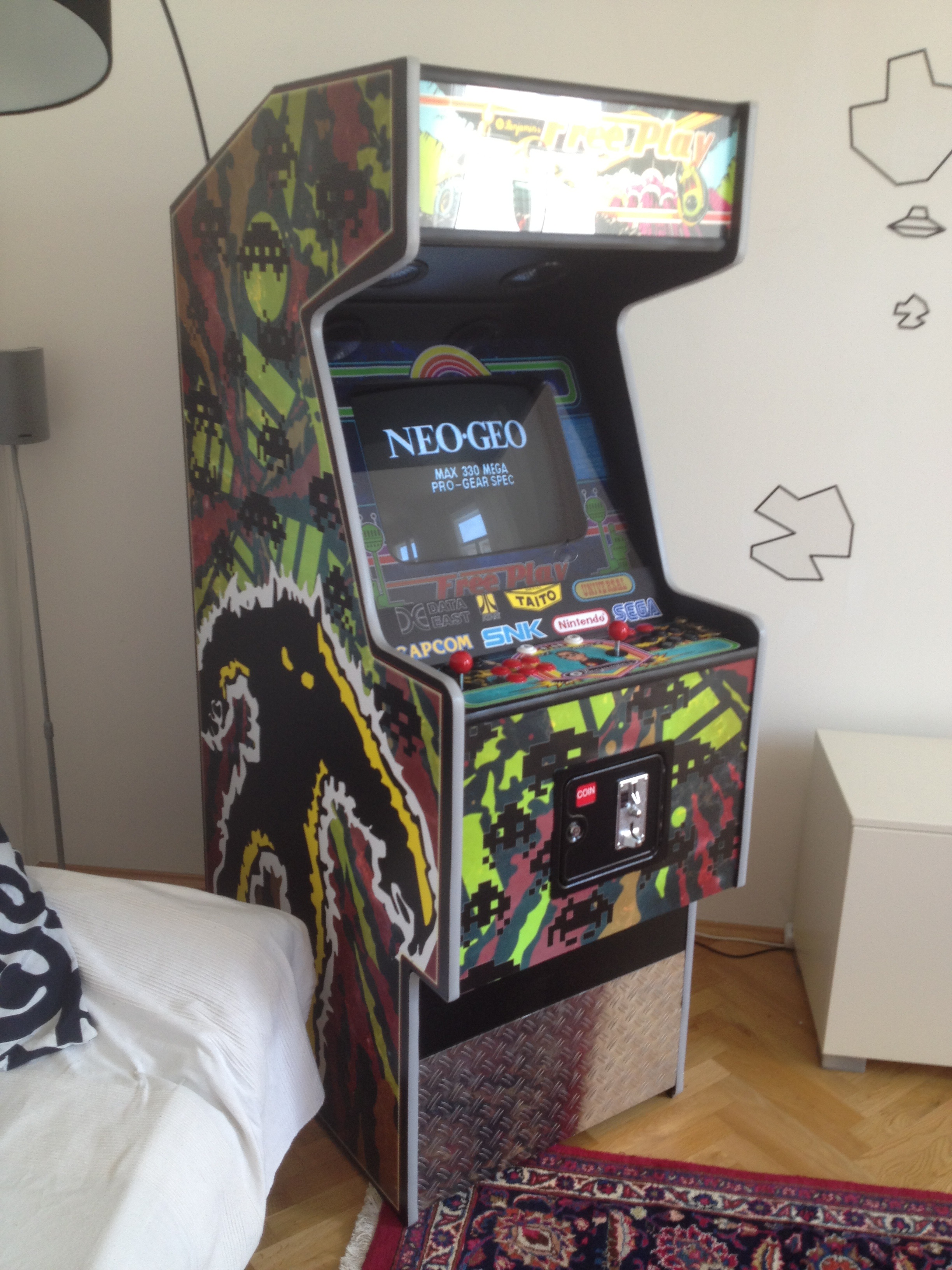

1st build - Getting started
My first attempt at building an arcade machine were pretty low profile as it was my first try at woodworking in general and i didn't manage to wrap my head around configuring a control panel. So i decided to use my ipad as screen and computer all in one and built a little arcade machine around it. Actually it's only a housing with speakers and a lit marquee. I printed some decals at a local copyshop and painted the whole thing black. The controls work by pairing a WiiRemote via Bluetooth and plugging in a common Wii Arcade Stick. The Mame4all App is installed on the ipad and wroks like a charm. That's how I got my first arcade fix and I was happy for a while.
2nd build - sizing up
After a year or so I realized, that i hardly ever used the little bartop and decided to go for the real thing. As I had moved into a new (and far bigger) appartement in the meantime, space was not so much an issue any more. While reseraching the net I stumbled over this site, got hooked immediately and spent a lot of my spare time reading and planning everything out. I dont have to say this, as everybody already knows, but this community is so awesome! I got answers to all the questions that popped into my head and even to those, I did't even think of.
I decided I want to have a CRT monitor and as Scart-TVs are readily availible here in europe for literally no money i went that route with an 21' TV i had at home.
I got myself an ArcadeVGA video card from ultimarc, configuring was a bit of a hassle but as always during this project, I learned so much while reading on this forum and figuring things out.
The actual build was a bit tedious, I was very eager to finish and get the machine up and running so I hardly made any pictures.
Woodworking is not a thing I'm really good at so I made a few mistakes. Cutting the side panels and working with a router for the first time were some of the issues. But in the end I managed to get everything done.
For the heart of the system I used an cheap AMD processor, a gigabyte motherboard and a CF card as a hard drive via an adapter. The arcade VGA is connected to the TV by a modded VGA cable (tried to solder my own but ended up beeing too clumsy with the soldering iron and so i bought one from wolfsoft.de). Sanwa sticks and buttons are connected to an iPac.
The measurements of the cabinet are inspired by Defender, for the control panel and marquee I took Moon Patrol as a base and tweaked it to look more personal. The pixel graphic is an actual portrait of me that I got  by supporting a kickstarter campain and I think it fits perfectly. In hindsight I went a little bit over the top with all the different artwork-approaches (Moon Patrol, Space Invaders, Defender and Gyruss, it's all in there somewhere :) but i still like it.
I got everything printed at gameongrafix.com. Buttons, Joysticks and the coindoor came from arcadeshop.de and after months of planing and building, my first real arcade machine was ready for playing  :applaud:
Since this machine sits in my living room, it has become the center of attention for lots of guests, regular Track and Field Tournaments are held and i enjoy the hell out of playing a quick round of all the games, i loved so much in my youth - in short: it's totally awesome :)
But there is one more thing: since a few months I'm totally addicted to everything that resembles a vertical shoot em up :) I'm playing Dodonpachi for at least 15 minutes a day, I adore the whole Cave gamelibrary and im getting better and better at those bullet hell shooters every day. You can guess what's coming up :)

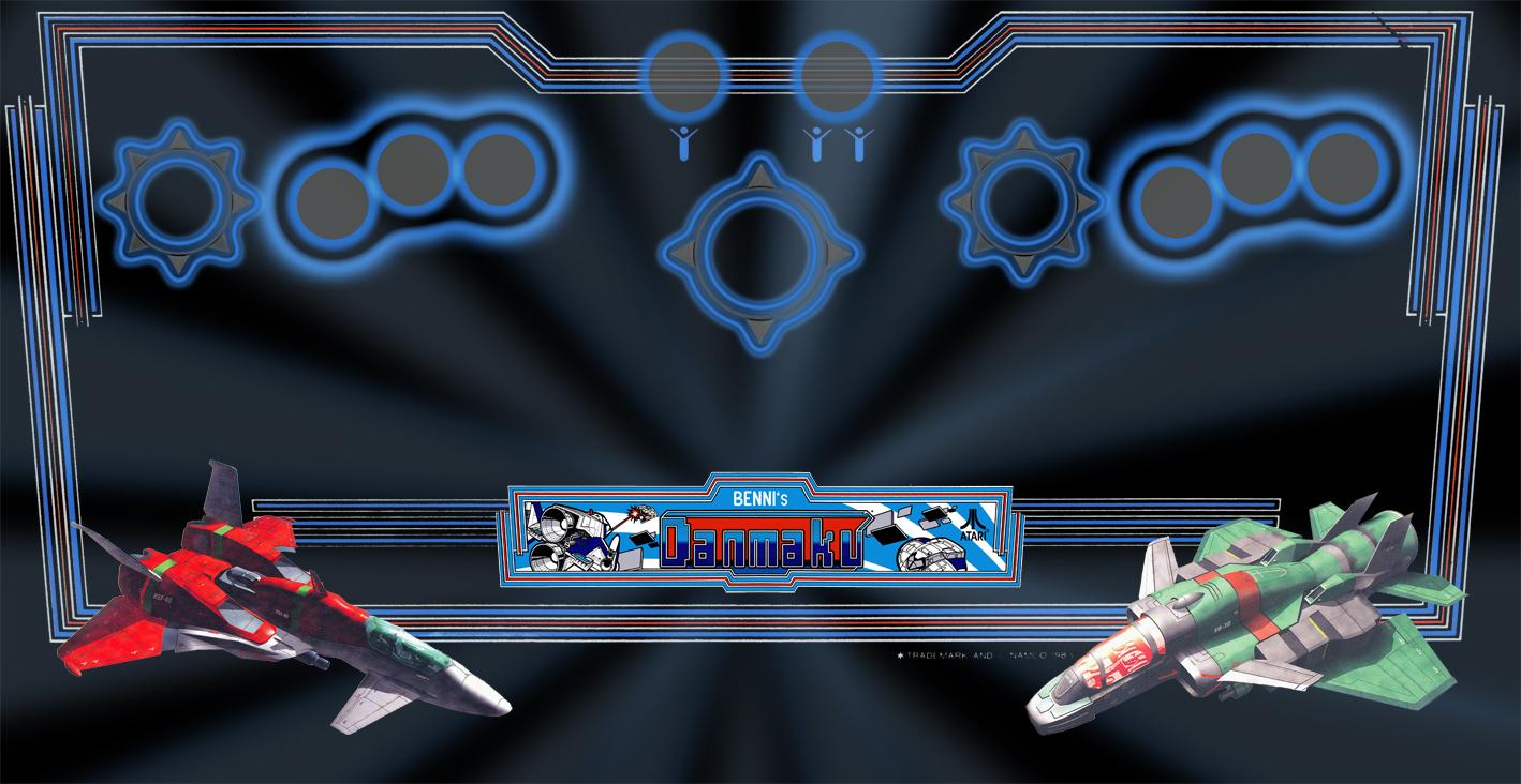

- pimped control panel
I decided to implement a third Stick as a designated 4 way stick for some classics, (especially one of my alltime favourites Ms Pacman), using a Sanwa JLW i had lying around. As the KADE only has 20 Inputs, my plan is to wire this one to the same inputs as the player 1 stick.
- LEDs
for japanese shooters everything has to sparkle and shine, so i shelled out and bought 8 Electric Ice 2 buttons with RGB-Drives  and a LED WIZ from GGG.
The P1 & P2 Joysticks will be Sanwa JLFs (still waiting for this order to arrive) lit up with a JLF LED Kit from Paradise Arcade shop.

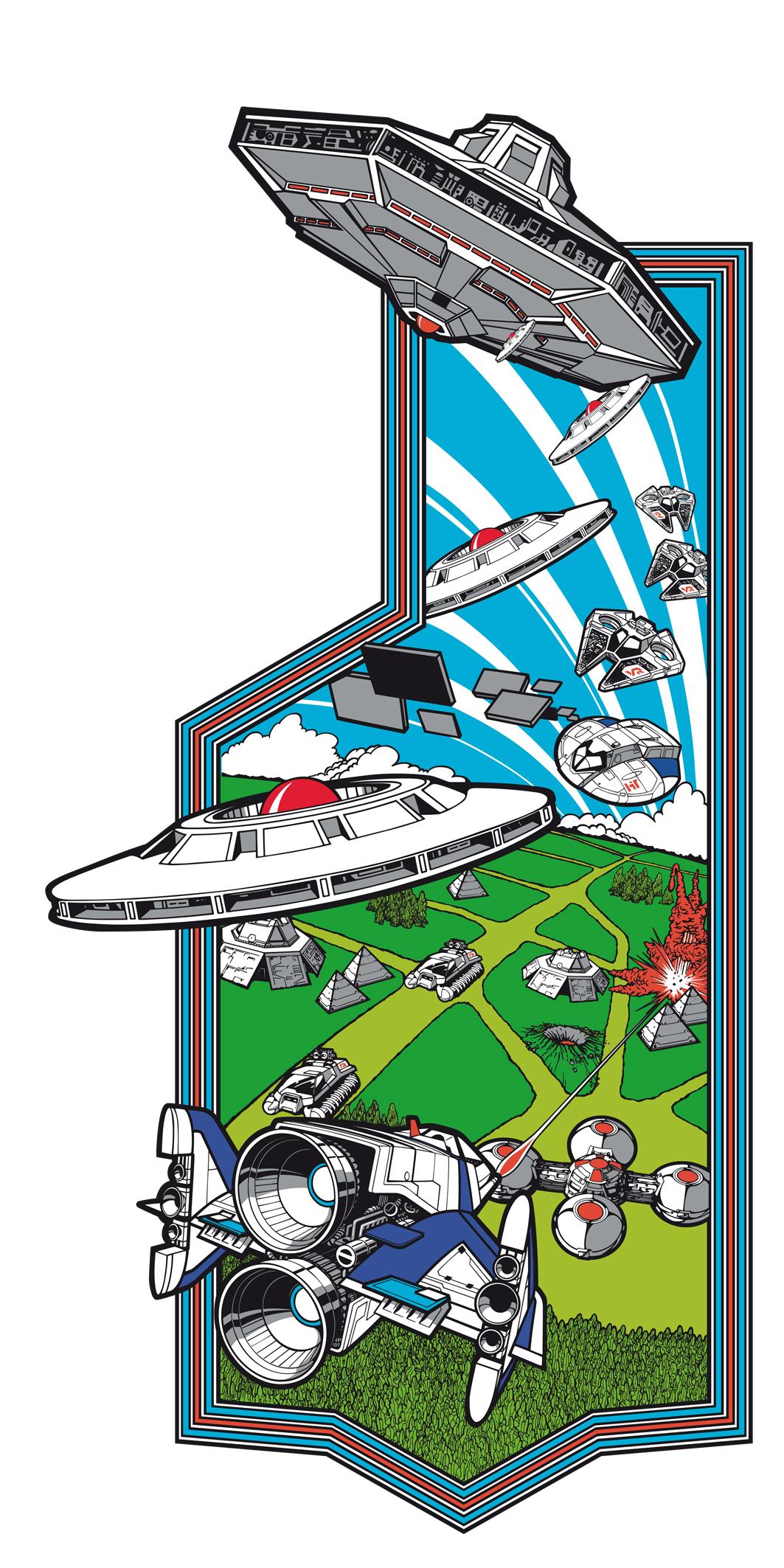

I am a big fan of Xevious, and since its kind of the first top down shooter and I really like the shape of the cabinet, thats going to be my template. I searched the net for measurements, didn't find any and ended up measuring everything from a picture of the cab, and tweaking it for my size. The cabinet is going to be a bit taller than the original.
I want to use the original sidearts, I just reworked the marquee and control panel graphics, T-molding color is going to be light blue.

Hello. The control panel artwork looks nice, but the Dai-Ou-Jou ships looks washed out against the vector style graphics behind them IMHO. If you work in Photoshop, select the layer that holds the ships and hit CTRL+L to adjust the levels. Now, using the drop select tool, click on the shadow of the ships to adjust the blacks of the image and they should fit in much better with the rest of the artwork.
I look forward to following your progress. :cheers:

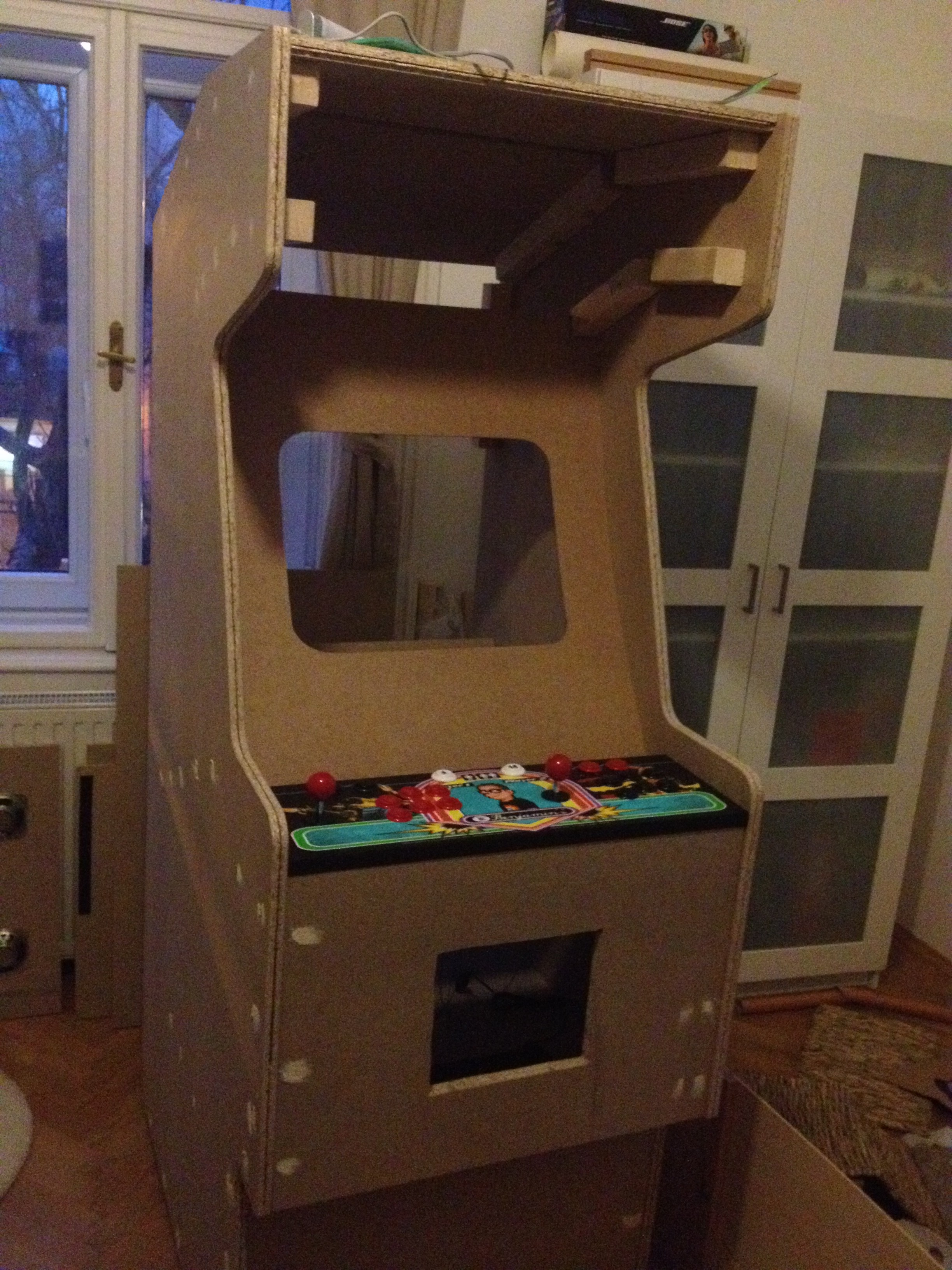

Re: Vertical Scratch Build - dedicated shooter cabinet
« Reply #9 on: July 15, 2013, 03:14:37 am »
Hey guys,
been working mainly on the controlpanel in the last week. Learned a lot of things while doing this, for example soldering the right resistors to light up the joystick LEDs.
Fitting everything in the tight space has been a major obstacle, i had to screw another MDF board on to the CP. There is a hinge attached, not visible on the pic but you can fold in the part with the KADE and LedWiz attached so that it should fit perfectly into the (yet to be build) cabinet.
My wiring is still messy as hell, but at least i used zipties and now i have at least some kind of order in there :) Its absolutely necessary by the way because i'll have to remove the wired shafts again to attach the CP overlay once thats printed. The Buttons should be easy because i can remove just the top part of the Electric Ice buttons and leave the wired switches in place. Same goes for the 4 Way Sanwa stick, here i can easily remove the balltop and shaft since it's not wired.
The LEDs look really awesome,  i made some nice looking sequences in LED Blinky, the next step it so include everything in MALA.
From a friend I got a very nice TV for free. It's a 60cm (24 Inch) philips crt from the year 2000 or 2001. Tweaked the geometry in the service menu so that it fit's best with all the different resolutions. Since there are some classics with very odd resolutions in my gamelist this was a bit of a challenge but i managed to find a good compromise. I love the easy setup with the Arcade VGA3000 and the way those games look on a big crt :)
Next on my list is to finish the control panel setup and configure my two different MAME versions to work with the CP. Then it's finally time to cover everything up to protect it from MDF dust thats definitely going to be blown all around the room soon :)
Looking forward to actual woodworking and to try out my new router bit!
Cheers,
Ben

« Reply #10 on: August 21, 2013, 07:23:29 am »
Hey guys,
it's been a very busy month, summer was extremly hot in vienna and i spent a lot of my free time outdoors. Nevertheless i made some progress:
On the software side everything is running perfectly, Mala is such a nice and easy to customize FE. Every game i selected is running perfectly in it's native (or very close to that) resolution, LED Blinky powers fireworks on my controlpanel all is running smooth.
So it was time for woodworking  :scared
This time i gave myself more time and did the job very thorough. i cut out the rough shape with my jigsaw and routed every edge with a guide to be perfectly flush. The new router bit did a very good job in copying the second side panel exactly.
After slot cutting my workshop (when i'm not doing these kind of things it's my normal office…) was covered in a thick layer of dust! I really underestimated these dirty MDF boards….
The slot cutting is always very nerve wracking but it worked out perfectly this time :)
Next step was to attach the guides for the horzontal boards.
One side was easy, just srewed them in at the premeasured positions. To save some time on the other sidepanel i attached the second guides on the first ones with painters tape, put some wood glue on them an laid the second sidepane flush on top of everything. After the glue dried up it was very easy to rip the painters tape apart, fixed the guides with woodscrews and i had two perfectly matching sidepanels.
On the base i put 4 wheels, 2 of them rotatable.
Then i assembled the cabinet with strong woodscrews, put some more guides in for the control panel and testfitted the tv.
Jump forward to present day: i routed out the front for coindoors and the speakerpanel (even got some fancy LED lit carspeakers and a little car-amp thats also powered from the PC.) and spent the last two days bondoing, priming, painting and sanding the cabinet. gooosh, sanding a thing that big is a really tedious process!
But i made good progress, after the second coat of paint its a lot smoother than my first cabinet.
If everything goes well then the cab will be assembled for a first test-round this weekend. Only thing thats still missing are all the artworks obviously. My funds have run low a bit at the moment so these will have to wait till next month. Credit for the hole in my wallet goes to this little machine here, the newest member of my growing arcade familiy :)
a 1984 Williams Space Shuttle in really good condition, perfectly playable, only minor problems. 2 lamps not working, some small spots of wear on the playfield. Currently i'm restoring the legs and sanding all the rust away.
So after i finish the shooter cab i'm gonna be occupied in outer space for a little while as i plan to disassemble the playfield and get this baby in perfect shape. Doing a lot of research in the pincommunity online and in my neighborhood at the moment, really loving it so far  :D
So long, the next update should be in a more timely manner!
Cheers from vienna
Ben

Here you go, GGG electric ice buttons plus RGB Drive 2 and regular Sanwa JLF sticks with the paradise arcade LED Joystick mod
