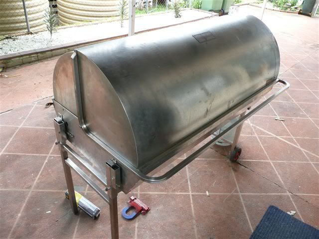

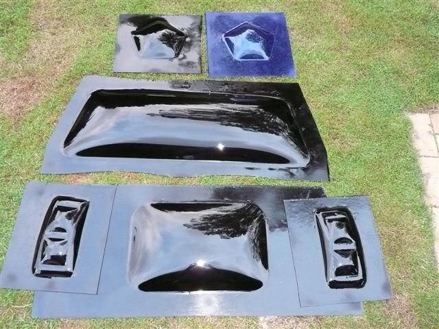

While we are talking ovens...
We blow moulded some dome windows for a mate's 70s era show van in a BBQ

Please tell me there is fuzzy carpet or wood paneling in the inside of your mate's van!

See told you BBQ GRILL!!!!!
Yes dammit, there a Carl back in the stone ages.....
LOL, griff is going to make a portable convection oven...........
