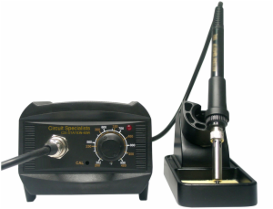

I have 60W soldering station from circuit specialists and can't fault it at all.  Has been very reliable and used for all kinds of soldering tasks - including soldering up hundreds of KADE devices.
http://www.circuitspecialists.com/csi-station-60w.html
My model seems to be discontinued now but there are various alternative models including similar one with digital temperature control.
http://www.circuitspecialists.com/soldering-station-60-watt-3dlf.html
I purchased with various tips but have mostly used the conical/fine point tip for precision soldering - with 0.5mm 60/40 solder.

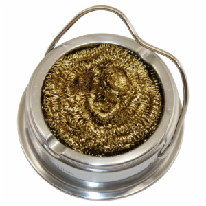

Also recommend these for cleaning the tip: http://www.circuitspecialists.com/ty-98.html as they keep the temperature stable compared to the wet sponges.
