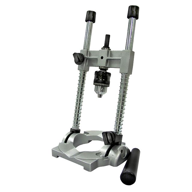

Question: How do I know how deep to countersink?
Just enough to get the heads completely in. Better a bit too deep than not deep enough as you will cover the remaining hole with putty anyway.
If you are looking for a quick/repeatable method using a drill guide, try this:
Turn the flat-head screw around and trace around the head on a scrap piece of wood.
Drill through the center of the outline with a slightly larger hole than the threads of the screw.
Run the countersink down until the countersink reaches the outline.
Verify the depth of the countersink using the screw.
If it is the right depth, set the depth stop on the drill guide.
Now you can use the drill guide to countersink all the holes on your cab to the same depth.
