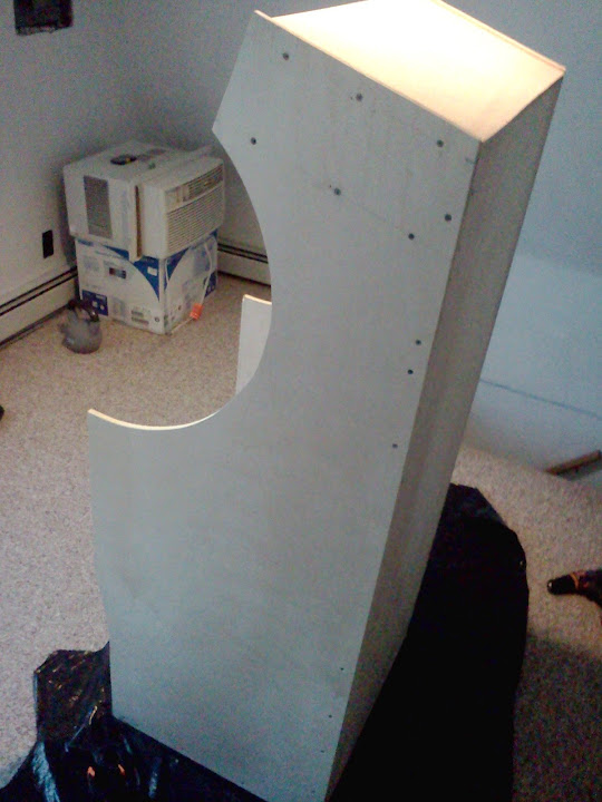

Thanks. Ok side panels cut. i freehanded with the arc with a jigsaw. The arc was a little tricky to get right at first but turned out good I think.
Excuse the crappy cell phone pics ill have my other camera soon!
I got the base done. Left a 4" lip to cover the bottom. The door will be 4" shorter then in the plans.
Also added casters. I had regular caster wheels but returned them for these locking ones instead. I didnt want to have the cabinet wobbling around.
« Last Edit: March 08, 2012, 05:56:43 pm by PIZZ »

Yeah cutting that curve can be nerve-wracking but looks like you nailed it, excellent start  :applaud:

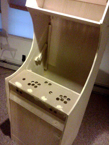

finally been able to make some progress on the cab. Been busy with this and that so Its been slow moving.
After multiple trips to Home depot...
The real magic happens with this stuff
Those cabinet latches were a real  pain in the ass to get on correctly! Since im using 1/2" paneling I had to drill a hole all the way through the paneling. The latches sit just flush with the hole. Lots of putty should cover things nicely.
So far its coming along, slowly albeit. Now just sizing up the top board and trying to get my CP art done.

Coming along nicely man, woodwork looks a lot cleaner than mine  :applaud: but yeah wood filler is definitely your friend  ;D

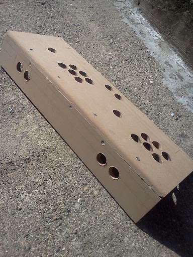

inching along... I got the CP built. I went with a piano hinge in the rear. No bolts, gravity takes care of the rest. Im glad it works well because I didnt want to have to use clamp hinges.
Im using a 22" monitor because I plan on using my PS3 along with my laptop to run 16:9 games. I wanted to easily take out the monitor if I needed to so I decided not to bolt on the monitor bracket, instead using support braces and letting gravity keep it locked down. Because of the angle that it sits on, it stays in place pretty solid.

I would figure out how to secure the CP closed.  Once people start playing they are going to be pulling it up all the time.  Cabinet looks great by the way.

Thanks, ya I like the Taito style. I like that Its lightweight yet sturdy. I live in a condo in the city and have limited space so I didnt want to have a huge cab weighing a ton.
Javeryh: ya I think I agree, I might have to add some sort of lock to the CP. The standard latches wont work though because of how the CP sits in there. Ill have to figure something out?!

Great work so far PIZZ. For holding down the CP, have you thought of using industrial strength velcro? I know i've seen it used succesfully in other builds on here?

Thanks I might give it a try. Ive used it before on other things. That stuff definitely has amazing grip. I was thinking of using those swing type latches too.
