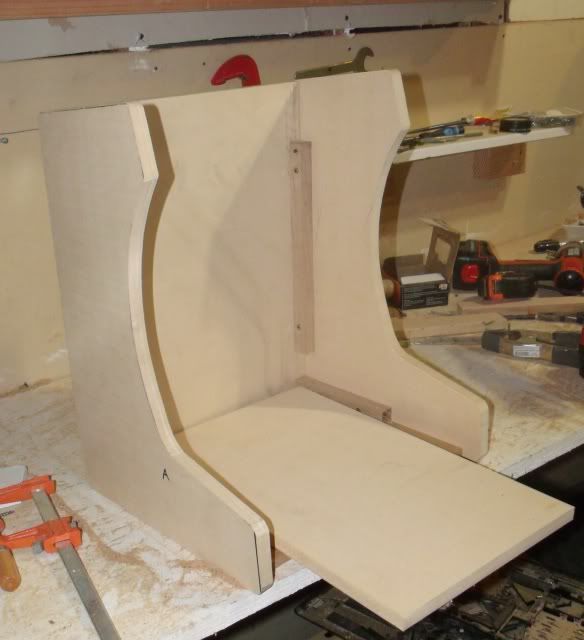

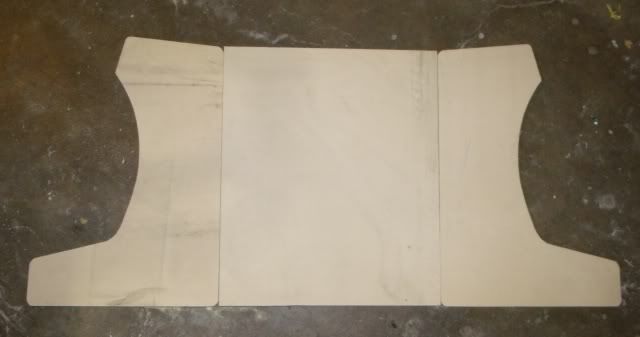

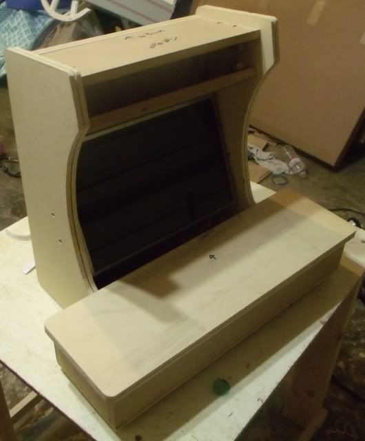

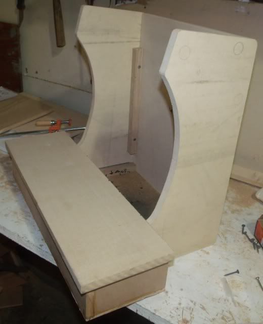

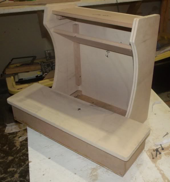

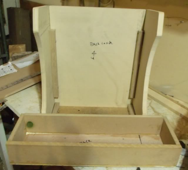

Thought I would try and make a half decent bartop. Got some MDF cut up using a template I created from a failed particle board side piece. MDF is 5/8", ordered t-molding from "gamemolding.com"'s Ebay store. Still attempting to make this rather frugally, will be doing my best to touch it up a bit better.
I have a full roll of that black contact paper to use on the sides, which I think will look much better without screws protruding and a smooth surface for it to be applied to. Or do you think I should go with paint? I have always failed at painting things  :banghead:
Also rounded the edges, will help with t-molding as well as give it a little extra something.

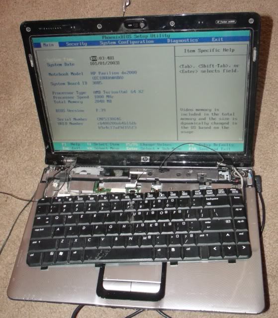

Had a fukton of laptop parts laying around from failed fixes and trades. Was able to piece together an HP pavilion dv2000. It was missing the laptop hdd connector, weird L shape thing, just got done soldering on one from a broken USB sata adapter. I am determined to use all I have before buying anything new. 2gb of ram and 1.8ghz dual core CPU, out beats the junk laptops I was using before, and they ran beautifully on MAME .83  :applaud:

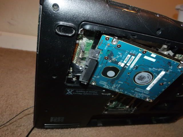

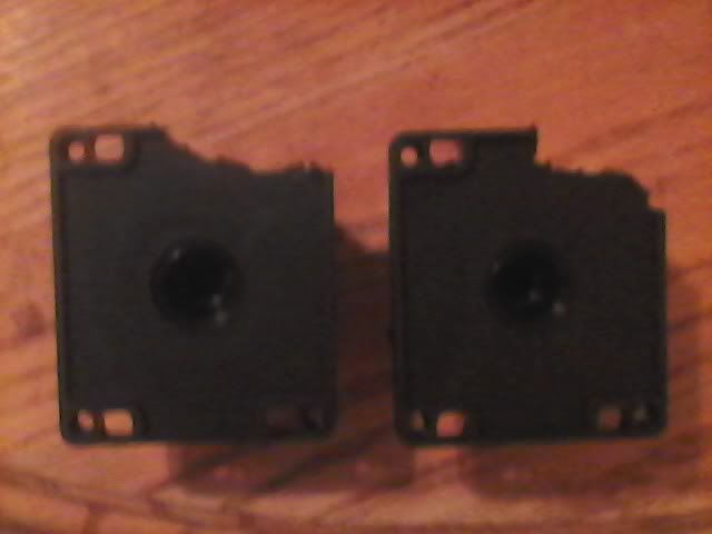

Here is the laptop. I would just sell it normally but it is missing too many little random things, like a back plate for memory, cracks and scratches, etc.

I quit using laptops. While the size is nice, usually the plugs and everything required make for a larger unit than an atom based board. However, if you have a laptop, go for it. I squeezed an atom motherboard, PSU, and HD into a 18" Galaga bartop. Overall, it was a smaller footprint than the laptop.
The other thing I don't like about laptops is they usually don't allow you to power on automatically after the power is turned on (AC Power Loss). They require you to hit a button. Not a huge deal, but right now I flip a light switch and all the arcade games come on and I like that.
Woa....I never thought about using the power on after Ac Power loss settings for anything arcade related. That is an awesome idea. I don't think I could fit a pc in this size, a rasp pi perhaps. This bartop template makes for a rather small bartop.

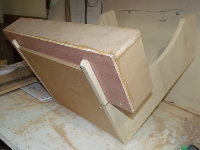

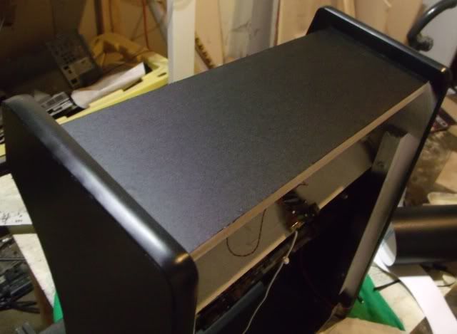

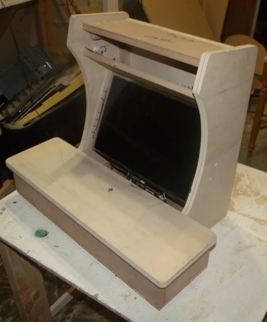

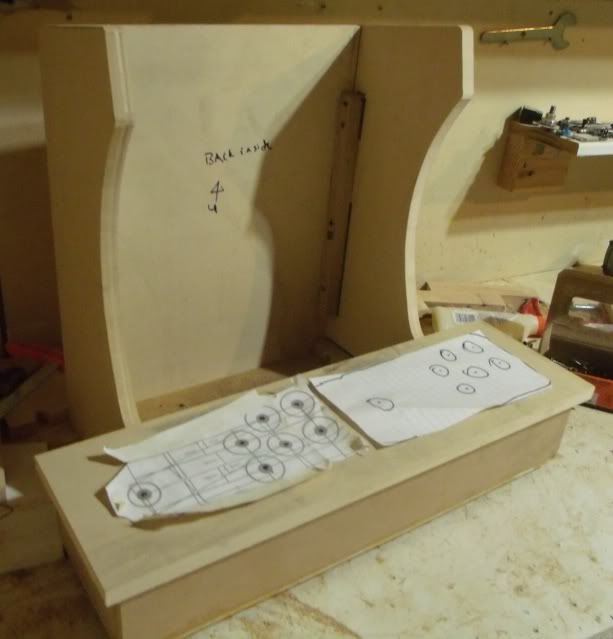

I got some more work done on it, trying to get better quality with this one is going to be fun but is also proving difficult since I don't have time to plan\plot\design properly if I want to get it done before I leave. I enjoy coming up with solutions to problems as they come along so it isn't too bad.
The laptop is widescreen so naturally the bartop has to be wider, this also helps to accommodate the two player controls. I didn't want it to be too wide though so I am making the control panel (not sure if there is a term for it) protrude from the sides.
The mdf is a bit dirty but that isn't an issue with a bit of sanding.
I had no idea how I was going to connect the control panel but I think this works out well

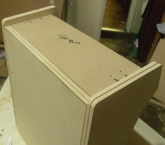

Sanded a bit, rounded corners of CP and finished the top piece will add pictures. Wont be any screws showing this time I promise :D

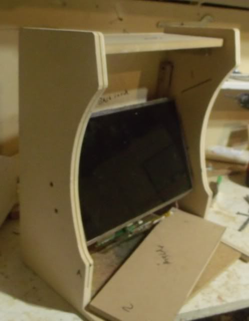

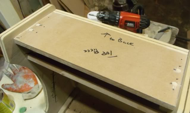

Did a bit of work today. Am really liking the way this is turning out   :D
Routed for t-molding, speaker piece shoved in place for now.
Fitting the computer & screen in.
Bother speaker piece and computer in their perm. locations.
This is what i came up with so far on the art stuffs. Chalkboard vinyl most places and a nice marquee. With red n blue buttons\joysticks. Not sure if black control panel or i should print something out and sandwich it between acrylic.....

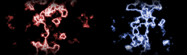

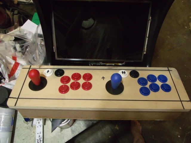

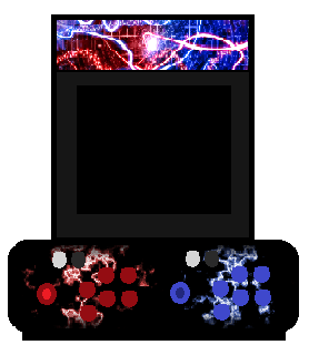

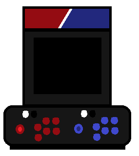

First time messing around in Photoshop to create cool effects. Made some quick control panel art that isn't very detailed but I kind of like it. Idea obviously based off of the GOG CP I was linked. Red Vs Blue lightning.
It isn't as exciting as the other one but like I said I kind of like it and have no Photoshop skills whatsoever. Would like to do button surrounds, but can't find much information to make it easy to get it right. Anyways, what you guys think of it? And if you can do better, please....please do  :cheers:

For the overlay just download the correct dpi overlay from slagcoin and import it as a transparent layer to the image.
There may be an easier way, but that was how I did mine :)

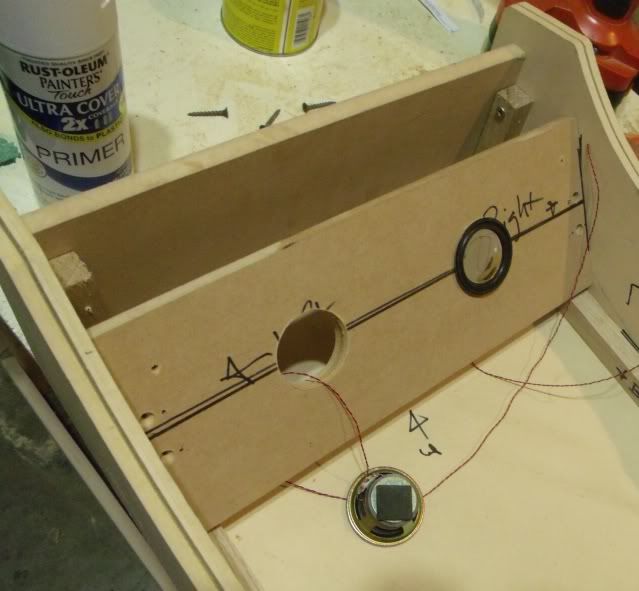

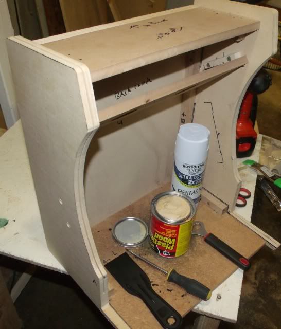

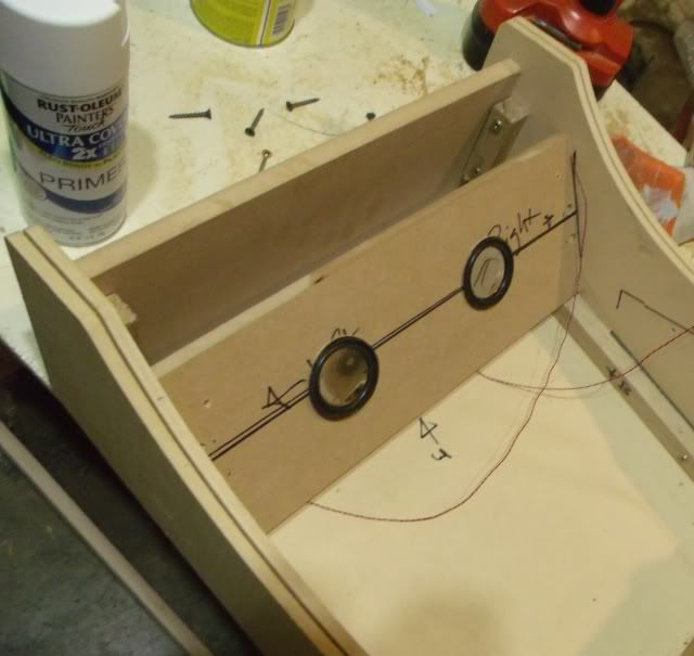

Got some things to make this perdy.
Cut holes for the speakers. Bought a cheap ass $5 iphone amp thingy off ebay.
Fill them holes
Priming
And now we wait....... :P

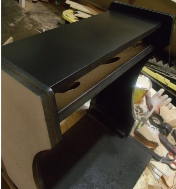

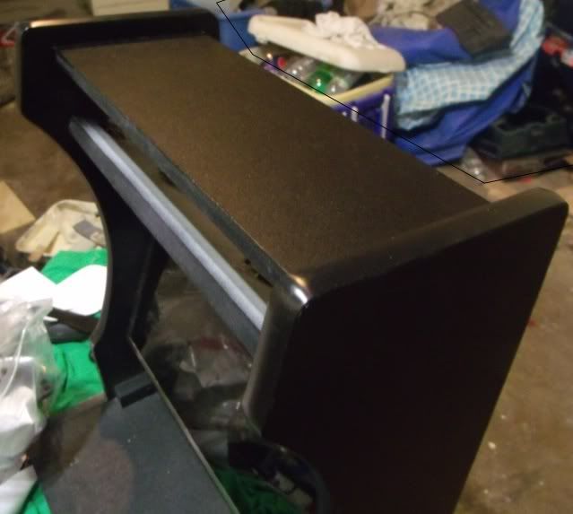

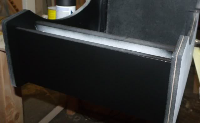

Did a bit of painting and am awfully surprised at how good it turned out with the rust-oleum matte black paint. I could do the sides and actually be happy about the finished product......But I bought a roll of this blackboard stuff...... :banghead:
rablack97
  • Posts: 2215
Re: Not as cheap bartop :D
« Reply #25 on: November 07, 2012, 08:39:50 am »
yeah paint is good if you do it right....
it's amazing how stuff can look when you take your time man..
Go get you some black metallic, and just mist over that black, then put about 3 coats of clearcoat on let it cure for a few days.....
polish it up with some Swirl-x.
Put that bad boy in some sunlight and it's off the chain....
All i can say if you better put a hefty price tag on this one, you sell this low, your other clients are gonna be pissed when they see this one vs. your wal-mart version...
great job man... :applaud: :applaud: :applaud:

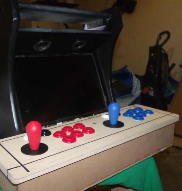

Awaiting a package today containing my Joysticks & Buttons, always feels like Christmas when I hear that knock at the door.
No comments on the control panel?  :laugh:

I like what I did for the CP, simplistic. Marquee though, might steal something.
Cropped the image you sent to see if I like it as a marquee
100dpi should be more than enough for the small marquee size.

lol, graphics were never your issue on the other builds, i'm trying to get you through to at least have something nice to put the graphics on....baby steps dammit baby steps...
CoryBee
  • Posts: 2093
  • Bopity Boopy
« Reply #31 on: November 07, 2012, 07:20:33 pm »
HEY, clam your tits man!
It is pretty, and I like it  :angry:
« Reply #32 on: November 07, 2012, 08:01:38 pm »
 :laugh2:
rablack97
  • Posts: 2215
« Reply #33 on: November 07, 2012, 09:25:13 pm »
awe hell now you've been distracted.....dont you dare pull out the oscar the grouch techniques.......
i like the marquee, the CP not so much....you have fairy trails in the marquee and electrcity in the CP....
match em up....
in fact i like it the way it was...
most people dont do button surrounds on that staggered layout cause it just don't look right....
if you were to do a 6 button layout straight across 3 and 3 then you could just do a halo around it....
i think i still have my .psd if you want it.. it has the halo layers and some nicer looking buttons.
Sooner or later we are gonna get you totally cleaned up, got dammit man even the buttons on your art look rough....... :soapbox:

I covered the sides in the chalkboard vinyl, really liked it. Also did the top piece as well. Looks spiffy. Then I did the t-molding,  :applaud: I love this stuff!
Measured out the inside of the cp box to make sure everything will fit. And used a modified version of one of Slagcoins templates, sega hybrid layout shortened to make room for player two. (Could of had more pics, but batteries)
I knew from the beginning if I wanted to fit everything in this size control panel I would have to modify the Joystick a bit. Cut the top right corner from both red & blue to make room for the Player 1 & Player 2 buttons. Cut it quick with a jig saw, it works.
(camera phone)
Everything fits!
The vinyl needs to be wiped down cause of dust but I am liking it.

sawing up your jstiks with a jigsaw :whap
Yea, thought about not sharing that part.....scared to death of my dremel since it has started wobbling something fierce recently :scared
