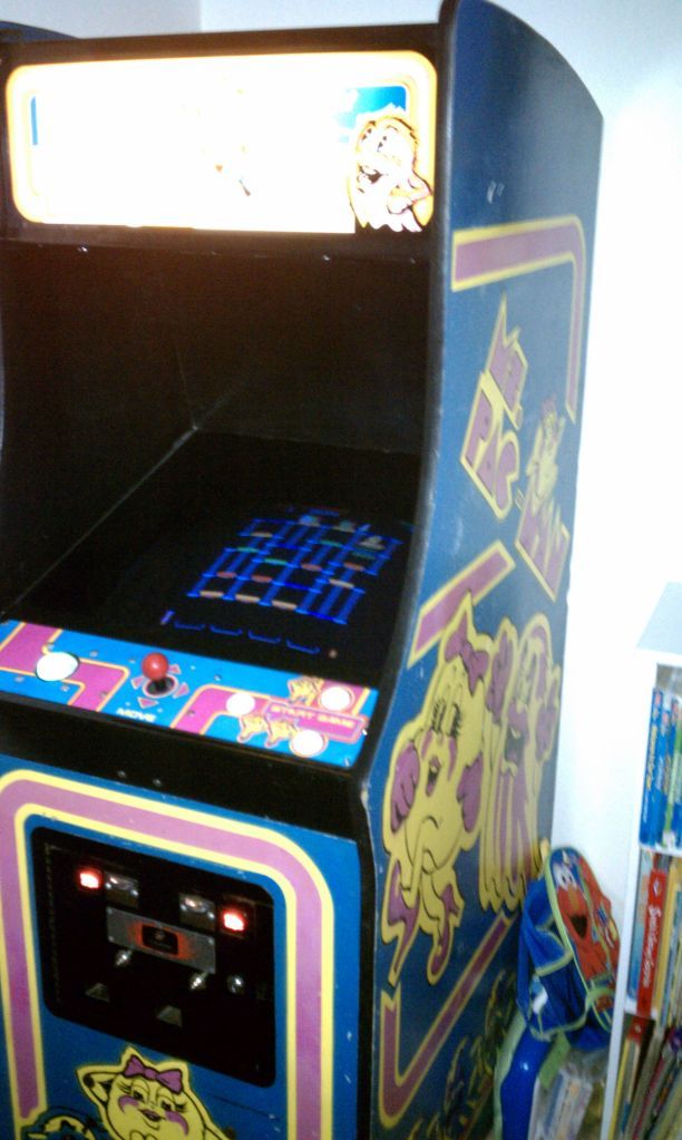

35% Light transmission is what I recommend. I used 20% on both my ms. pac-mame and pinball backglass and I think it's a little too dark:
