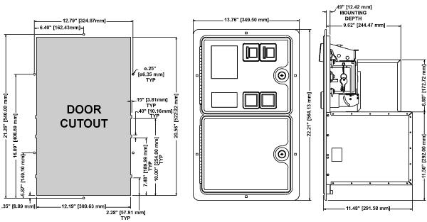

Just bought this cabinet on Craigslist. I like everything about it except for the massive hole for the coin door. I'm just worried I'll never find a door that will fit and look ok for a decent price. Obviously I can always cut a new panel, but I'd like to avoid that if possible. Does anyone know if I might have any options?
The dimensions of the hole are roughly 21 X 12 and a half. Any thoughts???

This could be it, but you might prefer buying a different cabinet rather than getting the Over/Under Wide Bill Validator Door w/Cashboxes and Full Metal Enclosure new from SuzoHapp for $266.50 + shipping.
Opening size appears to be 12.19" x 20.58".

Get a smaller coin door and some black speaker mesh and construct something that fills the hole correctly.

I would just mount another piece of wood behind the hole and mount a normal over/under door in that... the cutout would be a cool depth accent to the coin door, which is really the design highlight on the front of most machines.

I'd just cut out a panel that will fit in that hole and make it removable.  There's no need for a coin door on a MAME machine.

I appreciate all of the ideas for sure! And PL1...That's definitely the one! HOWEVER, now that I see all of these opinions, I'm thinking why compromise? That wide HAPP bill validator door will fit perfectly, but is that really what I want it to look like? I'm not sure I do. It's wicked expensive too. Maybe I could find it cheaper, but I'm kind of on a different train of thought now.
I'm thinking of a steel plate (maybe 1/16") cut to bolt over the entire opening. It'll have cutouts for a 4-player coin door and an access door below it laid out and spaced like a dedicated MK2 cabinet, (except for the 4-player instead of 2-player coin door). I'll paint the metal plate and the coin and access doors with a fresh coat of black.
Then, do I radius the corners of the plate? Or leave them as sharp 90 degree corners? Do I use a glossy or matte black paint? Textured paint? Also, I say "I", but I don't have the equipment for this. Where can I go to buy this plate and have it cut to my specs? So many questions!
I think it's a good plan, but I need to have it cut! I used to know a guy who worked at a sheet metal company. He cut some special pieces for me for a couple of animatronics projects years ago, but I wouldn't even know how to get ahold of him now. Hmmmm....

The problem is that that ISN'T the right one. The $35 one is the "mid-width" and isn't big enough, so I'm not going with that one. The one that's the right size is the "wide", and that's $266 new.
I agree, I think hammered finish would look great, and I do think keeping the corners sharp is the way to go. I don't want to cover up the other holes on the front because if you look closely, you'll see that those are cut perfectly and in the right place to mount my 2 HAPP recoil gun hoses! Woot!
I'm thinking if I can find a sheet metal company to sell me the right size plate pre-cut, then I can cut the holes myself with my trusty jigsaw. Yeah it's not the ideal way of doing it, and yeah I'll burn through a few blades, but once the doors are mounted it'll look perfect from the outside.
