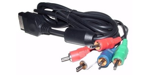

Next the component to vga converter (glad I decided to go for this instead of s-video, picture is way better):

lcd monitor s-video? that would have like a second delay lol..
you should consider getting some kind of hd cable or something. nice design tho.

I have hooked up the monitor yesterday and didn't notice any significant delay on the s-video input. If it should turn out to be present in a layer stage I can always revert to a vga hack instead.

If you are going down the non vga route at least use scart, pretty sure with scart you can power one of the pins so the tv switches to the correct channel( possibly out of standby too)
You have a 1.6 xbox, there is no vga bios hack available for this. I managed to pick up a mayflash YPbPr to RGBHV VGA from ebay, once the region is changed to NTSC and 480p/720p enabled it works fine.

That's exactly what I decided to do, since the nut of the switches I ordered is just as big as the switch top I reckon there will be no problem with wrinkles in the artwork.
I don't like the looks of the mini buttons from arcadeworld.
I'm not using a TV but a PC LCD monitor with S-Video input, so scart (basically at best component+audio in a little box ;)) is not an option.
I have another v1.0 Xbox as well, so as mentioned: If the S-Video turns out to be too laggy I will go the VGA route, but so far I haven't noticed any significant delay on the input.
p.s. Thanks for the tip on Kade, might just do that but don't want to bother him too much.

The one thing you will notice between the svideo and vga is the quality.

I'm quite happy with the quality of the s-video signal on the 214T, no jitter, and for instance the XBMC flicker filter can easily be set back to 0 without a problem so for now it's ok for me.
Next to that an arcade game shouldn't look too crisp ;)

OH no.....s-video is boo boo....
use these and get 720p resolution.....
http://compare.ebay.com/like/200477246021?var=lv&ltyp=AllFixedPriceItemTypes&var=sbar
http://www.ebay.com/itm/NEW-MICROSOFT-XBOX-AV-COMPONENT-CABLE-FOR-HIGH-DEF-HD-/190848095827?pt=US_Video_Game_Cables_Adapters&hash=item2c6f6ed653
I use these on all of my builds and the resolution is gorgeous.....

Thx for the tip Rablack97!
Although the type that you posted is a lot more expensive if I want it shipped to the Netherlands.
I found these instead:
Single output:
http://www.ebay.com/itm/HD-Video-Converter-Board-HD9800-GBS8200-Arcade-Game-VGA-RGB-CGA-EGA-YUV-/400422239695?pt=LH_DefaultDomain_0&hash=item5d3b067dcf
$ 29,- incl. shipping.
Dual output:
http://www.ebay.com/itm/New-RGB-CGA-EGA-YUV-to-VGA-Arcade-HD-Video-Converter-Board-abb-/190854005923?pt=LH_DefaultDomain_0&hash=item2c6fc904a3
$ 29,99 incl shipping
Think these are the Gonbes dmarcum99 was refering to, will these do as well?
Edit: just noticed on the pcb's that the single output version can be powered with 5-12V DC and the dual version somehow is 5V only.
Since I have a 12V psu in my cabinet the single output version would be the better choice for me.

Yes those should work fine...A friend of mine showed me those a few days ago, I ordered 1 to check it out....
Here's the same one cheaper....
http://www.ebay.com/itm/NEW-Arcade-game-RGB-CGA-EGA-YUV-to-VGA-HD-video-converter-board-HD9800-GBS8200/360690521769?rt=nc&_trksid=p2047675.m1851&_trkparms=aid%3D222002%26algo%3DSIC.FIT%26ao%3D1%26asc%3D261%26meid%3D8862333107307474786%26pid%3D100005%26prg%3D1088%26rk%3D2%26sd%3D190854005923%26
Here's nice video reviewing it....
Also, you could use one of these and plug it into the PSU of the xbox and pull 5v or 12 from the splitter.....

From what i see, it doesn't play well with the component cable to vga....
Here are some good reviews which you may have already read, after reading, it seems this board is unstable, and is power finicky.  Also I found out the newer boards have the dual vga output, so not sure which one you ordered.

Super apologies, it works..........
This was a mistake on my part....I have 6 xboxes in my closet and the one i hooked up to just so happened to have the softmod vga hack installed, so the card was fighting the hack. :banghead: :banghead: :banghead:
I hooked it up to a different xbox and voila, perfect output.....so all i well....
