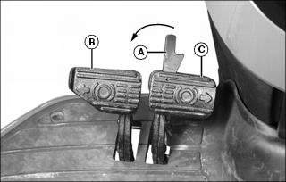

In an effort to keep my build thread focused what's actually been built I'm yet again posting harebrained related questions for group brainstorming.
I need to selectively connect two square axles.  This will allow me to use the left and right speeder handles independently or in unison.  My plan is to linearly actuate a collar bearing mounted square-holed sleeve across a gap a RCH wide between the two axles.
I'm in love with this: but it costs a measly $1500 with controller for an inch of travel.  F that.
Here's what I'm thinking:  DC motor connected to a rail similar to what's on TJC's CP slides with two limit switches.  Put the rail in the middle and two guide rails on either side then just mount my axle joining bracket to a base plate on all of that.  Whole shebang should take up 3 or 4 inches and only needs to actuate an inch either direction.  Motor wired to a DPDT.
Crazy, ludicrous, just might work?  Is there a better way to skin this cat?  What parts would you all recommend I start loading into my shopping cart.  I am not opposed to spending money on this to work, I've looked at micro-slide tables and really like those but am not sure how to actuate them as is so building one of my own came to mind. I just don't want to break the bank over a trite feature.

First thing that came to my mind was how tractor brake pedals are set up...

This made me think of the hi-low gear on my lathe.  When you want the lathe in high speed you manually push a pin that connects the  gear to the shaft.
To put it back in low you pull the pin out and reconnect the reversing gear.
With the limited amount of travel that you should have, you should be able to  automate a pin, or several pins on a collar that are spring loaded and actuated with a solenoid.

I'm not coming up with anything better than the square collar and linear actuator.
(picturing it attached to one axle and extending a collar to the other axle when activated)
Surplus Center has some real cheap ones without limit switches, but built in ones would eliminate a lot of parts.
http://www.surpluscenter.com/item.asp?item=5-1783&catname=
Not sure if you'll already have a 24v source, but the draw is low enough it could be powered from a laptop brick.
EDIT:  probably need to ensure that the collar doesn't move until the axles are aligned. (handles in same position)

Just magnets.  Really strong neo-magnets?  So when they are near, they join, but can be split by a normal strength person to use them independently.

Here's another possibility that is bistable, doesn't matter if the handles are aligned when the switch occurs, and uses a linear actuator with a short throw.
The left throttle collar (green) and right throttle collar (blue) both turn independently of each other around the throttle axle. (yellow)
The coupling collar (gray) fits over and turns with the right throttle collar.  It has a spring loaded pin that goes through the right throttle collar
The linear actuator (light blue) has a screw head (red) on the end that passes through the curved red slot shown in the side view. The screw head and actuator shaft are both too large to pass through the slot.  Use a small bushing (not shown) to protect the threads of the screw.  The actuator is mounted to the speeder body and does not move with the throttles.
When the actuator extends, it pushes the coupling collar forward.  If the pin is not aligned with the hole in the left throttle collar, the spring is compressed until the handles are placed in the same position and the pin pops into place.
Edit: Updated attachment for greater clarity.
