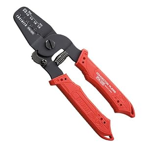

Re: RGB 3 Way Cocktail - Need Opinions -
« Reply #17 on: September 04, 2012, 01:42:13 pm »
Can you post link to 'tested proper' tool.
These work (with dies shown installed) for the Micro-Fit Molex connectors and also the header connectors for the PACLED64s.
iserian

How about this?
« Last Edit: September 04, 2012, 07:03:04 pm by iserian »
« Reply #19 on: September 04, 2012, 07:13:12 pm »
Nope.
« Reply #22 on: September 04, 2012, 11:30:17 pm »
How about this?
Been using something like that for years, no complaints.
« Reply #23 on: September 04, 2012, 11:47:04 pm »
Based on Neph's advice, I bought that same Molex crimper. Now I can crimp Molex like a ---Bad words, bad words, whatcha gonna do? Whatcha gonna do when saint censors you?--- riot.  :cheers:
« Last Edit: September 05, 2012, 12:23:43 am by yotsuya »

Iserian - Put "crimp ratchet" into the forum search to get about 8 threads of info and links that won't bust your budget.
« Reply #28 on: September 05, 2012, 08:07:46 am »
How about this?
You've been using crush type crimpers for these types of terminal pins?
...and have no complaints? You're full of ---steaming pile of meadow muffin---.
On a side note; iserian, you can get a set of the crimpers I pictured earlier for $20-$30 that come with the dies to crimp the "standard" Molex pins found in arcade cabs and buy the set of dies in the picture for smaller terminal pins (Micro-Fit) for about $7 shipped.
« Reply #29 on: September 06, 2012, 06:48:08 am »
I got one like this off ebay:
And I went from 15 minutes-per unreliable crimp (and a lot of swearing), to 3 or 4 crimps a minute with extremely high reliability. It holds the terminal in place with a little spring loaded clamp, you just insert the wire, and both crimp areas are compressed in one squeeze. Mine came with a Micro-Fit style die (like in the picture), which works well enough for both the wire-to-wire connections and the pins needed for the wire-to-board connectors as well.

I have a similar pair that I use for tiny terminal pins:
I've made over 2,000 crimps with them and they're still going strong. The only thing I don't like is that, with these crimpers, I have to crimp each terminal pin twice (once for the conductor, and once for the insulator).
Hmm. . . $260 less in my pocket or crimp twice. . . Thats a tough one.   :lol

When I want something I do a great deal of searching to find the best deals... But for those who like stuff handed to them here we go...
The crimpers from my previous post:
http://www.amazon.com/Engineer-PA-09-Micro-Connector-Crimpers/dp/B002AVVO7K
These are for really tiny crimps only. I used them on 1mm JST terminal pins...
The mysterious $30 crimpers (they crimp the insulation and conductor simultaneously):
http://www.amazon.com/Tool-Aid-18930-Ratcheting-Weatherpack/dp/B000K1CFXO/ref=sr_1_9?s=hi&ie=UTF8&qid=1347061444&sr=1-9&keywords=ratchet+crimper
Great for the "standard" Molex connector pins.
