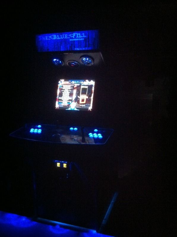

Made a lot of progress with software configuration today, I am very happy with the results.
First out the gate, Hyperspin auto-rotating on launch working great, a huge thanks again to DNA Dan for all his help with this.
Second a sneak peak of the layout in pinball mode, I can't tell you how happy I am with the way the whole layout comes together for pinball, can't wait to play a little TAF on this

The halftone dots in the graphics and bezel were an inspired idea.  I'd get rid of the street fighter and make it a pinball themed cab- its so well suited for VP/FP.  Good work.

Man that looks good great job.....
Looking at it with the full effect....too late now...but some ambient lighting behind yor graphics would have been nice...to show them off....you may be able to see them well in person, the graphics area looks dark and your art work it so good would be cool to se it lit up around your screens....

Thanks guys I'm really happy with it. You can see the art well enough when you are standing in front of the machine, it was a delicate balance of having it visible but not detracting too much from the playfield. Unfortunately because of the way it is built backlighting wouldn't be possible, but that's ok it worked out pretty well.

Today I decided to ditch the idea of the remote control RGB lighting in the cab. Relocating the IR sensor proved to be virually impossible and in the end I managed to snap one of the legs clean off it  :banghead:
Not a big deal, the main RGB box still works well enough and starts up in color cycling mode, so I am going to use that on the motherboard base for the computer 'night club' in the back of the cab, it will color cycle on it's own and look nice and flashy. The LEDs in the marquee just need to be static white so I'll wire those manually, I was planning to do this anyway as I didn't want the backlights color cycling the marquee every time I started up the cab.
As the cab is raised off the floor slightly by the wheels I think I will put a static red stip of lights in the bottom to give that nice ground FX look.
This weekend I plan to cut the sides and get the hardware to hang them on the cab.
I drink and I know things.
That's really a nice effect.  I think when I put mine on carpet, I'll need to raise it a little.  But, on my paint-stained garage floor, it looks really cool.  I used 15" CCFLs on mine.  I also put a 5 LED 45 degree light cascading down on the coin door:
