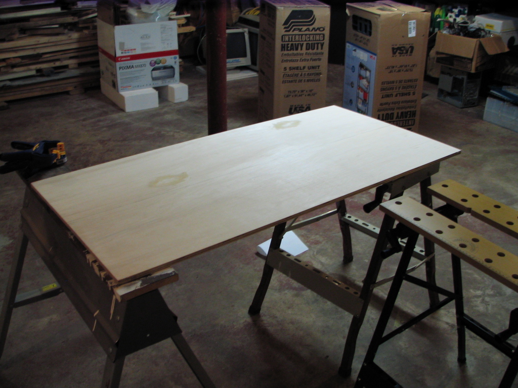

On 2X4 1/2 thick plywood, I Draw a line down the middle lengthwise.

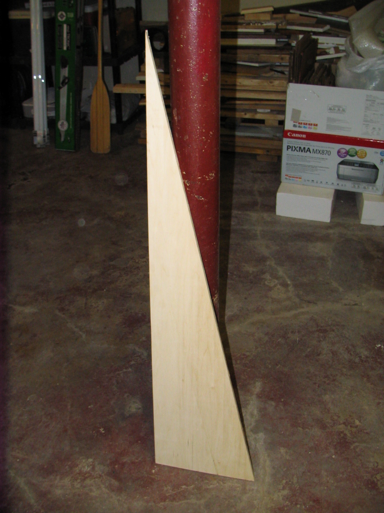

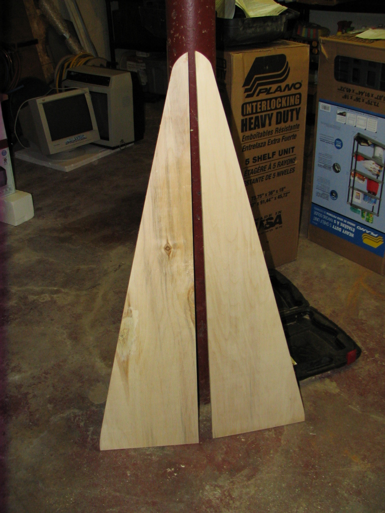

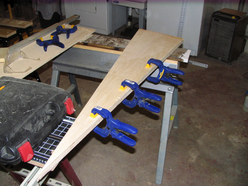

On one of the halves, draw a line corner to between corners to make two Triangles. Cut out both triangles.

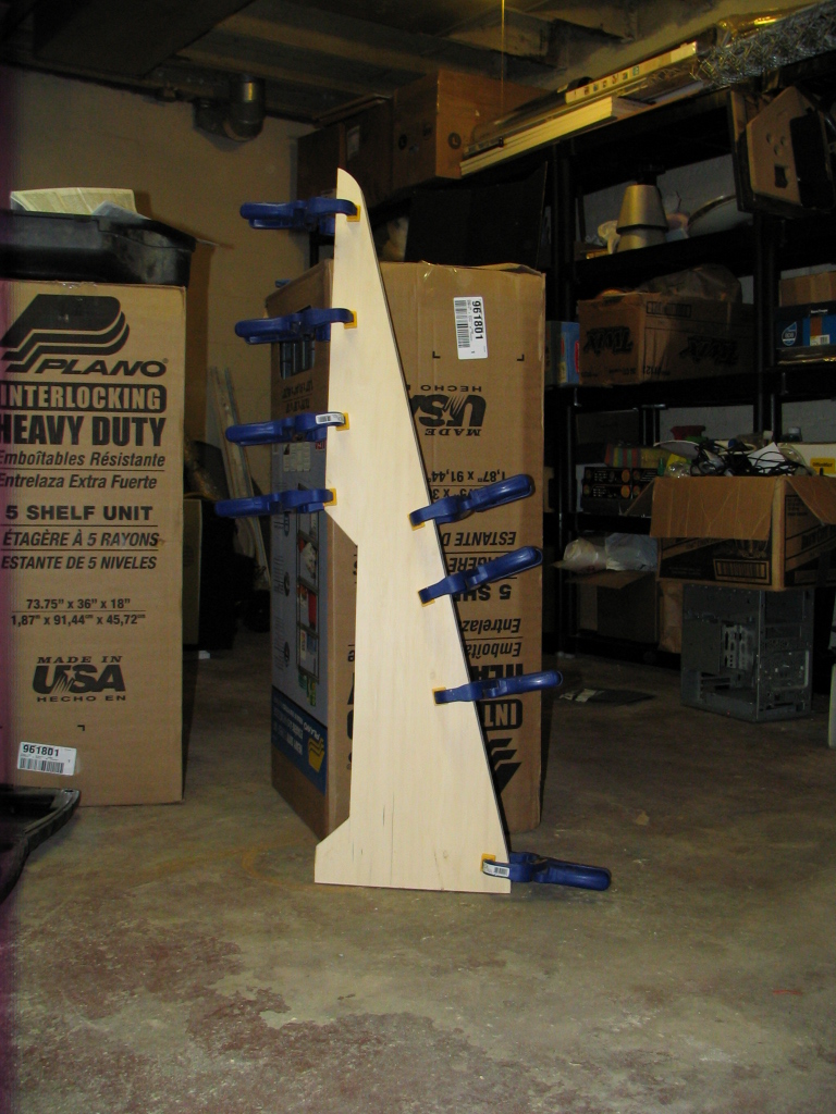

Clamp the triangles together. You may flush them out with a router if they are slightly different in size. Now round off the bottom front and top corners.
Now Cut out some of that Gauntlet jut. I made mine 2 inches, and it is good that I did, because I needed that scrap wood for later in the project. Mmmmm, sexy Gauntlet jut.

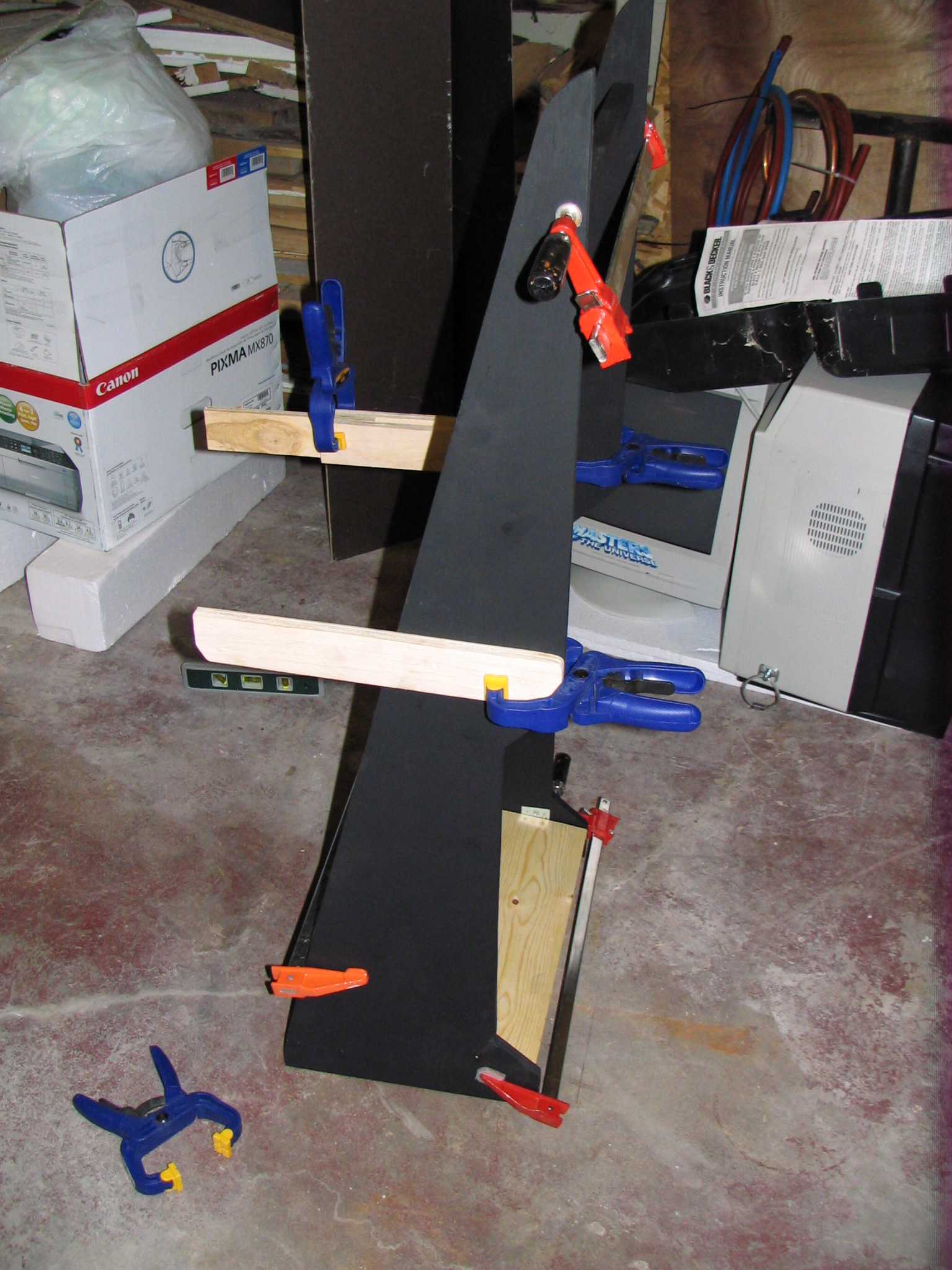

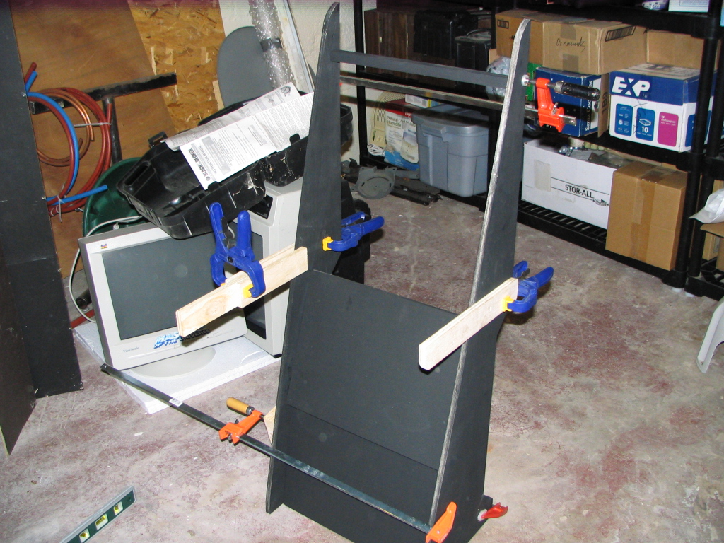

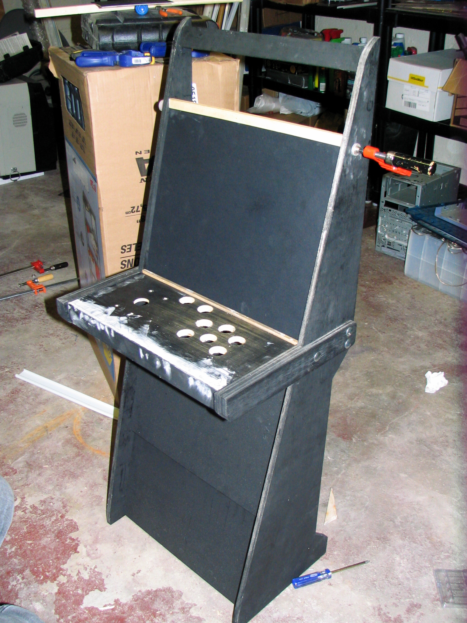

OK, now it is time to start fitting the parts together. I put some brackets down, some firring, since I am bracket-aholic, but I still am clamping. I started priming my pieces. That's why some are black. Those two plywood rectangles, they are on the front. To keep the design simple, I just overlapped them like shingles. Easy and effective. Remember that spare 2 inches of wood from the Control Panel piece and the Gauntlet jut? Those went to make the arms that hold the control panel in place.
Because I am keeping measuring at a minimum, in the photo I am lining up and marking where to cut the arm pieces. Each arm is made of two pieces of wood. One to go on the outside of the cab, and the other to bring it back flush with the inside of the cabinet since my control panel is only 16" wide.

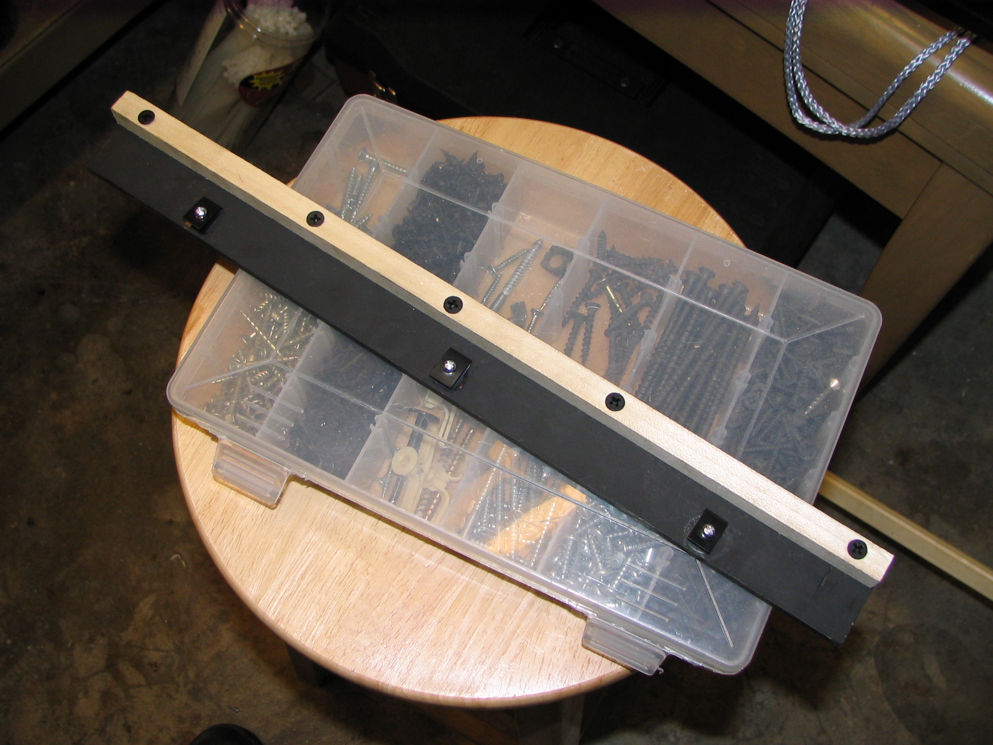

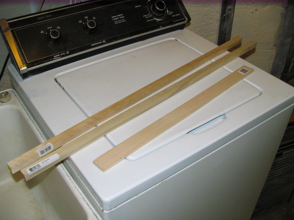

For the top of the cab, I just screwed a flat dowel to a square dowel, then shoved some clips on it for the marquee. I could do the same with the bar for the bottom of the marquee, but I was running out of doweling, so I just am using a piece of cap moulding.

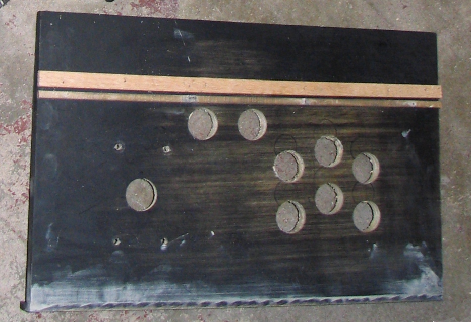

I have assembled the control panel. I put a piece of flat dowel in front to hide any controls that would stick out from underneath, I then puttied in the gap. I also nailed in a couple of small square dowels on the top to hold the bezel in place.
Now I bolted drilled and fit everything together. drilled some control panel holes, and cut a piece of art board to size for a bezel, and tested the feel. I think it is going to look great!
That's my progress so far. I was going to start painting, but I bought a dud can of spray paint. Not bad progress for two days of work.

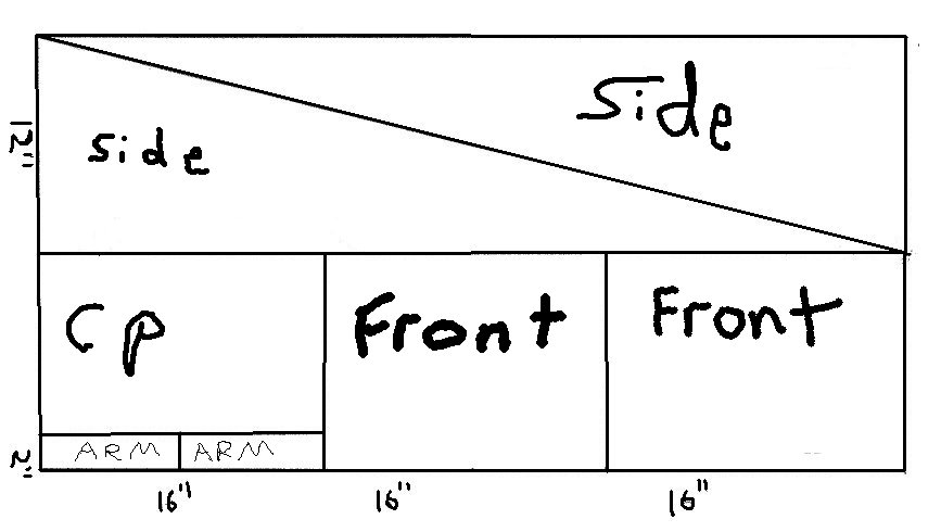

Since i'm basically stuck at work, i'm going to make a quick sketch of the board. I'll put it up when i'm done.
Awesome! Please do!  :)
Happen to know the dimensions for the jut you cut out at each side?
Also, i started the draft using a 4x8 piece of wood in mind to make a full sized cab. Before i started actually drawing out the cab i thought that i would simply double up the measurements. Physically drawing this out proves that this would be greatly disproportionate for the average human to play. While a 32inch control panel is feasible,the vewlix by default also uses a large, wide screen monitor however a cabinet with an 8 foot height from tip to tip is not.
If you had actually envisioned this using a 4x8 piece of wood, what dimensions would you use?

I can get you the full dimensions on the jut tonight, I don't fully remember because I went with my gut on the overall length. I did start the 45 degree cut at 2 inches up from the base, and it goes 2 inches inward. I will measure the length tonight when I get home from work.
As far as dimensions on a fullsize cabinet, I had thought about the daunting 8 foot height it would be. I almost immediately had the 2x4 sheet in mind, so I didn't think over that part too much though. When I trimmed the top, I did lop off about 3-4 inches, so that would double on a full size cab. Maybe if 2 feet are taken off the entire sheet of wood before anything else is cut, it might help the overall proportions. with a 4X6 sheet, the control panel width would be 24" and the height would be about 5 and a half feet after getting rounded off. I can't visualize how that would change the look aesthetically, but it seems like much more normal proportions, plus extra wood for the cabinet.
Re: Wedgecade, a super easy mini cab on 1 sheet of 2X4 plywood
« Reply #21 on: April 17, 2012, 08:51:32 pm »
OK, I just checked the length of the jut. Total length is 20", 16" on the inside. 2 inches depth.

alright, here goes. made this quickly as just a simple diagram to show the basic cuts. this is NOT to proper scale, you cannot enlarge the image to a 1:1 size and expect to use this as a template. It will not work. simply go by the dimensions posted in the image and you should be fine. The image does not contain any curves. If you want curves, simply any one of your favorite curving tools (coin, cup, crack pipe etc) once you have your first cuts. There may be some inconsistencies, I'm hoping someone will point them out. I'm tired and hungry so expect this to be revision1. This is for the 2'x4' model only. Still trying to visualize a full sized, two person version although i believe it can easily be done.

404, Awesome work with the diagram. It looks great! As far as I can tell, that is exactly how I cut mine.  :applaud:
Not sure how Vigo feels about the project but you can feel free to modify the image attached any way you want.
I am also fine with anyone using the design and running with it however they want.
