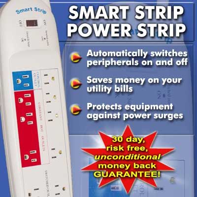

I have hit a small problem however.   ???  I want to make an on off switch that works for the computer and the tv but I really have no idea how to do that.  ???  I assume I can take my tv apart a bit and add some wires leading back to an external switch but I would really like to see someone who has done this already so I don't make a mess of it.  If anyone can help that would be awesome.

What you need is a smart strip:
http://www.bitsltd.net/
Plug your computer into the 'master' outlet, and your TV into the 'slave' one.
But better yet, doesn't your 16x9 display have a VGA input? Most times those displays go to sleep (or low power state) if the video signal goes away. I know my 47" Vizio does that. But only when connected via VGA. If I'm connected via HDMI, it doesn't shut off when my home theater computer is shut off, it simply stays on and says 'waiting for input'
Try hooking your PC up to the display using the 15 pin d-sub connector and see if it goes to low power mode when the computer is shut off.
Of course, if you use the 'smart strip' approach, you can also hook up your speakers to it too, and have them power on/off when the computer powers on/off. Saves electricity.

As far as the smart strip.  I don't think this will work for turning on the tv and computer.  When power is cut to the tv and the computer they both need to be turned back on by pushing their separate power buttons once the power is turned back on again.
Re: 16x9 Cocktail Table Project (More pics!!!)
« Reply #146 on: May 21, 2012, 02:42:16 pm »
Get a DPDT (or SPDT) momentary switch. Wire one side for your computer's power, and the other side for your TV's power.
