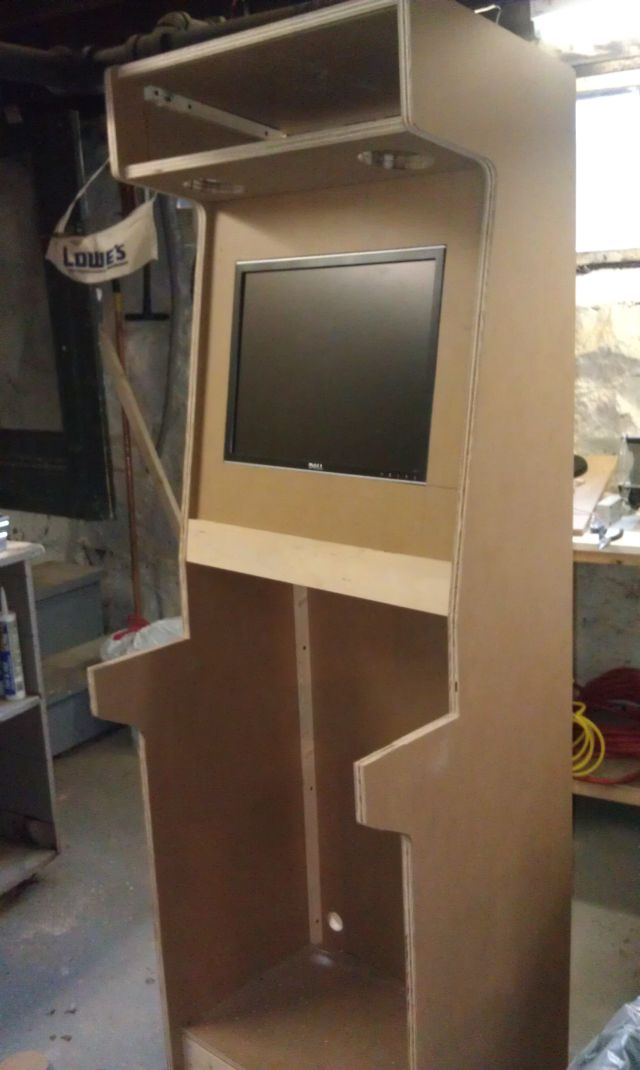

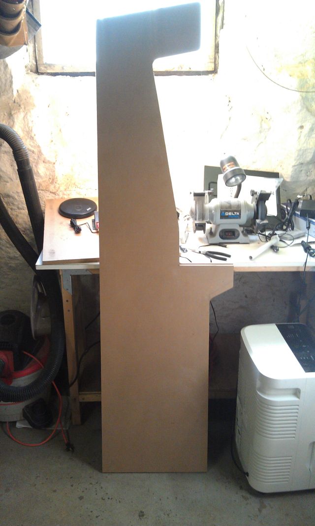

I have begun construction on my first build.  It is a slim cabinet with a 20 Dell 2007FP IPS panel for a monitor.  The design is a mashup of the many slim cabinet projects that I have seen on this forum.  It is certainly inspired by Knievil's Evolution build as well as Alfonzotan's build.  It has a depth of 17.5" and is 24.5" in width.  I will be running Hyperspin as my front end.  The control panel will be the typical Knievil design with 3" trackball, spinner, dedicated 4-way stick, and two eight ways with 6 player buttons each.  I have ordered led strips for the marquee since I don't have a whole lot of space for the light.  I will be using 4" car speakers and a Lepai amp for the sound.  I build the cabinet from 3/4" MDO which has been great to work with.  I have run into a few problems along the way since I am not really using plans to build this.  Routinh the slot for the t-molding was one of them.  I screwed that up pretty good because my router plate was sitting a fraction of an inch lower than my router table.  It has been challenging learning how to try and get this right the first time.  I have good woodworking skills and a great shop with a cabinet saw, router table, jointer, 14" bandsaw, floor standing drill press, and even a wide belt sender.  Even with all of this it has been a challenging project.  Kudos to those of you who build beautiful cabinets with limited tools.  That takes patience and some ingenuity.  My next step is to finalize the artwork.  I have always liked the cosmic frostbite image in green.  I know it isn't very original so I am looking at doing something different.  I am having a real hard time naming the machine.  I know that it will be something cosmic so if you have any ideas for me I would love to hear them.  Anyways, here are some pictures of my progress so far.  Tonight I work on the keyboard drawer and the front door.  I have to mill up some edge banding material out of hardwood for the door since I am using MDO plywood and the edges would be exposed.  Thanks to everyone for the inspiration.
The profile
On the base with the back, top, admin panel, speaker panel, and monitor attached

Here is my next problem.  I didn't want to buy marquee retainer so I decided that I was just going to run a 1/4" dado on the top and bottom of my marquee box so that the two 1/8" acrylic panels that sandwich the marquee art would just slide in.  The top of the machine is removable with a couple of screws to access this.
So, no problem.  I did that and it looks like it will work.  The problem is that I planned on using t-molding on the front face of the marquee area but I cannot run the groove for it now since it will intersect the dado groove that I ran for the marquee acrylic and end up just cutting the the entire corner of the wood off.  Do you think that I can remove the "T" from the t-molding and just glue it onto the edge of the plywood?

You can try that and see how it works... might want to make a very shallow channel in the middle to help line up the remnants of the "T".
Another option:  make fake marquee retainer.  I bought a strip of this stuff at Lowe's (couple of bucks for 6' if my memory serves) and trimmed with tin snips to make two retainers.  Added screw holes, painted it flat black, and it passes for actual marquee retainer perfectly.  Cheap and easy.

Look at some T molding before you try to install it with the T leg cut off.  The molding I've used has a lot of curve out the outer part which is flattened out by the flat edge of the workpiece.  You're going to be fighting that curve without the barbs of the leg holding it in the slot.
Here's another cheap hardware store idea:  I went to the closet section and got the hook rail that a lot of modular shelving systems use to hang from.  It worked great on my switchcade cab.

So I just walked the aisles at Home Depot looking for something that could be used as a marquee retainer and I had no luck.  Looks like I am going to have to buy the real thing.  My question is this, will the front part of the retainer cover up the edge of the wood around the marquee box.  Tough to put this into words but, is the front of the marquee retainer 3/4"?  I do not want to see a shadow on the marquee when backlit.  Thanks

the ones I've seen are 1/2" or less but i've never bought dedicated retainer parts.  I used 3/4" material and I incorporated black into the bottom and top of my marquee to go with it.  Sometimes people cut tapers in the top and speaker panel to get around that.

I would suggest some iron-on edge banding from your local hardware store. They sell that in black.
Or this would be another option..
http://www.t-molding.com/store/product.php?productid=69&cat=5&page=1

 I think i have some edge banding lying arount from a black melamime project or I will just use a thin stirp of wood.

Lots of progress over the last few days.  I completed the priming and painting of the cabinet and I am really pleased with the finish.  I rolled on the finish with a foam roller and there are no line marks in the paint.  There is a slight texture but it looks good.  I installed the LED strip lights in the marquee and these things are great.  I can't imagine that there is a better product out there for lighting a marquee.
They just stick in place.  I did use a few strips of two sided tape just to be sure they wouldn't fall off.
I also got the 1/4" solar grey plexi from Tapp installed.  It fit perfect but I did have to remove the admin panel and widen the dado groove I made for it to sit in.  I also got the speakers and amplifier mounted.
They keyboard drawer was a PITA to get right but I got it done.  I just need to put the hinges on the door to finish that off.  I used peel and stick edgebanding T-Molding.com instead of marquee retainers.  My marquee glass will sit in grooves instead of being retained.  It should make for a clean look.  Here is where I'm at.
