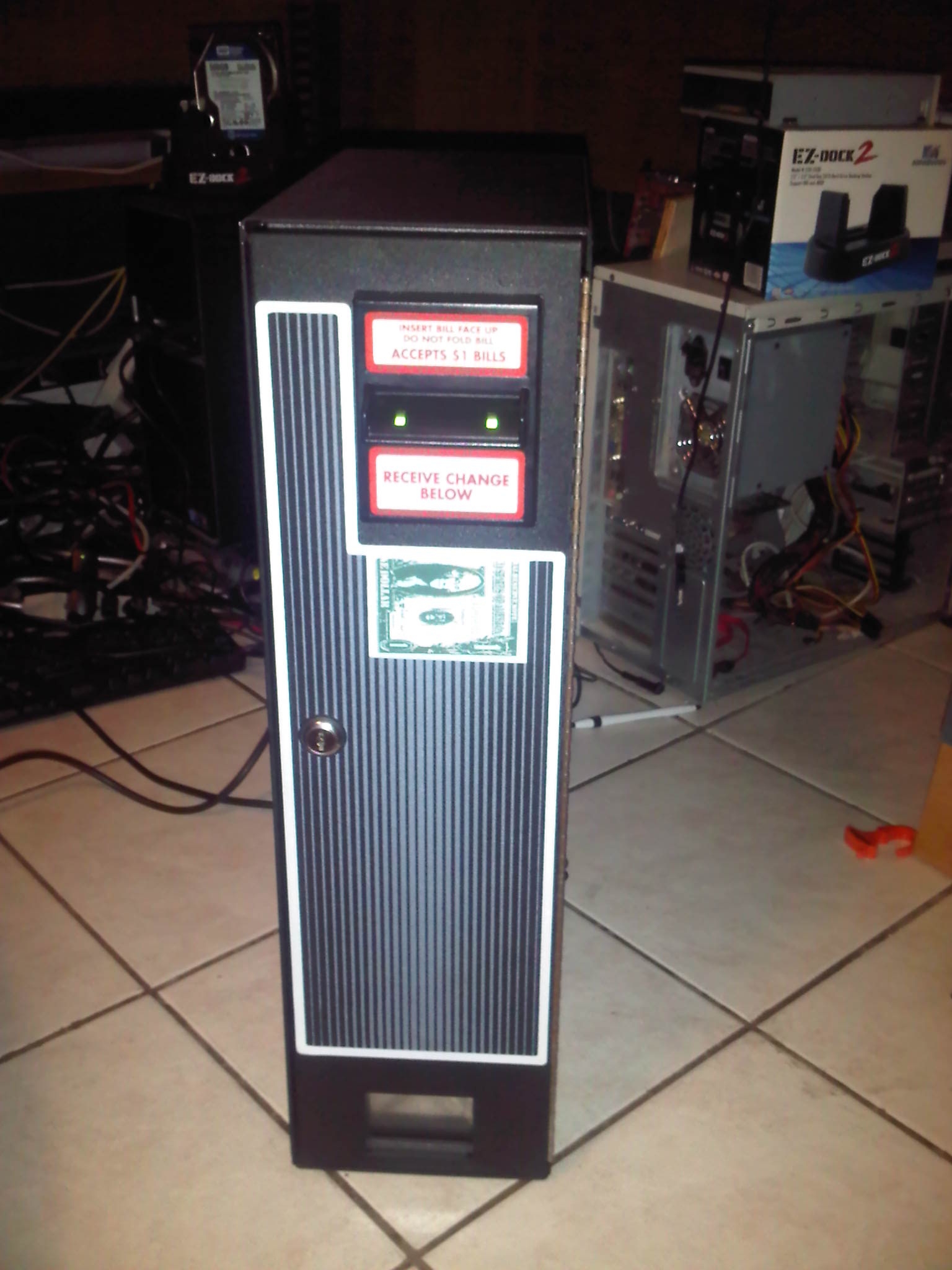

Hey guys-
Like many of you, I grew up in the 80s. My arcade experiences revolve around tokens and quarters and change. That's why my two cabs both accept coins and don't have credit buttons. To me, there's nothing like dropping in the coin and then playing the game. Free play, while a nice concept, isn't the way we did it back then.
So, in order to have a fun, functional gaming area, I have a large jar of tokens I've collected. Although this works just fine, I've always toyed with the idea of getting some sort of change dispenser. Is it necessary? No. But to me, putting a dollar into the slot and hearing the change drop into the return slot is as much a part of the arcade as the games themselves.
I toyed with the idea of building one, as the cost of change machines on eBay and Craigslist seemed very prohibitive. I could immediately rule out the larger ones, as cost and shipping were too high. The smaller ones were probably what I was looking at, but even at that, the cost they wanted for shipping was about the price of the machine.
So, I just kind of kept my eye open. Around Christmastime, I found a guy on CL who wanted $175 firm for one of the smaller ones. It was more that I wanted to pay, but I couldn't seem to get him down. I thought about giving in, but the listing disappeared before I could make a decision, so I assume he sold it. Even at that, $175 was still $100 bucks lower that what they were listing for on eBay, but I had a budget. I had to just wait.
A few weeks ago, a different listing came up for pretty much the same machine. This guy also wanted $175 for his. I decided to take a page out of the PinballJim handbook. I shot him an email, politely telling him that I saw the listing and that I was interested. I told him that if he had trouble unloading these, I had $100 bucks cash in hand that I would be willing to give him for one. I didn't want to sound like I was lowballing him, but rather I was giving him a option if they didn't sell. At worst, he'd ignore the email- at best, I'd get an email from him after a week or two and get my machine. I figure he might try to counter, and as long as he didn't try to go over $120, I'd get my change machine. It was a straight-forward, no-haggle offer.
The next day, he replied and said $100 would be fine. I went and picked up my very own change machine.
I took some tokens to his house to make sure they worked. Sure enough, they did. The guy is a beverage machine route operator. He picked up some used machines and had no need for these, so that's why he was selling them. He was really nice and made sure I got the best one (he had 5 of them for sale). I'm always liked PBJ's Cash-In-Hand posts, but now I see the definite advantage to them.
I'm going to build a nice stand for this. I can't wait to break it out for the next party. No more freeloading!

Dunno if you want a free-play option on the changer or not, but it would be super easy to rig up since that uses a pulse interface DBA.

Funny you say that, Q*Bert- I *was* going to post a schematic here along with an idea I had to rig a hidden button to dispense tokens. You have an insight/idea? I'm all ears!

It looks like you have a JCM DBV-10, possibly a 20.
Just splice the pulse line and a ground line to a microswitch. 3 of the 6 wires are ground wires. 1 is the pulse line, and the other 2 likely have 12v going to them. Verify this with a DMM.

Q*Bert-
Here's the wiring diagram from the manual.
My thought was that I could splice a button between the Orange (signal) line and the Black (grnd.) lines coming off the bill acceptor. Does that sound correct? Also, do you think I should use diodes on the lines coming from the button to the splice?

That's correct. The diodes shouldn't be necessary, but I'm not an EE.
I've added a DBA to a coin switch line by wiring the pulse line in parallel with the coin switch, and aside of the rare possibility of someone inserting a coin and a bill pulsing at the same time and not crediting both, there weren't any problems. YMMV

Heh. You can. It went through (althought it hasn't been as painless as this pickup was)
Cash-In-Hand II: The Megatouch

That is one feature that will complete my arcade room too. A change dispenser. I want to wire mine up for $1 bills and it dispenses like 20 coins. It would be awesome and
feel like you are winning the lottery every time. That way I don't hear my friends complaining about having to pay to play :P
  • Posts: 19963
  • Last login:November 13, 2025, 01:36:49 am
Re: Newest Addition to My Gameroom - The Cash-In-Hand Story
« Reply #35 on: March 03, 2012, 11:37:43 pm »
There are some dip switches on the changer I might mess with, but right now it's pretty much $1=4 Quarters.
