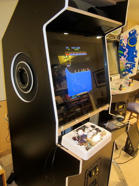

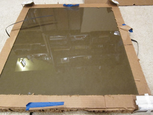

Finally got the monitor mounted for (I hope) the last time.  It was sitting on my table for a few weeks and I was struck by just how big the thing looks.  Here is a picture next to my Galaga for scale.   ;D
I made a bracket for the top of the glass out of MDF.  It will hopefully be the only exposed piece I have to paint.
Here is a picture of it mounted.  I think it turned out pretty good.  I'm anxious to see how it looks with the glass installed.
Here is the bottom mount for the glass.  It will be hidden by the control panel.
I cut a piece of scrap hardboard to the exact size I want for the glass.  This should hopefully make it so the glass fits right the first time.

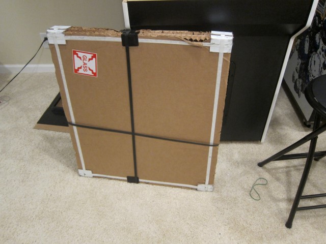

I ordered my glass from OneDayGlass.com and could not be happier.  Well I guess I would have been happier if the shipping were free but I digress.
Shape: Square/Rectangle
Glass Type: Tempered
Glass Thickness: 3/16"
Glass Tint: Solar Gray (Light Gray)
Edgework (Step 1): Seamed Edge
Option: No Tong Marks
It came boxed very well.
My special rubberized gloves.  These worked very well for installing the glass without leaving fingerprints.
It is hard to get a good picture but suffice it to say it looks great in person.  I went with the Solar Gray 31 because I was afraid of having too much tint.  It is a touch lighter than I wanted but it looks fantastic.  It is dark enough to give an "arcade" feel but light enough that the monitor didn't even need adjusting.
I've got GroovyMame configured and am using HeadKaze's CPwizard to drive the 2nd monitor.  The joystick I'm testing with his a piece of crap so I'm not worried (too much) about slowing down because the cabinet is technically "working".

Lookin' good.  :applaud:
